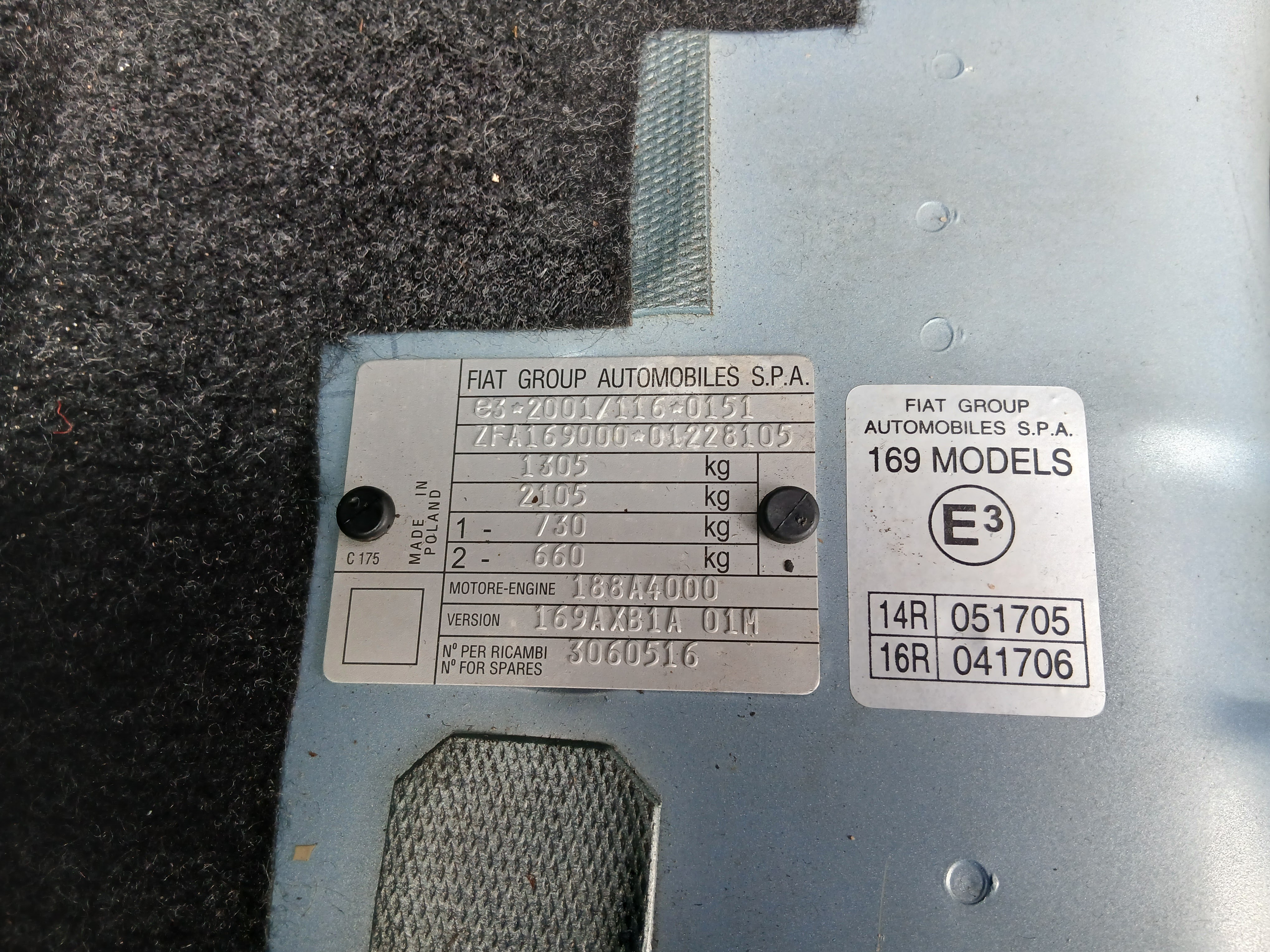

Just wanting to verify the engine number before ordering a replacement cambelt.
Car was first registered on 09/09/2008 and the engine has the round oil filler cap.
Picture of the plate in the boot - am I right in thinking that the number next to 'No for spares' (3060516) is the engine number?
I'm pretty confident that its the original engine in the car, we've had it since 2020, and the one previous owner was an old lady who had it serviced by her local Renault dealer who had details of all the servicing since new when we bought it from them.
Many thanks for any info / help.

I think you will find the engine Series number is what you need. 188A4000. Unless someone knows better.
This is from an earlier Cambelt Technical Manual, but lists that engine Series Number.:)

Unless it has had an engine change the number I go by for technical information is the one you showed in your photo , the 188A4000 engine series details as I don't have specialist Fiat data to go by the spares number etc. on that plate, the 188A4000 also aligns with my Auto Data Technical Manuals as you can read in my Cam belt book photo at #2 above.:)
