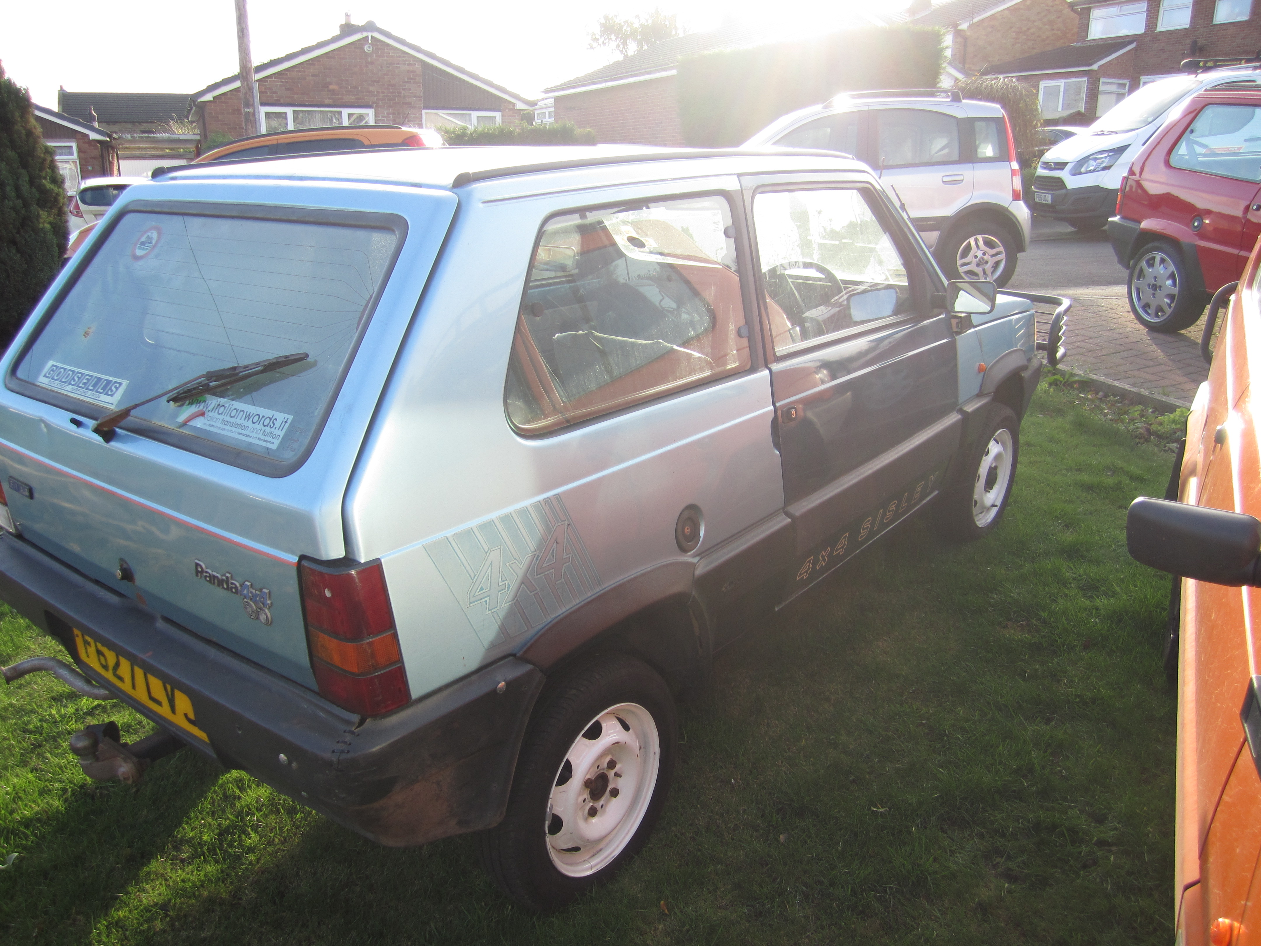

Ok, for those who don't know this is my latest acquisition.
I didn't really expect to win the ebay auction so I didn't view it first.
This will either be amazing or a lesson in how not to buy a car :eek:
Ebay pics :

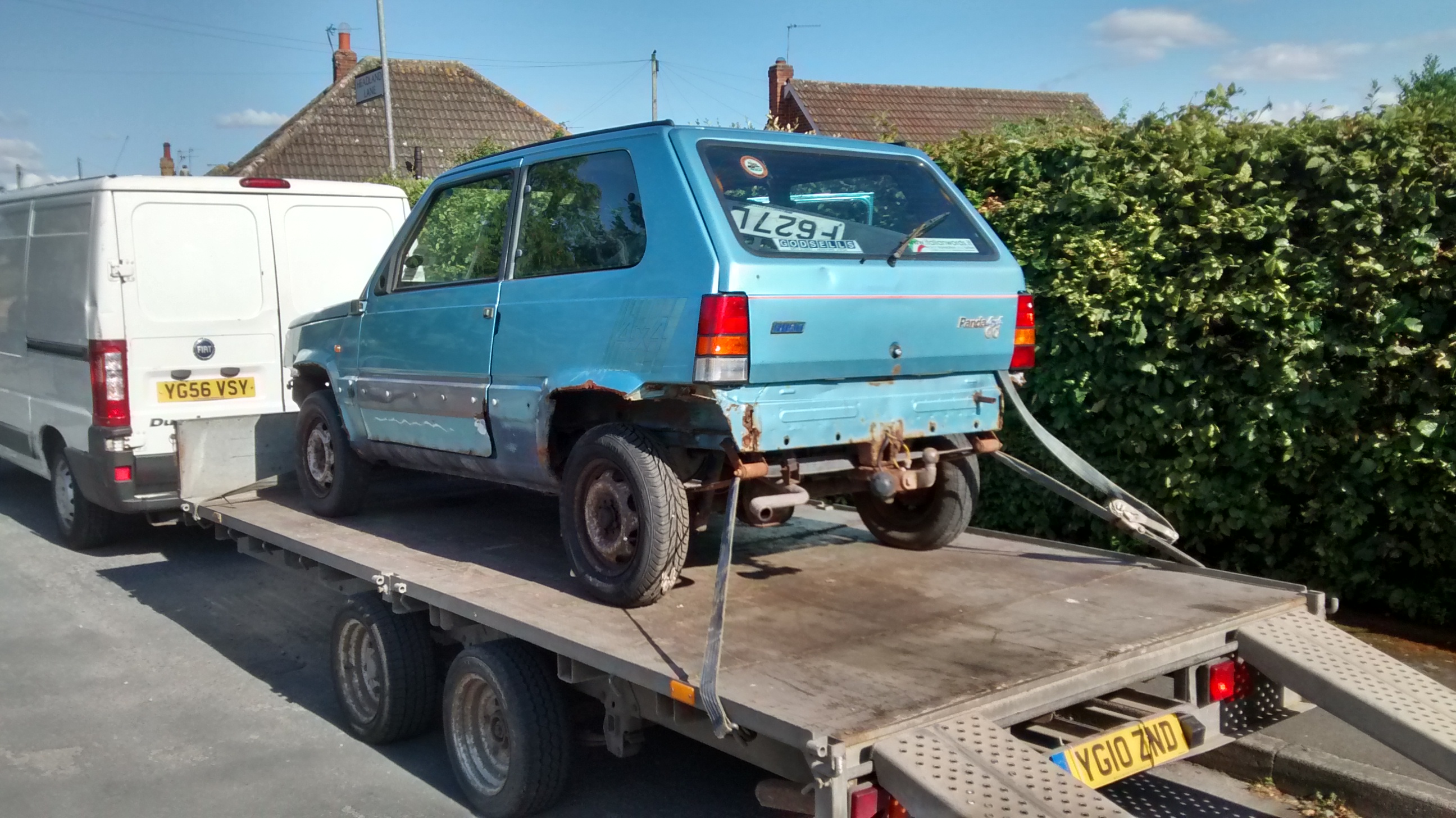

Still trying to work out how to collect it without it being silly money, If I can get a car trailer for a day my brother has offered to help with his isuzu pickup.
Open to other offers though as he notoriously changes his mind if he gets a better offer for his time (like the pub being open :rolleyes:).

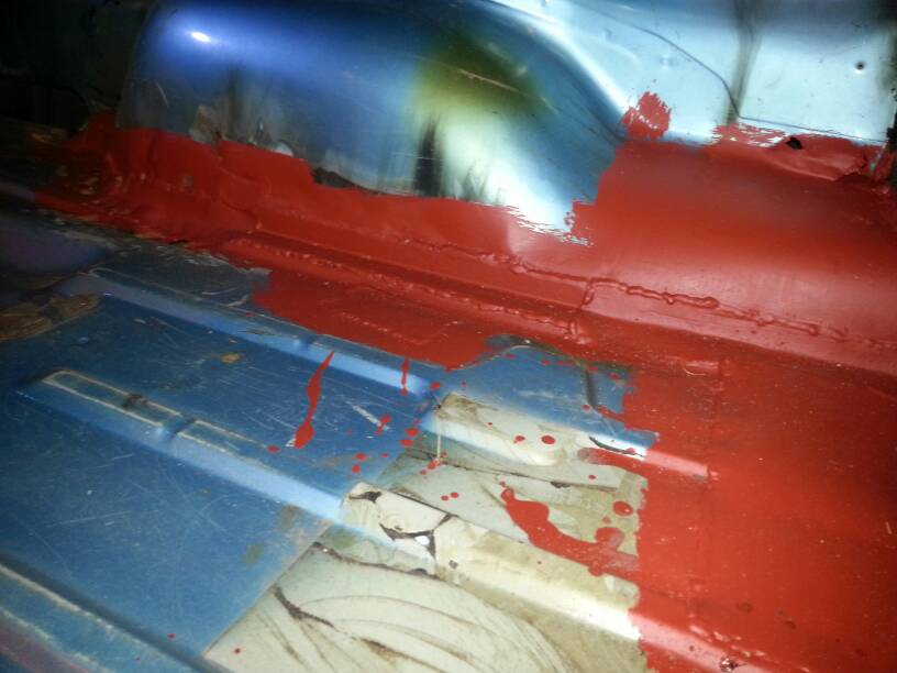

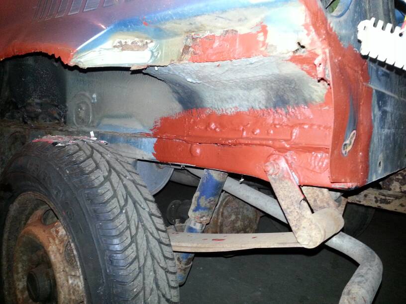

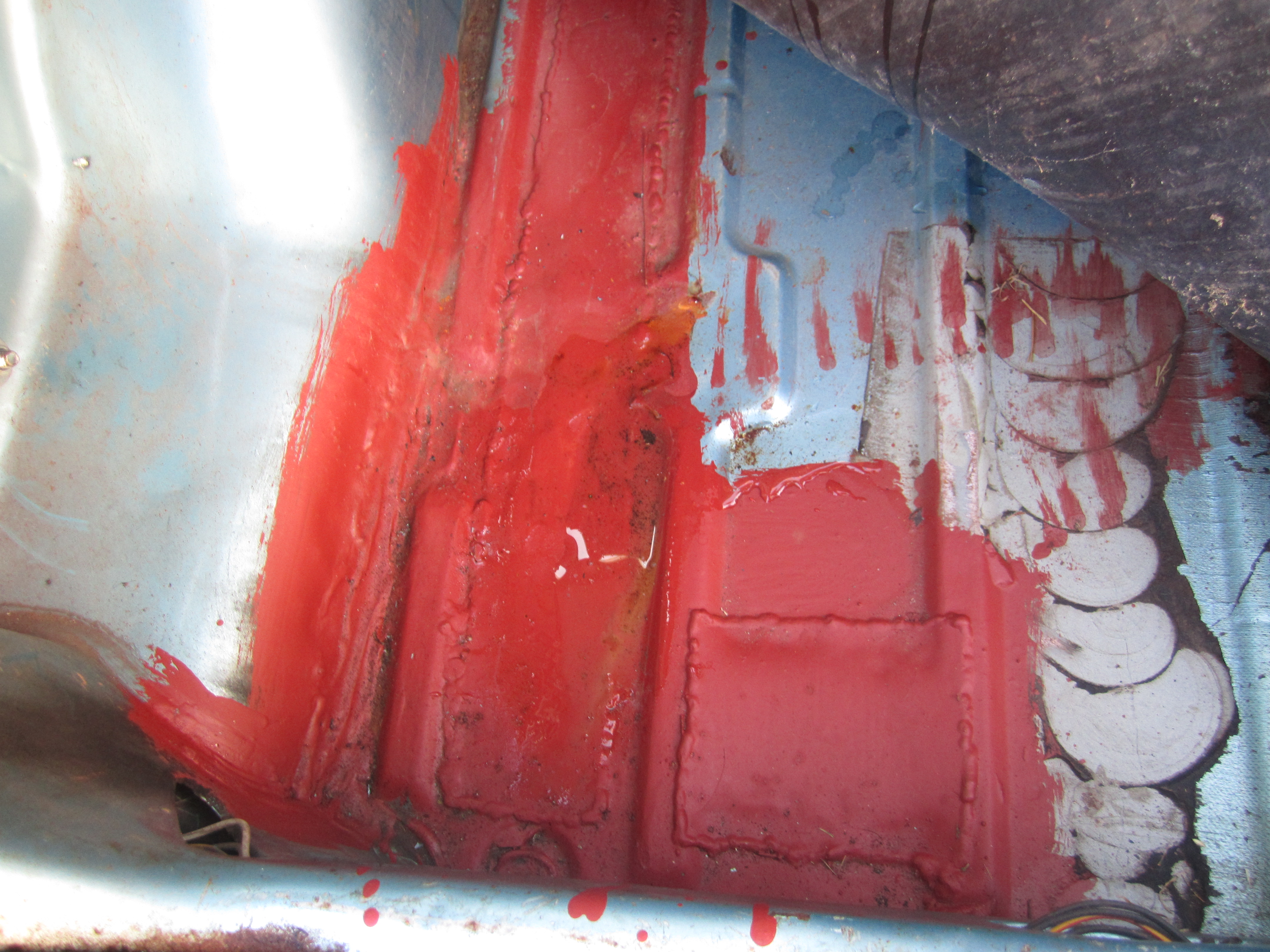

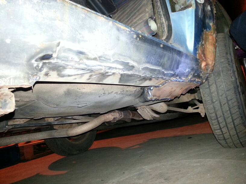

John panda panda brought me a Fizzle full of bits for LVJ today. We were both due to go and visit the car thismorning but plans fell through, so I went down this evening to see how the welding is progressing.
The answer is, very well - almost done! ALOT of work has had to go into LVJ as it's body and chassis in particular areas was none existent. The rear end has had the most work, as seen in the pics at the start of the thread most of the seams in the boot had completely rotted away, aswell as parts of the rear chassis rails and rear bumper mountings. This has all been rebuilt now. The rear spring mounts and shocker mounts have been rebuilt aswell and are now strong again.
The off side sill and chassis leg have been stripped out and rebuilt along with the inner arch, fairly exstensive repair work has gone in to this area. Much the same on the nearside aswell - this is the last bit to finish.
The chassis section which runs under the front floor pans has also been replaced above the prop shaft as it was very crusty.
Fibreglass work on damage to the arches (dents and scrapes) has been started aswell with it nearly ready for a final sand off before a filler coat.
The rebuild will start next week, with new brakes and wheel bearings first then the new Alfa seats will be installed. I have to source a new rear UJ for the prop shaft aswell as the current one is completely shot. Most of the engine work has been done, just the gear oil to change - the car starts and drives brilliant, even with no panels on!

Fantastic!
You can't beat a bit of red oxide for rust proofing - I've painted a barn or two with that in my time!
Looking very solid, can't wait to test the strength of the repairs with some proper off roading :)

Can you take a photo of this plate work from underneath the car? It looks like a plate has been laid on top and not lap welded both sides.
Unless it's a tight fit in that case the second (under) lap used the top run as a cold bar.
