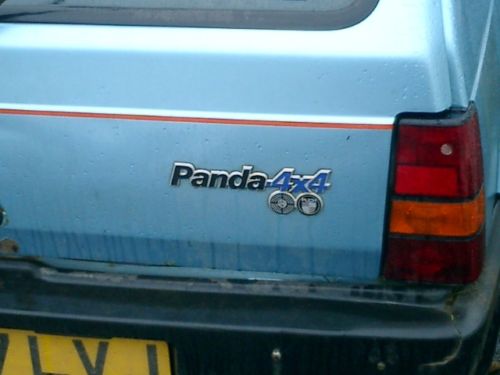

Ok, for those who don't know this is my latest acquisition.
I didn't really expect to win the ebay auction so I didn't view it first.
This will either be amazing or a lesson in how not to buy a car :eek:

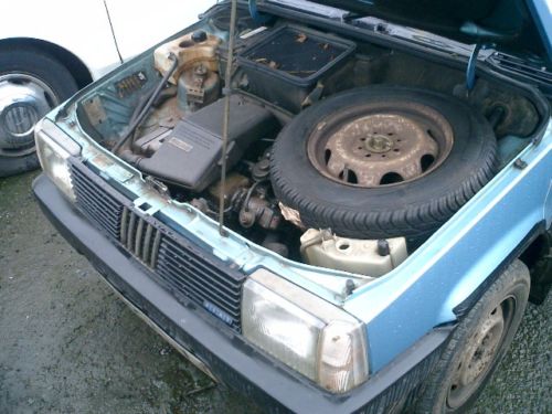

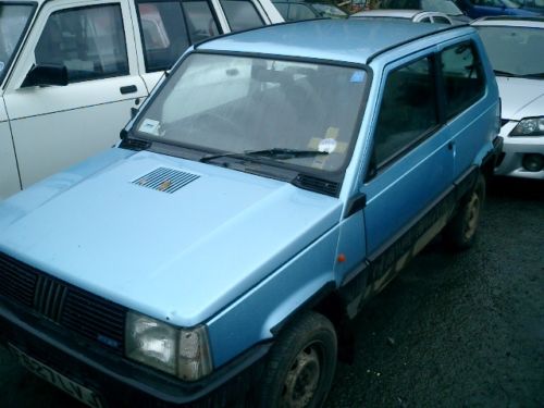

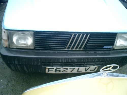

Ebay pics :

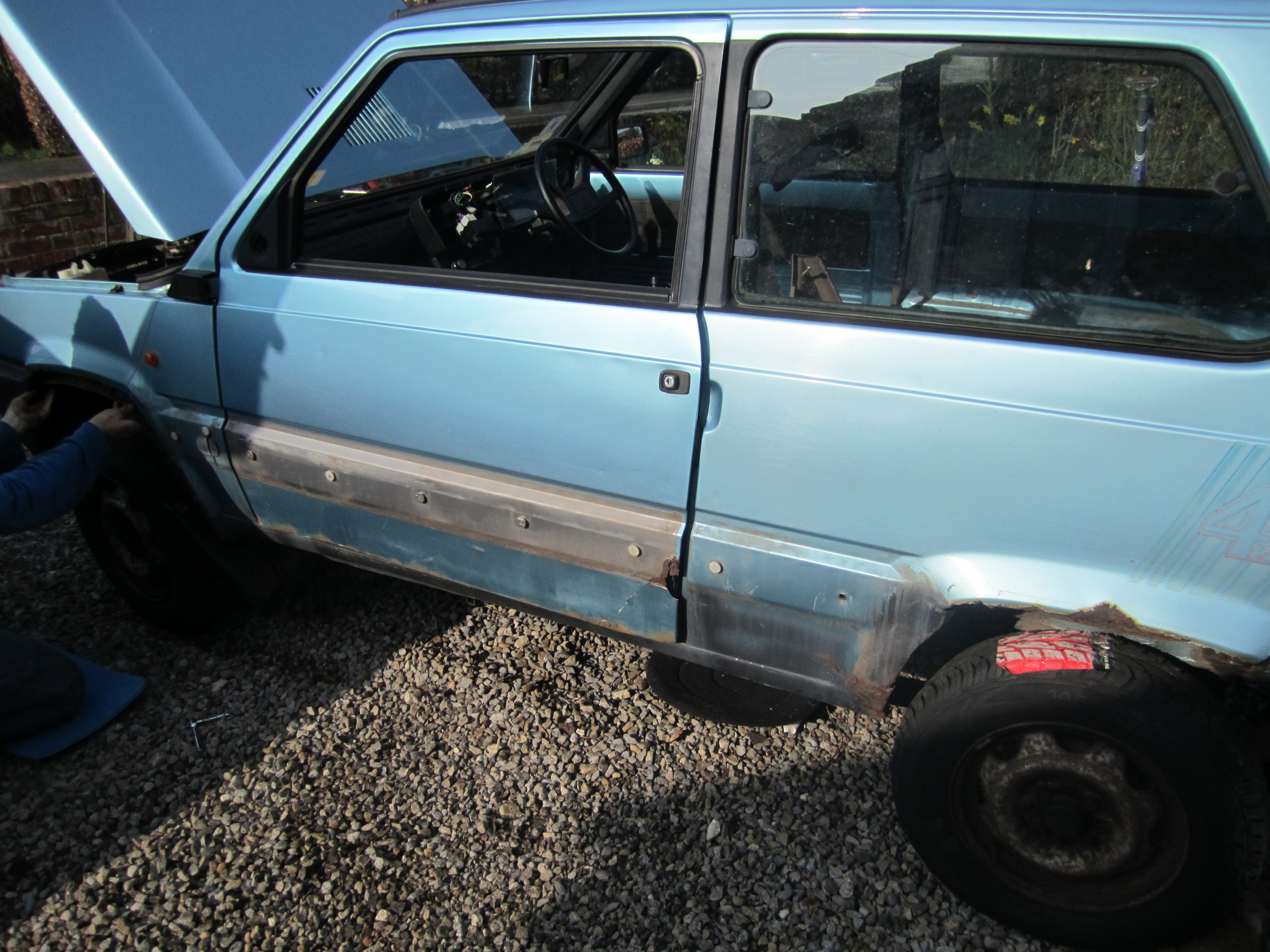

Freebo (aka yet another John!!! surely it's the forums most popular name?) came over yesterday for a bit of a fettle with the blue lump of fiat branded rust and misery which is my 4x4.

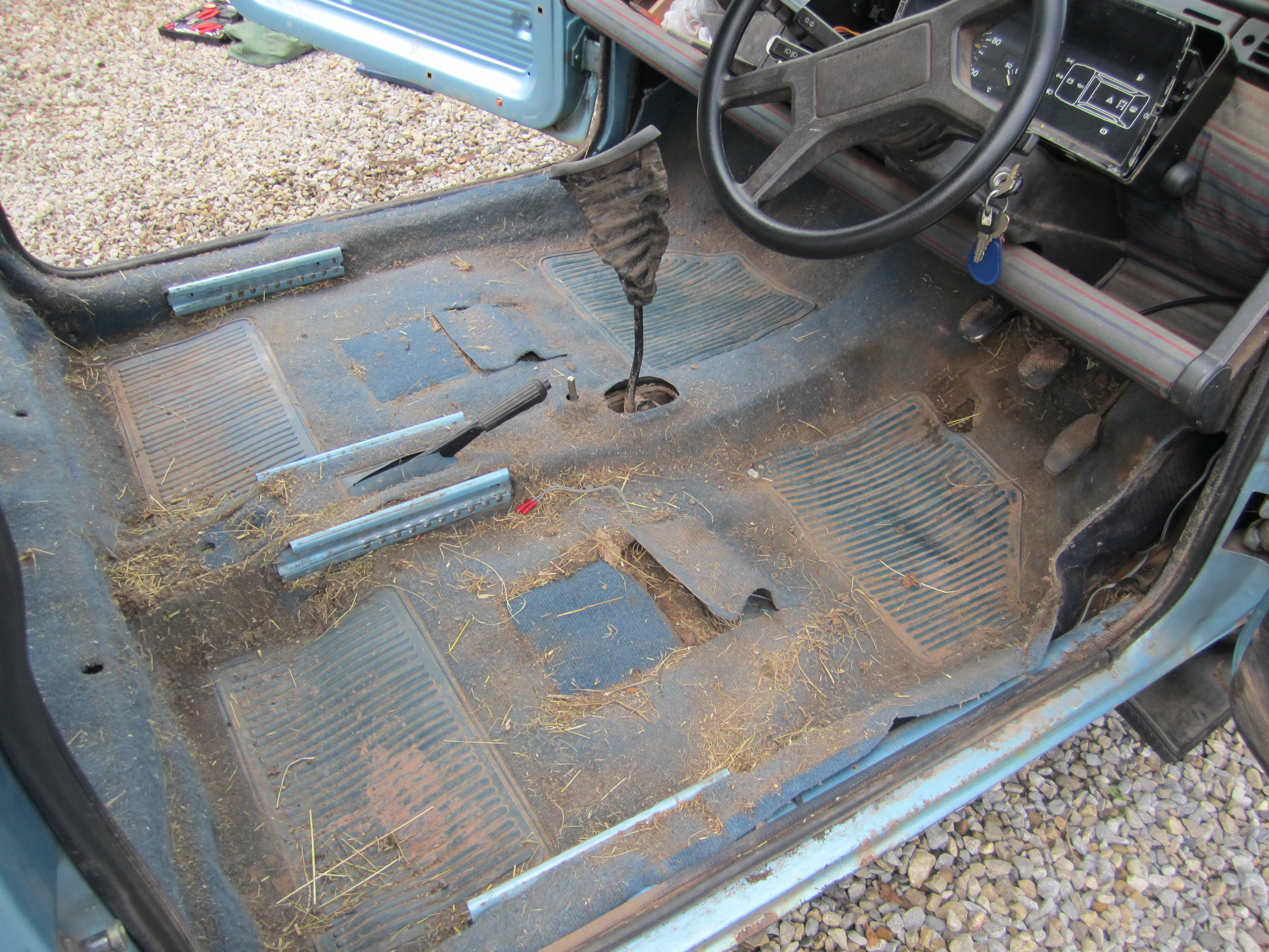

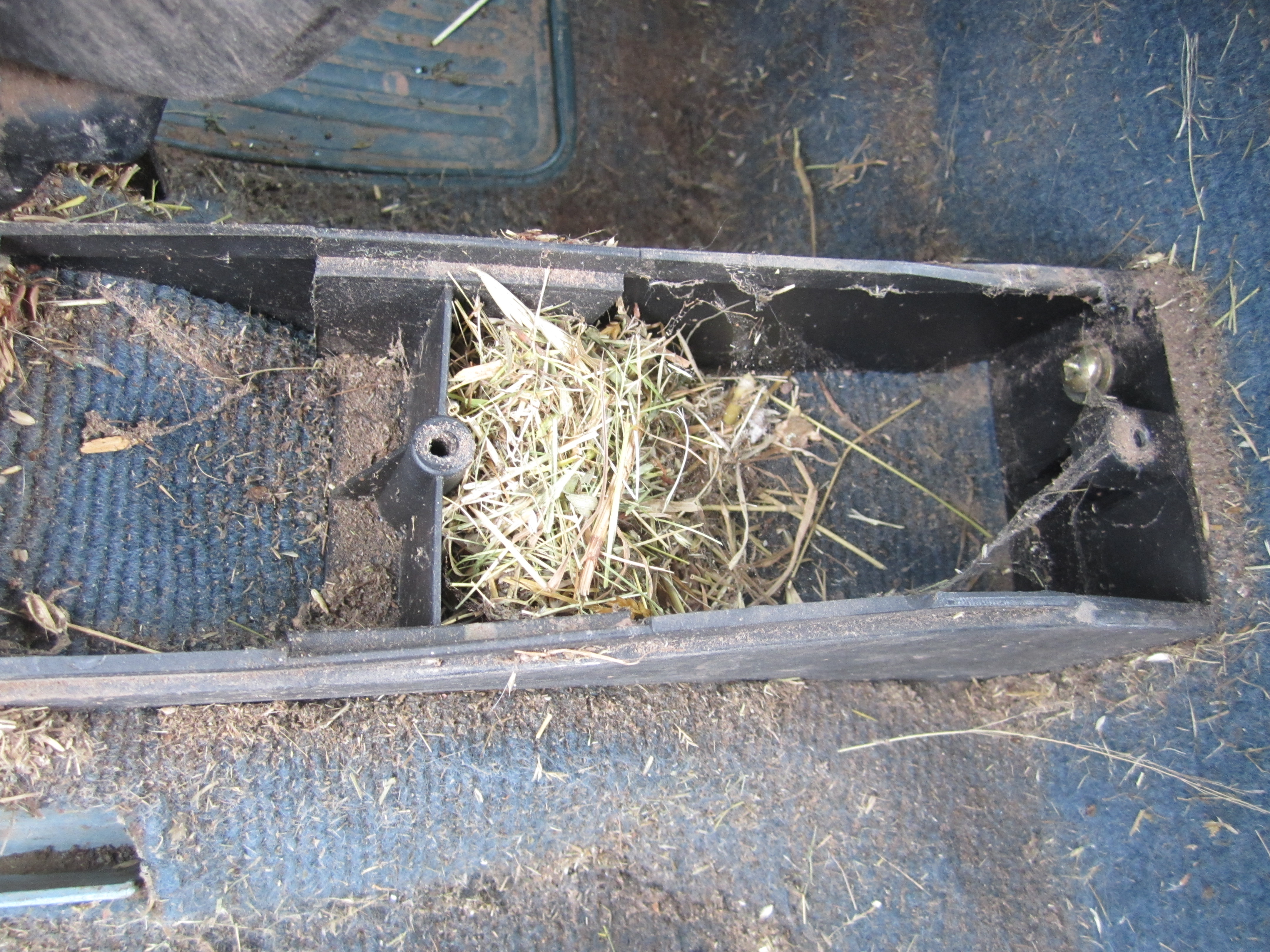

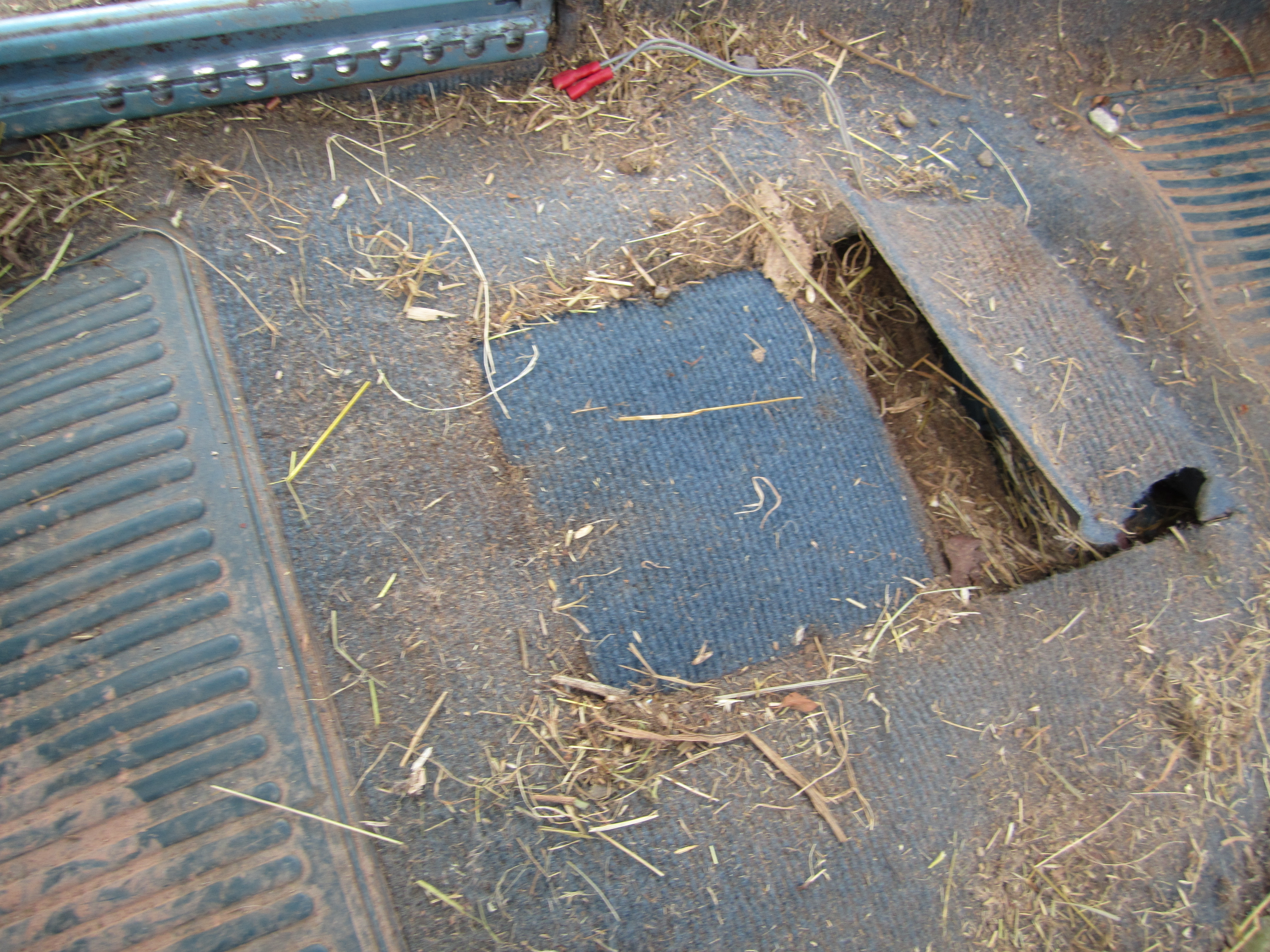

Some pics of the marvelous under seat non-sub woofer:
Hay every where still! :
Seats out :
Through the heel hole:
Plastic trims off and I think these are replacement doors somehow:

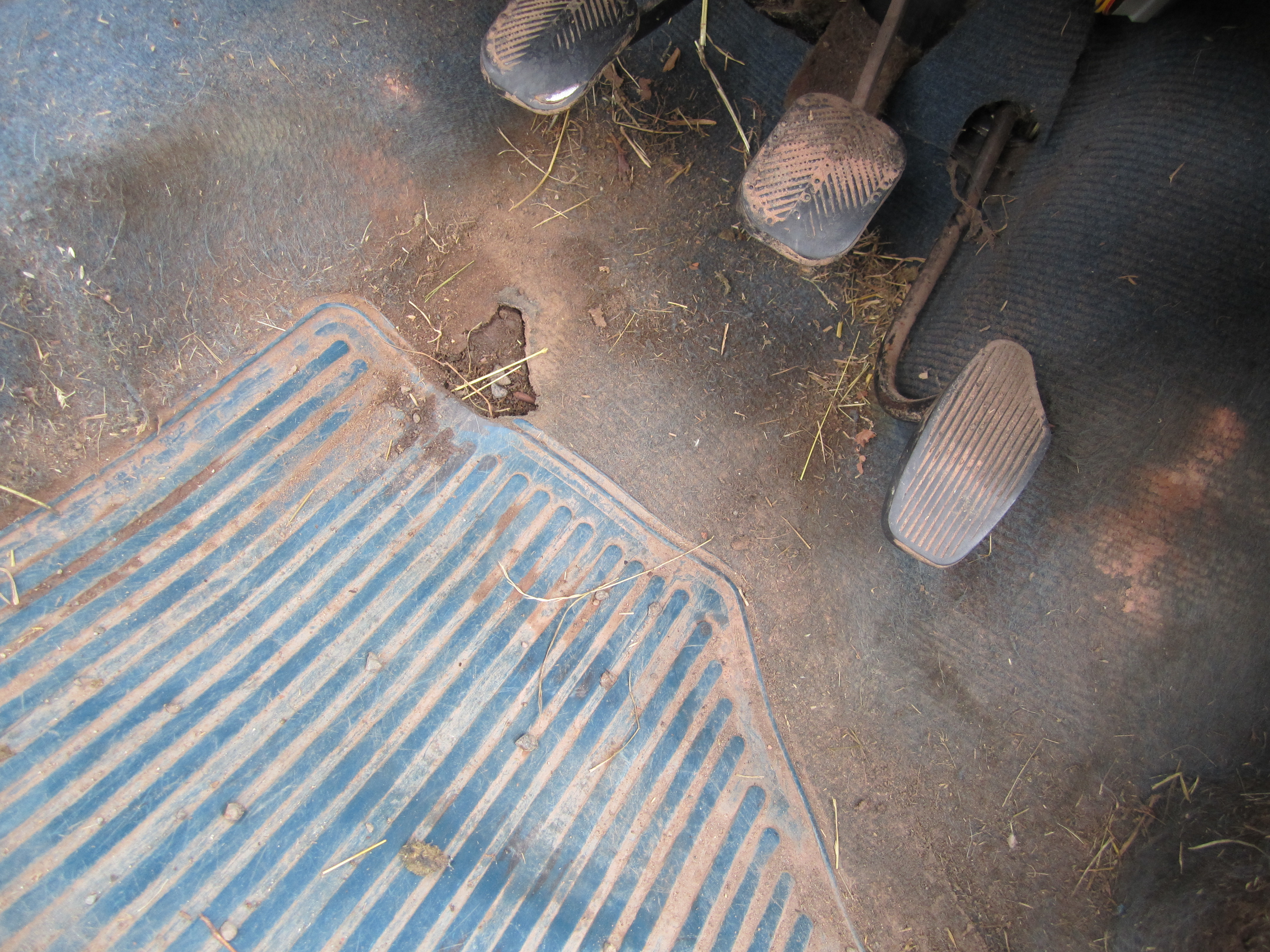

The bulkhead foam under the pedals is very wet (not suprising once I found what was under (or rather what was not there ) the wheel arch liners :
*picture absent due to camera man being too depressed to photo any more frilly rust holes in the car.
Hmmm I haven't taken any pictures of the welding by the seat runners or the bare interior. She's full of bits that have been taken off now so that will have to wait until I recover enough energy to have another go with the grinder :devil:
