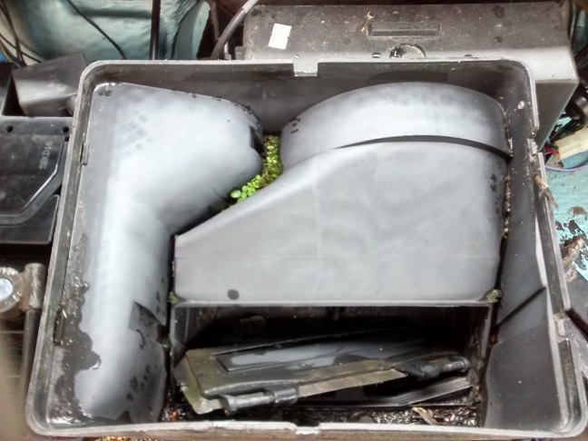

I'll have to dig through all my old screws and self-tappers to see if I have enough to fix it and the plastics back in place. Not quite yet though as there are a couple more things to check out while it's loose. One thing is that I need to discover where all the heater controls connect as it looks like I've a flap that could do with fixing:

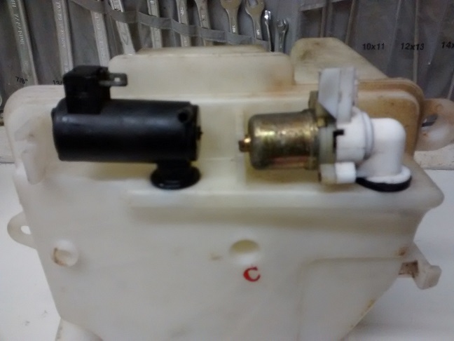

We had realised before I set off yesterday that the windscreen washers needed some attention - the rear washer pump was "sealed" in place with insulation tape.
It must have been enough for the MOT but now, a couple of months later, any water that went into the washer bottle poured straight back out
So today I had a think and a rummage in the basement. I found my box of grommets used for electrical backboxes and happily a grommet fit pretty well:
Let's see if that's good enough to last a while! Probably should have tested the pumps, but I'll leave that for a (hopefully pleasant) surprise tomorrow morning...

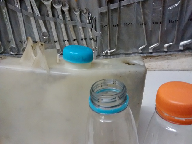

The washer bottle also needed a lid. Never one to throw something away that "might be useful one day" I tried a number of things for size. The winner? Lucozade bottle cap:
Nice positive fit, very snug, but then comes off nicely with a slight twist
