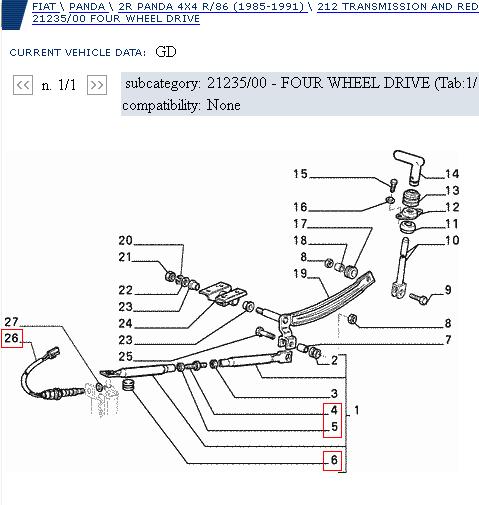

I'm also worried that I couldn't engage the 4wd, the lever just pulls up and down without any resistance and the light on the dash stays unlit.
I'm not the 4x4 expert yet, but the light indication might be electric problem - the actual 4x4 lever sensor switch, lack of any resistance potential slack at the lever system somewere under the floor.
You might need to let the clutch up abit with the car in gear to get the 4WD to engage properly, or maybe the warning light doesn't work as you don't need much effort to pull the lever usually.
I'd have a good poke round underneath first before doing anything else, if its been on the road recently it can't be that bad, can it?
Switches and the contacts in particular can corrode. Clean these up before looking for more technical, mechanical issues. 4WD engagement is a simple sliding collar affair which will stand a fair bit of abuse without breaking, if the car has been used off road regularly I'm pretty certain the system works, even if the switch does not.
i would not worry too much about it john, on the fallout panda, the wires have snapped off away from the switch. this may have happened to yours...
check to see if the bulb has blown.. if you look where your coil is you will see another wire going down the fire wall, ducking behind the break pipes.. it will be a black wire with 2 wires inside. somewhere there will be a plug on it.. undo the plug and short the 2 pins out. if the light on the dash does not light up then the fault is with the bulb.. not the switch ;)
