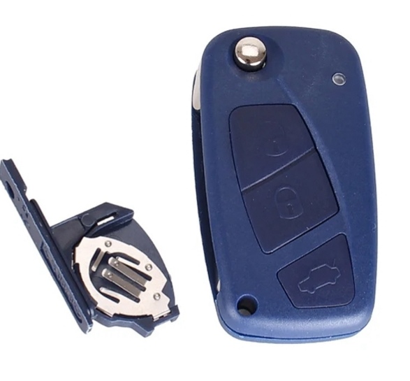

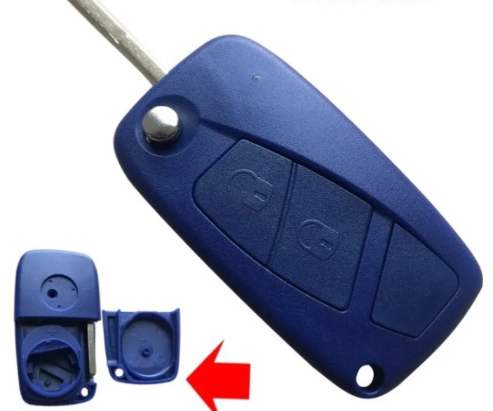

Just re shell it
There only £1.50ish from china
Make sure you order the right one
Fiat do two different but very similar keys
The inside can not be swapped from one type to the other
Type A
Type B
The blade swaps over

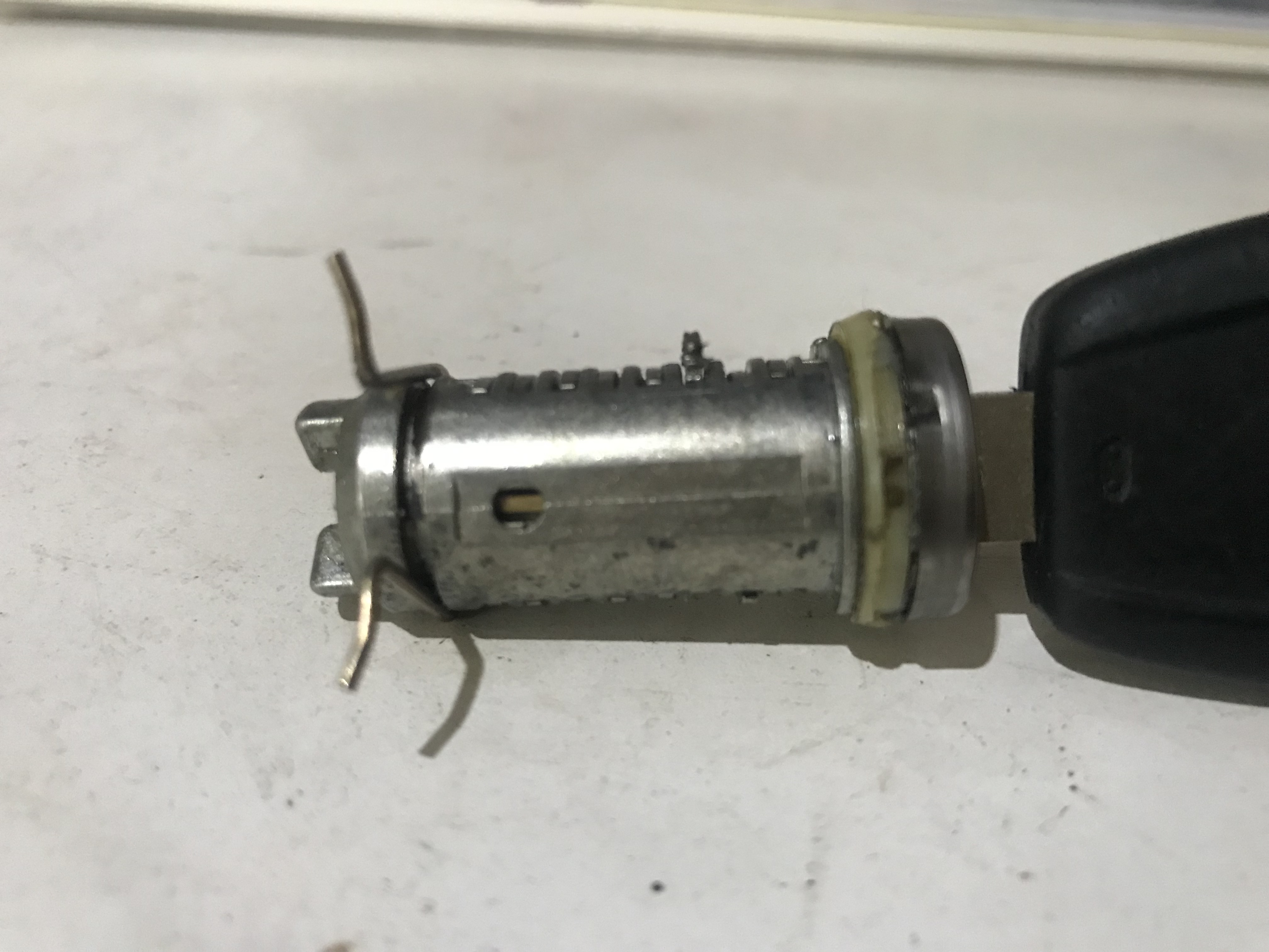

Today I managed to remove the airbag lock and fit it to the door and now the key works!
Dismantling the door was more complex than I imagined but with the help of YouTube and a cordless drill to remove a couple of rivets The whole process probably took me 90 minutes.
The faulty barrel has a stuck pin. I can’t move it with pliers and it remains sticking out when the key is inserted while all the others retract. I wonder if there’s a way to remove that pin so the key still works? Could I just file it flat?
Thank you for all the help on this subject. Could not have done it without you all.
I don't see why not as long as the key fully inserts
If I have an ignition barrel that will not turn because the key worn
I either remove the blades completely or file them down and never had any bother
I have repaired quite a few locks but never seen one that's jammed like this, could it be super glue?
