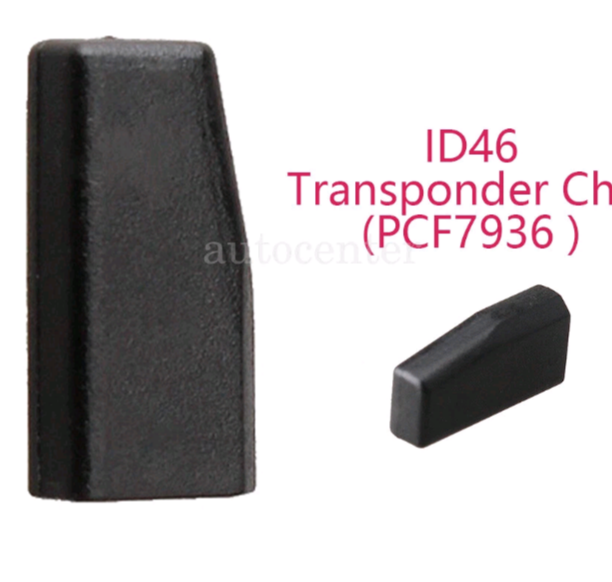

I can buy a used set of locks with one remote key, is it possible to change the transponder from a normal key to a remote one?
The transponder in a manual key
Tiny about 12 x 6 x 3mm
It can be cut out, don't loose it
The remote is different and is an IC chip on PCB
Remove the PCB and glue the transponder instead of, works

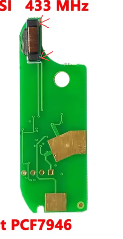

I have currently a non remote key that works and a remote key that does not start the car, hopefully the issue is just the transponder coil and if so:
I will buy a set of used locks that comes with one remote key,
Change the internals of the remote keys or change the blades
Have a new non remote keyed and change the transponder from the old one
After this, from what I understand, I can blacklist the missing remote on MES, is that correct?
The none working remote
Solder joint fail here
PCB get cracked same place
Long shot, but is a fairly common fault
I will open the key and check it out, thank you.
