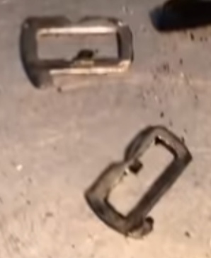

If someone has tried to force the lock, it could be bent. If it is made of brass, it will not like being straightened, as the first bend will have work hardened it. With it removed, the lock is a little less secure, but as no-one really tries to pick such locks, that will not matter much.
If miine, I'd try to wriggle it out and straighten it, but that might take a lot of hours, and a significant amount of choice language.
I don't see why not as long as the key fully inserts
If I have an ignition barrel that will not turn because the key worn
I either remove the blades completely or file them down and never had any bother
I have repaired quite a few locks but never seen one that's jammed like this, could it be super glue?
I’m not sure if there is a spring mechanism for each blade which has may be got jammed. I can neither push or pull the blade out, it’s solid with a tiny bit of lateral movement.
If you're only going to use it in the airbag switch then filing it down to allow the barrel to turn should be fine.
There are definitely some Pandas around which have had them all removed so any key will work (presumably from breakers, and it was not possible to change the barrels over... or couldn't be bothered?)
It's no big deal or hurry as it's now only going to be used fitted back in the passenger airbag
As there is some movement you could try leave it submerged in a thin oil for a few days
If you take the key out do they all stick up the same amount
All the other blades should be sticking up with the key out.
