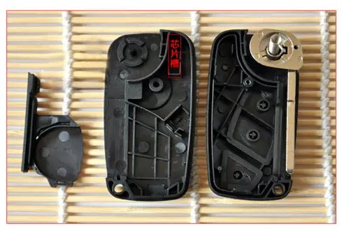

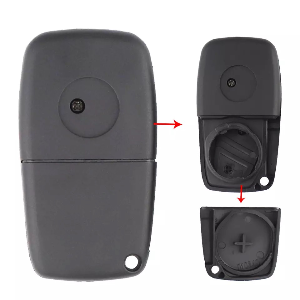

You did order the correct shell, you want the one where the battery is under a separate cover, and not the one where the battery slots in the side
They are not compatible AE sell both types listed for the Panda
This is the same as yours
This is the wrong type and will damage the PCB

If it's the shell that splits in half its this one
https://a.aliexpress.com/_EHeHKqG, that's the normal one here in the UK is don't know if Israel used the same, it's normally all you need
