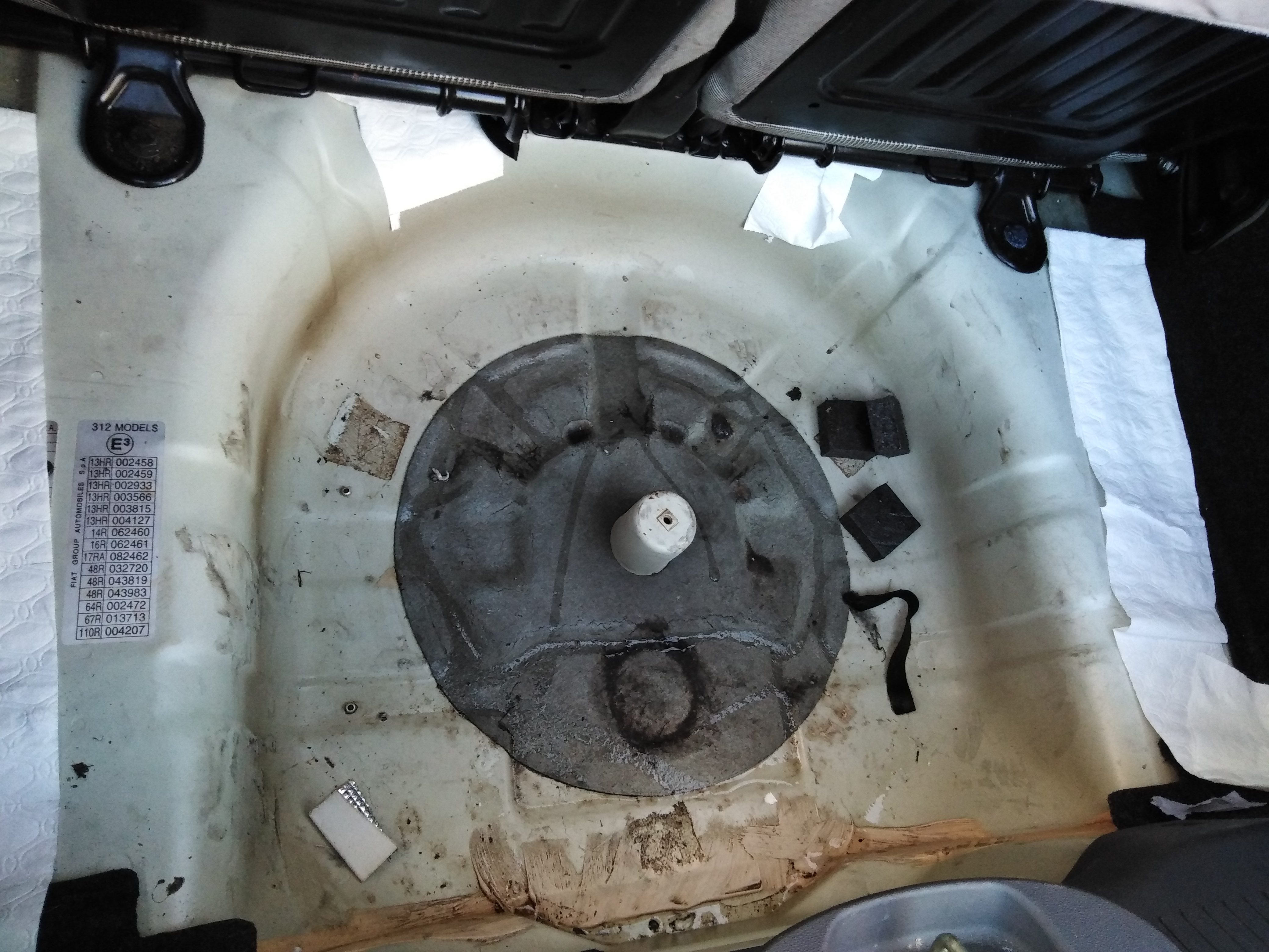

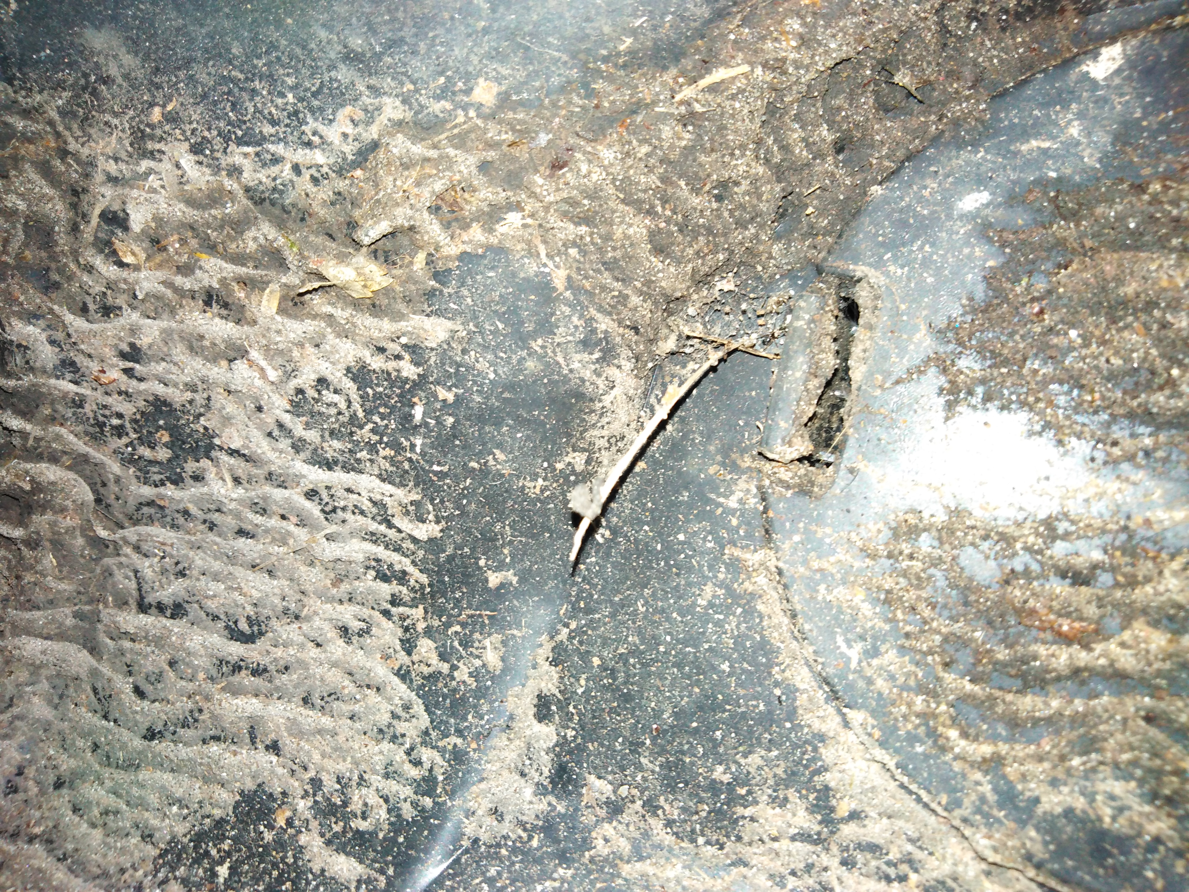

I have three suggestions based on experience with Fiats.
1. Underneath the back light fitting of our 2014 Panda all looked well, but there was a hole, all nicely sealed around the edges and painted neatly. Just bad panel fitting and hte boot was soaking. Dealer even gavce us a brand new boot carpet as the original was soaking. Fixed with Unibond 30 year mastic.
2. Bravo had a small leak which was the same bad build quality, all nicely sealed, but a small hole in hte roo to rear quarter panels. Fiex with Tiger seal.
3. 2019 Panda has a leaking rear screen. IOt was OK when new but has started recently. I think its fixed with a liberal application of Holts Seak n Seal.
At least your leak looks a slight one. You should have seen the Panda with the hole behind hte rear lights!!
