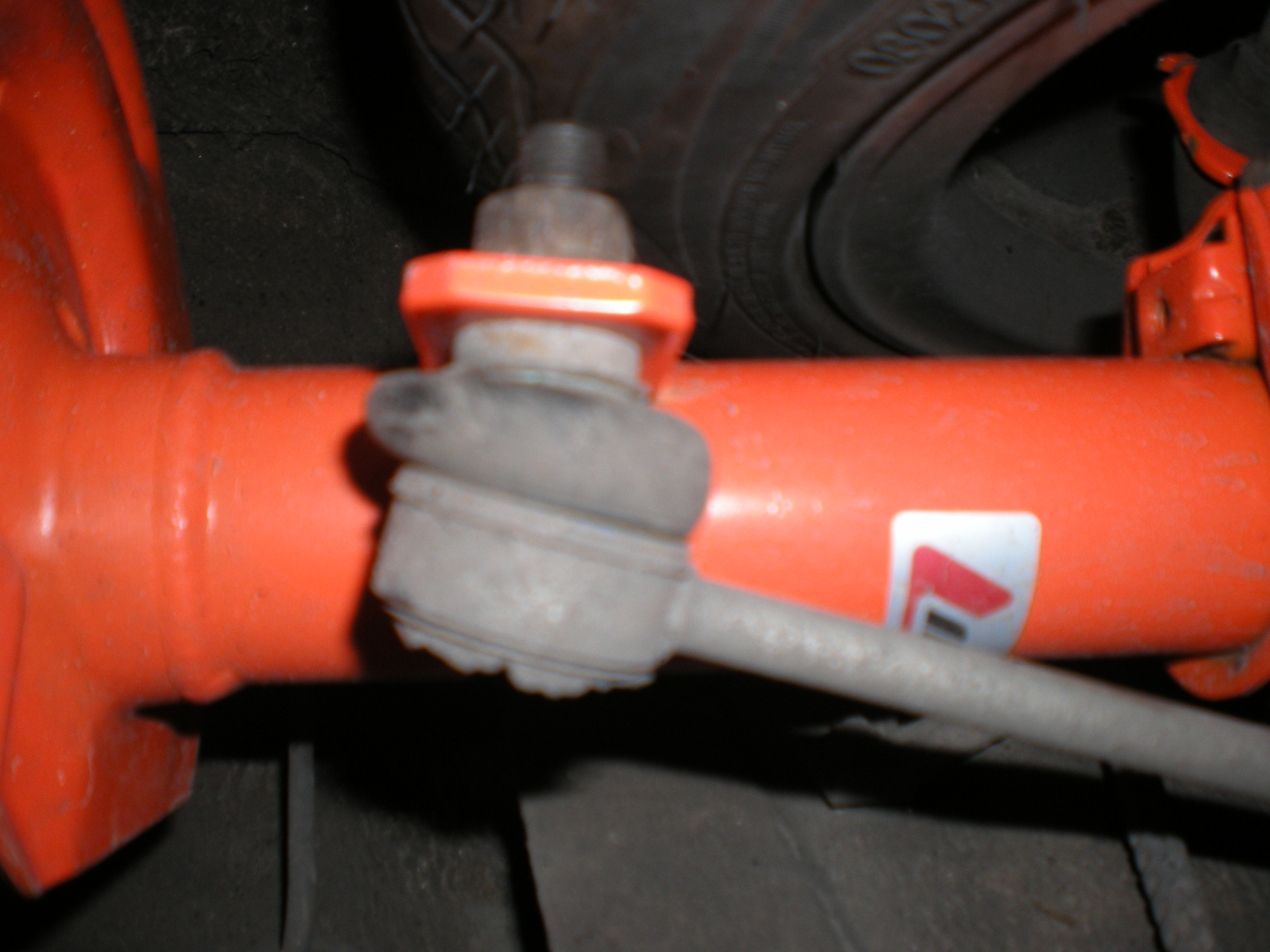

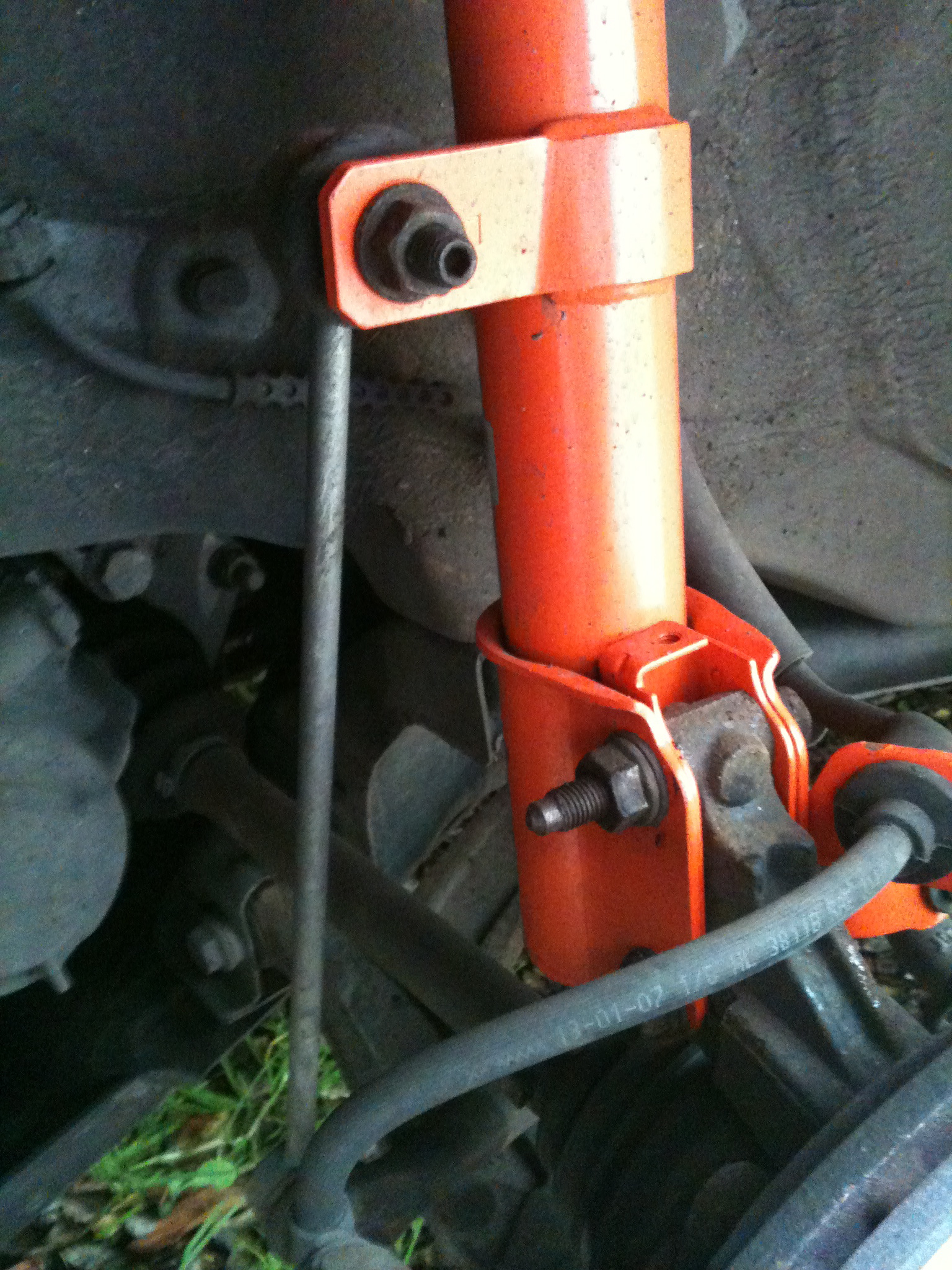

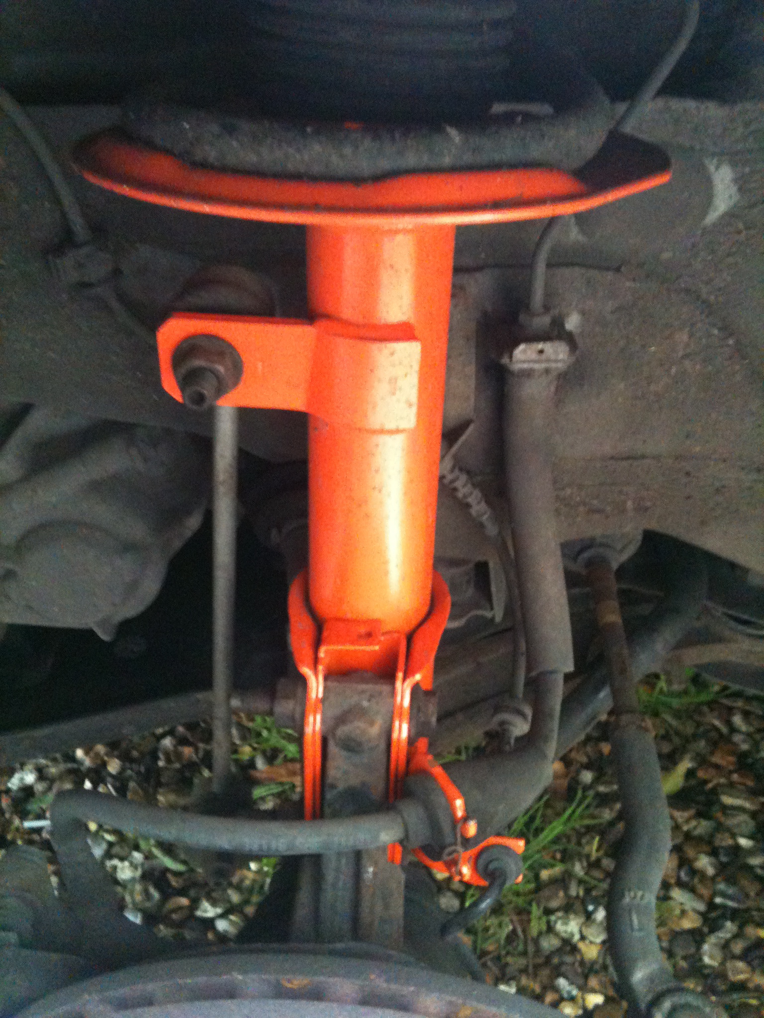

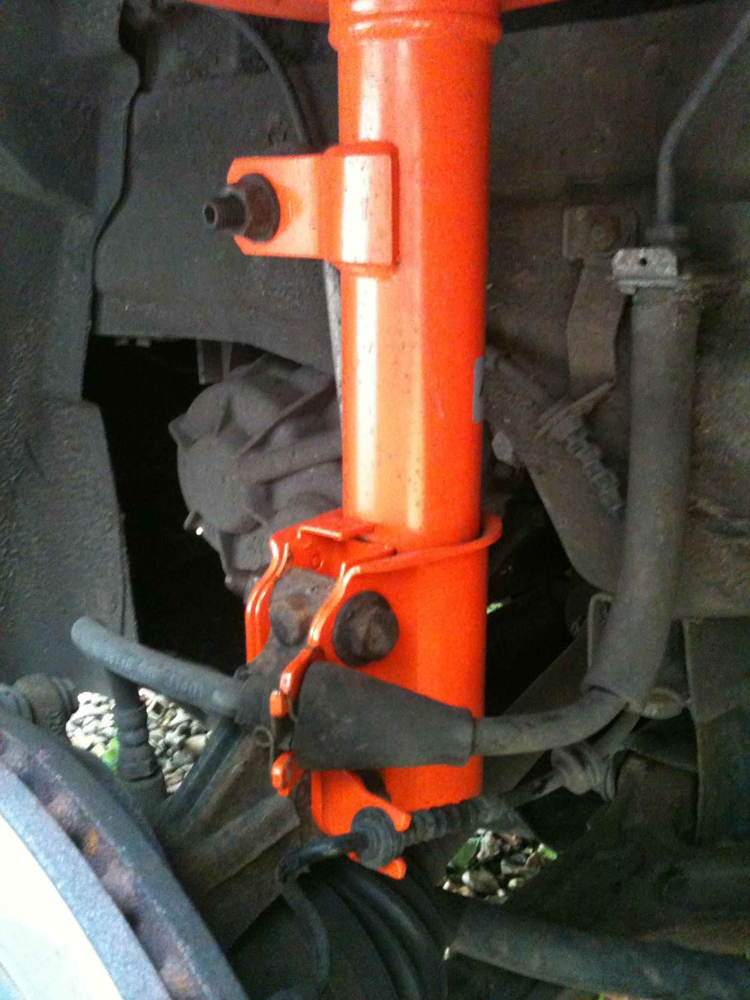

I'm hoping to readjust the rears tomorrow, so if I do, I'll have a look at the fronts and will take some pics of the Koni SRT.Ts on my 07 plate car.
