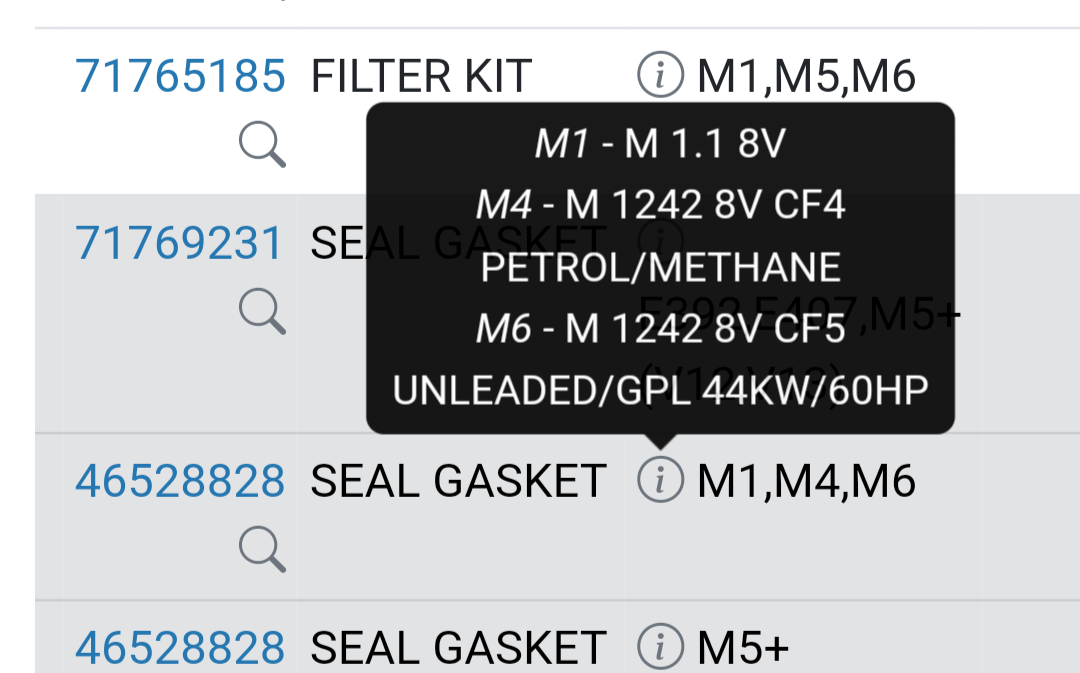

Still not convinced about the airbox to throttle body seal, I'd replace that anyway except they appear to cost 25 quid or more which seems rather steep for what it is. Is that right? Part number is 46528828 if I am not mistaken.

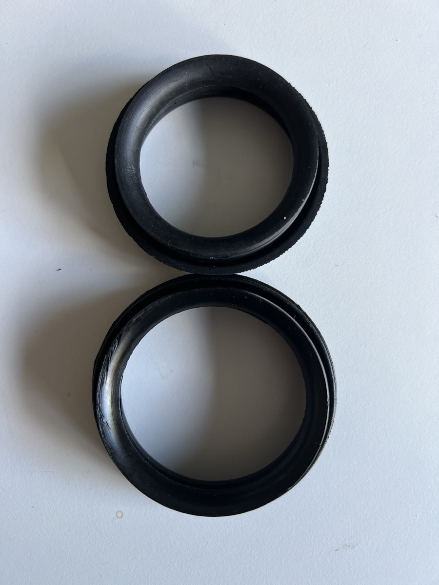

71748095 1.2L doblo fits and cheaper £10
I ordered this item which arrived today but it's much smaller than the one on the car. No biggy as it was only a tenner but definitely not the right one.

I don't understand why it doesn't fit
I thought all all the 1.1 and 1.2 are the same
Except the 4x4 and dualogic

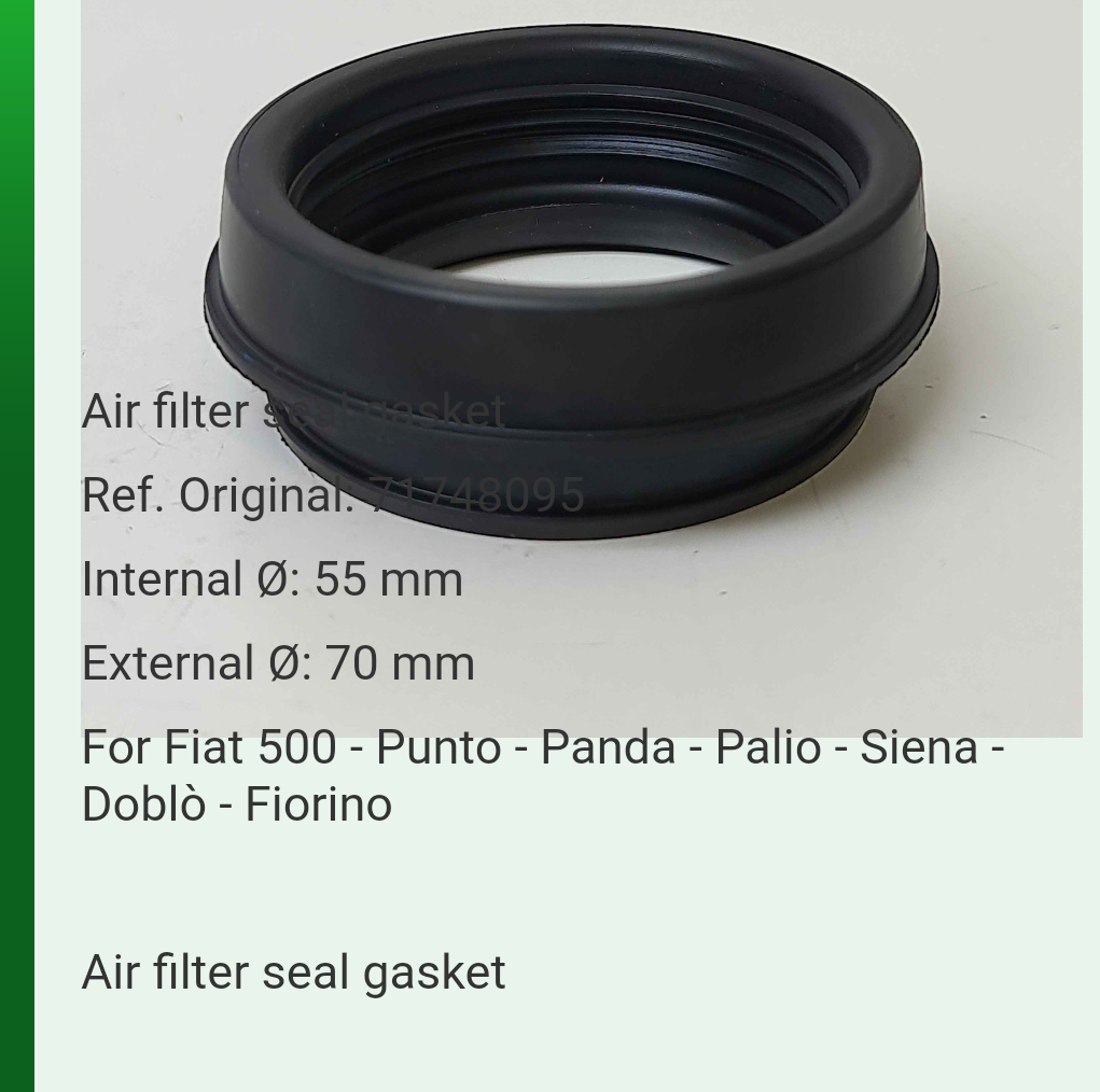

Does the one they sent have a 55 mm inside diameter
It been fitted to a 2004 dynamic 1.2 as well as the the latter 500s susesfully
The part number you ordered shows
55mm on another advert
Something isn't right
But it looks like you been sent the wrong part
Could you tell me where you got the screenshot with the measurements from? I'll contact Robust and send them the link and ask them why their item doesn't have the same measurements despite having the same part number.
