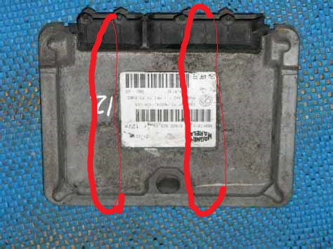

It's likely to be
The wiring loom to the ECU, which often cause the engine to cut out going over speed humps, usually there is either a coil or injector error code
The battery earth strap, which has been known to cut the engine with no error
Lastly the crank sensor, never know this to fail over bumps, but it often temperature related and also often gives no codes
As will a loose battery terminal
Need to try and narrow it down
With the engine running
Grab the earth strap under the battery tray and wiggle the cable
Does the idle change
Try tapping the panel under the keys
Gently wiggle the wiring loom to the ECU does the idle change, don't go mad here we are talking about moving the loom about gently, not pulling it that hard it breaks wires or connectors
People have managed to fix this in the past by cable tying the ECU connector down, save fixing or replacing the loom, you could try this first and see if the symptoms stop
Join a couple of cable ties together if they are too short
Try watching the dials as it happens, does the oil, immobiliser, battery or any other lights come on, does the time start flashing, does the back light on the clock go out

The electrics stay on when the problem occurs, radio, dials, lights everything, no flashing clock either. I poked a little at the ECU cable but nothing seemed to change. The car has been decetly kept and only has about 43k miles so I kinda doubt the ECU has shaken itself loose yet. If I don't have a gear engaged when the problem occurs the car stalls completely as I've said so the appropriate oil, battery and engine lights come on. For what it's worth before issue started to occur I fueled it up Shell VPower, typically it get E10 petrol. Still running on that same fuel now.
