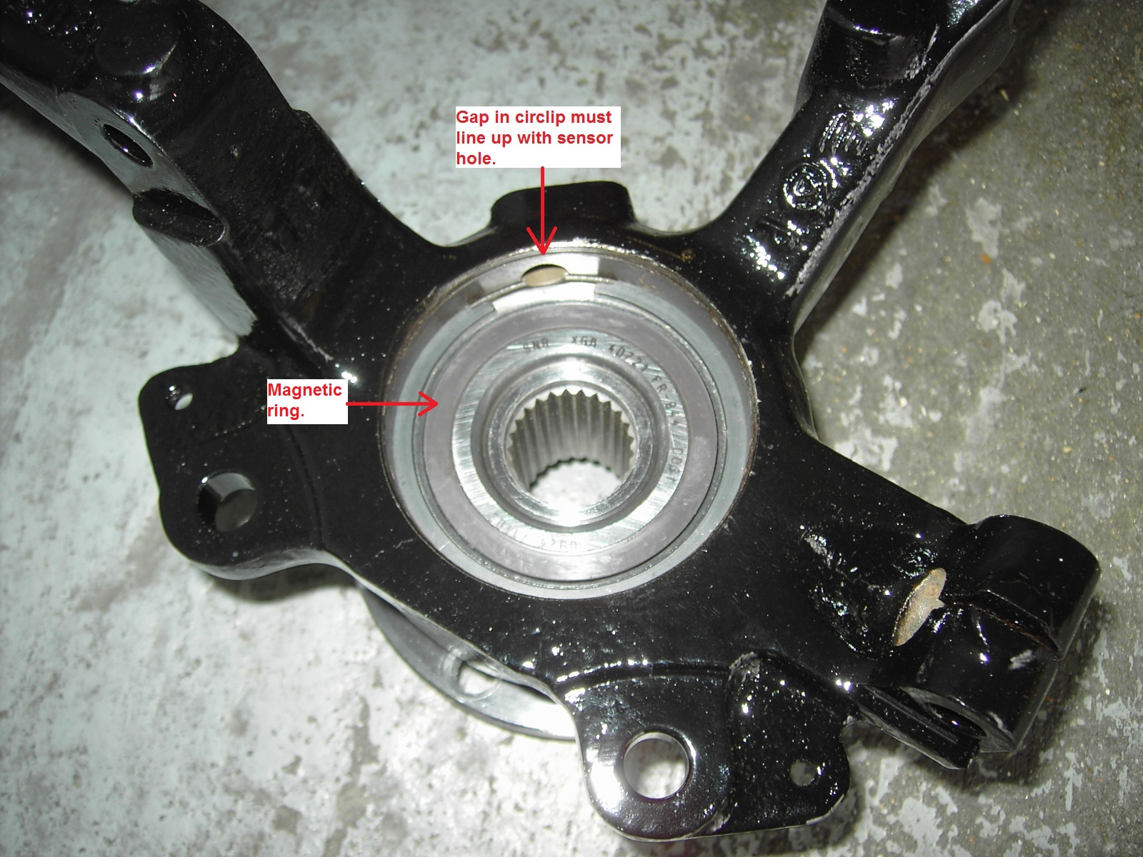

I have just fitted a new wheel bearing on our 2011 panda 1.2 and now the ABS light is on. I was very careful when I removed and refitted it but I was thinking that I may of got grease on it. Its the only thing I can think of.
Any suggestions.

Did you fit the circlip gap over the ABS hole
Bearing the right way around
Hi. Thanks for the quick reply. I think that the circlip may be over the hole. So I know what I will be doing Saturday morning. I've told my girlfriend I need the car for a couple of hours, cant do it before because she uses it for work.
Thanks again for your help. Cars have changed so much since I left the trade in 1981.
