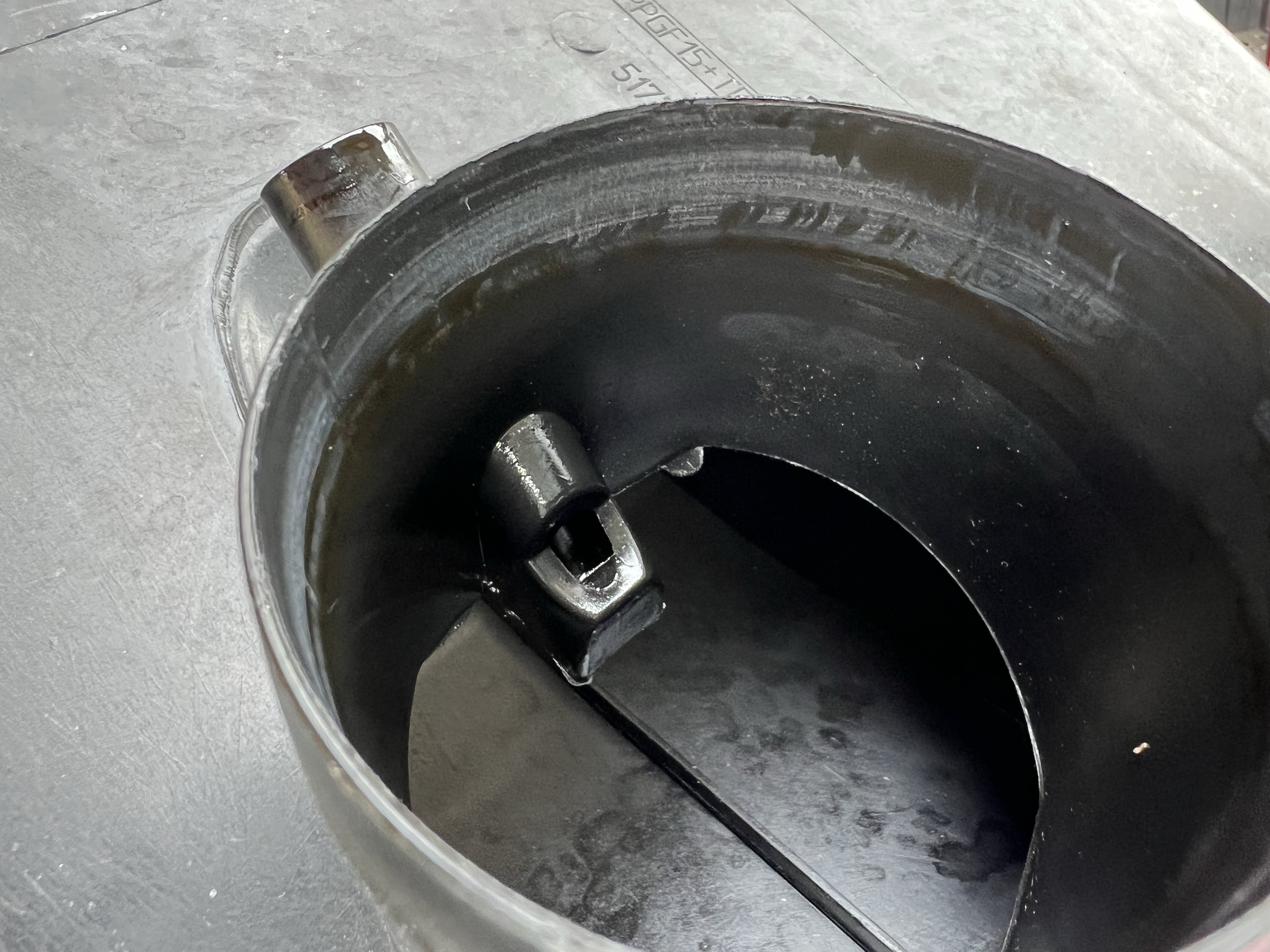

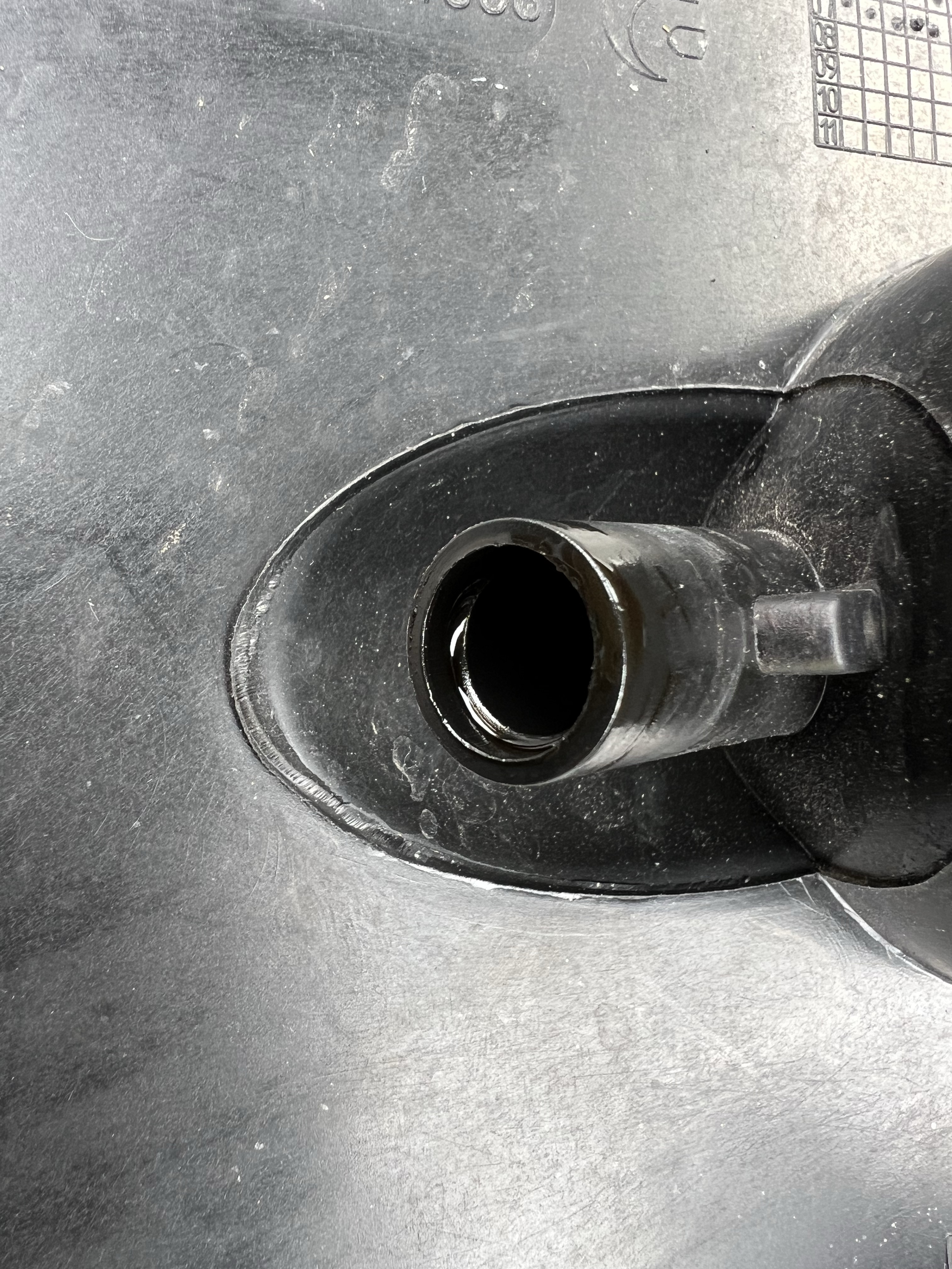

I also see oil where the breather attaches to the airbox, and also inside where the air box attaches to the throttle:

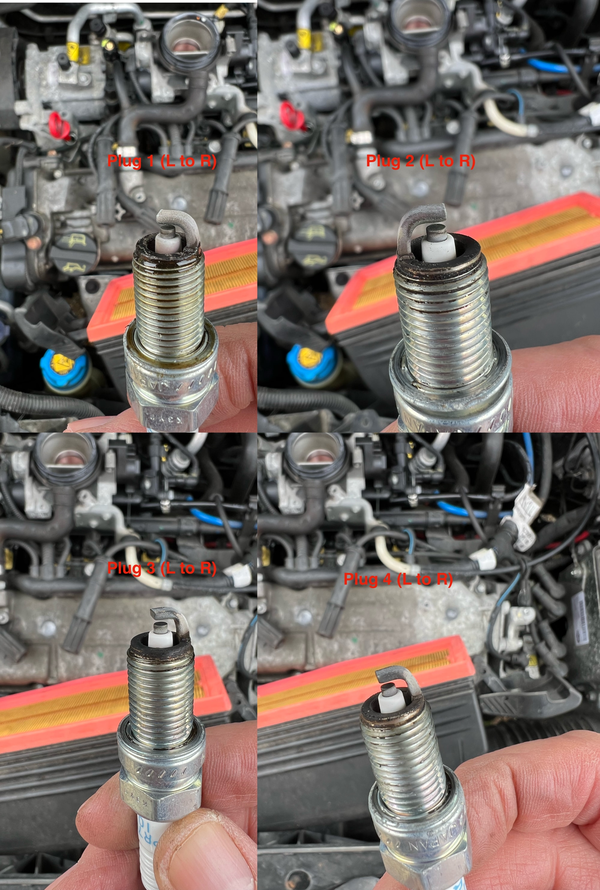

Electrodes are dry
I suspect that just a bit of oil or water that's run down as the plug was then out, the threads are oiled as well
Exactly my thoughts. You beat me to the punch with your reply. There's oil on the threads which couldn't get there from inside the cylinder and an "oily plug" where excess oil is being burnt in the cylinder, will result in a heavy deposit of black slightly "stodgy" carbon around the "business end". I think there's probably oil leaking into the plug recess from either the breather pipe or cam cover gasket?
Could well be from the oil that was present around the throttle when I first started experiencing this, which was coming from the breather pipe. As the electrodes look good, I'll put the plugs back into the car.
They certainly don't show anything much by way of electrode wear so probably fine. Is there oil up the side of the plug or it's HT lead? If so clean and see if things improve. Genuine plugs give very little problem these days but I'm always careful about where I buy as there seems to be quite a problem with counterfeit plugs over the last few years.
No, pretty clean except for the oil on the thread - I've cleaned that. Plugs were from Euro Car Parts in May last year, so quite new and (hopefully!) genuine.
