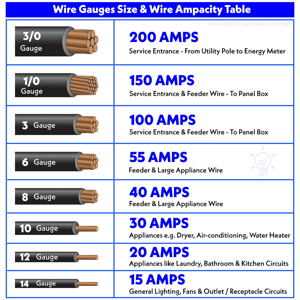

I was ignoring this advice
So often I advise someone to do a voltage drop test under load, and I get well it measures 0 ohms
All these wires measure close to 0 ohms
All these wires will measure battery voltage at the end if not under load
The correct method is to check is via voltage drop under load
As per Delphi and just about every auto electrician
Here a auto electrician, that teaches at a collage
Here's my car with a faulty earth
It's a very simple test, and is 100% accurate at the time of testing, so will catch nearly all cases
If the block to the battery negative is under 0.2V while cranking, take a minute of your life, the gearbox cable is fine, you can just move on
