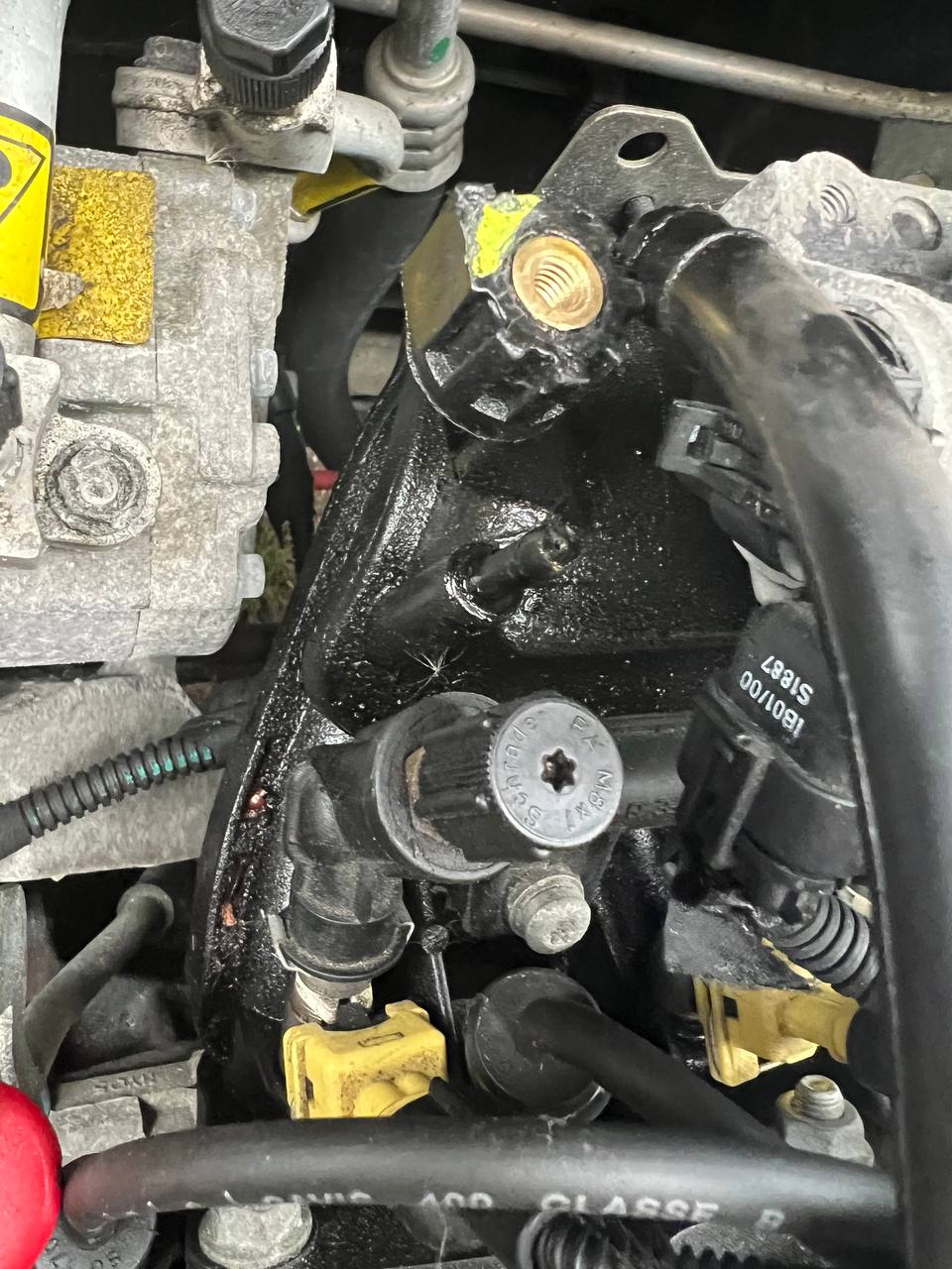

Pulled the air box off this morning and cleaned the large seal between the air box and the throttle body. Also cleaned the breather pipe that connects to the airbox, and the smaller pipe that connects to it.
I notice there's a lot of oil on the inlet manifold on the drivers side - see pic below.

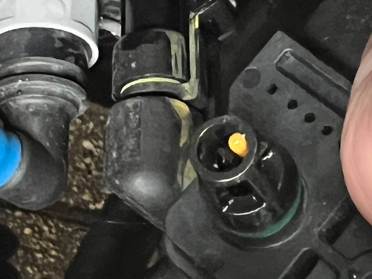

I also feel that the large seal between the airbox and throttle body isn't particularly tight so perhaps not making a great seal. There's oil around the top of the throttle body as well, as per second pic.
I then drove the car and it was jerky again - pulled the MAP sensor, which I cleaned yesterday, and it shows oiling, so have cleaned it again.
Any thoughts? Replace the large airbox/throttle body seal at minimum, I think?
The breather pipe between the cam cover and air filter box, including the small diameter pipe that connects onto the inlet manifold that you show to be leaking, tends to harden with age and doesn't seal onto the stub pipes. Becky was leaking at the wee stub pipe just like you show here. When i removed the air filter the first time the pipe felt as hard as if it was made from metal. I bought a new pipe from S4p as part of a larger order so i could get the discount, and it's never leaked since. If your pipe is still in good order maybe try a wee hose clamp? I've noticed on other Pandas that that wee pipe often has oil around it where it joins the wee manifold stub pipe. Messy but doesn't affect running. However do make sure the main pipe into the air filter housing isn't blocked with "gunge".

The oil around the joints shows it's leaking
It's missing the band's from the ends as well, fairly typical of a car of this age
Should be like this, mine had nice spring loaded clips, so it could just be pushed on and off

I see your is a cable throttle, the MAP on these don't tend to oil up as badly
Here what a fairly typical one looks like, they leak a bit but not wet
