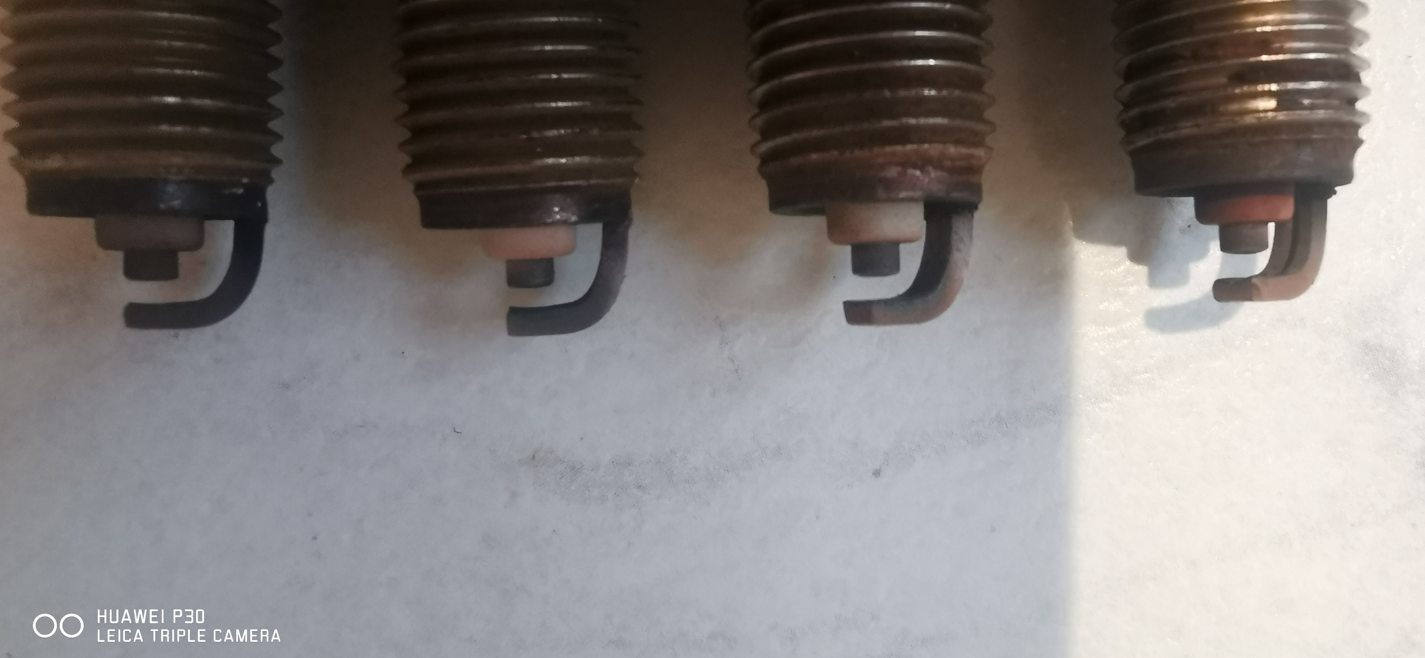

Pull the plugs and post a picture in the same order the were in the car can sometimes be useful

Well it turns out the plugs aren't that bad, well at least I don't think so from looking at them but I'm no expert.
