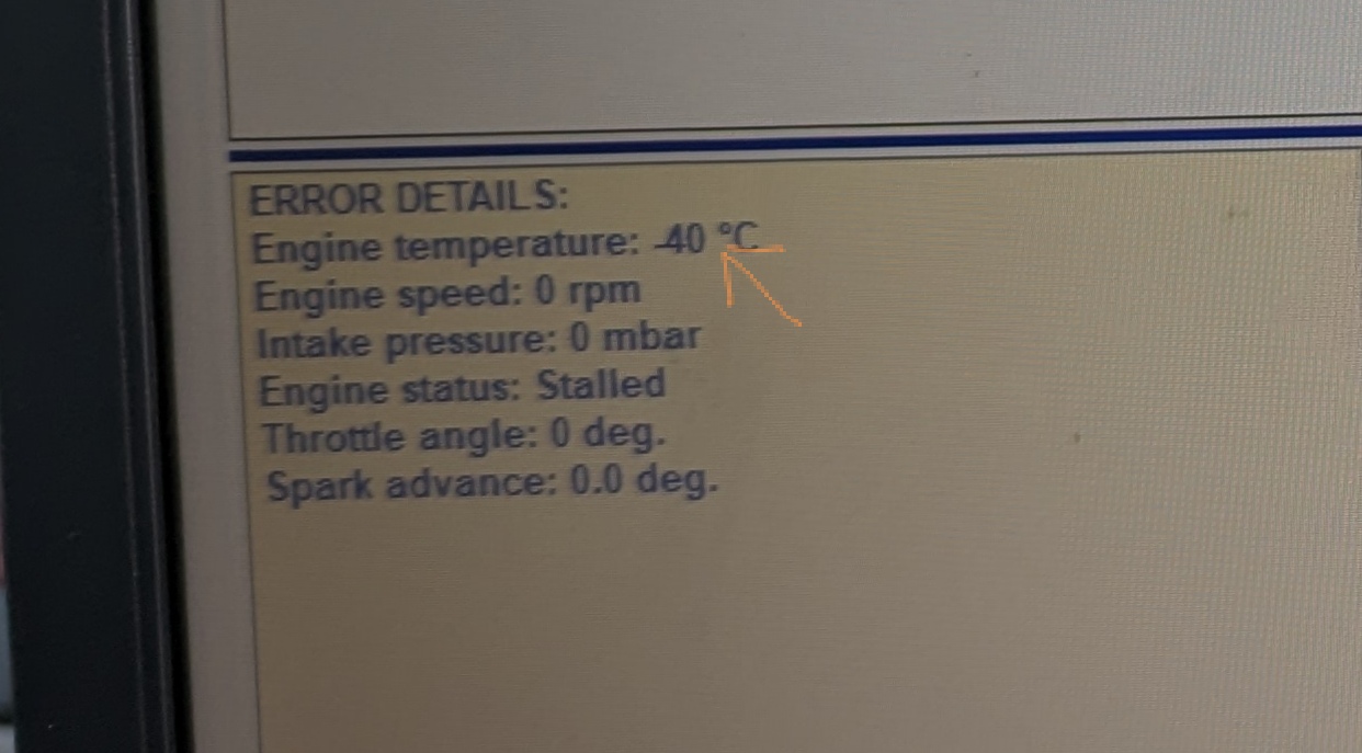

Got a scanner hooked on, panda was ticking over fine while getting this info. Seems like the two O2 sensors were giving me decent enough voltages.
The revs settled down to 780rpm after a few minutes of idling.
Wondering if it's either a dodgy earth lead or a duff coil pack.
Cool
Some good data
Ignore the P03??
They tell us there is a problem but not what it is
-40 on the coolant sensor
And
Post CAT single dropping out must be diagnostic
I take it was running fine before the tree
