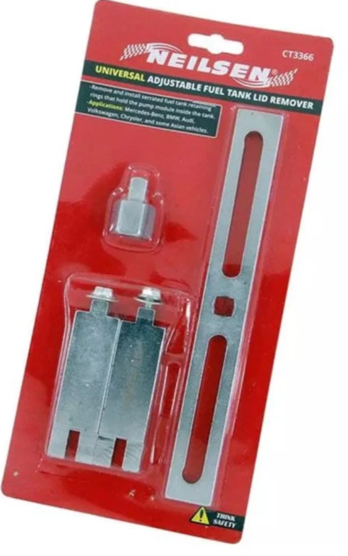

The device you recommended was up to the job but the fins on the actual lid are really small I agree possibly the extension bar could be the answer the prongs on the extraction tool when in place are slightly to wide for the fins when in place so I am thinking of setting it all in place and putting a slither of metal in place to take up the slack then see what happens either that or send the new pump back and have a few drinks instead 😆

I bought this it's made of solid stainless steel and it wouldn't budge it I'm loosing the will to live
I bought this tool at #16 some years ago can't remember where, to do a Fiat Doblo1868cc Diesel and it has worked on all the other ones over the years,
The beauty is it has three legs so it doesn't tip and you can lock the jaws at the set size, then I use a 3/4 drive bar and socket.:)
Yes I was thinking that 3 is better than 2 I will have a look around for something else or I might send the pump back as it's only the float that is faulty
