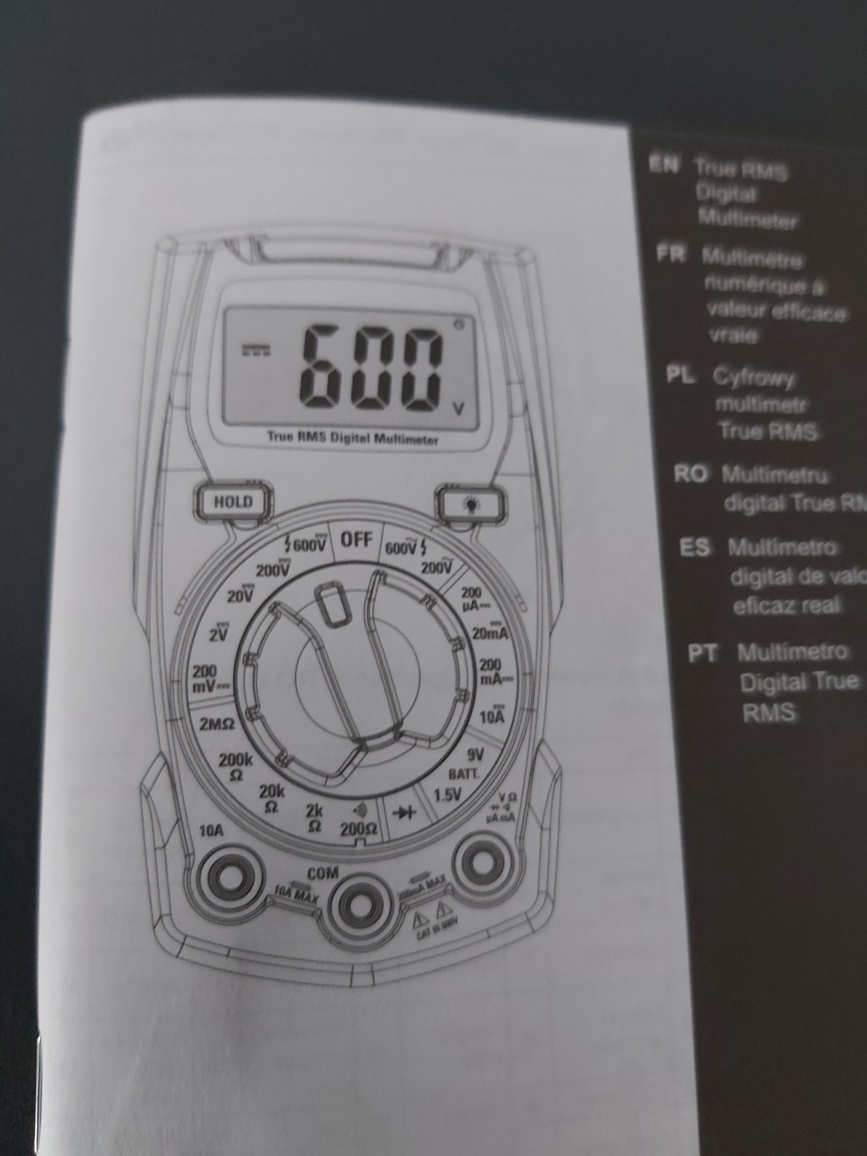

Ohms or if the MM is autoranging then you don’t have to set it if not try one of the ohms settings until you get a reading.What position do I set the multimeter to I'm a complete novice
Post a picture of the multimeter so we know what we are dealing with it's likely to be marked 2K or 2000, ohms or ΩWhat position do I set the multimeter to I'm a complete novice
Thank you I will reply tomorrow with results (if any)
