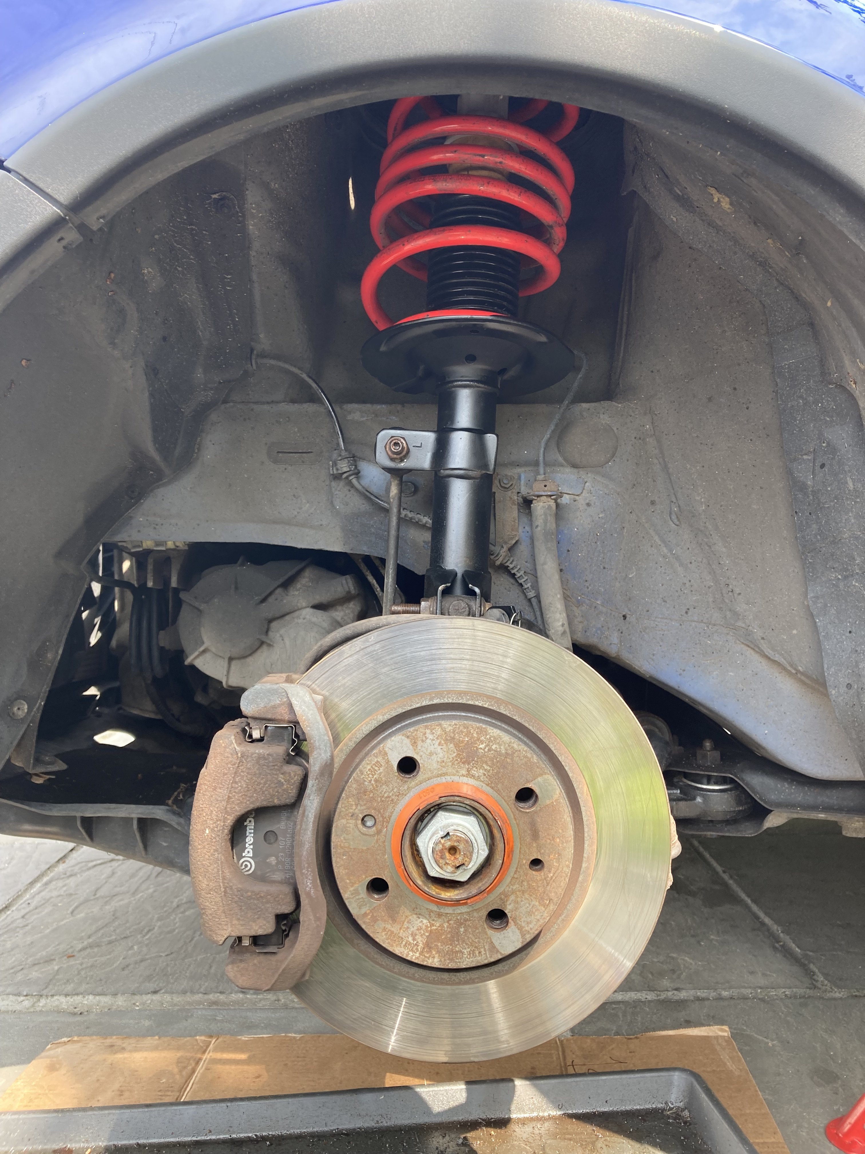

I understand what you say regarding the Upper Drop Link Mount. The Upper Mount on the Bilstein (i have fitted) is in the same position and angle as the original Fiat Shock.
I have included some pics.

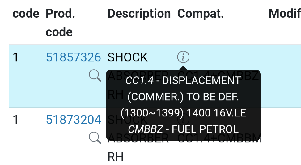

Fiat parts catalogue show unique part for 2006-2009 and 2010
As does shop4parts

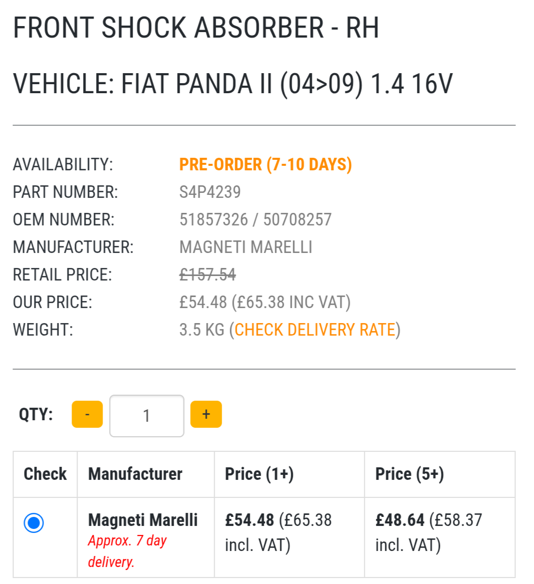

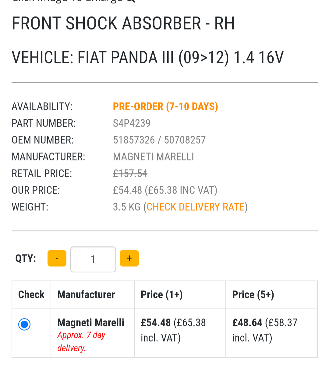

I looked up your Magneti Marelli S4P4239 which is listed on Shop4Parts as Front Shock RHS. The picture they show is a Rear Shock.
The Label is still on both my Original Shocks. When i contacted Fiat Ireland, they said the original Part Number (in the pic) is updated to 518 57 326.

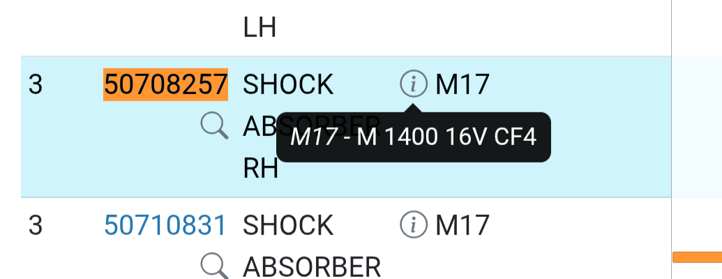

When you check on eper and drill down to the 100hp it gives 2 part numbers for the drop links, 51856872 is the drop link with the fittings the different way round and are compatible with ‘electric steering’ if you click on the ‘E112’.
While 51856873 are the same way and show compatible with 16v when you click on the ‘M17’
I would say it would be more the 51856873 part for the 100hp so the one with the fittings the same way looking at epar.

If you look at Pic 5 you can see my Drop Links have the fittings on the same side (as I mentioned above, they are original drop links).
I’m starting to think these are the correct ones for a standard 100hp, I have the other ones fitted (where they point in different directions) and I get rubbing on full lock with them which would explain that.

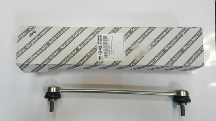

And
and are designed for this drop link
Any aftermarket shock that also fits the 1.3D has the more central drop link mount which will require the drop link with the ball joint opposing each other
This type mount
Requires

Camera angle can be deceptive but it does not look like the drop link is at the right angle and would benefit if changed to one with opposing ends to move the bottom a cm or so closer to the wheel
No big deal, when the stabilisers isn't vertical to the bars movement, body roll will be increase, it will be none linear, and probably puts more pressure on ball joints reducing its longevity
Of course I am going of photos and the information given, so could be wrong
