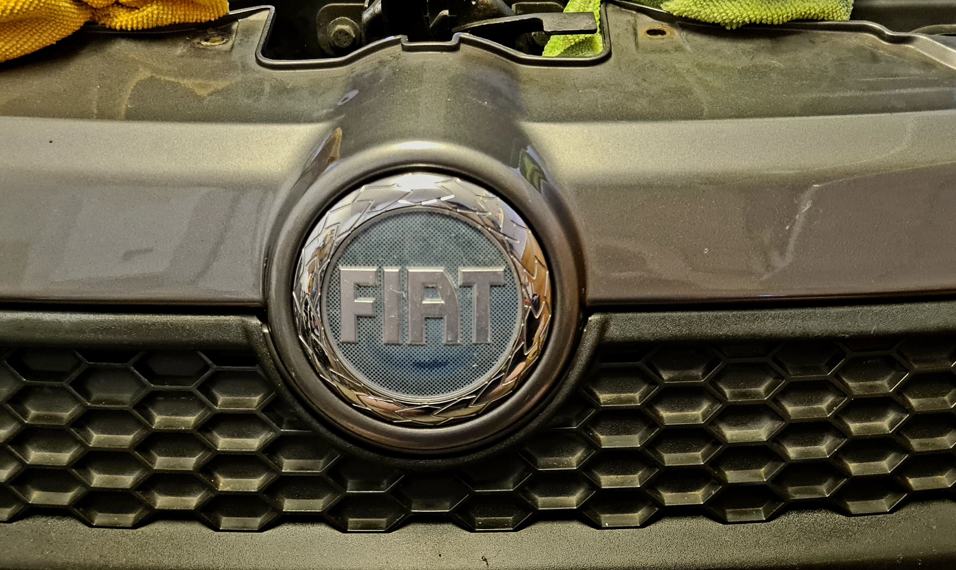

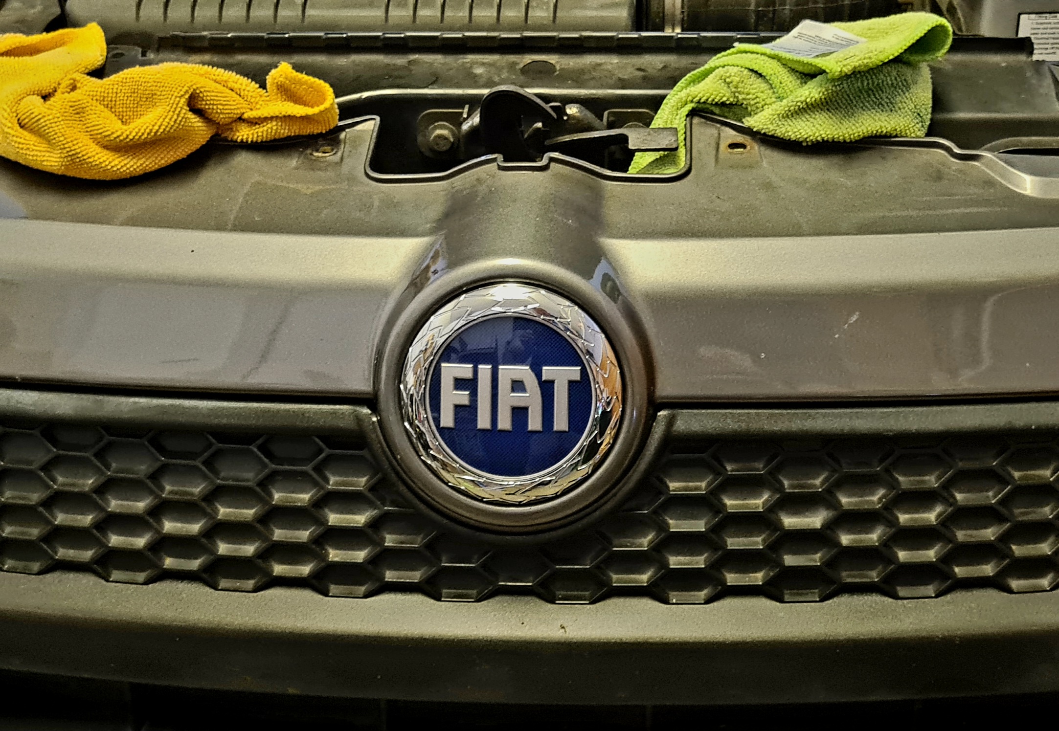

Just managed to get mine done today without taking the bumper off. I pried the top of the bumper up slightly and wedged it open with a couple of microfibre cloths, which gave me just enough space to get my left hand in. From there I could pass myself a small socket wrench (8 I think) and carefully manoeuvre it onto the nut. It was very fiddly, but I managed to work the handle round bit by bit and the badge came off in the end.
I’d agree that removing the bumper is probably the smarter and more straightforward job. This is an 07 bumper so probably not as flexible as it once was, but if you’ve got slim enough wrists (and a bit of patience when you drop the washer) it can just about be done in situ.
Before and after:
Before and after:
Looks so good with a new badge!
