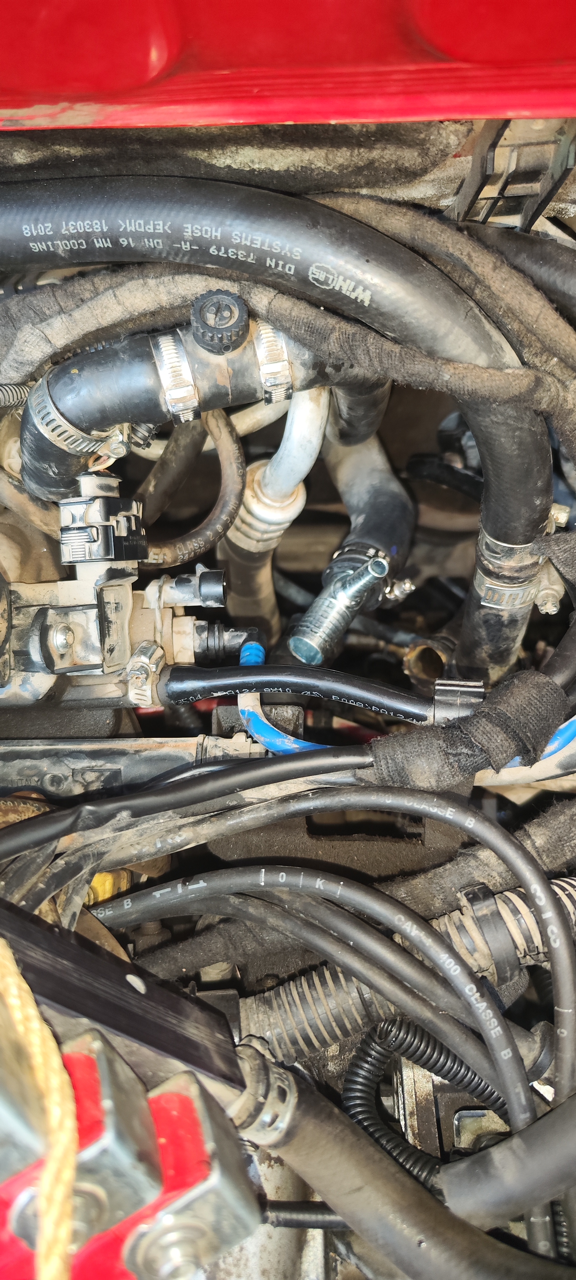

I have an idle problem in my car. No malfunction lamp is on. I'm checking the electrical installation.
I had to remove this hose while checking. It has cracked because it has hardened over the years.
Could this hose have something to do with the idle?
At this time, the fault light started to come on.
Is there anything that needs to be done to calibrate the throttle valves after removing the battery?

You have a problem
It's nothing to do with the breather pipe
It sounds like it's running on two cylinder at low revs
When the engine is cold, if you accelerate hard is there a knocking noise from the engine
Try this test post 17

I've checked all the wiring of the injection system and can't find any electrical faults.
They run fine without the airbox and pipes connected
I see an early engine, cable throttle and LPG
Is that factory LPG
Read the code would normally be the first step, any chance to borrow a reader
The reader in my hand is interestingly not connecting to my car.
I'm considering buying a Creader 3001.
Unfortunately, it is not the original LPG of the factory.
This complicates the electrical installation as one wire from each sensor is combined. I also check and secure the cables and joints that I can reach.

Take each spark plug lead off one at a time
See which if any make it worse or no difference
Yours sounds like it's on two cylinders at 900 rpm

I just removed the spark plugs one by one. I saw and heard sparks in the pipes. Some cylinders are not affected at all, while others are very affected. I don't understand this part yet.
I disassembled the IAC. I took the video before copying it. It was quite dirty and greasy inside. I needed to do some cleaning.
After cleaning and assembly. I started the car.
I'm currently idling around 800rpm. The car does not stop. At idle everything is fine.
However, when I suddenly release the accelerator pedal, the car stops working. It stops when I suddenly give gas and pull.
The ones that have no effect are the ones
Not producing any combustion at idle
This needs sorting first
Spark, fuel, combustion
If it cylinder one and two that make little difference I would go straight to a compression test
With engine cold, wet the exhaust outlets stubs and start engine. Spark plugs fire in pairs 1&4 and 2&3. If one coil is miss-firing, you will see those exhaust stubs remaining cold for longer that the other two. You can prove it by swapping the coils and repeating the test. If the cold stubs move, you have found the faulty coil.
HOWEVER, when one coil fails, the other won't be far behind and a pair cost just £25. Swap the pair and be done with it.

You didn't say which cylinders made little difference
If it's one and two
I suspect you will have
A compression test is the next step to save wasting any time
