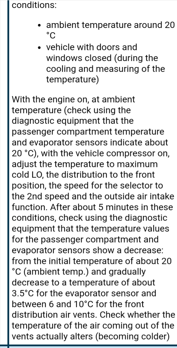

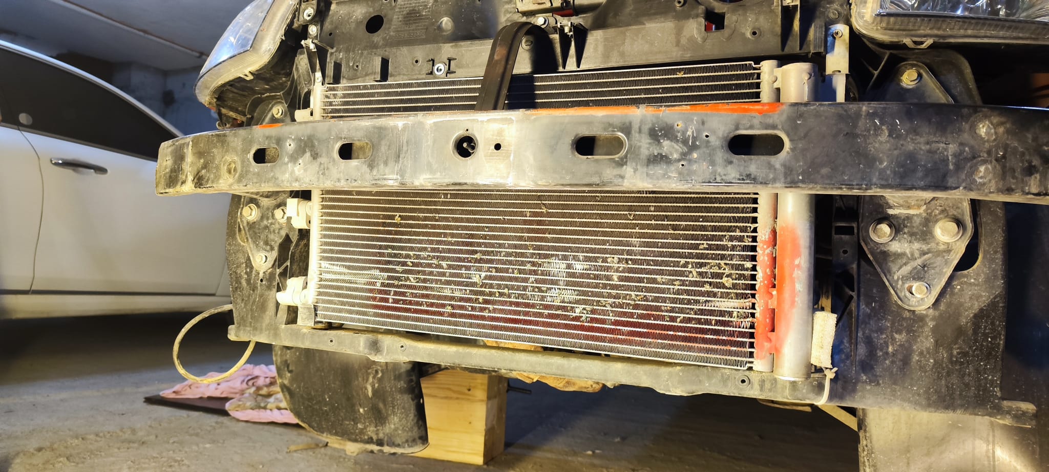

Hello, the weather forecast is around 35 degrees.
My car's air conditioner blows air around 18 degrees at idle. When I travel at a speed of 70-80 km, the lowest temperature I see is 12 degrees.
I removed the front bumper to organize the headlight installation. In the meantime, I'm thinking of cleaning the evaporator with chemicals. If there are testers, can they share their temperature values?
Since the engine of the car is not very powerful, I do not have high expectations.
