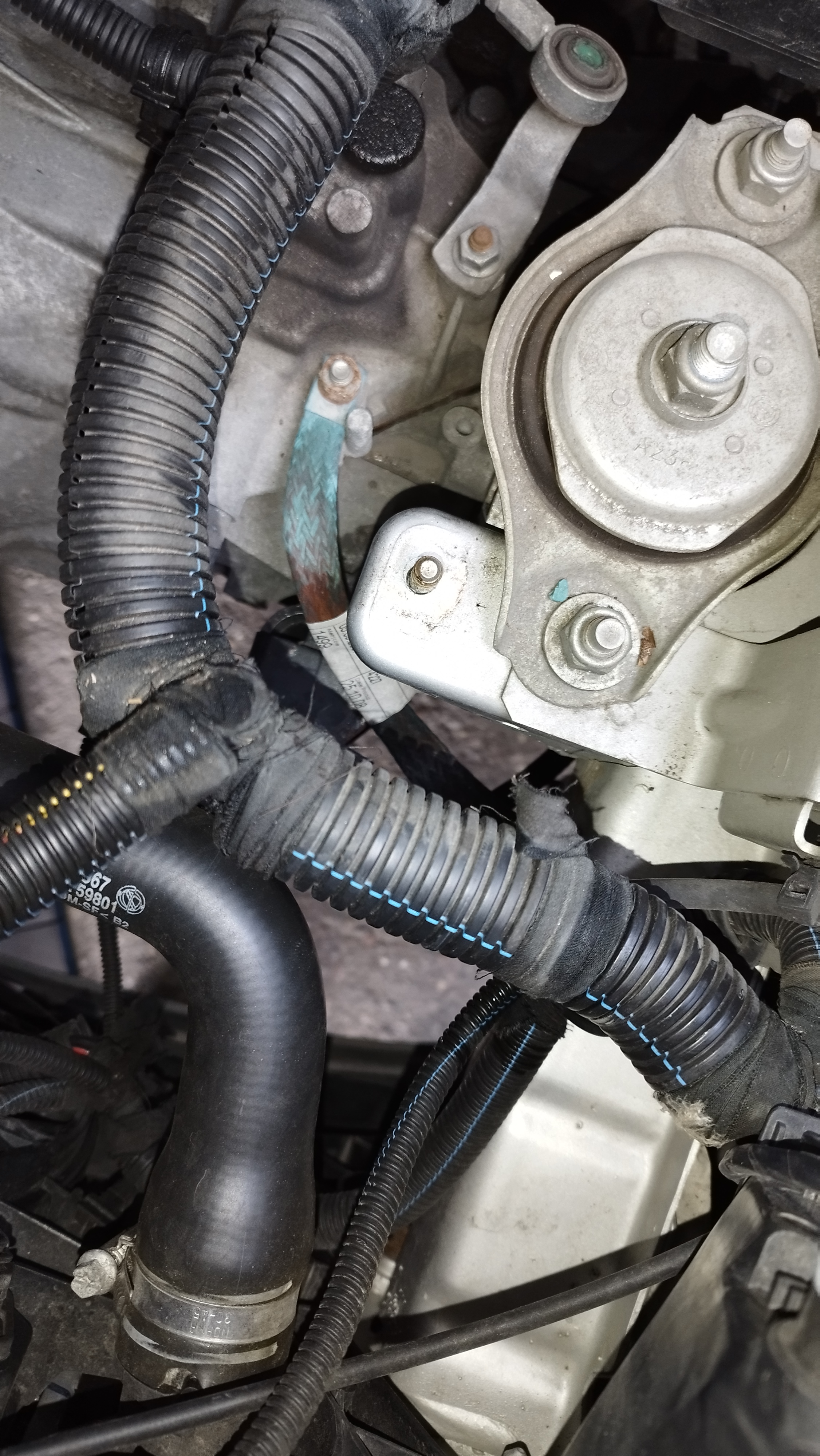

Earth cable is sort of green and oxidized. I do not know if it is okay but instead of replacing it, i will clean it and i will add another new earth cable and connect it to gearbox. (i saw something similar in one youtube video.) I tried to find earth cable but they are really expensive 15 Chf for simple earth cable so i will improvise with thicker spare cable that i have and crimp heads myself. I hope it works.

Earth cable looks okay
Well much better than mine
A good coating in grease and it will probably out last the rest of the car

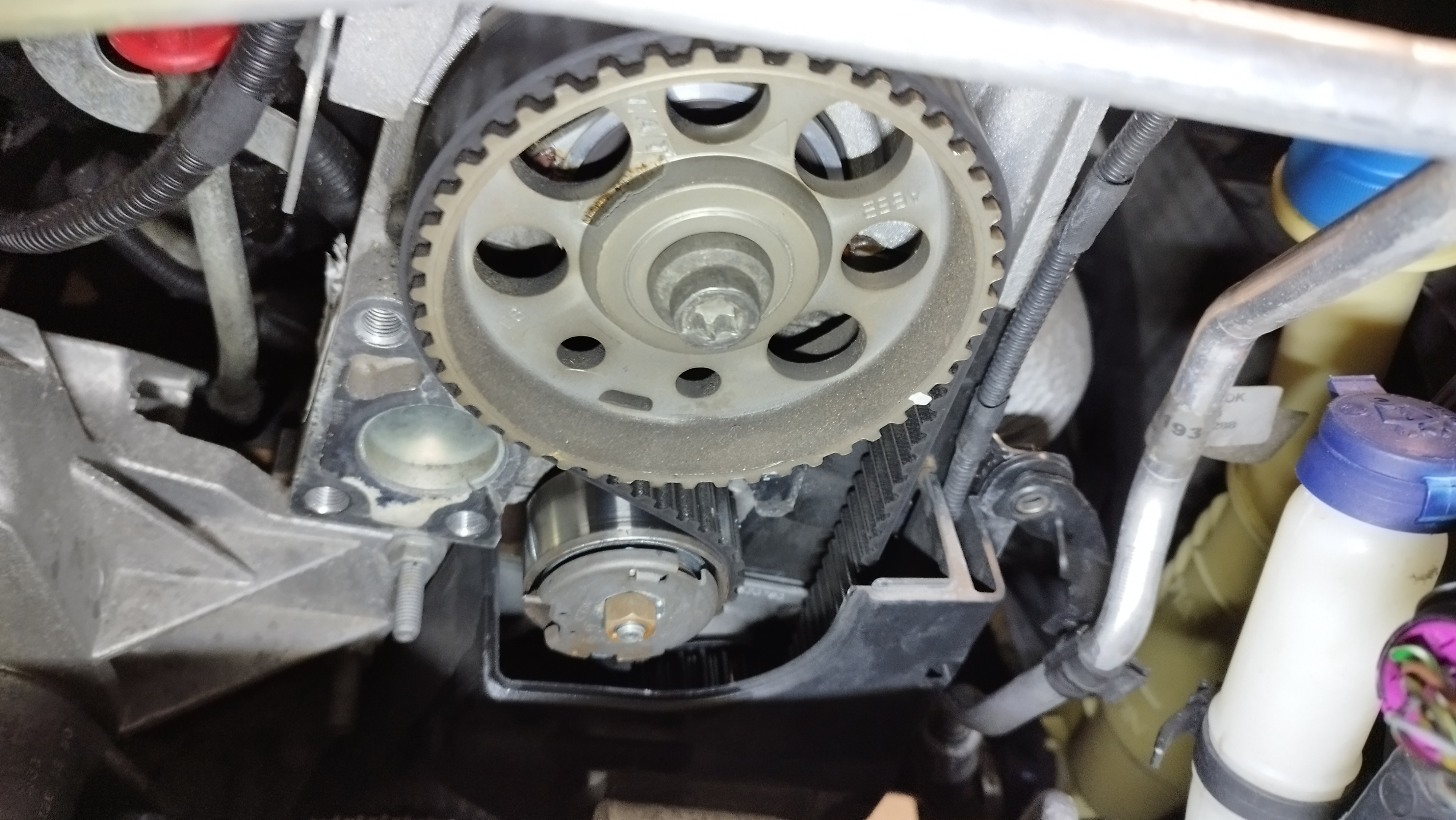

Today i tried to replace belts and find out if i can fit backlight in the luggage compartment.
I removed the back carpet and find a factory light connecter already in place. I will buy suitable light for it but it makes 0 sense for me to crate a luggage with microswitch so that it detects if it is open or closed, with light cutout, connector already in the loom and carpet with cable cutout and NOT putting a light.
I replaced the auxiliary drive belt for clima and alternator. It was cracked a lot.
Engine support mounts were pain in the a... to remove, i could not fit braker bar due to limited place, only shortest 15mm socket fit but i could not leveraged it and had to use small ratchet and big pipe and even with that it took considerable amount of force. I might have ruined the ratchet itself as well. it did not sound crisp afterwards.
I tried to remove the 3 13mm bolt on the crankshaft pulley but the engine turned, i tried to block middle 15mm but even with my thinnest socket i can not fit 13mm on the bolts. I tried to put car in 1st gear but engine turned again. I could not find a way to remove it and open for suggestions. Time was getting late therefore i fixed everything back together. Timing belt does not have cracks neither outside or inside as far as i could see. But it would be great to change it and learn it as well. If you people could help me with crankshaft bolt removal i would like to give it another go.
Other than 2 bolt i could not fit the torque wrench on the engine support bolts and had to guess by hand. I hope it is tight enough. I torqued other 17 and 15 mm on flexible mount to spec (50-60Nm)

Loosen the the pulley bolts first with the wheels still on the ground,
Thanks for the answer. I only lifted the front right wheel and removed it. Left wheel was on the ground and gear was engaged, it turned nevertheless. I will try your suggestion as soon as possible, i doubt it will be easy because room is very limited
What year and engine was it you bought in the end
There's three different timing methods
Two for the engines with the square oil filler cap and one for the engines with the round filler
A lot of the information online is either wrong, misleading or missing some vital information,

Round cap is an evo2 engine
They are supposed to be timed like this
However the camshaft pulley bolt will be very tight, there is a risk of damage unless you have access to the a impact wrench capable of 300nm and the pulley locking tool
The belt will not fit while the crankshaft and camshaft are locked, you can not pull the left side tight enough
This is my car is a year later with variable valve timing but the principals are the same
I wedge the belt on the crankshaft pulley with a rag pull the belt up and mark the pulley and belt
Release the camshaft and turn anticlockwise one tooth
There are other ways
It can be done without using locking tools or taking the valve cover off by making your own timing marks
Thanks for detailed answer. Do you mean the central 15mm crankshaft pulley bolt or surrounding 3x 13 mm pulley bolts for (to drive belt for clima and alternator)
i have no intension to remove central 15mm bolt but rather 3x 13mm bolt to access timing belt behind on the tooted gear. I read that it is only 25nm and should be easy to remove but engine is turning when i try it with wrench. I saw someone pushing a screwdriver in to the flywheel teeth through the hole between exhausted pipe and oil sump. I am not sure if it is risky but if i could not manage to loosen them with the wheel on the ground as you suggested i might try it.
