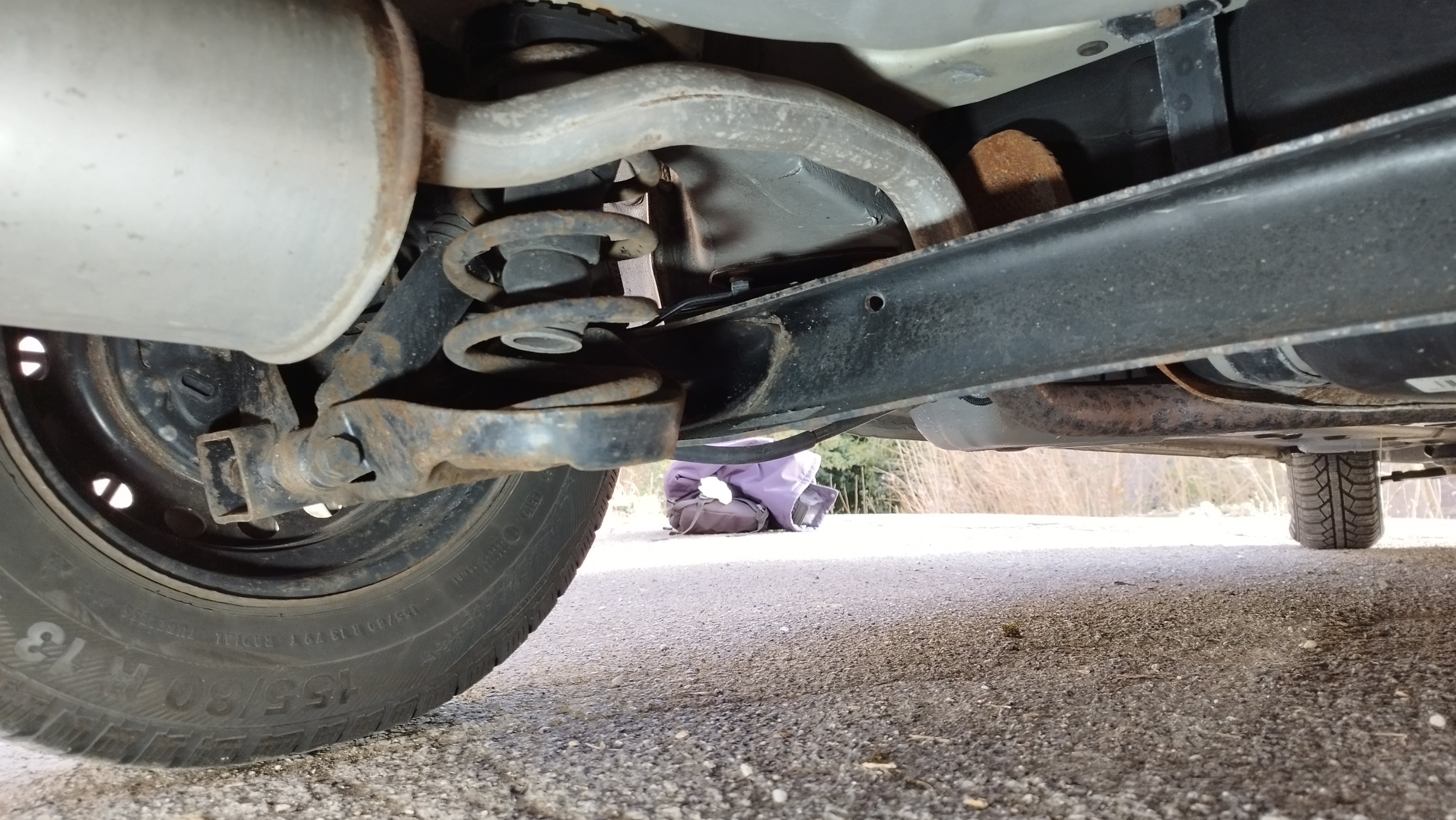

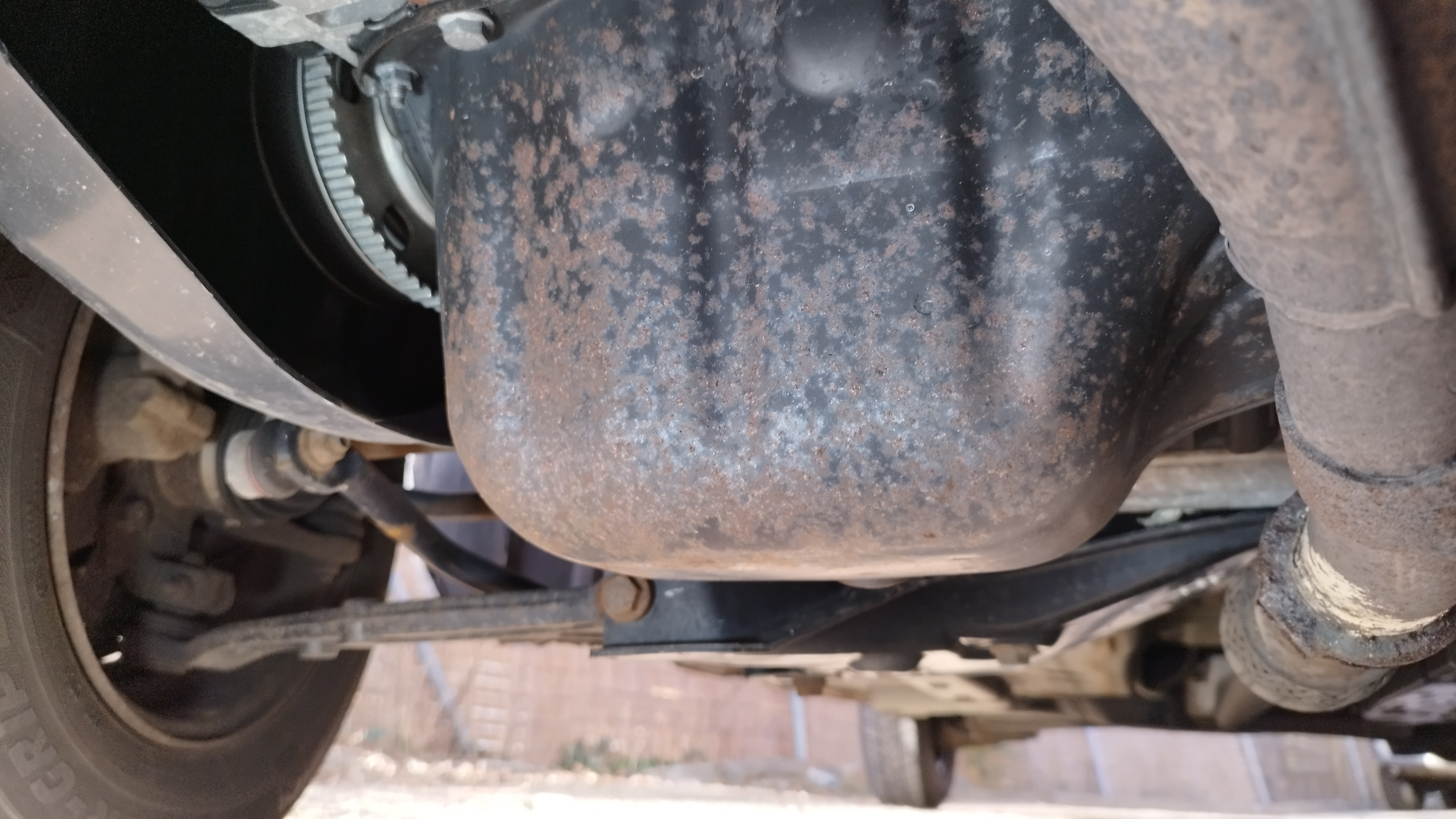

Hello Everyone, i am looking for a Fiat Panda 2010 with 65k km, interior is in really good condition but the underside makes me little worried. There is oily resiedue around the oil pan but it looks semi-old and before and after test drive i did not see
any new fluid on the oil pan or around the car. Exhaust is rusted out a lot and back axis are also rusted, I am not experienced with the rust repair so best i can do clean it and cover it with rust converter and spray or buy new pieces and replace them.
I do not know how bad they are but if possible please look at the photos and give me suggestion about it. Should i proceed forward with the buy and change it by myself or should i avoid it?

Today i looked one last fiat panda
1.2 2009 90t km with clima, singular backseats, 7/10 interior 5/10 exterior
Front of the sump is really rusted but i couldn't see any oil leak around. Back of the sump is great condition.
Back axle is not that rusty. MOT is from last December. So it is already good. The problem is left front door is jamming time to time. I do not know what is the reason for it.
Some small problems as well. But the biggest is he told me steering wheel red warning light comes time to time and when it comes the wheel becomes really heavy. I could not reproduce the mistake during test drive and there is no stored code in ECU.
Battery voltage is around 12.7 v. I do not know if the battery is bad or not.
It is the best panda i have seen apart from cosmetics defects all around. But i am little worried about the steering wheel problem. Is it hard to diagnose and fix? I read it might be cause of weak battery but he told me it could be due to faulty sensor.

Car looks good for a 2009 Panda - in the UK they would usually look much worse underneath at that age.

Drives door will probably just need stripping and cleaning, maybe realign the catch plate, it's unusual to have problems with the drivers, it nearly always the rears
Worth checking around the A and B pillars for any kinks from crash damage

Well done @kavil on getting what looks like a good car - so much less rust than cars here in UK & Ireland :)
Good news is, main bodies are galvanised so rust shouldn't be too much of a concern.

And keep on top of the areas that can rust:
  • rear axle spring pans
  • rear sills (access to treat rust via rubber bung in rear wheel arch)
  • shock absorbers & springs
  • mud trap behind front springs
  • coolant return pipe across front of engine
  • engine sump pan
