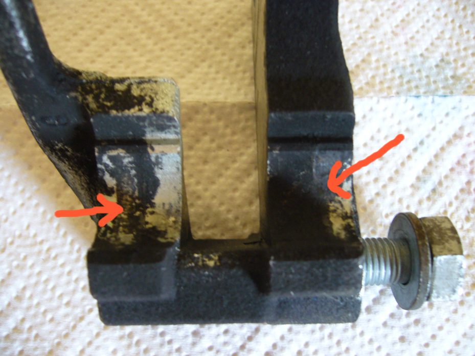

The reaction frame is made from a grade of cast iron which has a very low corrosion resistance, and even on an almost-new car, these sliding surfaces will be significantly corroded - preventing the pads from sliding freely. This doesn't really affect safety, as there's a huge amount of hydraulic pressure available to force the pads into the disc & stop the car, but there's no comparable force available to help them release afterwards, so instead of moving back out when you take your foot off the pedal, they bind in the frames & cause the brakes to drag - leading to all the problems identified in the introduction. In the worst case, the pads will actually seize solid in the frames & then the hydraulic pressure will start bending the pads. Mark Elvin posted a good picture of what happens if this occurs, here:

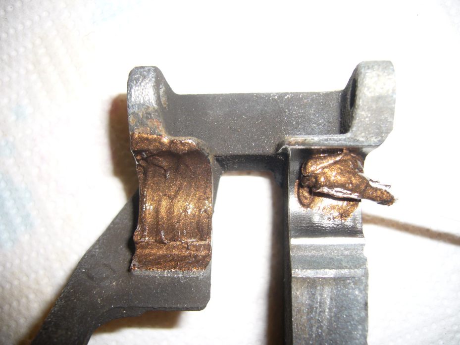

The only solution that's actually going to work for any length of time is to remove the reaction frames, thoroughly clean the sliding surfaces, apply a generous helping of copperease & carefully reassemble, taking great care not to get the copperease on the discs. I've now done this to both my cars, and the improvement in braking performance is quite noticeable, particularly when braking gently.

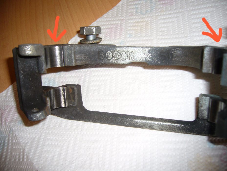

I've attached some pictures to show the process - just click to enlarge. I've included a 'before & after" shot after cleaning out just one side of the frame. The extent of corrosion buildup is remarkable after only a short time in service - the car had done less than 3000 miles when they were taken.
It took a considerable effort with the rotary wire brush to remove the dirt & corrosion & IMO you can't properly fix this without removing the reaction frames from the car, even if you're just changing the pads.
From experience, if you do the cleaning without applying the copperease, the brakes will work perfectly for about a week - then they will start corroding again & you'll soon be back where you started.

This picture is the key. If you don't do this, any benefit you get will only be temporary.
