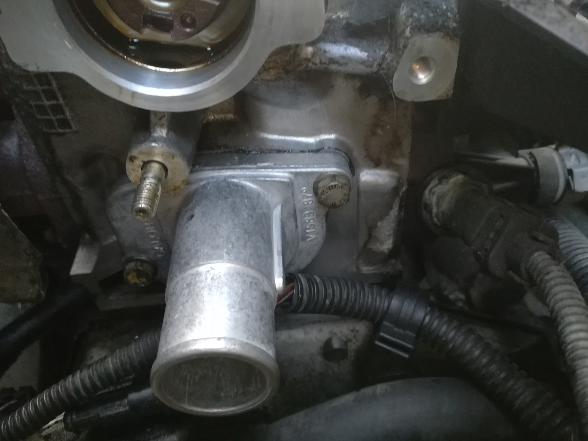

I done three the same. The last one I unbolted the plate that holds the coil packs and moved them out of the way still connected. Cleaning the old gasket off was much easier.
Also you will see in the photo that one car has had a radiator leak and been filed with water

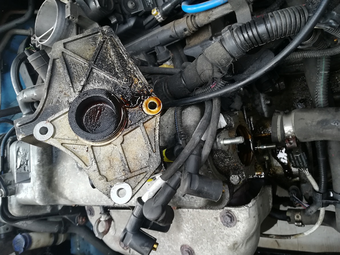

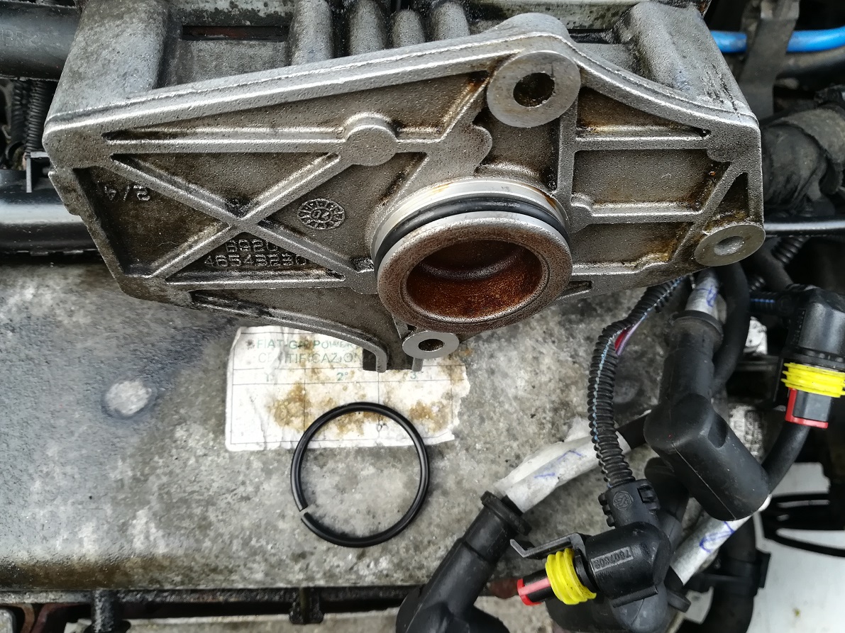

I also chose to remove the coil pack mounting plate for access, and discovered where that pesky oil leak was coming from! Replaced the cracked seal in the blanking plate.

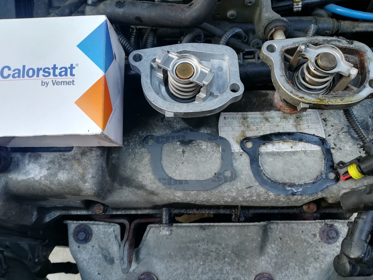

I guess there's supposed to be a rubber seal on my old thermostat (on the right) where it is visible on the new one? No sign of one, so presumably completely dissolved with age.
Now the top radiator hose stays cool until the temp gauge reaches 1/2. I should have done this ages ago...

When I'd done the cam belt, maybe a year or so previous to doing the thermostat, I'd found an oil leak just like your's coming from that end plate. I'd had it off together with the cam cover for access to the end of the cam where the cam locking tool fits. My O ring was still intact but somewhat flattened and a bit hard. The dealer didn't have one and couldn't give me an estimated delivery time so I just cleaned it all up and degreased it with brake cleaner then applied a light smear of my favourite silicon sealant: https://www.halfords.com/motoring/t...rs/loctite-si-5980-flange-sealant-599720.html which I was using anyway on the corners of the cam cover gasket where they tend to leak if fitted "dry", it's remained oil tight ever since.
It did cross my mind whether this was supposed to be a specific seal, but looked fairly basic to me so I just cycled off to the hardware store to get a matching rubber O ring - I measured it at 36mm inner diameter.
I figured if I do keep the car long enough to change the thermostat & coolant again, I'll replace the seal again, so it doesn't need to be anything fancy.
