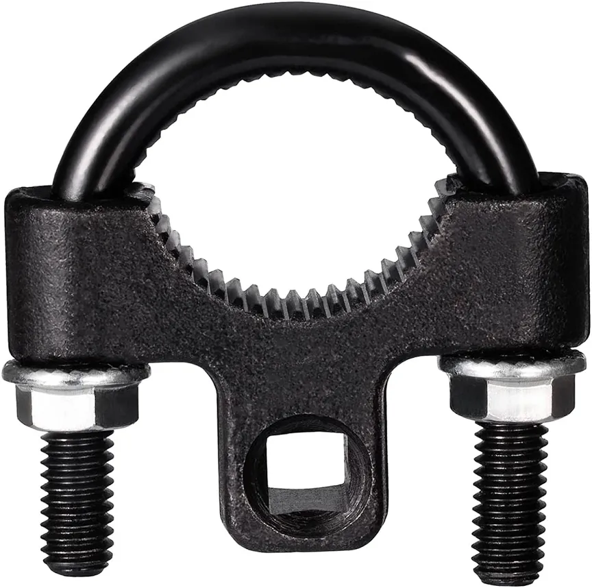

Hi all, I managed to get the Panda through the MOT with only one advisory, a n/s trackrod end, which has slight play, so having investigated it found that it's a bit rusty, (securing nut is jut a blob and steering arm is also very corroded) so I managed to purchase a replacement kit which contained the trackrod, steering arm and new boot, for both sides. Managed to remove trackrod end securing blob and break the friction fit to the hub, cut off the old boot, so as to see all the arm fixing to the rack. the question I have is how to undo the nut fixing to the rack? the new one is faceted, the old one is smooth round and directly above the subframe/lower suspension arm, so access is VERY restricted, do I have to remove the complete rack or what?

If I understand you correctly
Something like this
And some long extensions so you can get a breaker bar from outside the wheel arch

I've got a tool as you've described, but I need to grip the smooth securing nut at the steering rack and the tool which Koalar suggested is exactly what I need, now ordered from Amazon and hopefully delivered tomorrow.
Thanks again for your help
