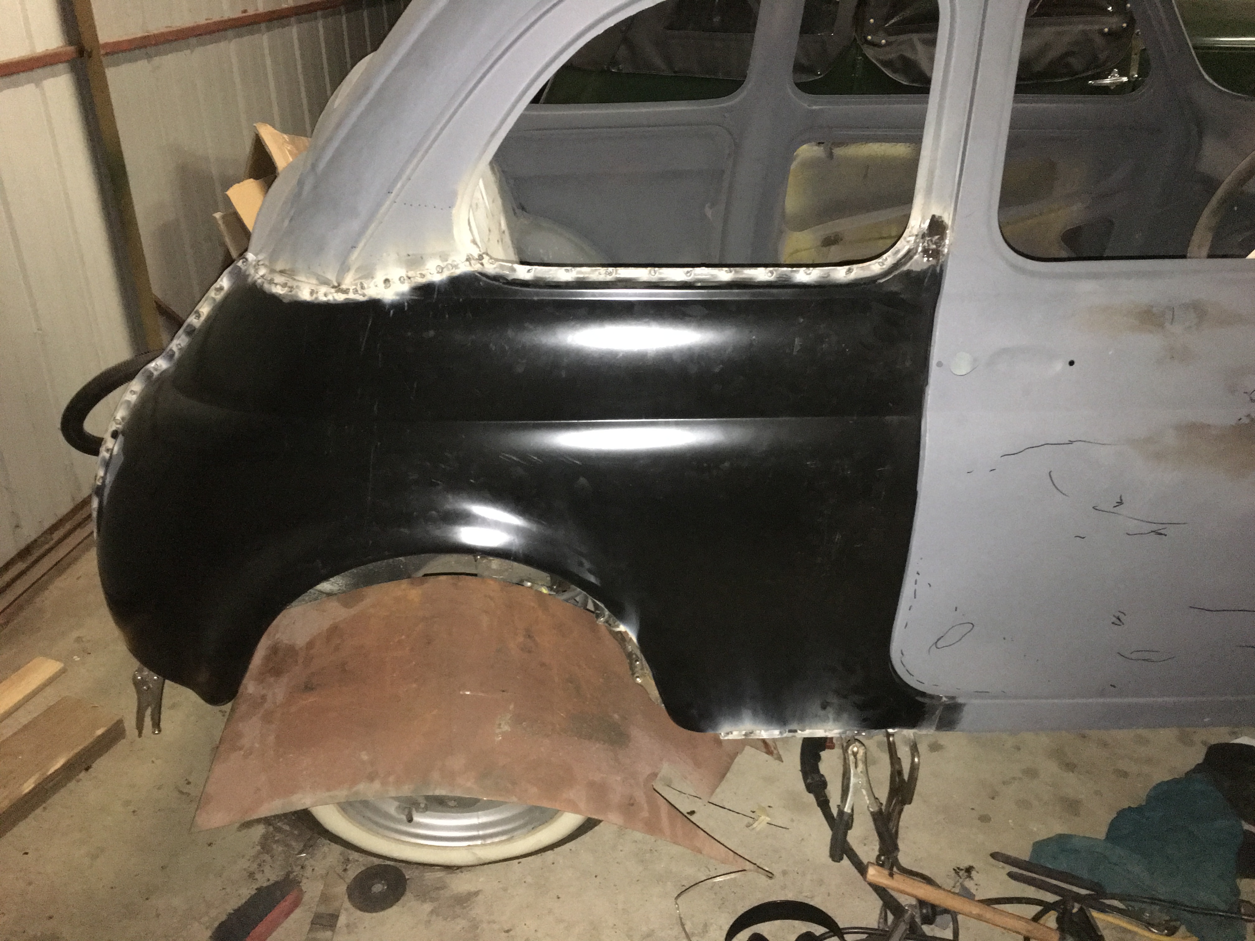

Finished unpicking all of the spotwelds yesterday. So I could see better, I marked all of the spots, then cut slices again, just behind each spot. I then thinned down each spot weld before wiggling them off. It took a while but I'm happy.
I then clamped the new panel on for a rough first look to see where the best joining areas will be at the top. It is quite different behind the side window so may do the join below that area.
I also think I will join it below the seam that goes around the top corner, rather than unsettling the original seam.

Well I have done all the welding of the new panel and started smoothing out the body, but busy working on it and not taking photos.

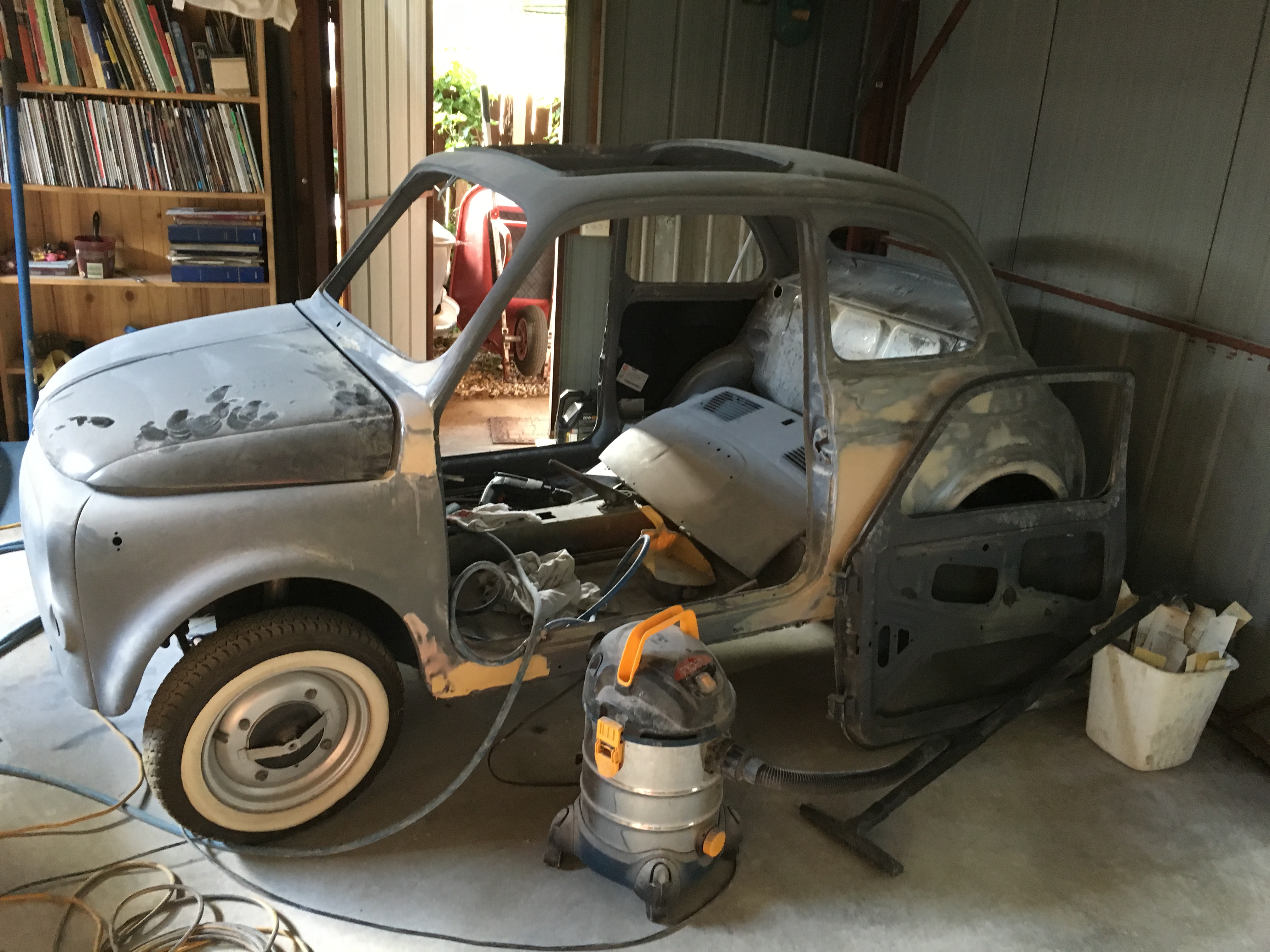

Finally back to it after Christmas etc
Sanding sanding sanding.....
I did patch up a big hole in the dash where a previous owner put in a cigarette lighter So that's better
I won't be taking it to the Fiat Nationals in March?
It was over 40 Celsius today so couldn't do too much after lunch. Same forecast for tomorrow

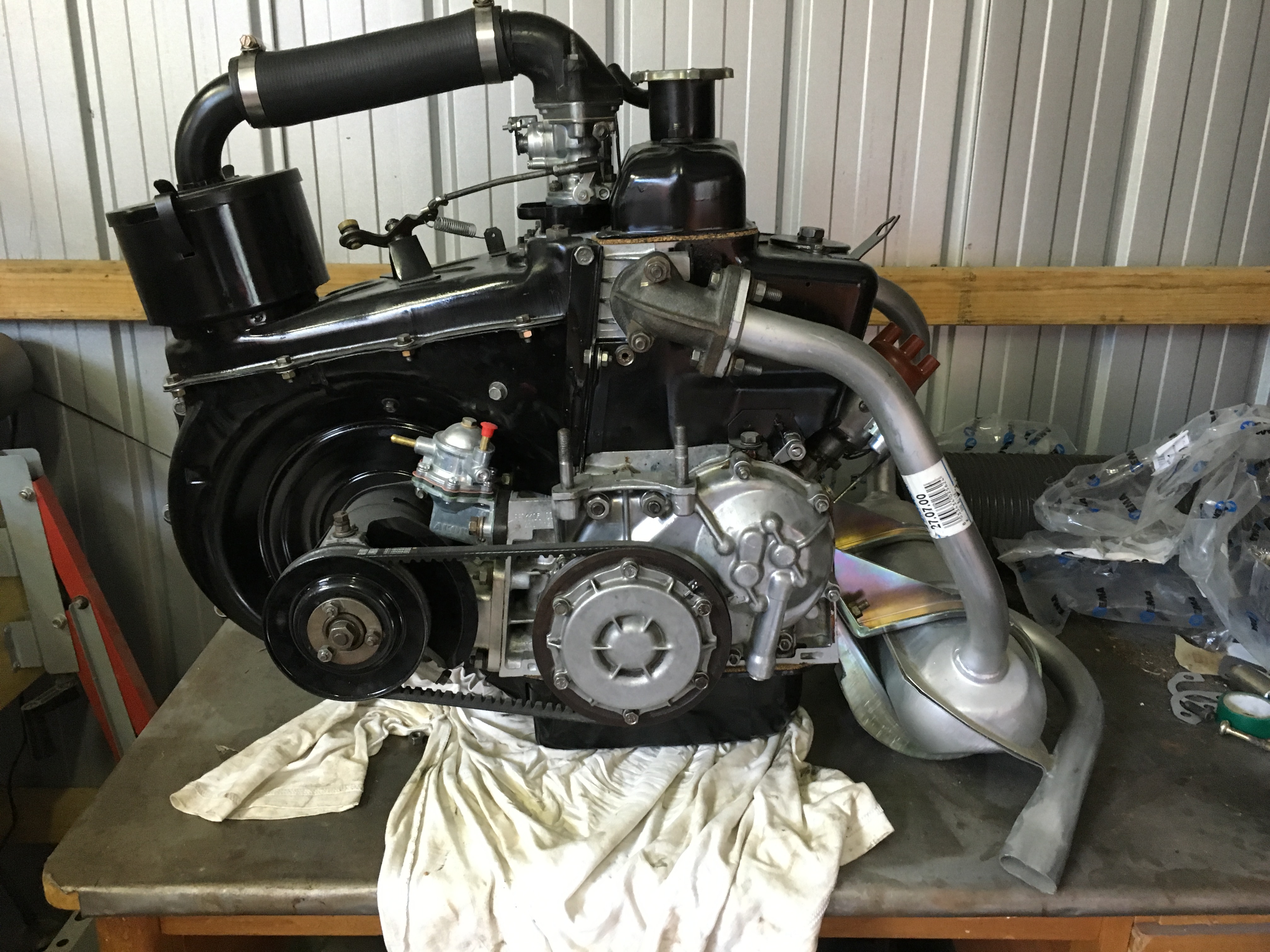

With the intention to display my rebuilt engine at Autoitalia Canberra next Sunday I decided it was time to tackle fitting the exhaust.
Being a 500 crank case bored out for 650 barrels, I bought a 650 head and exhaust system, with the corresponding larger mounts
I found the I had to cut off some of the new lower mount so it would sit flush against the crank case. Once that was done it all pulled up quite nicely.

In this picture have you filled the left rear panel yourself? I have a depression (no creases or obvious dents) that looks very similar, between the door aperture and the rear arch, and I'm struggling to achieve the correct contour. I've tried blocking, using a ruler, and also using a flexible pad. I thought it looked OK yesterday until I put a light coat of primer on to protect the bare metal and it looks awful. Do you have any tips for a complete bodywork novice? I have never done any filling (besides walls in my house) :)
