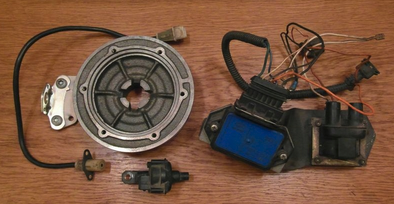

That's how the whole set of the Nanoplex ignition looks like:

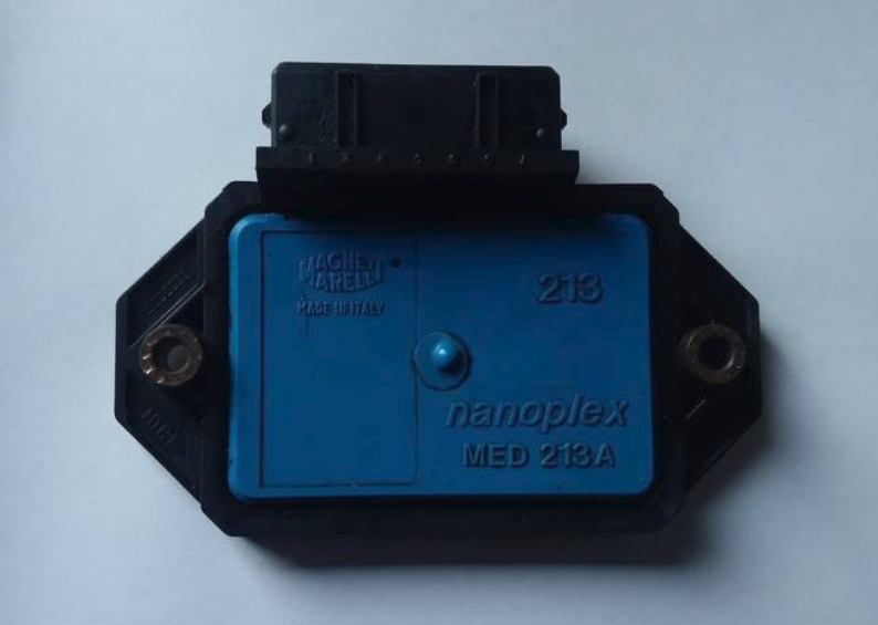

There are two of them depending on the ignition module type (and colour):
46577004 for the grey and black and 46577369 for the blue and red.

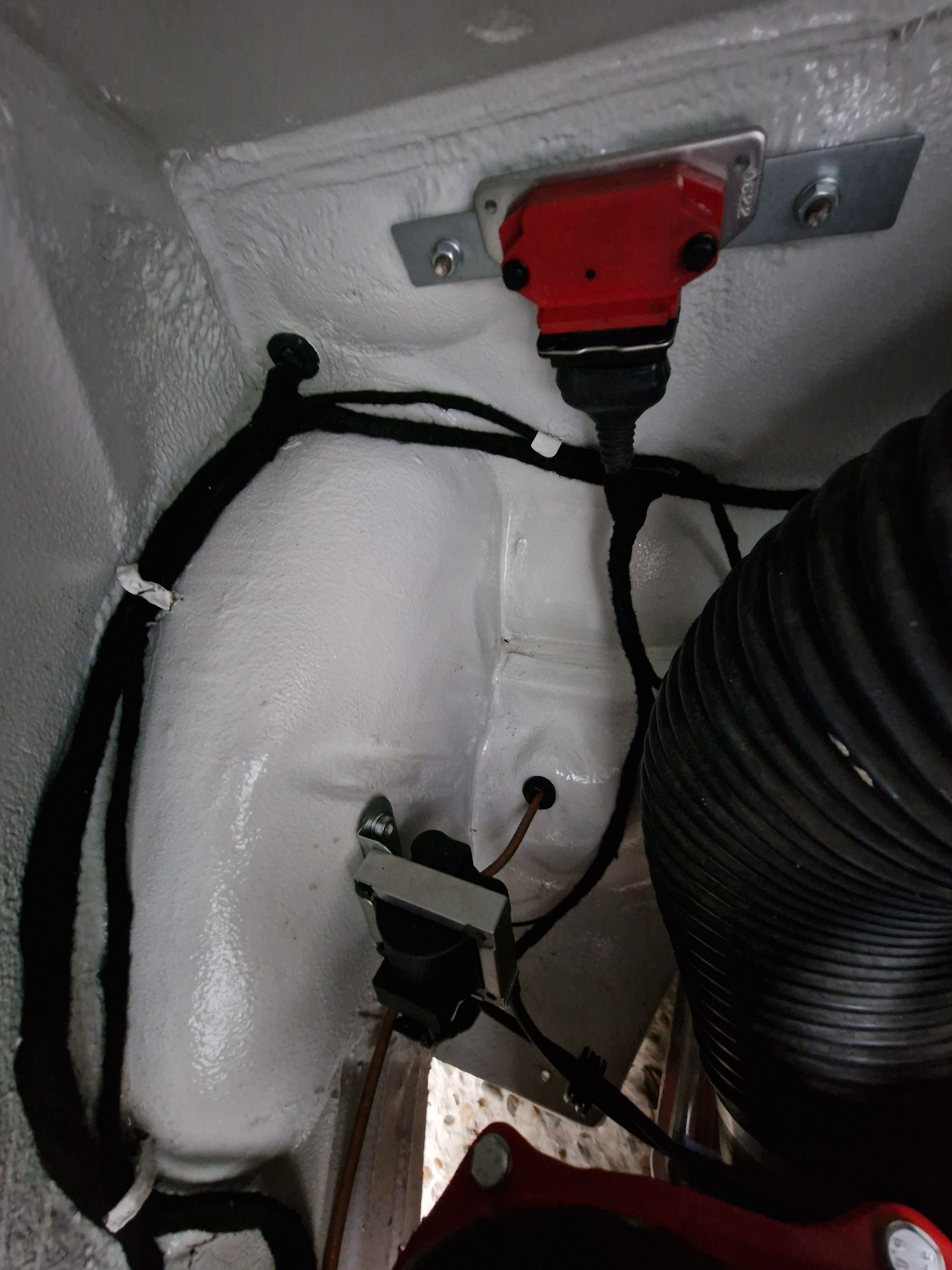

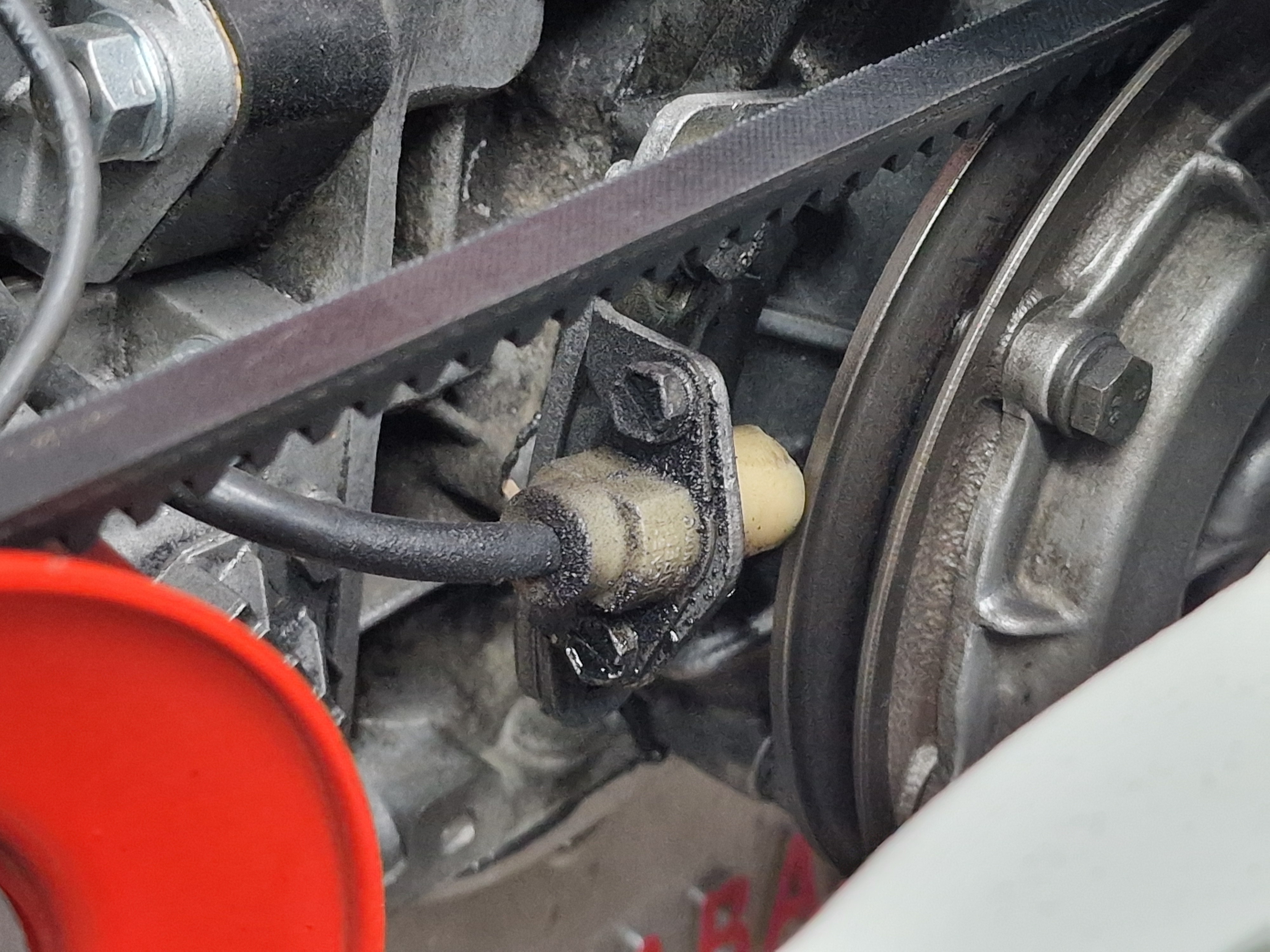

I have exactly this setup. '66 F with a Polish 126p 650cc engine in it. The (distributor-less) engine came to me with no electronics, except for the crankshaft position sensor.
After a bit of troubleshooting, trial and error, it has been running great this summer. It's especially enjoyed the cold sunny mornings of recent!
I got an APE 20FF ignition module, and the associated connectors, and made a loom to connect it. I referenced this post for the wiring.
https://www.fiatforum.com/threads/installing-electronik-ignition-kit.486992/post-4633981
I did not wire in a vacuum sensor, however. Maybe something I'll look into, having read this thread today!

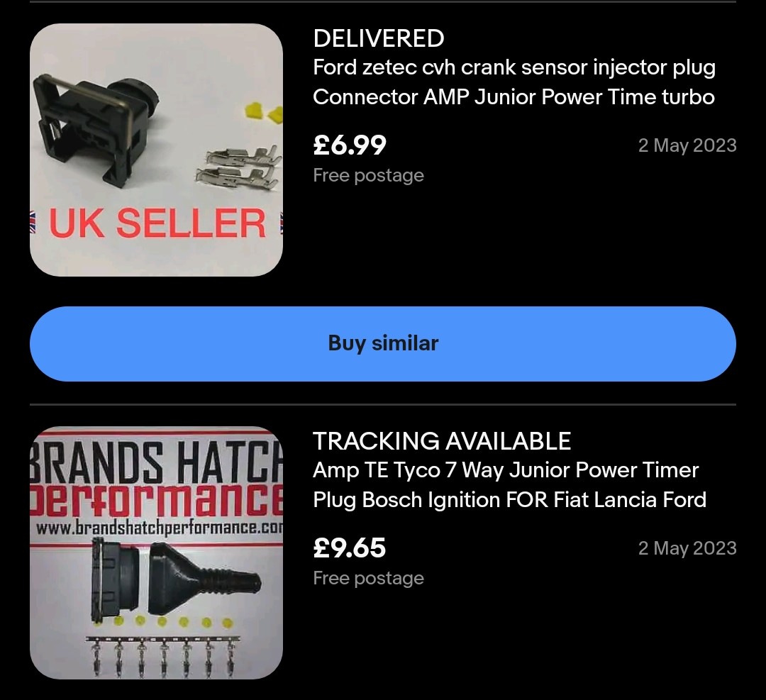

The connectors to make the loom should be found on ebay:
  • Tyco AMP Junior 7 way - to connect to the ECU module
  • Tyco AMP Junior connector 2-pin - to connect to the crank sensor
  • Tyco AMP Superseal 2 way - to connect the coil (*modern type)
In terms of wiring, I've been round the houses with ballasts and coils, and have settled with a more modern 12v coil, without the ballast, which seems to run great. You can't see much in the photos because it's all been wrapped, but to give you an idea, and placement of the various bits using existing mounting points. Naturally, the bits of flat bar I used to 'temporarily' mount them have not been quite so temporary!
