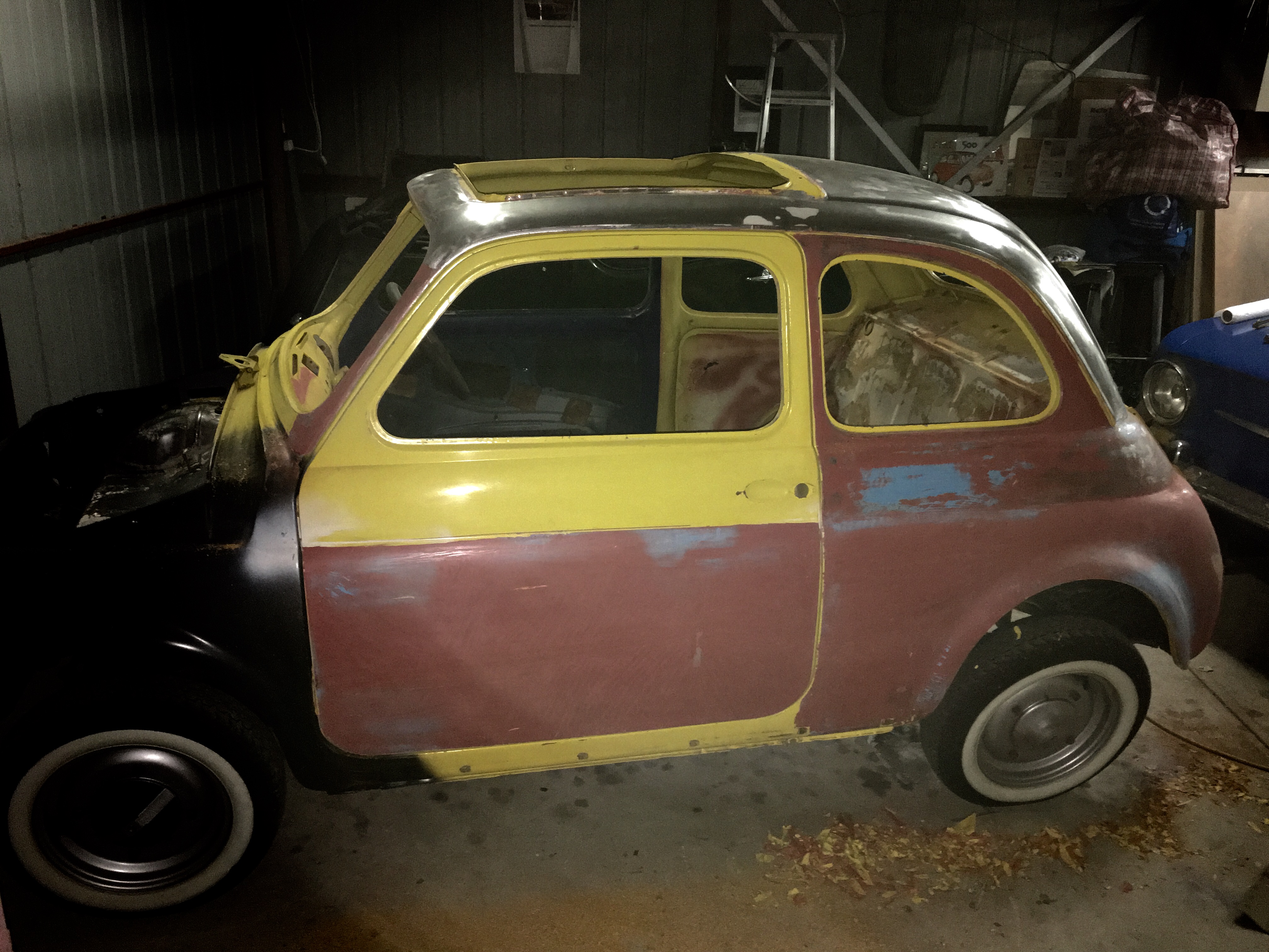

A little bit more top coat off.. Slowly slowly. Just dry scraping this as I found the top coat is not holding on very tightly so I can use less fumy stripper this way.

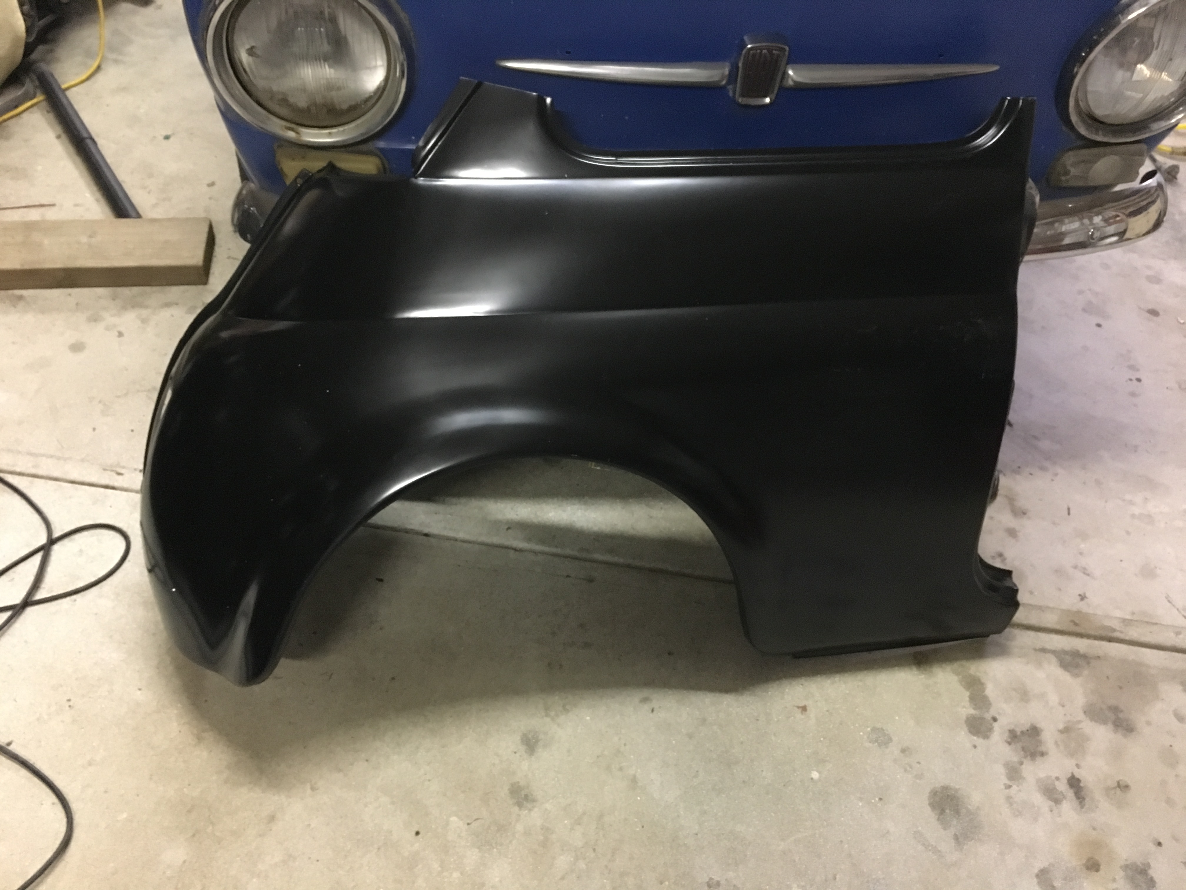

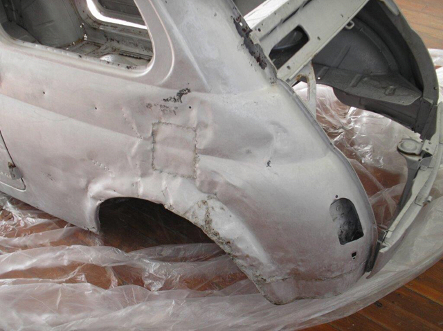

I got a lot more paint off today and then found the filler! The same rear right panel that needs work anyway has a large dent in it above the wheel arch. I think based on how messy the panel is, the best course of action will be to get a replacement panel.
So to the online shops I go to start seeing who has the cheapest postage to Australia. (I might get a new bonnet while I'm at it since both of the ones I have need work.)

Ouch!

Is the dented rear quarter otherwise OK and good at the wheelarch edges. If so I would check if anyone could tidy that up and even weld in a repair section. Your car body has such integrity that I would want to keep the original panel and welds etc.

In regards to the panel, I did wonder about trying to repair but it is damaged around the top of the wheel arch and also split down the edge near the door so it seems I will get a better result by replacing it.
Or I can replicate the beautifully crafted sculpture using body filler again.

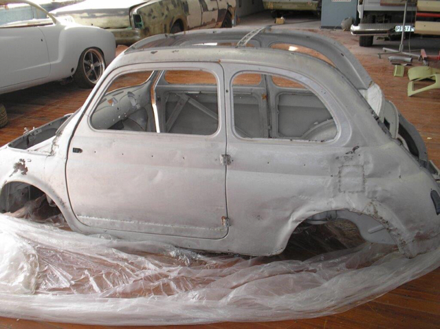

This is what a really creased rear quarter panel looks like..IMG_1471854039.347996.jpgIMG_1471854067.983547.jpg, mine had more hits than Pink Floyd

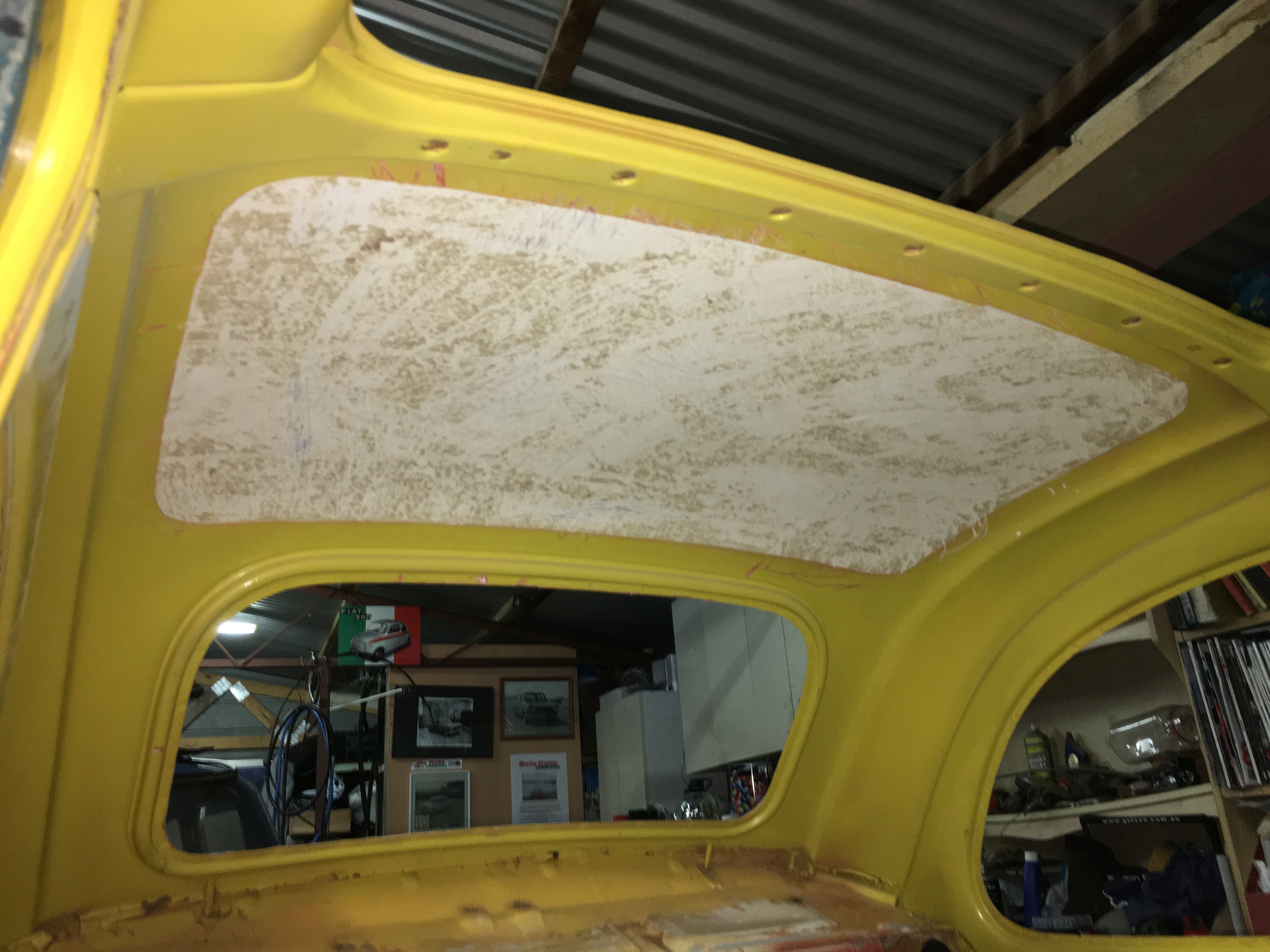

Roof lining out now. And cables as well. Will try to get to the blaster next week. Also a new RH rear panel and bonnet are on their way from Germany.

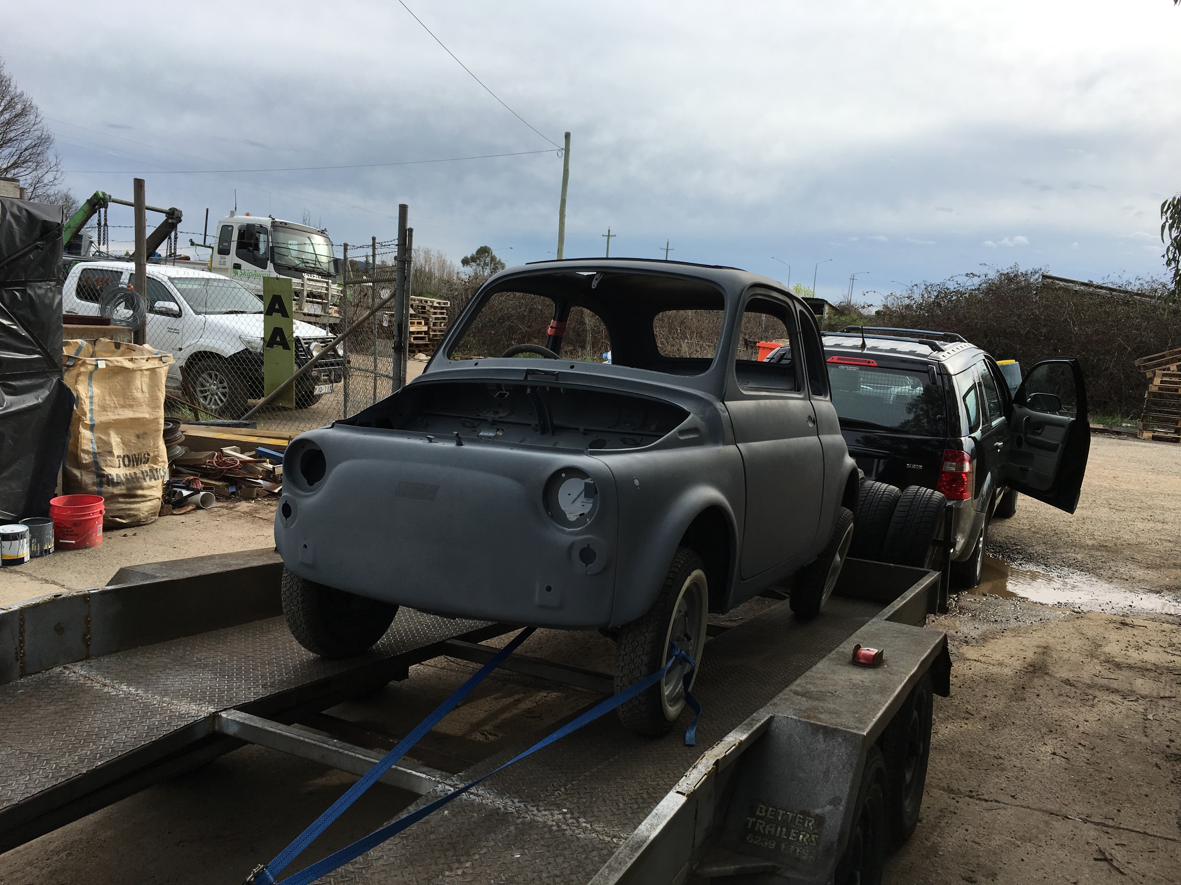

Dropped the car off for blasting today.
This will give me a chance to tidy the garage a bit and sort out what other new bits and pieces I might need. Time to start a list.

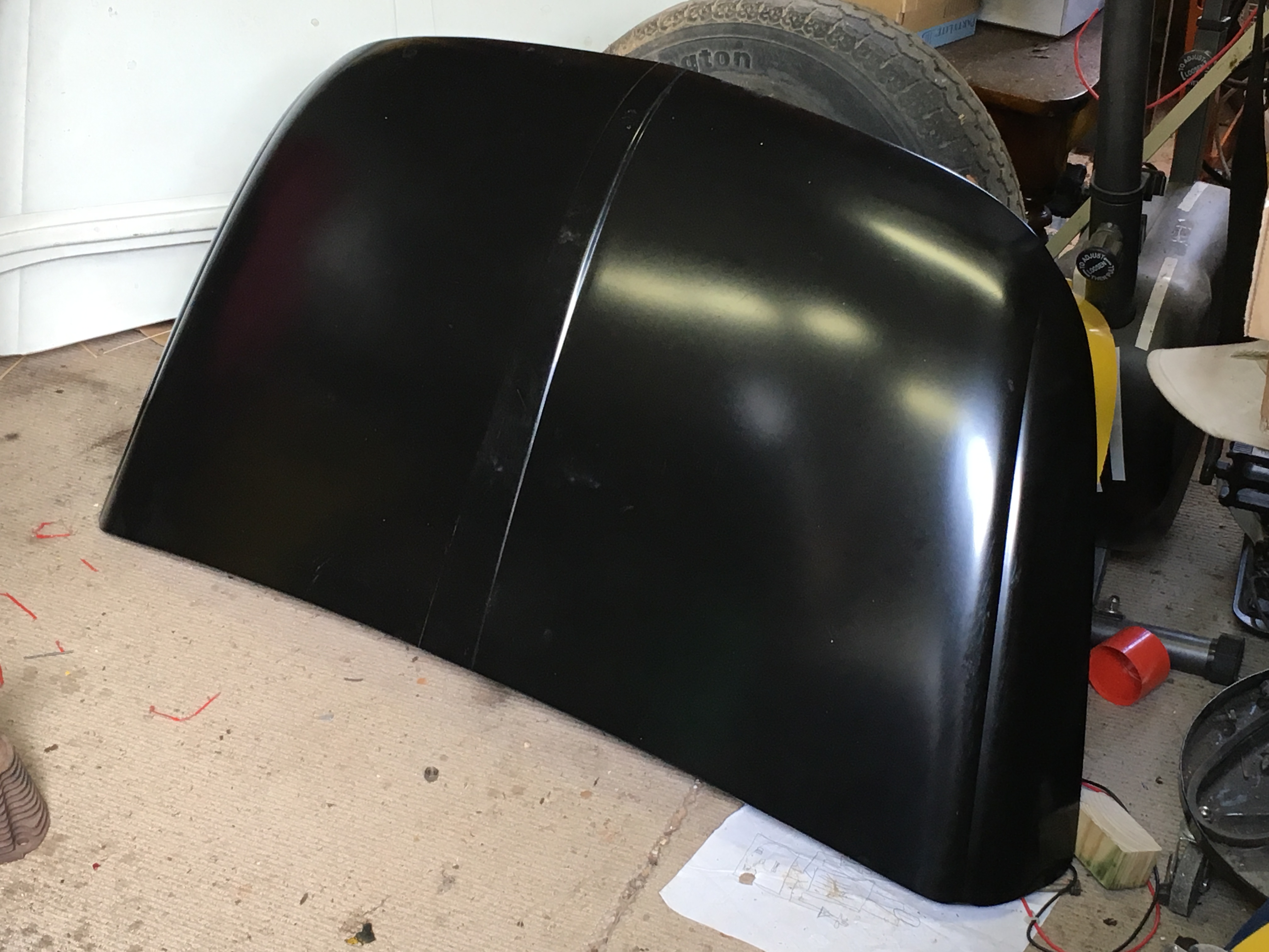

New bonnet arrived today
One question. Have people who used these replacement panels removed the black paint before priming again, or just primed over the black?
I just went over mine with a scotch brite pad (fine grade). Came out a treat
