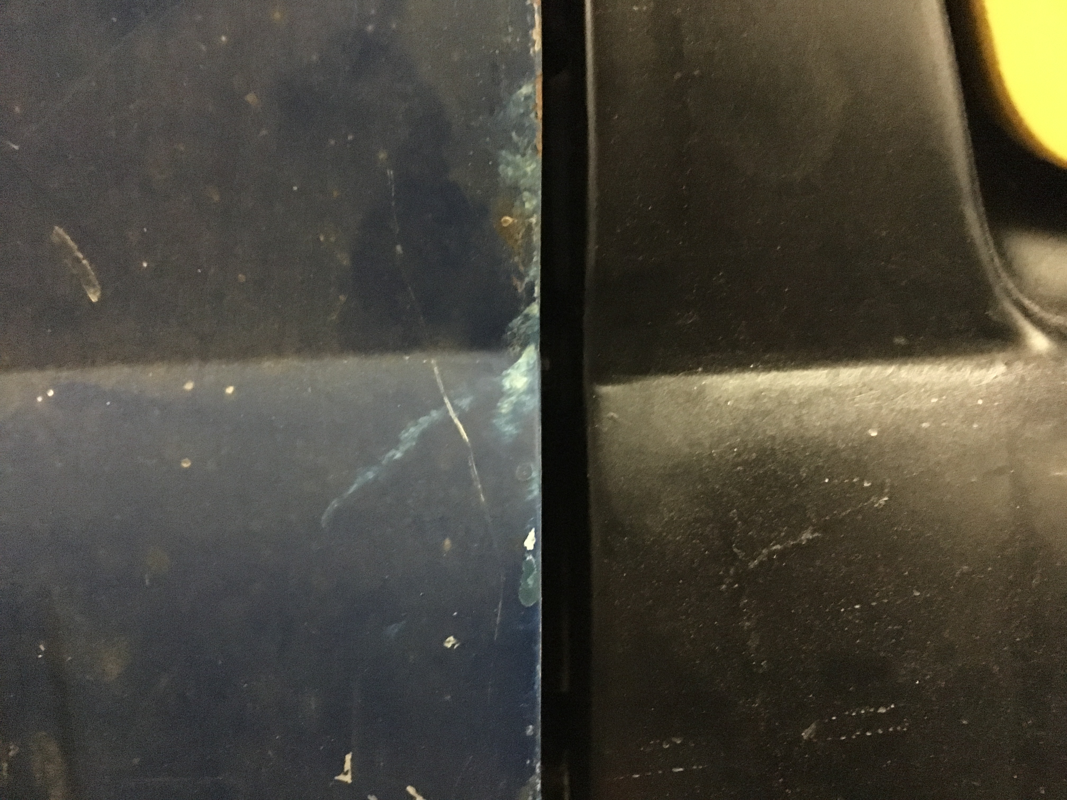

I tried on a spare door that has less dents than my yellow one, but it sits higher than it should. The line on the side is 5mm higher than the front and back quarter panels and it just scrapes the roof when it shuts.
After much thought I have decided to remove the hinge pins, grind the bottom of the hinges that are welded to the door a few mm then put the pins back in with washers as spacers at the top.

I trimmed the lower edge of the door hinges today. I now have a door that lines up and shuts better than ever before. I put a bit of white paint on to highlight the line and am happy with the result.

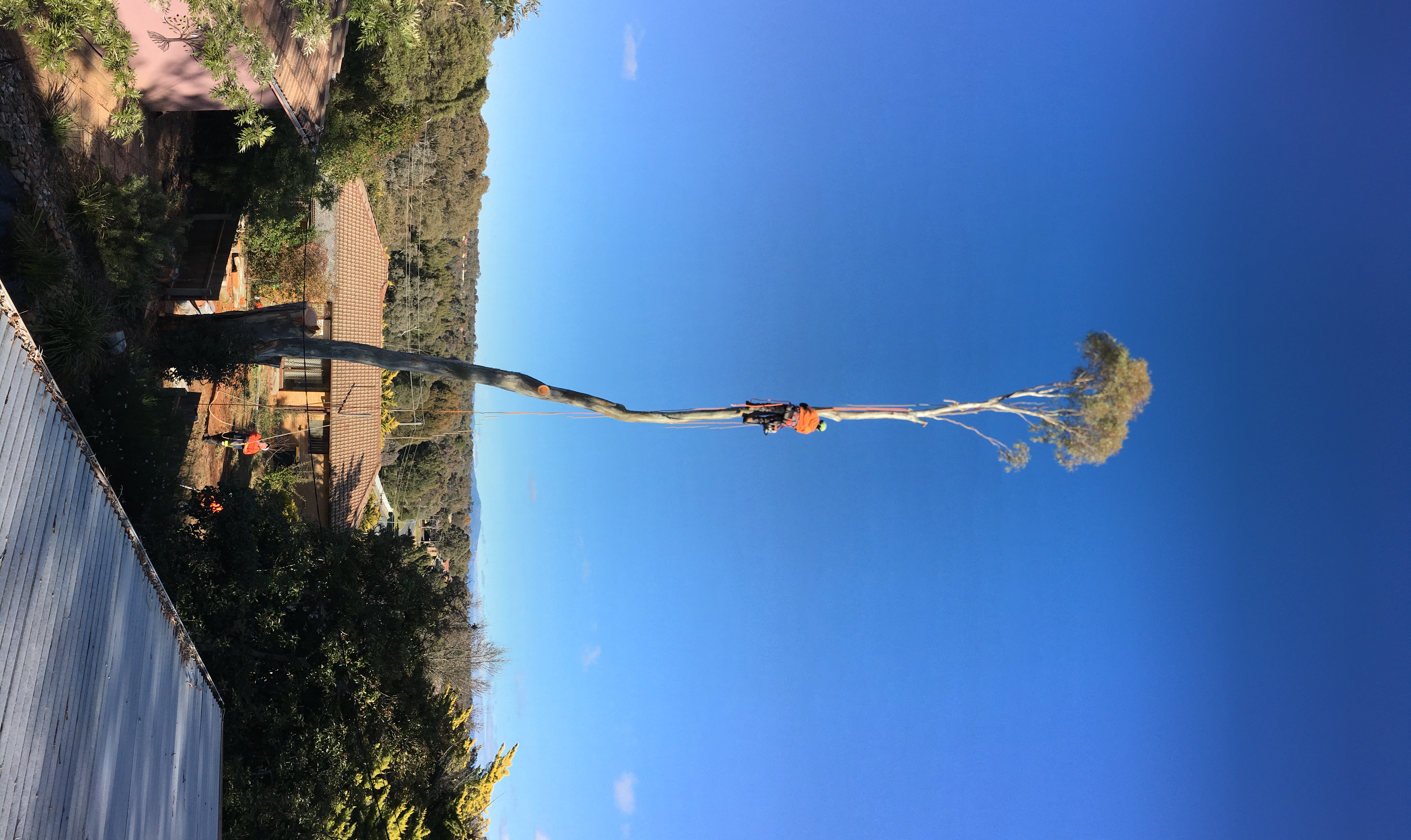

I was too distracted watching our giant gum tree getting chopped down... That was the last of many tall branches - three days work. Glad I wasn't up that tree.

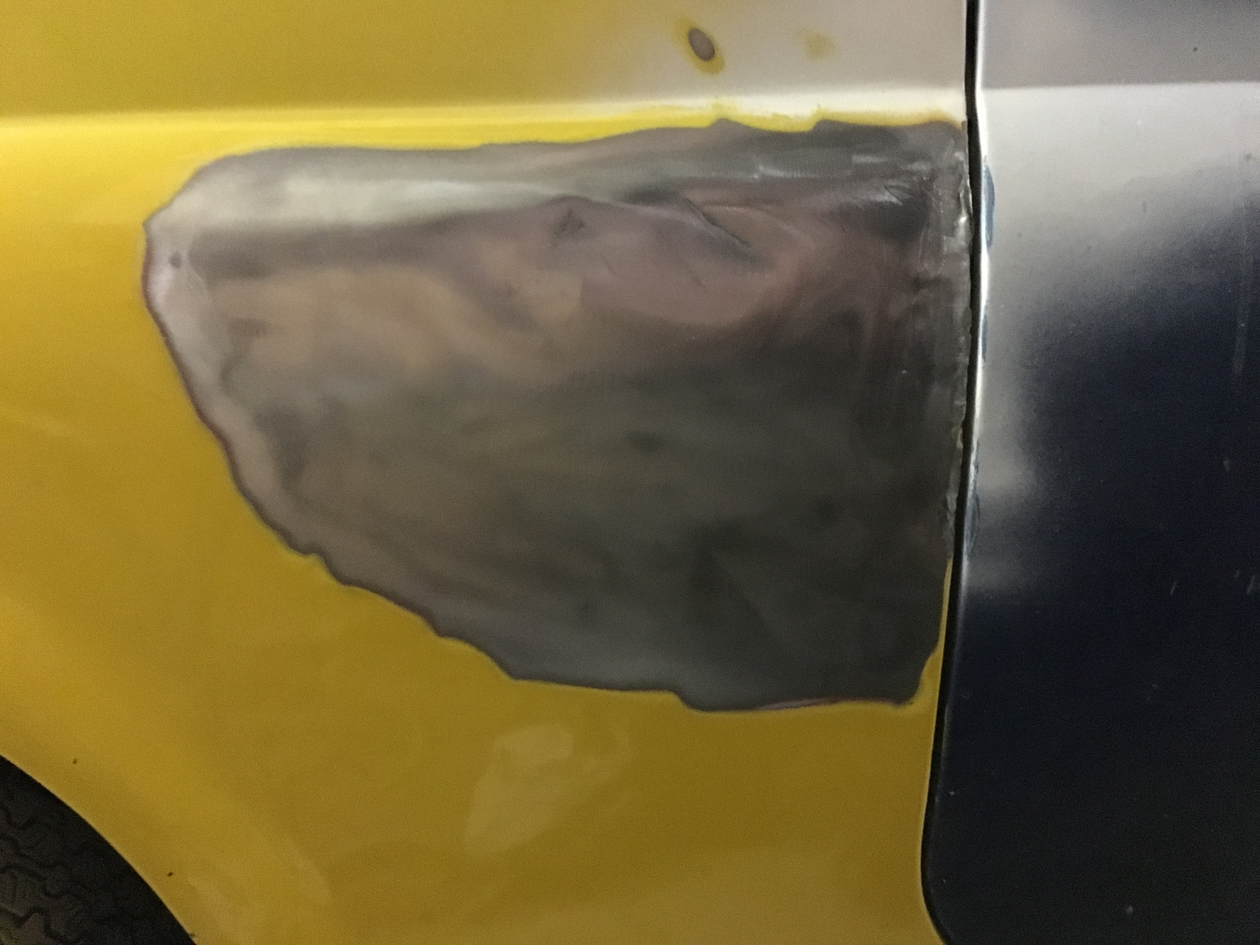

I decided to use paint stripper on the big flat surfaces. Experimented with a small patch on the roof today.
I didn't put it on thick enough to get through all of the primer, so know better for next time.
It it quieter and less messy than blasting or using a strip disc on the angle grinder so over winter I will gradually do as much as I can get to.

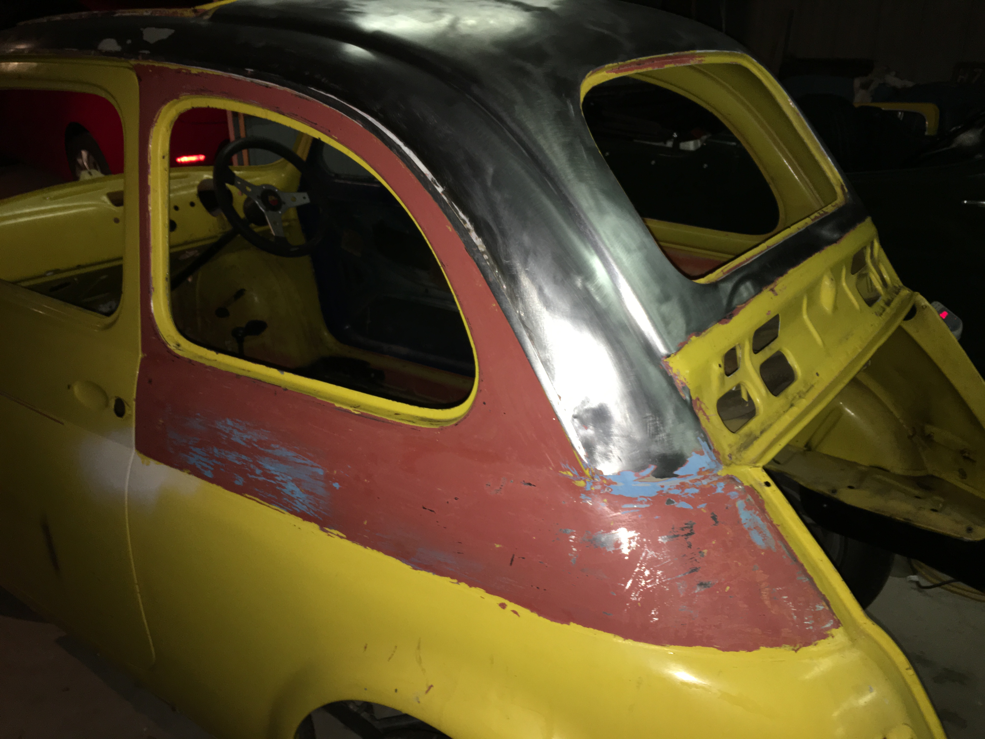

A bit more paint stripping today and yesterday. The luggage compartment had a few more layers of old paint to get through but nearly there.
The roof is not so bad and only takes two goes to get the bulk off, followed by a light rub down with wet scotch bright.
