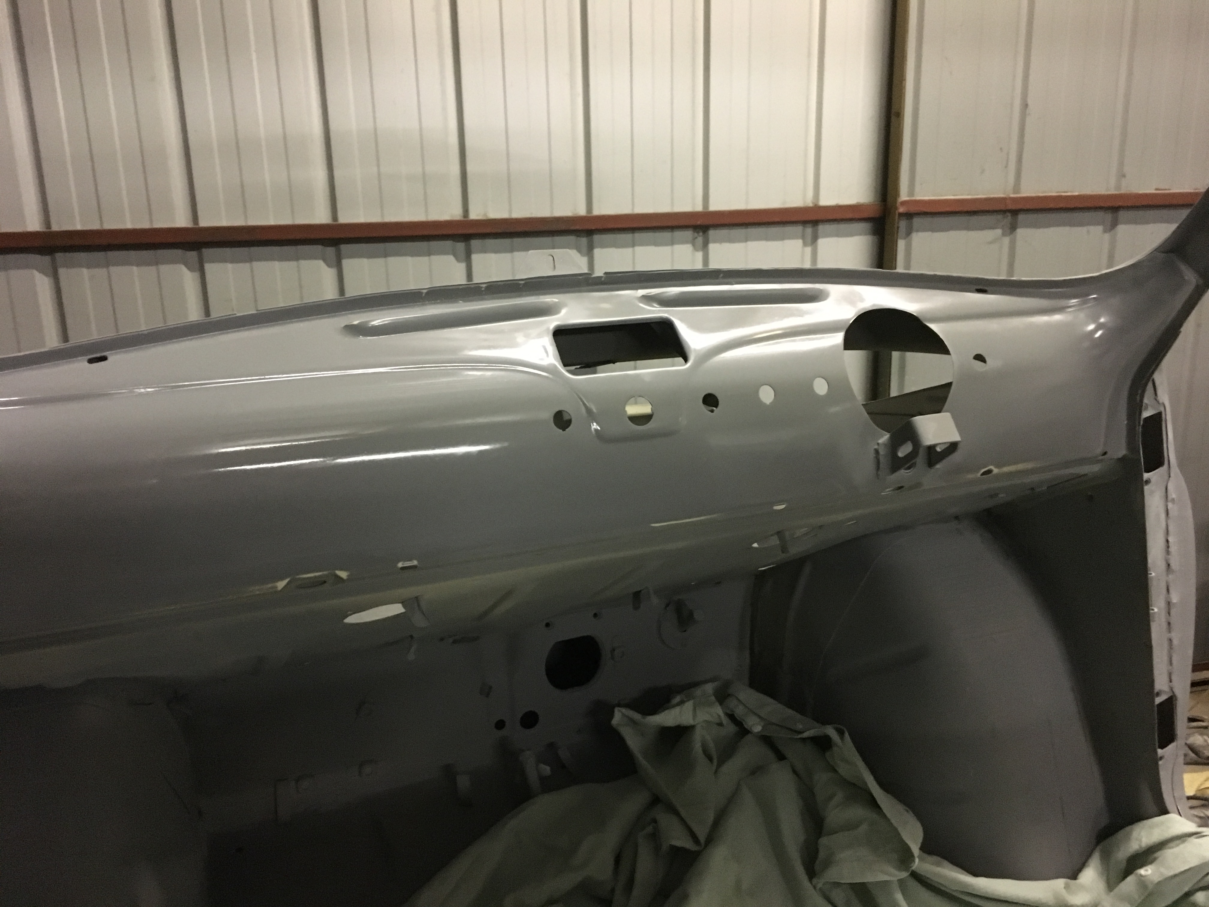

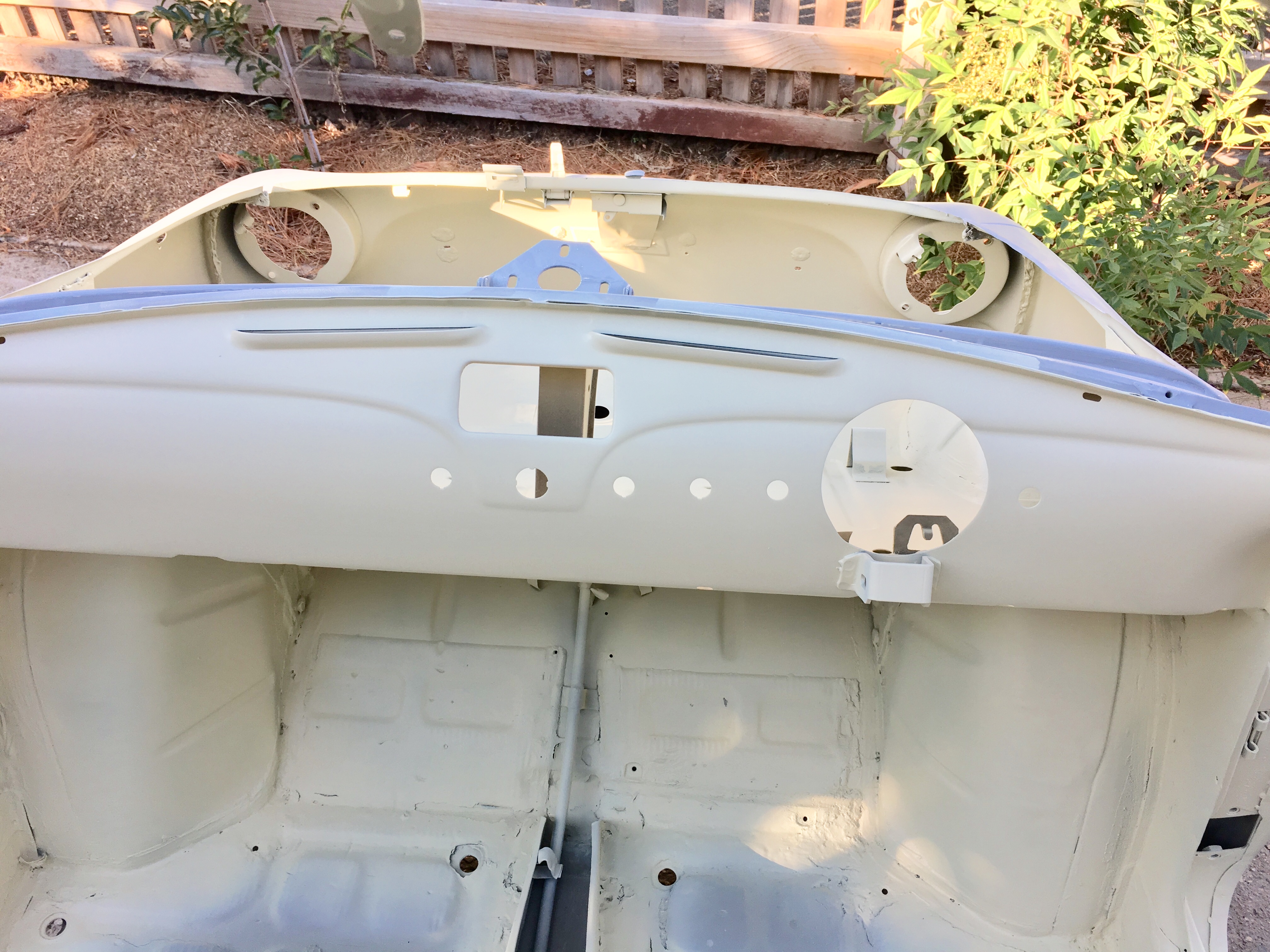

Latest photo with panel wet down with wax and grease remover.
Hmmm. The more I sand the more teeny tiny imperfections I see.
I need to take off my glasses, stand back And be happy ?

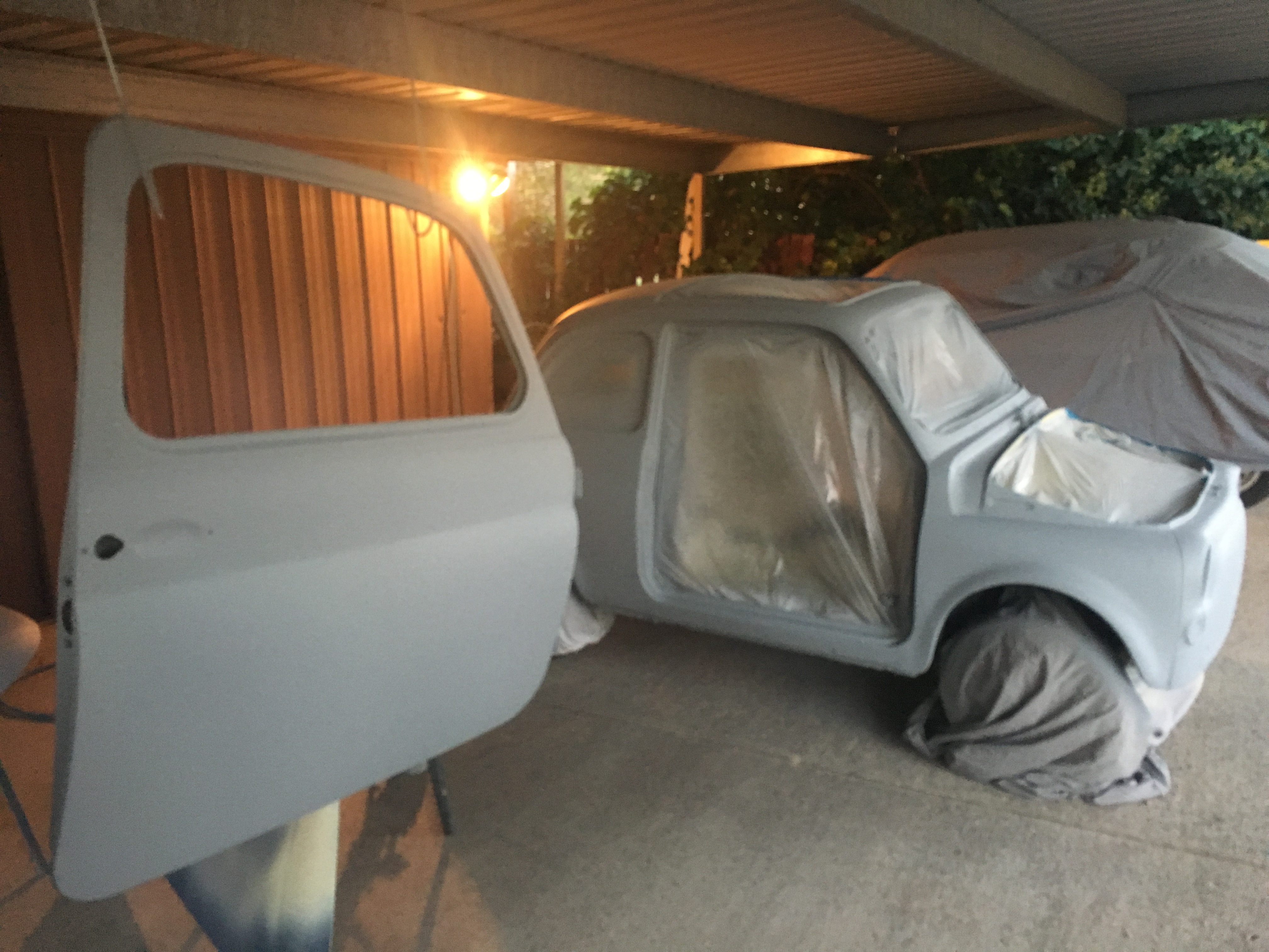

Quite lucky that the weather forecast is good for this weekend. 28 C so should get a good lot of painting done.

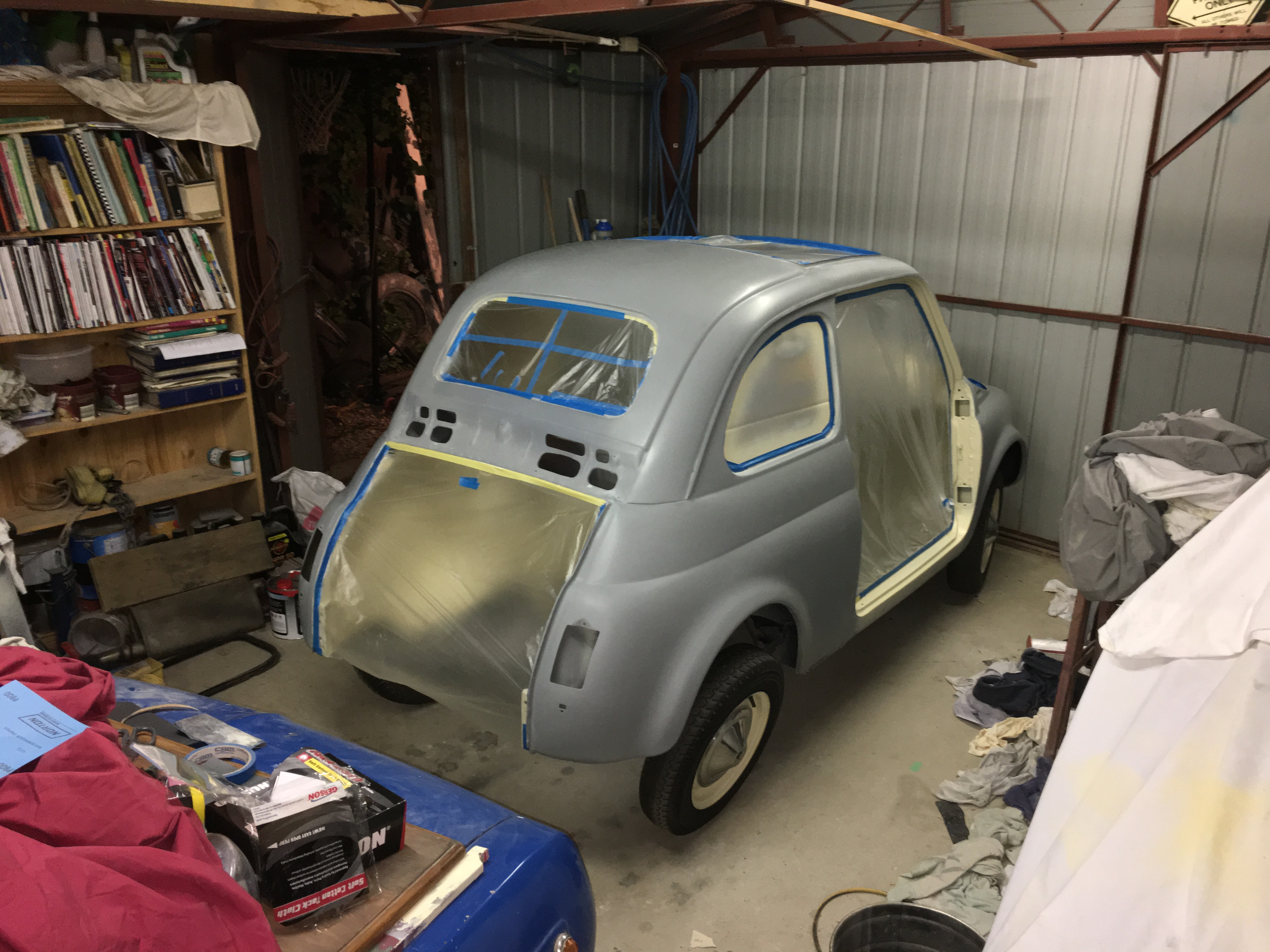

Sanding showed up some areas where the primer was too thin. Taped up ready to give the outside a few more coats.
Hi Geoff,
I think you made the right decision! (y)
There's a natural tendency when re-painting a car to 'press-on' especially if you're trying to fit this work in around other commitments. (Btdt :cry: )
But if you spot any defects when sanding, it always better to defer painting until they're rectified.
Well done for exercising patience, I hope you'll achieve a great finish.
Regards,
AL.

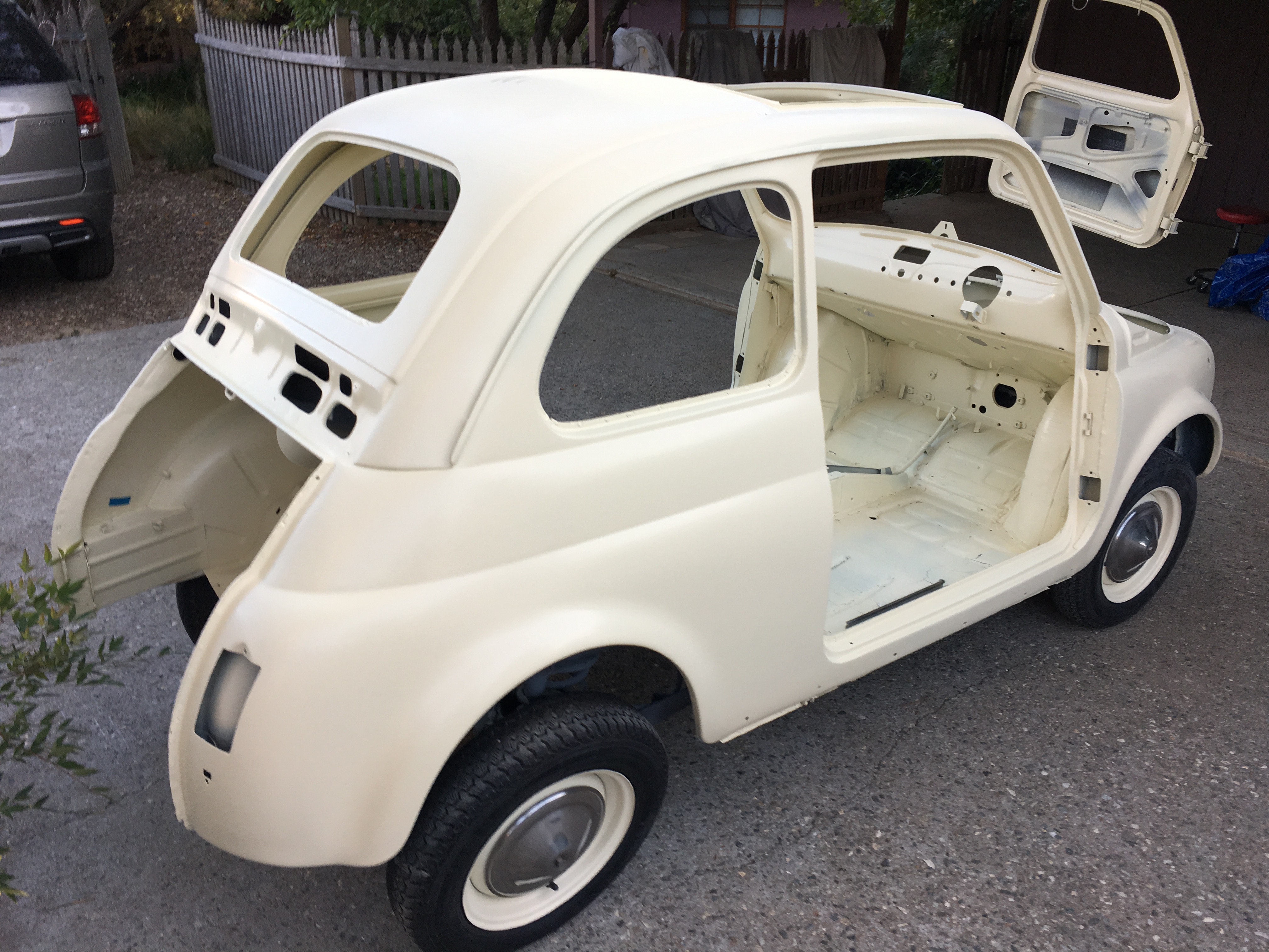

Success. The weather was warm enough but a bit windy so we pushed the Austin7 and Fiat 850 out of the garage. Covered things up, wet the floor and painted.
A much better finish than the first go.

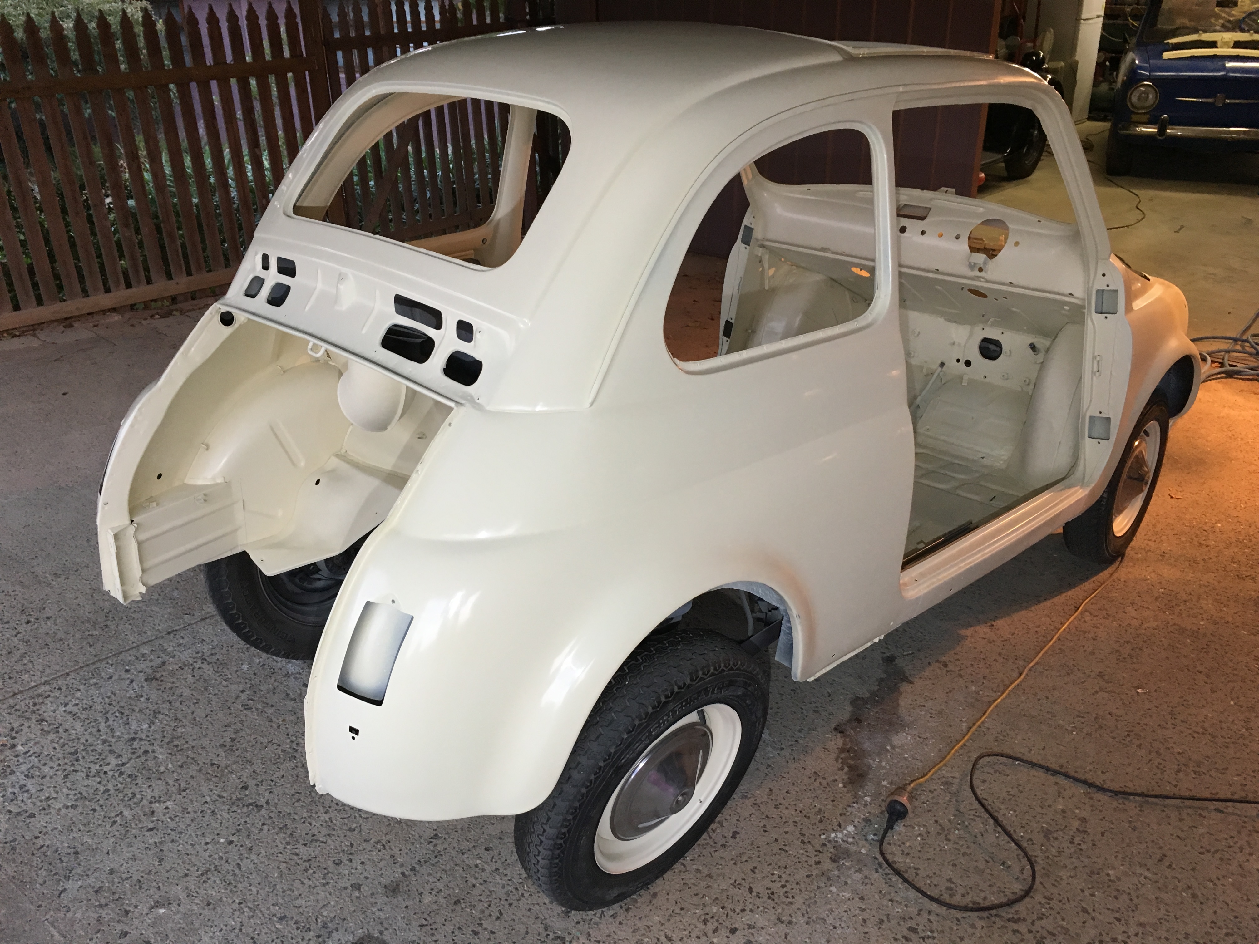

The Austin7 sees the light of day. Need to fix the generator now there is some paint on the 500

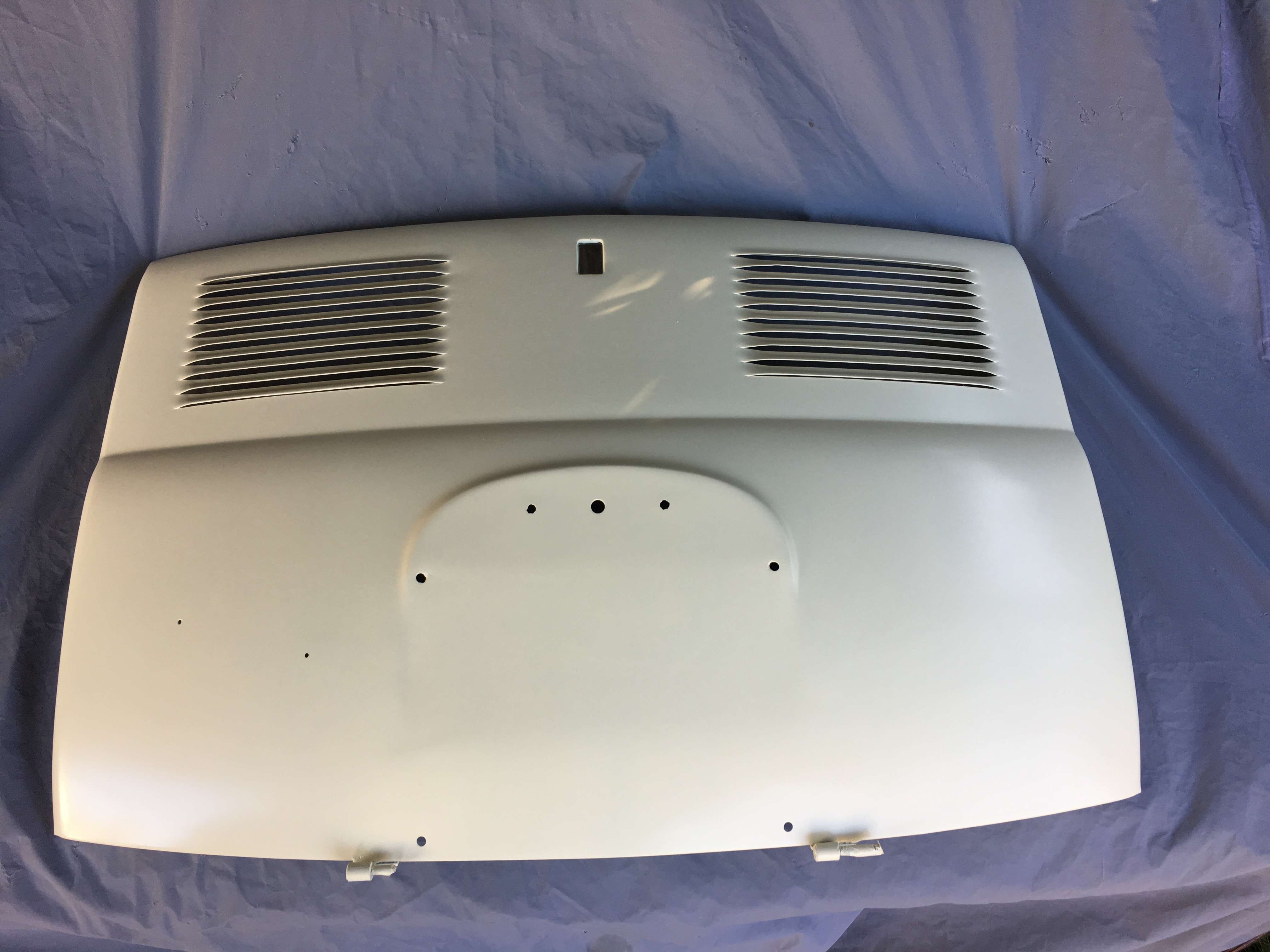

This pic shows the difference between roof that has been cut back and rear quarter panel waiting it’s turn.

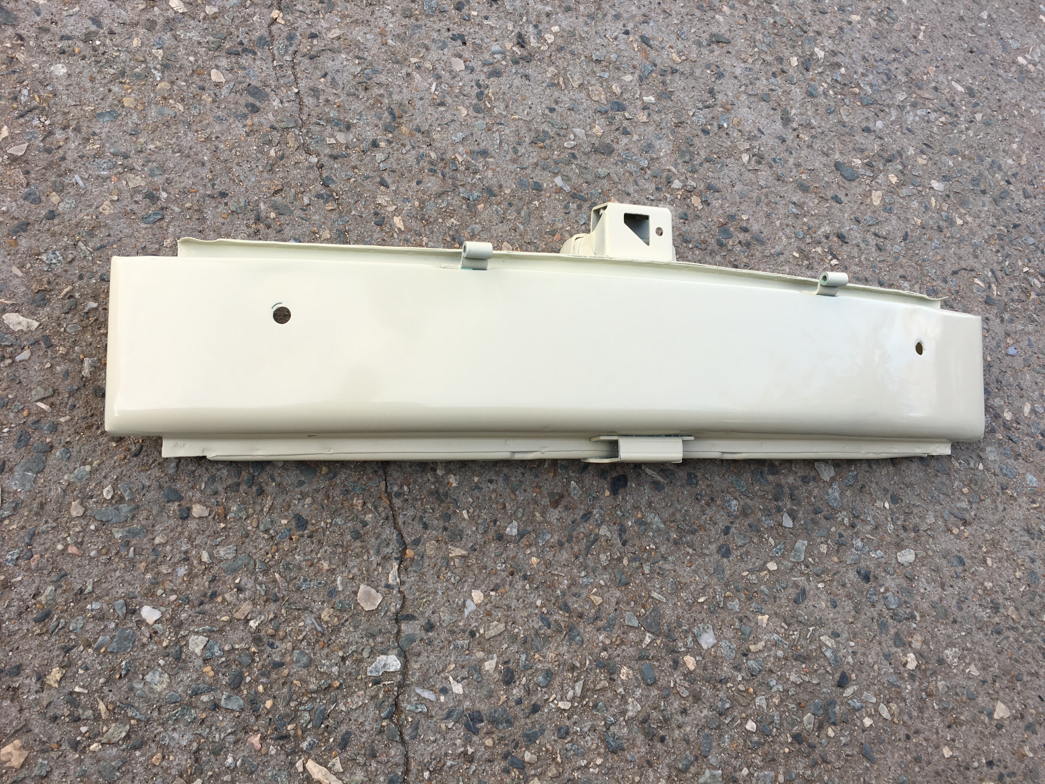

Looking good.
But please don’t look too closely as when I was nearly done on the rear quarter panel, I got too close to the wheel arch on the wrong angle. The foam pad on the buffer caught the edge and took a tiny bit of paint off. Oh well. A small touch up will fix that.
