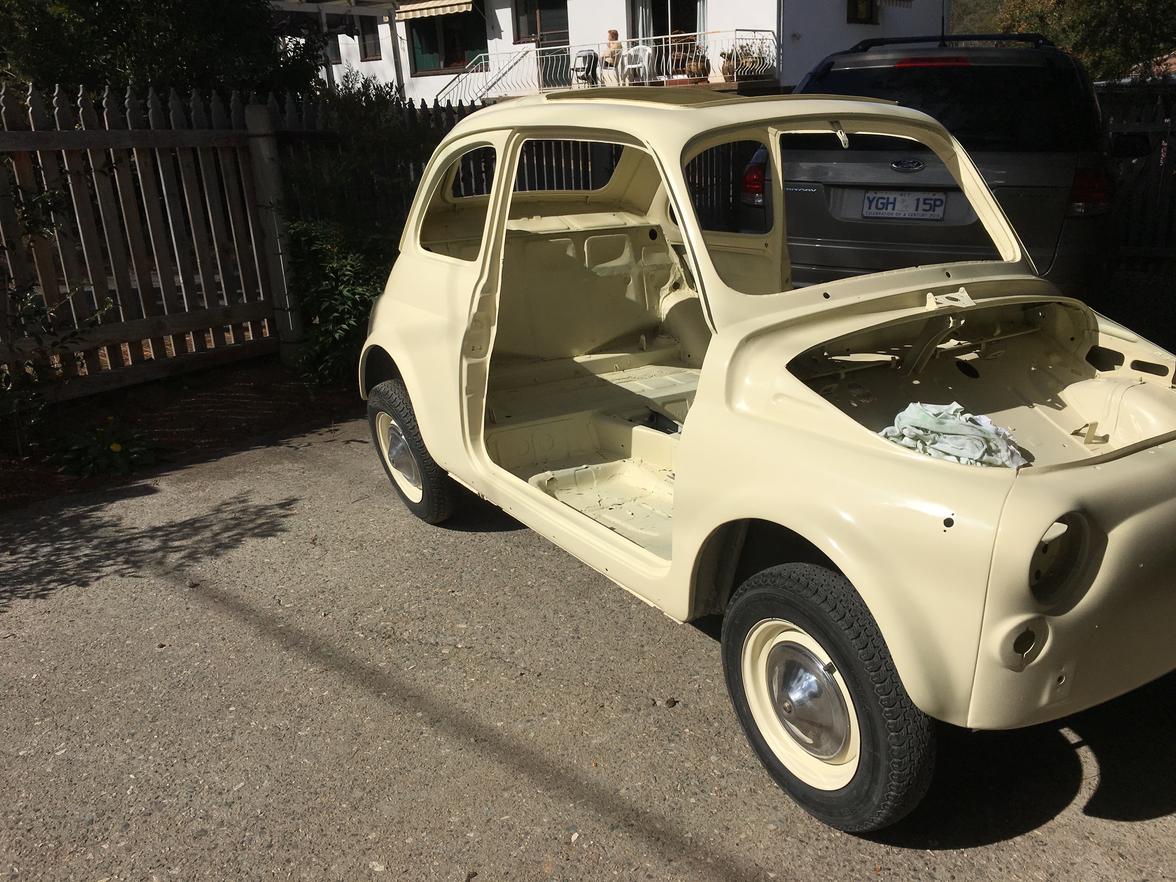

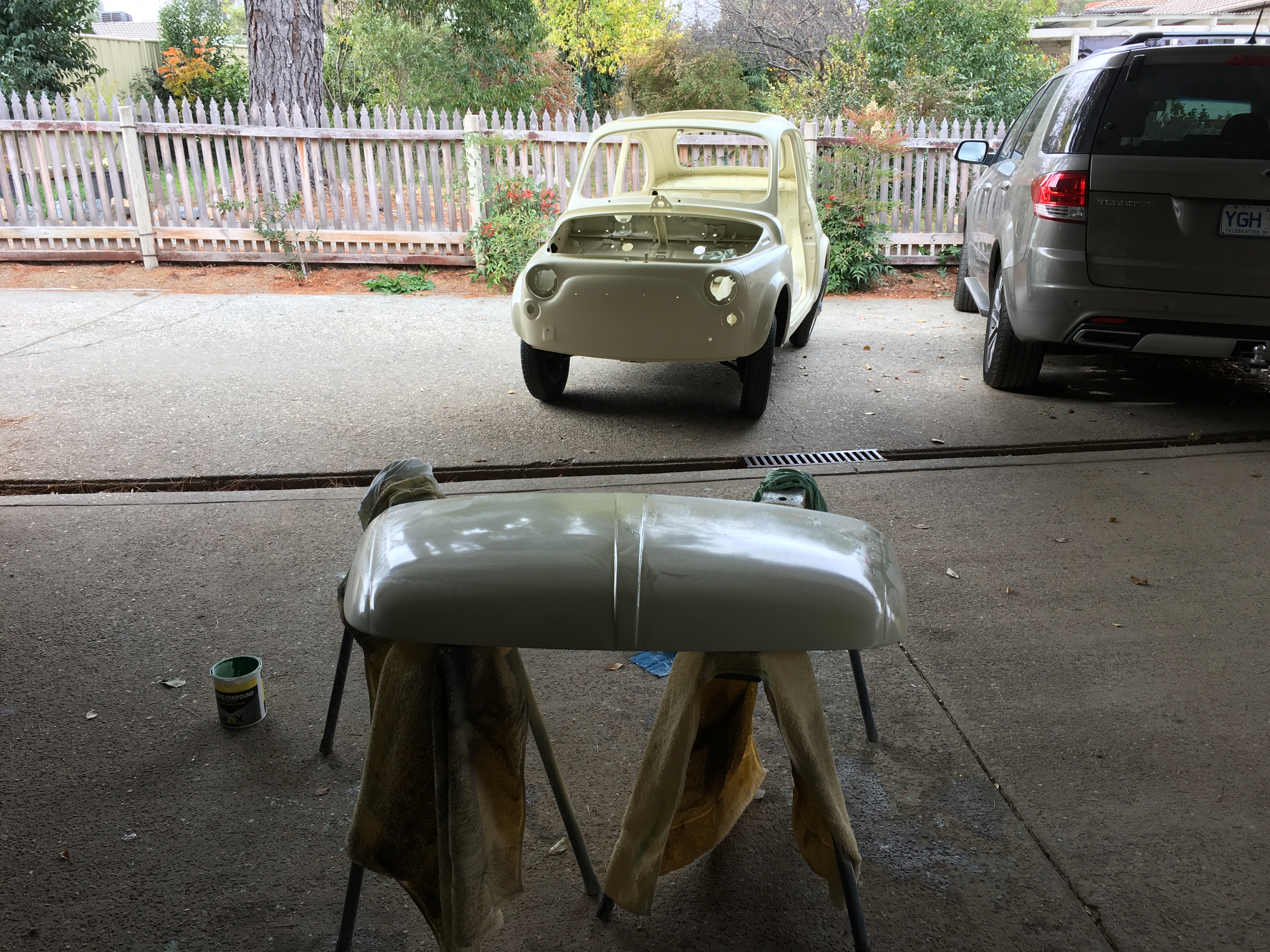

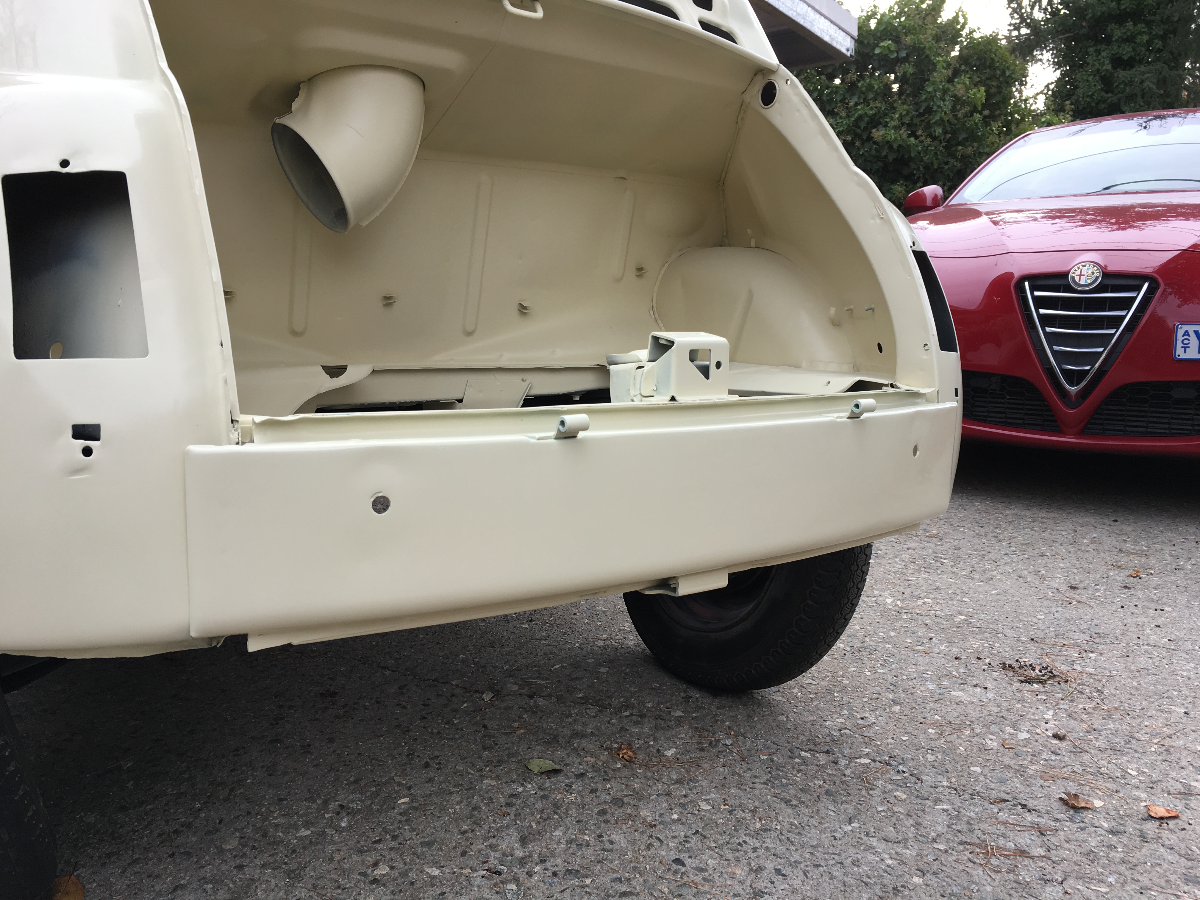

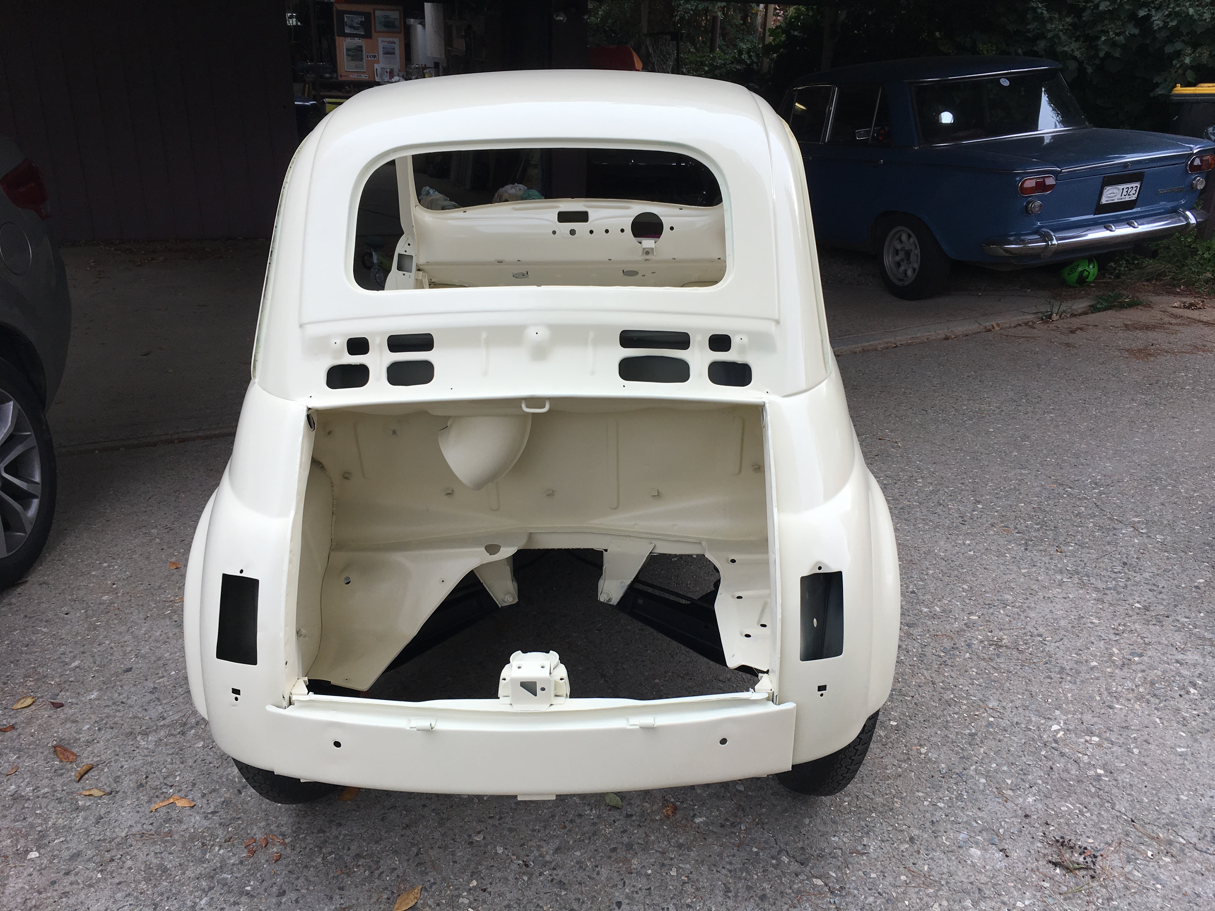

Out in the bright sunshine. Front quarter panel and lower windscreen frame done today.
The car is a chameleon and keeps changing colour. (Although I think it is reluctant to go back to its very bright yellow however much it would please my daughter. )

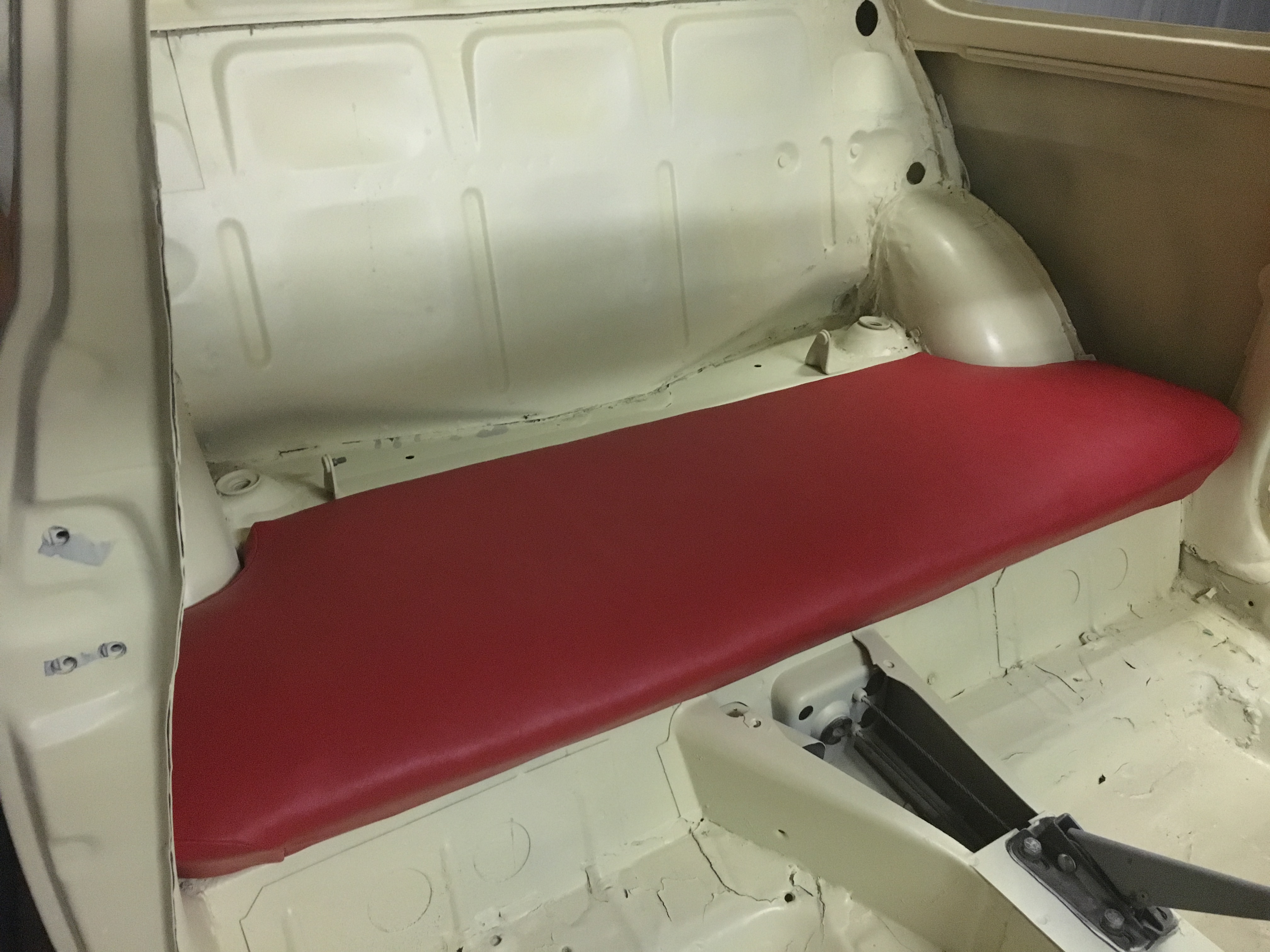

I popped into reupholster yesterday to see how much it would be for him to fit the bottom back seat cover. (It required hog rings and a special tool to bend them around. )
He had a look, popped it on his bench and very kindly fitted it straight away.
I can do the others myself as they are held in with spikes built into the frames.

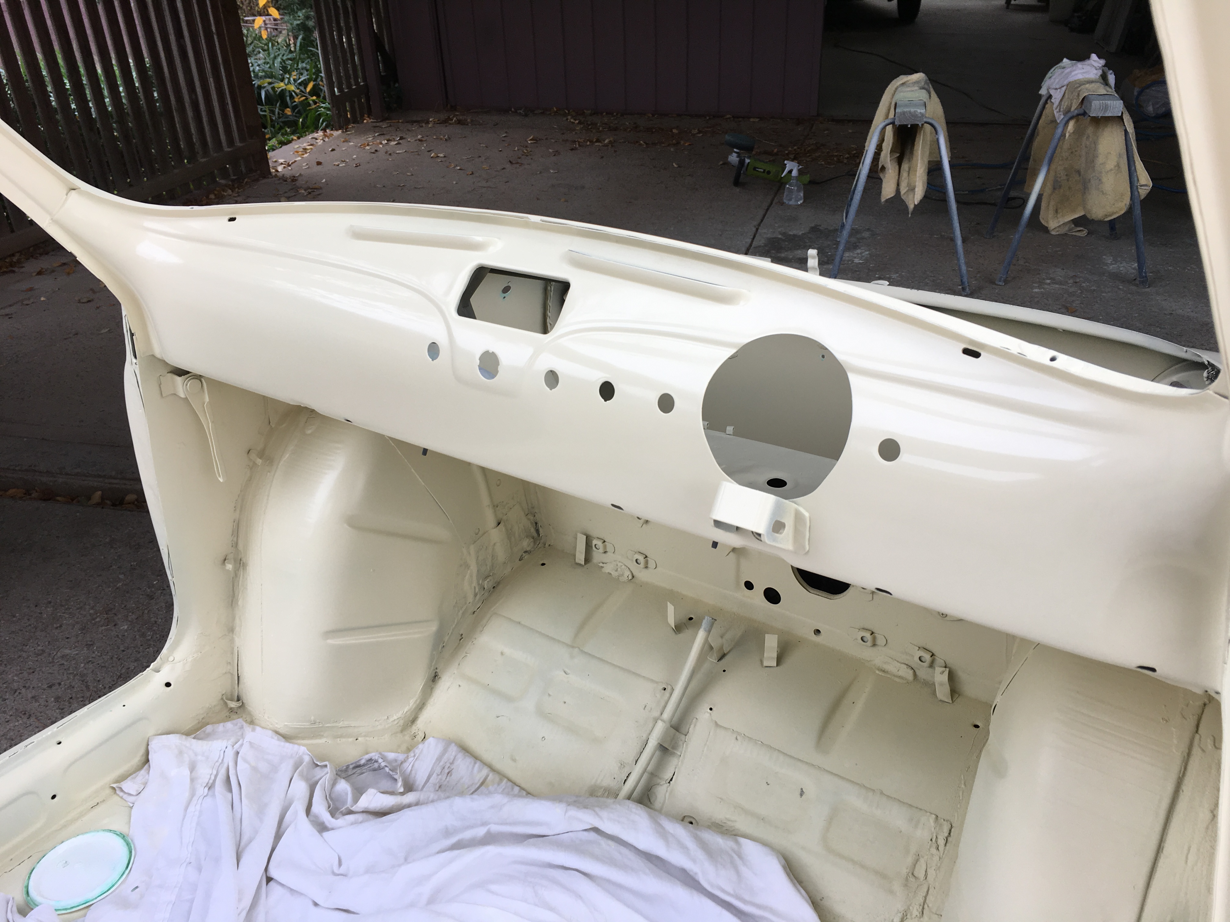

A bit more polishing completed.
I am very happy with the dashboard and considering that’s the part I will see the most when driving, that’s a good thing.

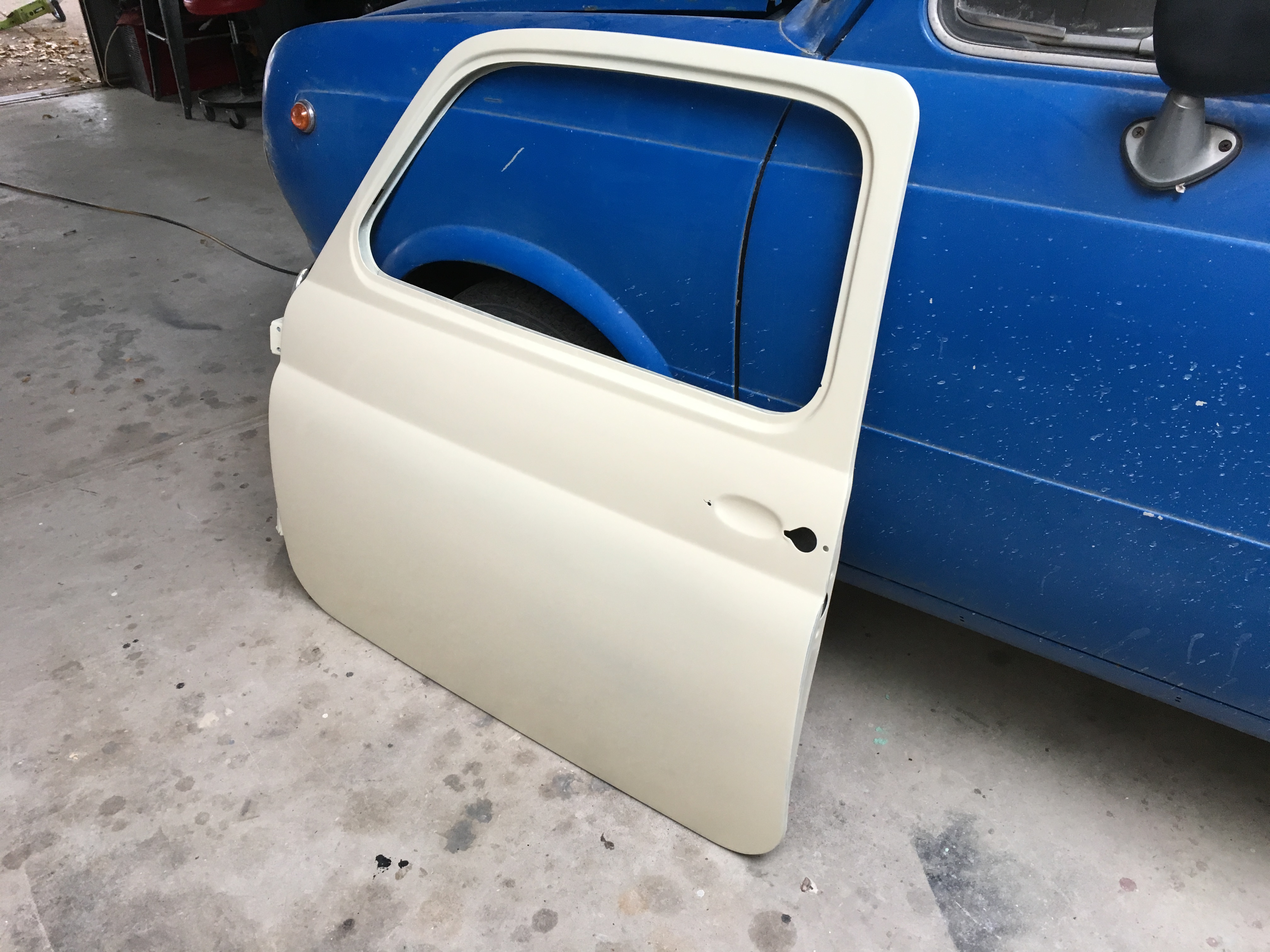

Doors are a lot better than when I started. A little beating, a few skims of filler and countless hours of sanding and priming.

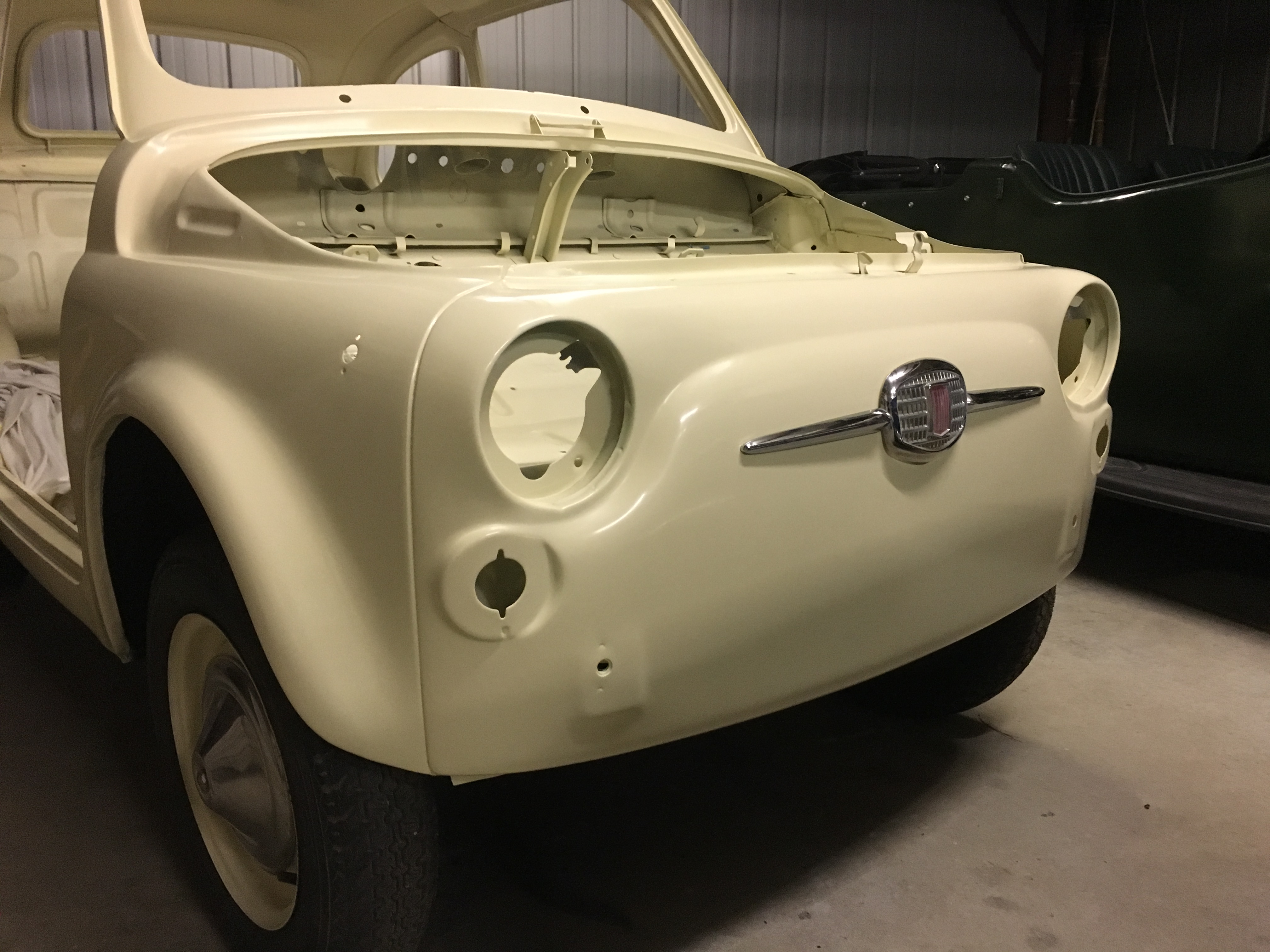

Tried the badge just for fun. This is a 500r panel that I filled the oblong badge area and drilled holes for the f badge.
(When I was ordering panels from Germany, at the time, the f panel was not available)
That's looking good.
I've said before, I found that my 1969 "F" came from the factory with an "L" front panel; in that case, the winged badge simple covers the indent. Once they designed the car properly, including re-locating the horn there was no need to have a silly hole in the panel. ;)

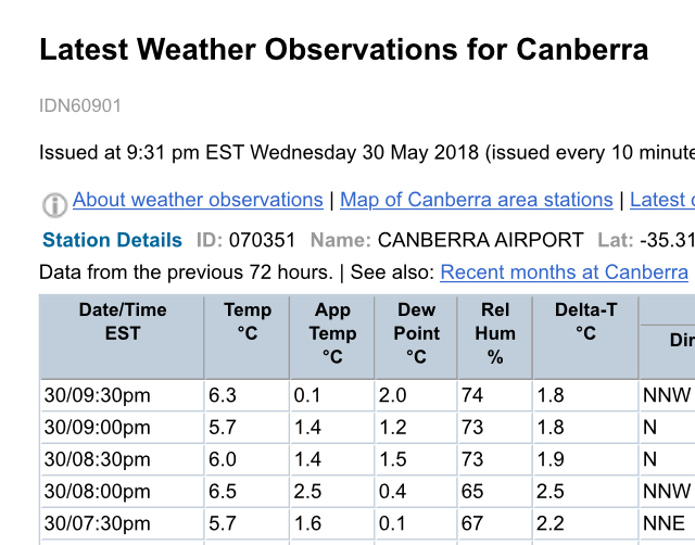

Up North that would be the case but where I am the average winter temp ranges from 0 to 10C The average temperature graph for the year looks like a roller coaster.
Looking at the current temperature I should really go out and work on the car as it is not below zero.
