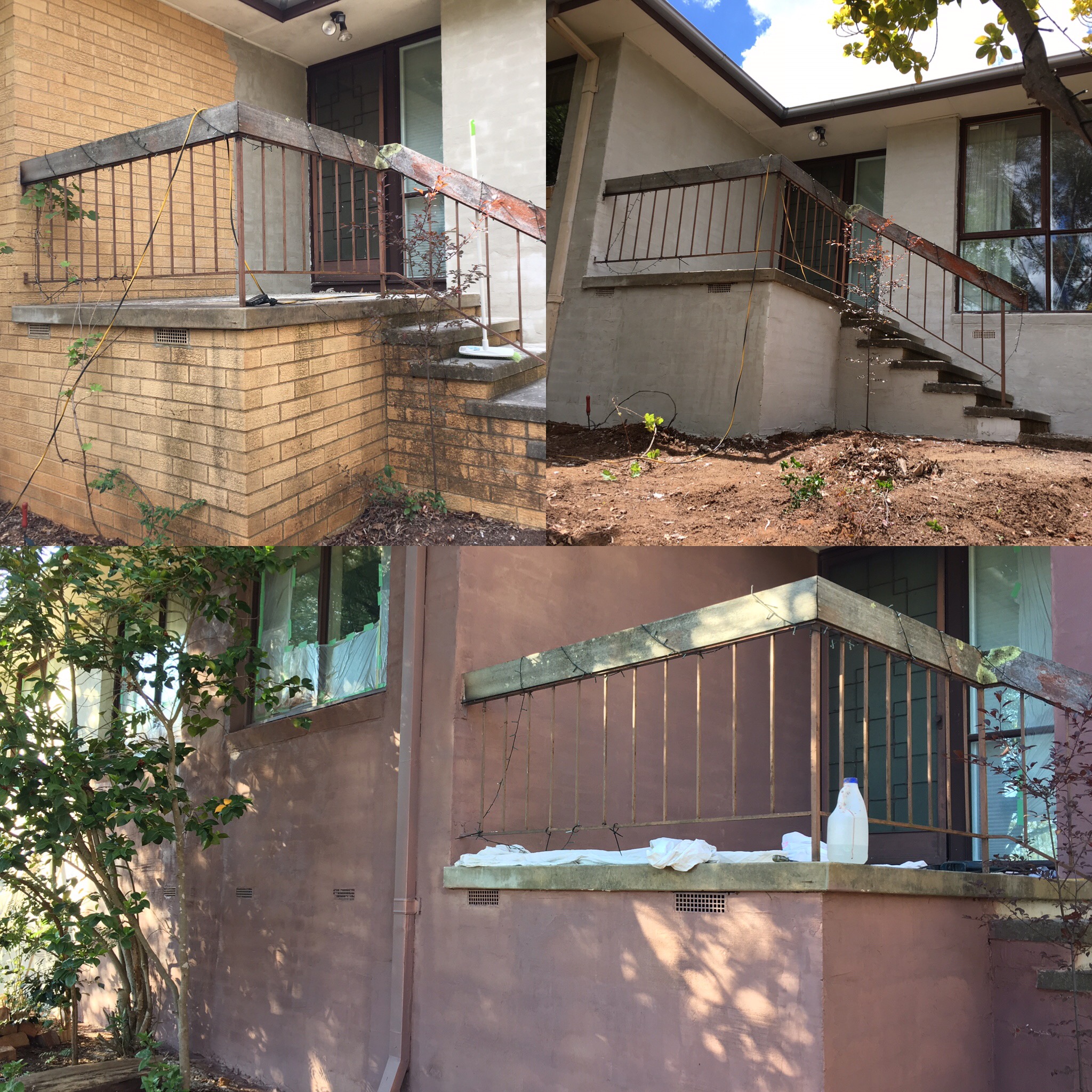

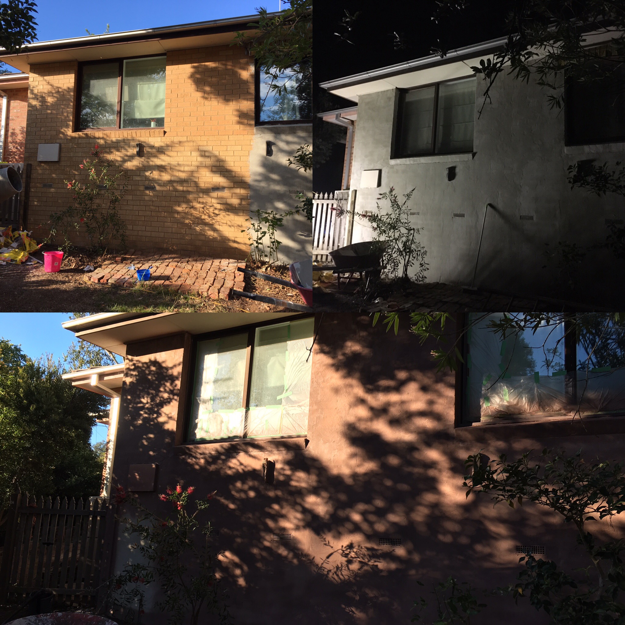

I rendered and painted the front half of our house about 8 years ago. Finally did the back half. A job I had been putting off while I had Fiats and Austin 7 to work on... transformation over the last three weekends...

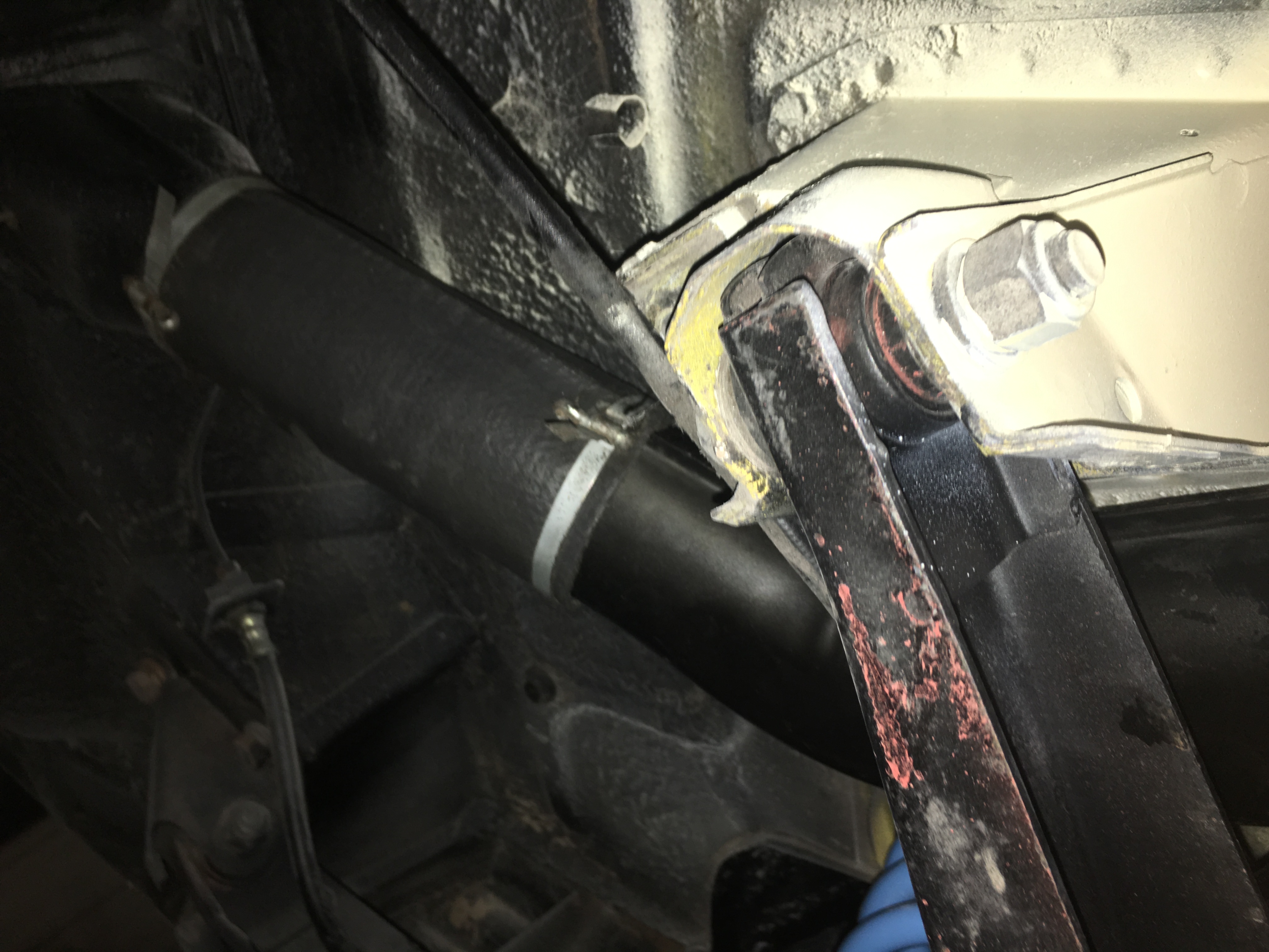

Not a very exciting update but just before bed last night I popped out and installed the heater tube. One small step closer to installing the engine and gearbox.

Hi Geoff,
Have you seen the Fiat Special Tool for loosening/tightening the above hose clamps - it's like a short and a long section of tube welded together into a T shape, the tube ends being flattened to fit the part of the hose clamp that is turned. The short side has a bend, this allows the tool to be used in different positions/locations.
Many people resort to pliers/small screwdrivers/90 degree picks etc, but the correct tool makes it easier.
I trust you'll be doing something about the ends of the steel bands that are protuding - these can inflict a nasty cut. You'll probably have your own ideas but I used to slip a pin or small screwdriver under the steel band next to the adjuster, press down on the free end and pull out the pin/screwdriver, leaving the band following the curve of the hose clamp with none of it sticking out.
Just a thought :)

Thanks Al. I must admit I just used pointy nosed pliers. It had not occurred to me the possibility of injury so I will follow your tip and make it a bit safer.

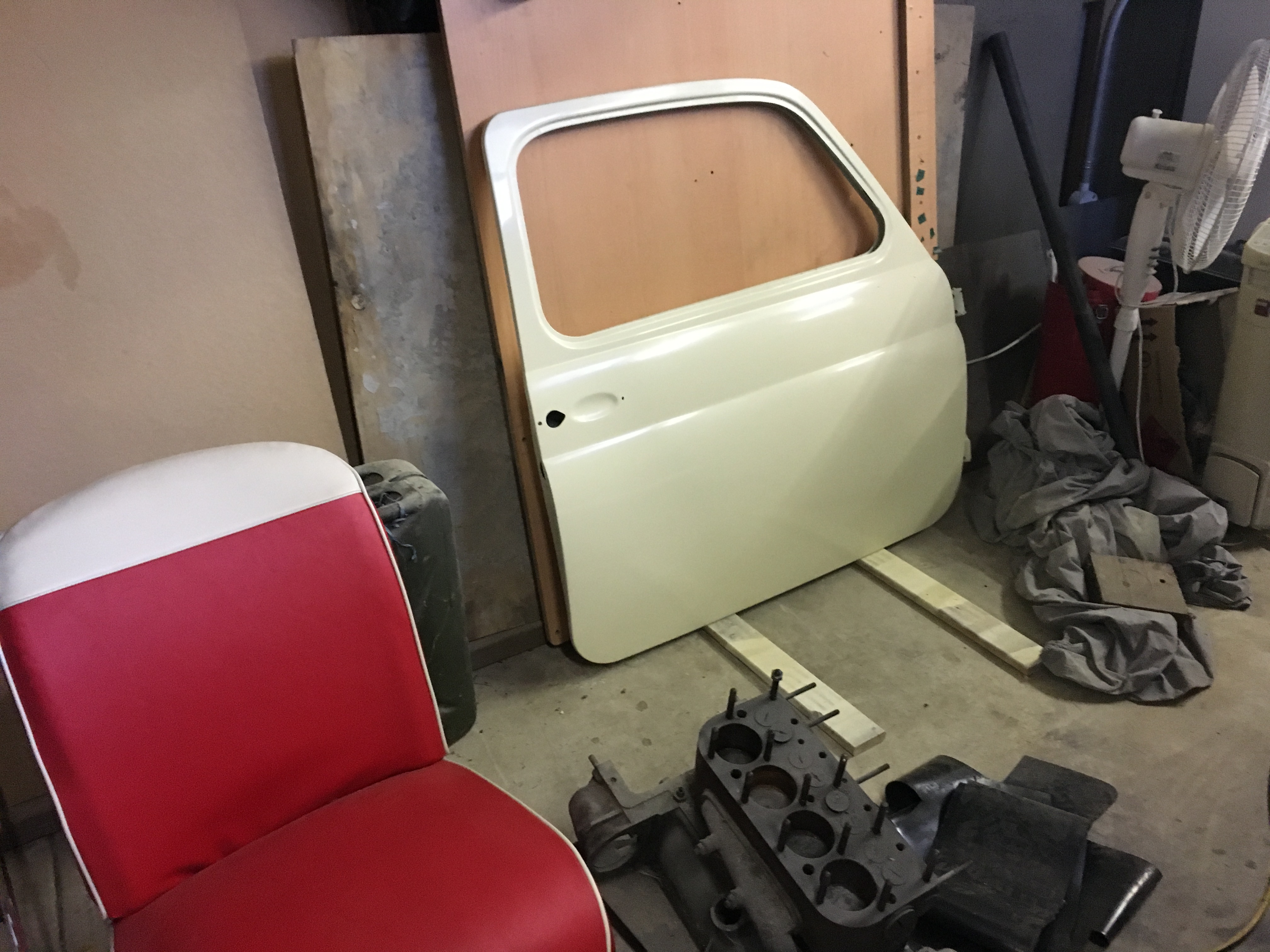

My youngest daughter (10yo) cooked our dinner tonight leaving me with enough time to polish the doors. I am tempted to bring them inside and start the long awaited reassembly.
I will follow Damien’s (Paolo66) instructions and see how I go.

Whilst it will probably have the "it must be as it came out of the factory" purists holding their hands up in horror, I have tended to use large 'stainless' jubilee clamps or, for the large air-inlet tube, long, heavy gauge 'cable-ties' to hold them in place---quick, simple and easily put on/cut off.

For the air intake tube (in the UK) try Screwfix.....big, stainless-steel hose-clips. The original clips are not much better than pipe-cleaners ( if anyone remembers what they are). Ten in a pack... enough to last a lifetime. :)
