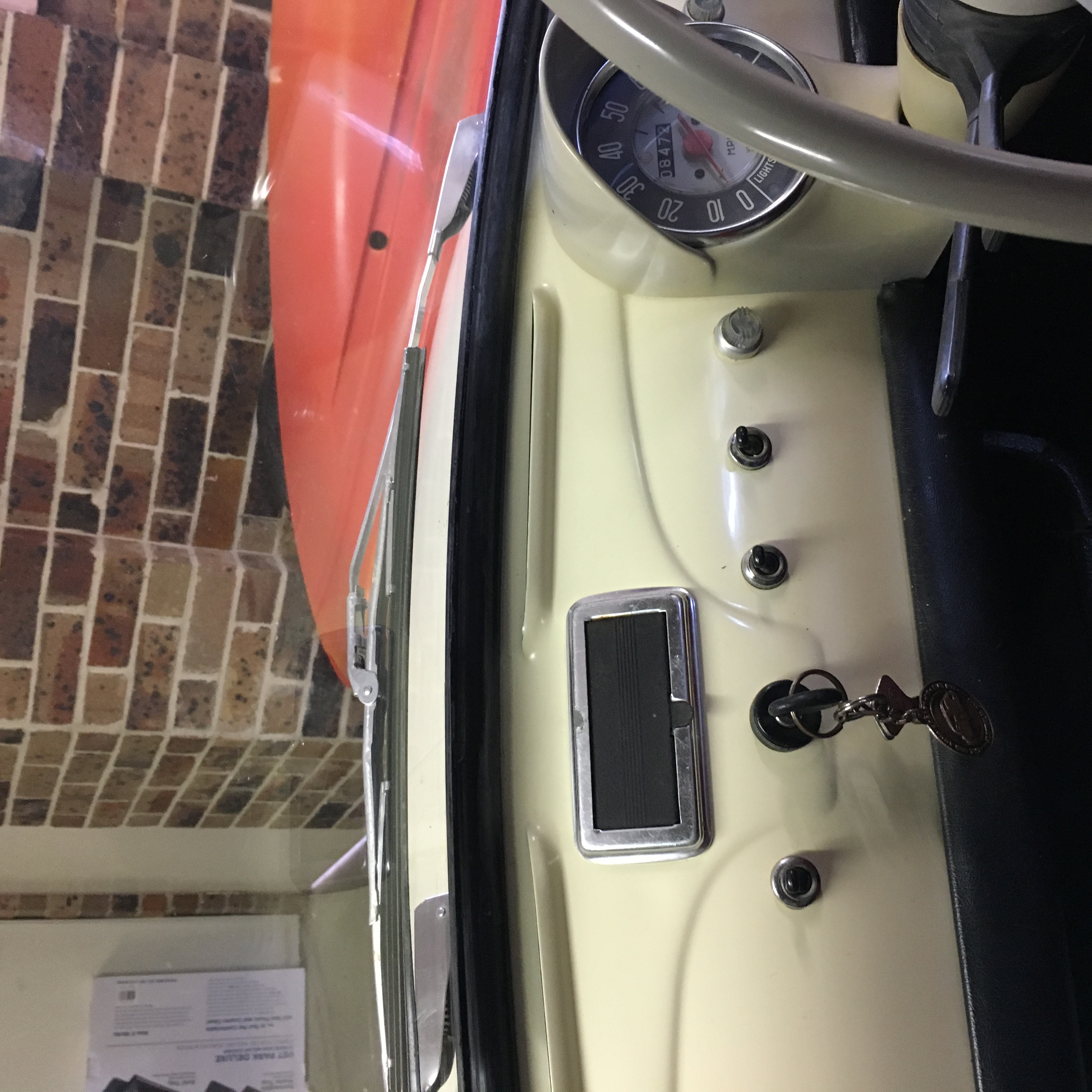

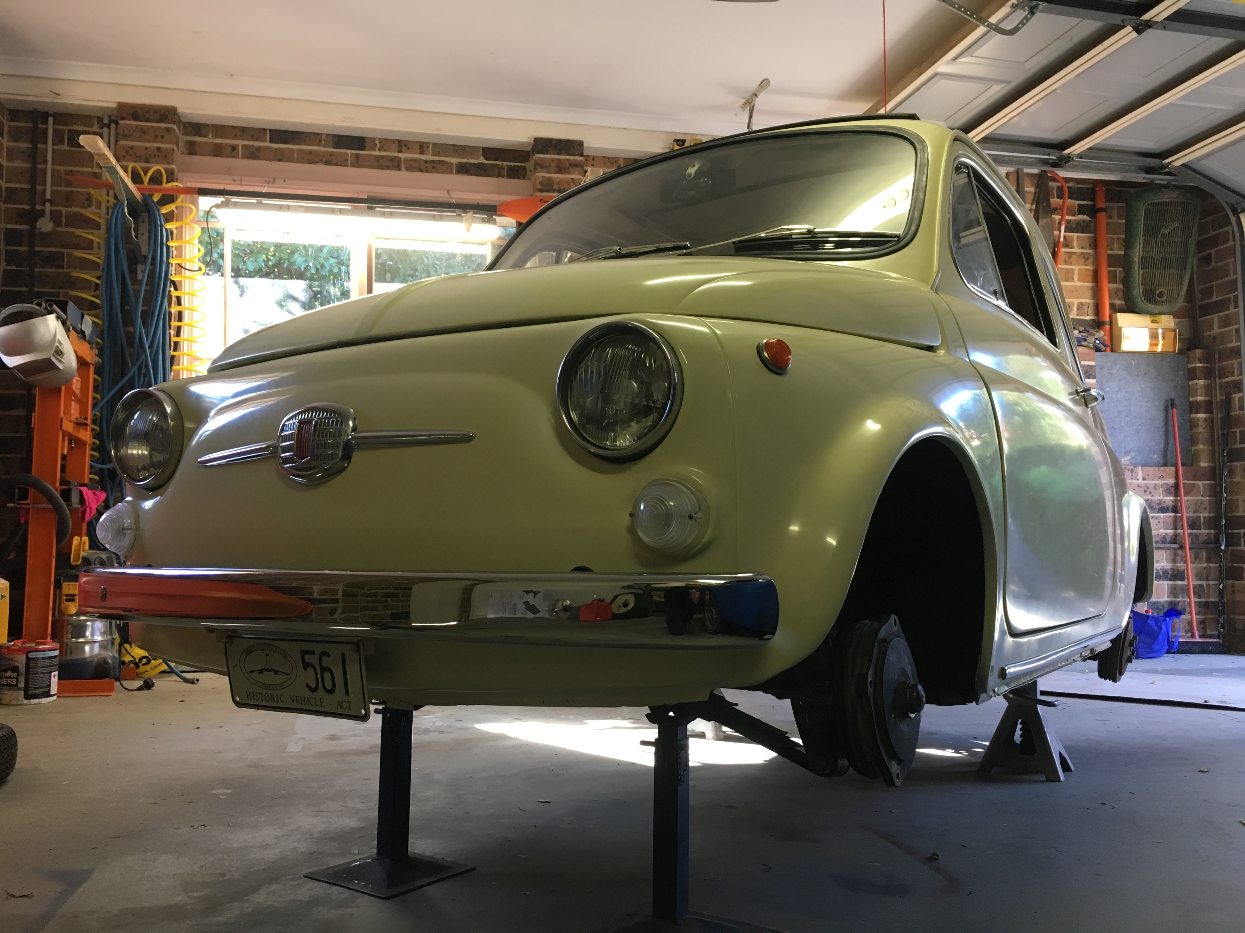

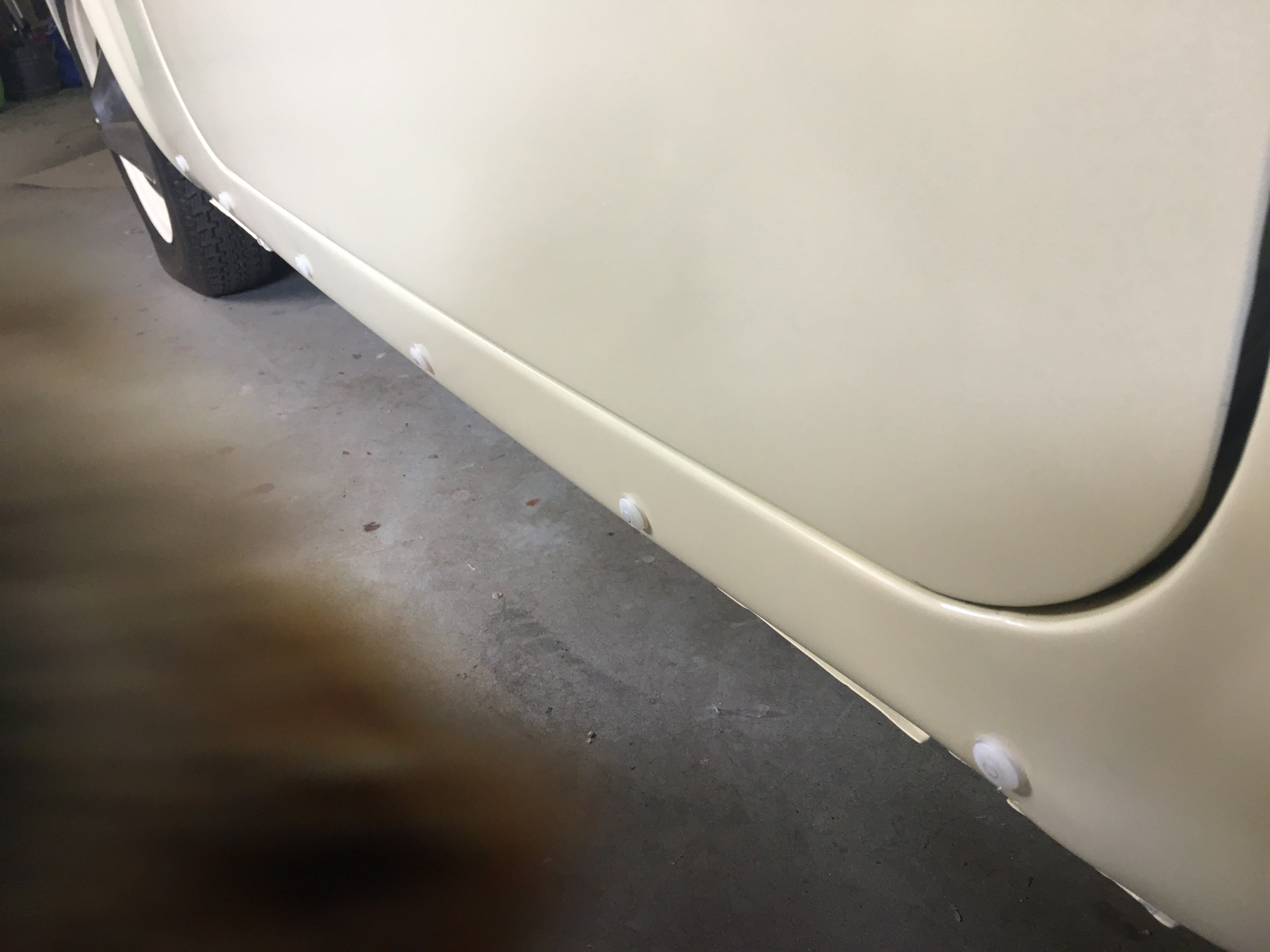

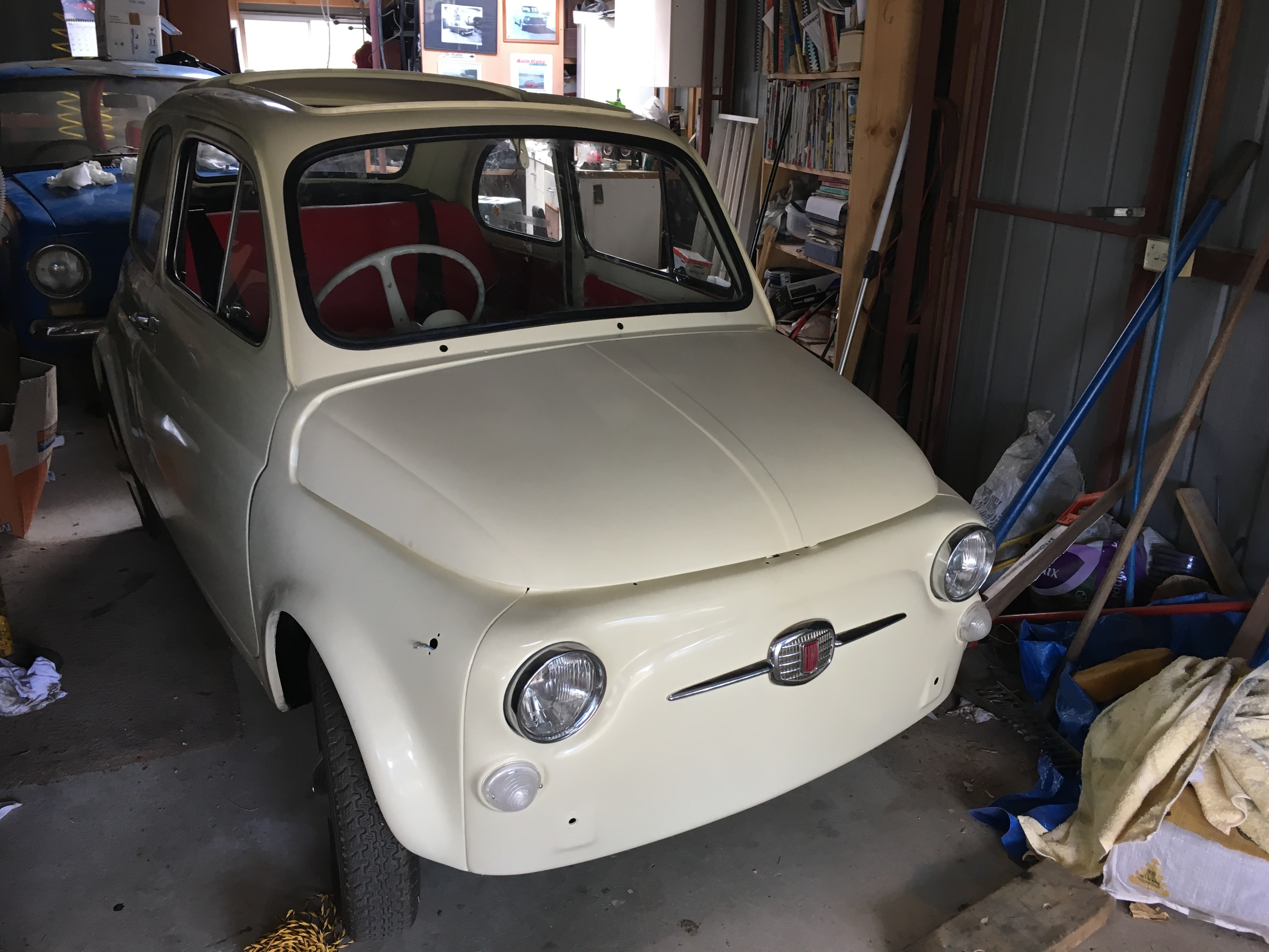

Also we had family visiting for Christmas and my nephew James was keen to do a bit of work on the Fiat. We fitted the windscreen with a bit of trial and error. The rubber cord I used popped out so I ended up using my finger the guide the seal over the lip with James applying just enough pressure from the outside.

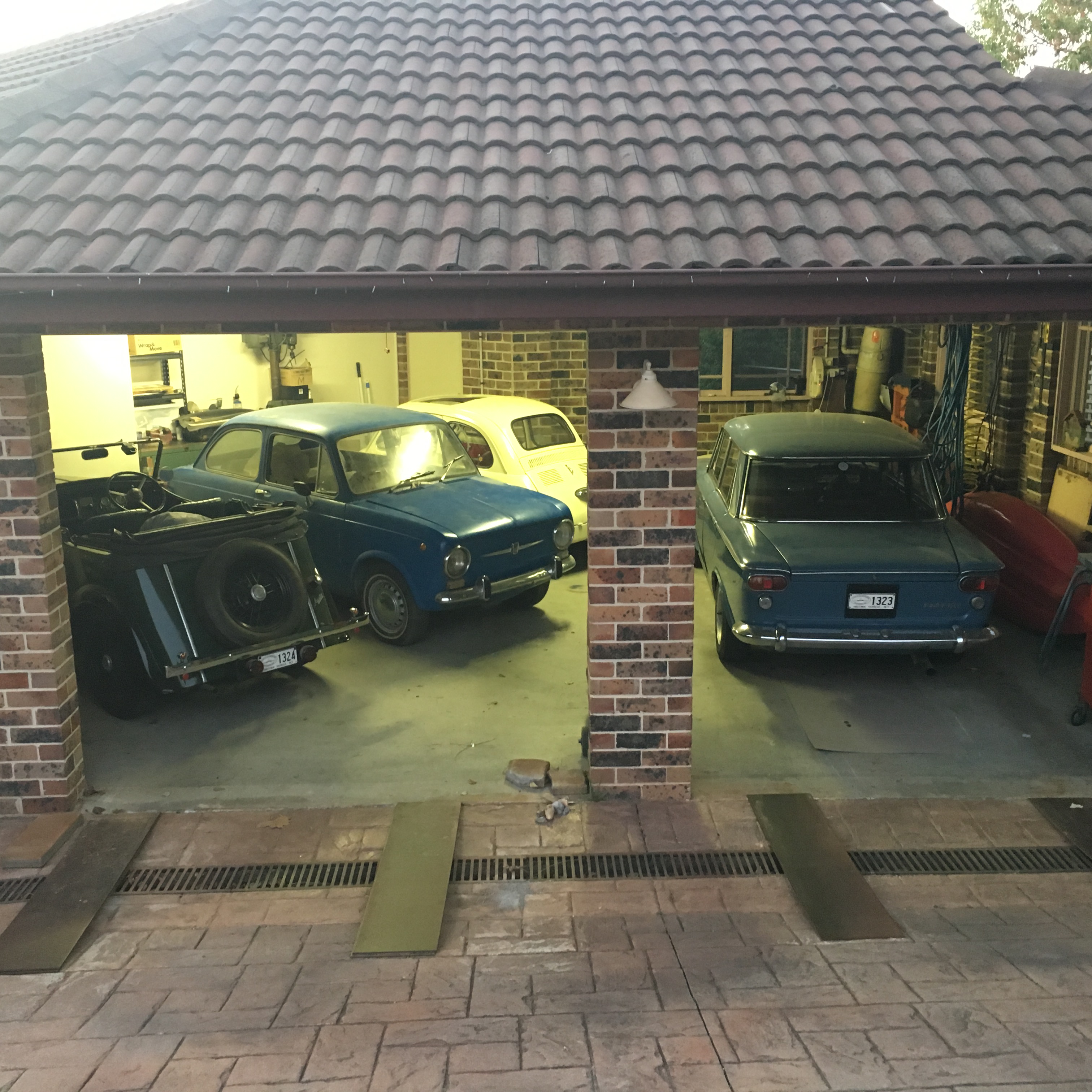

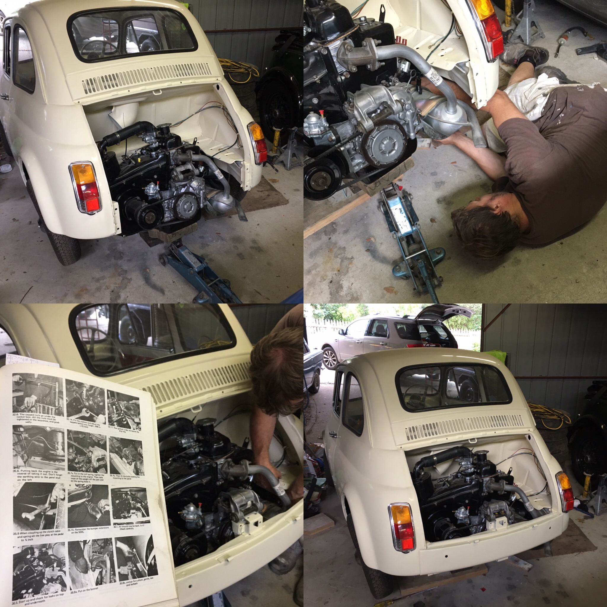

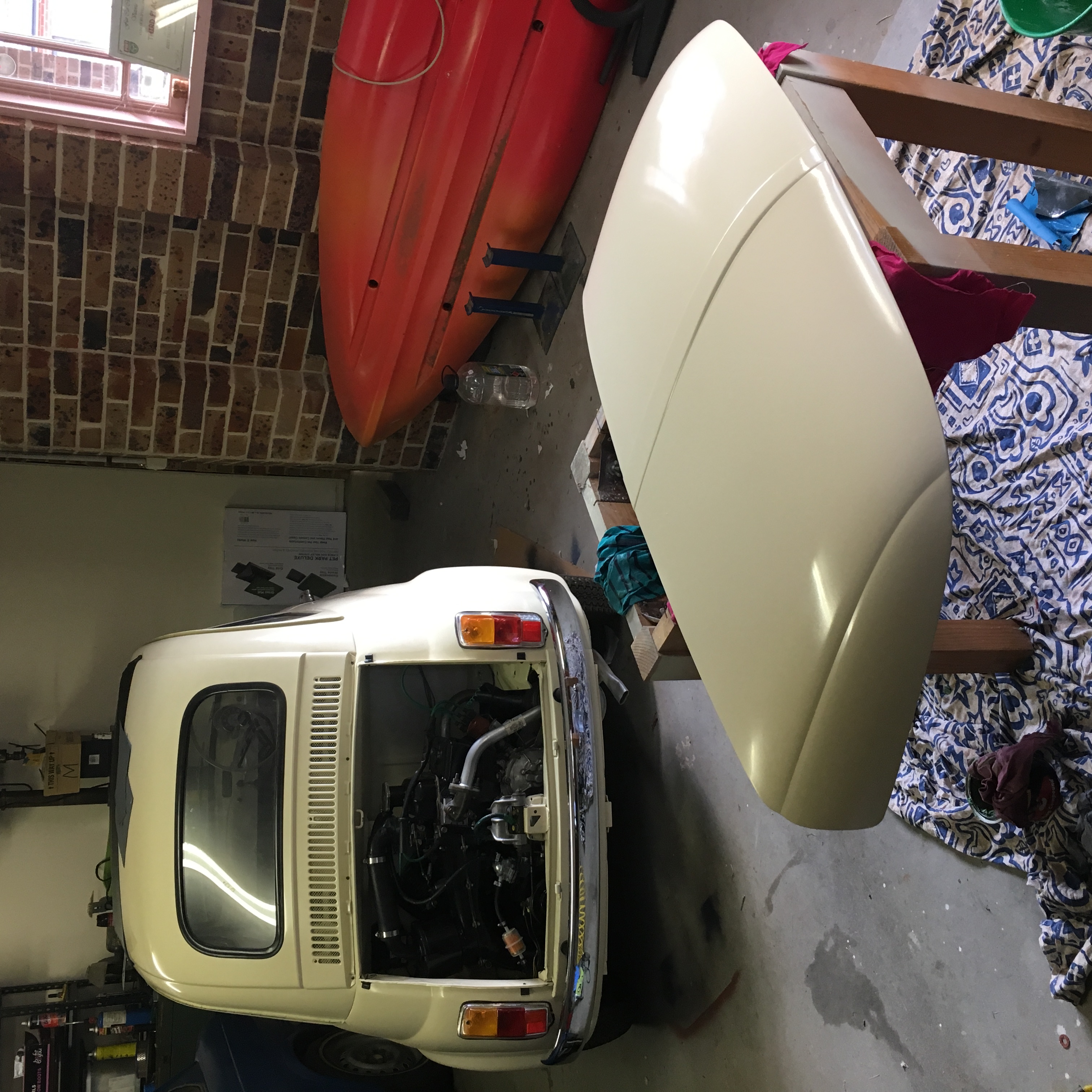

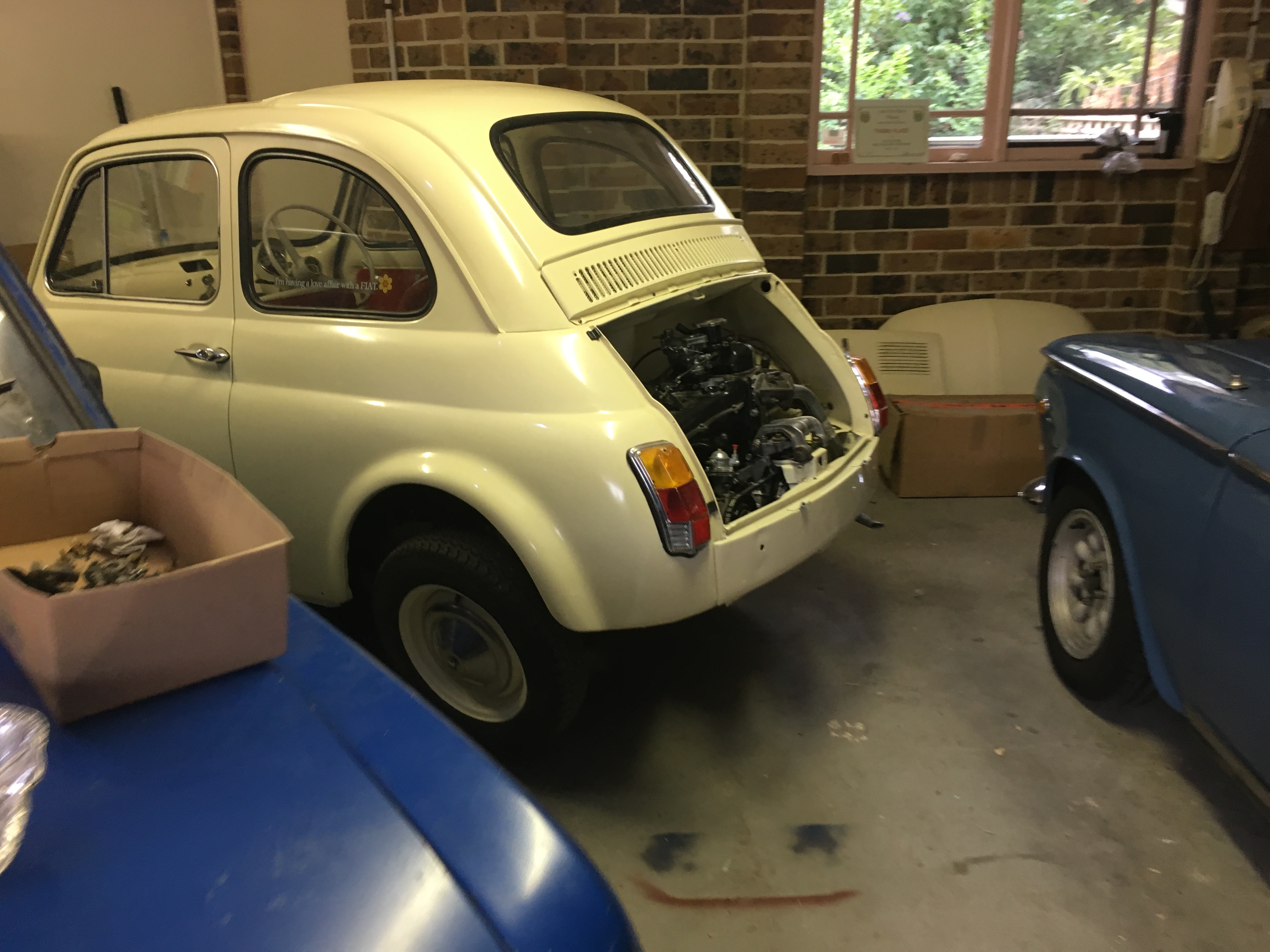

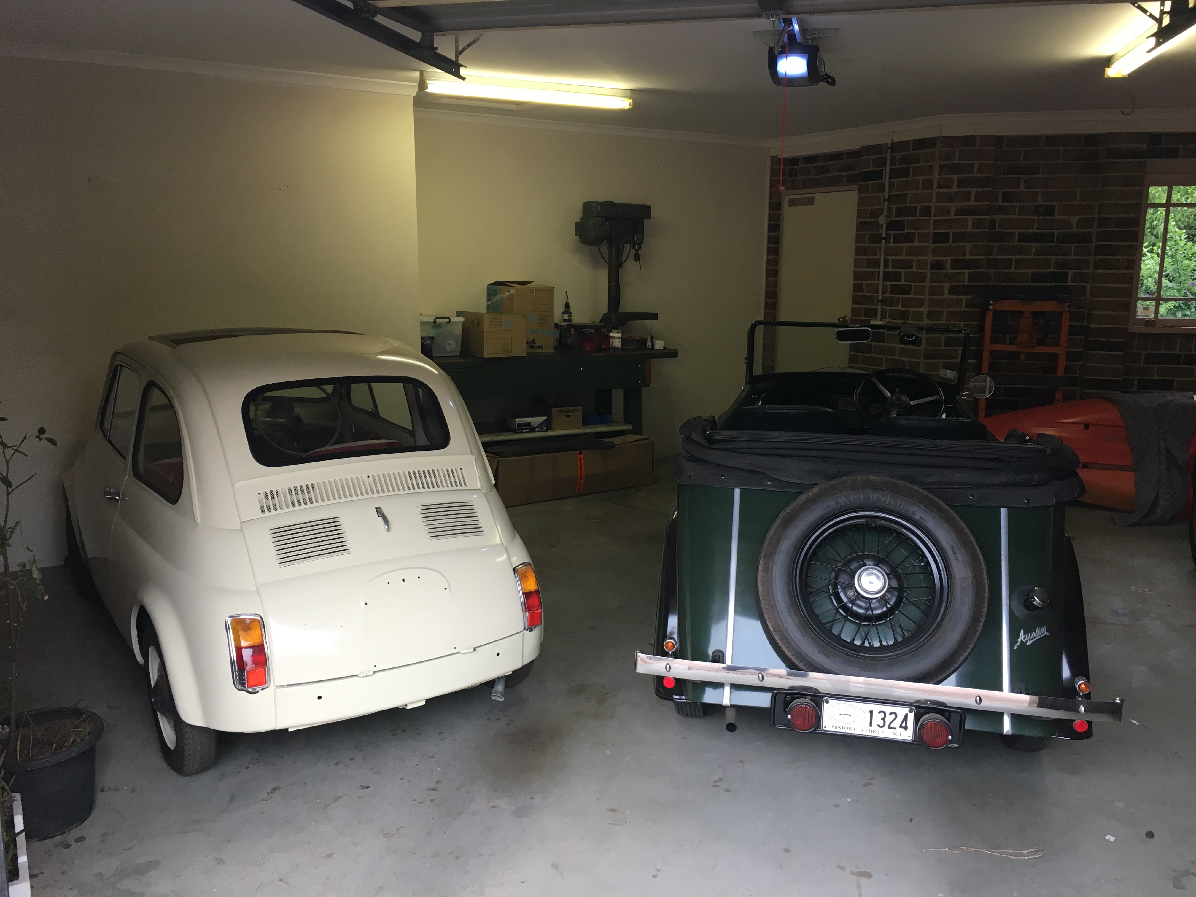

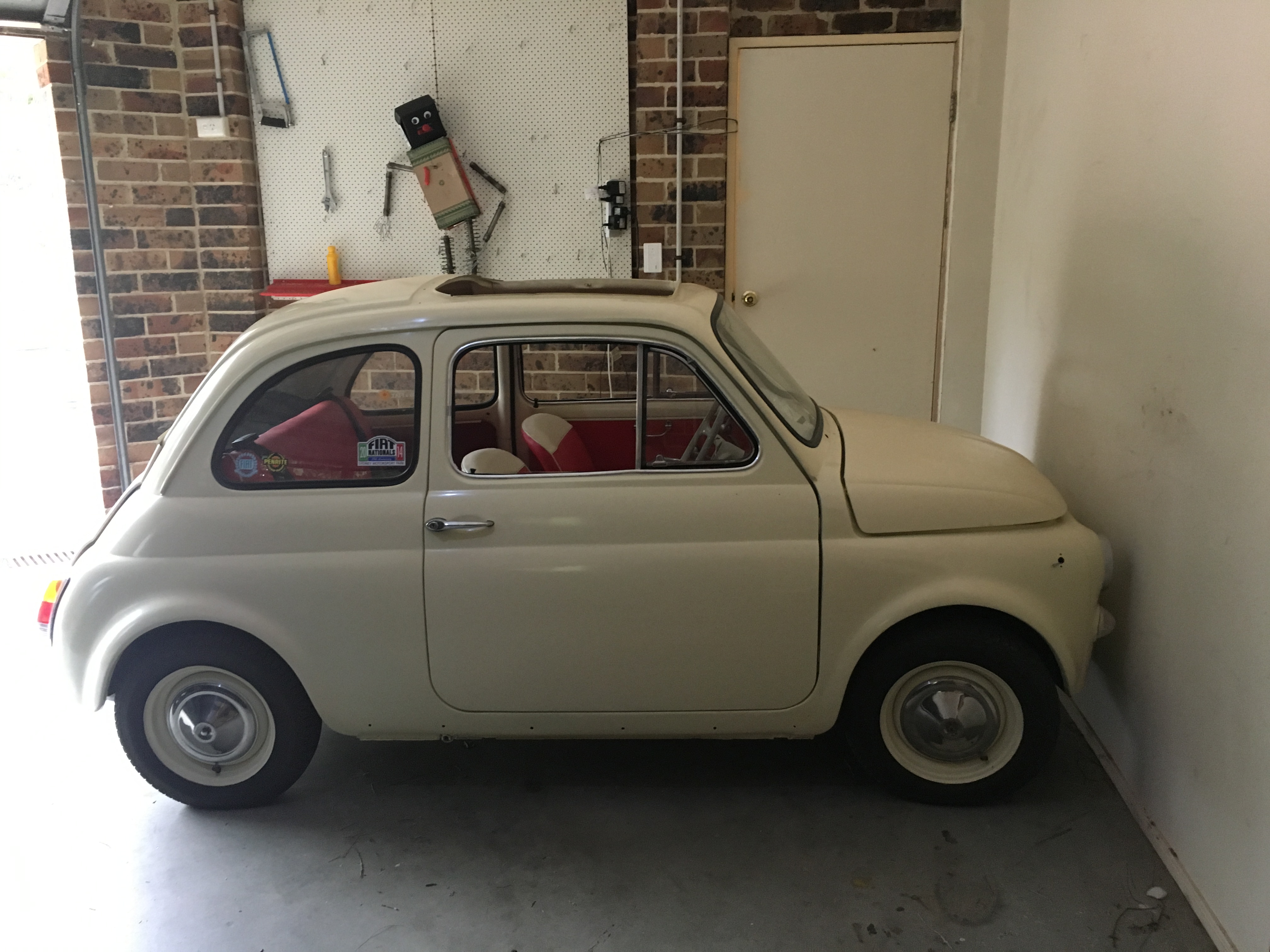

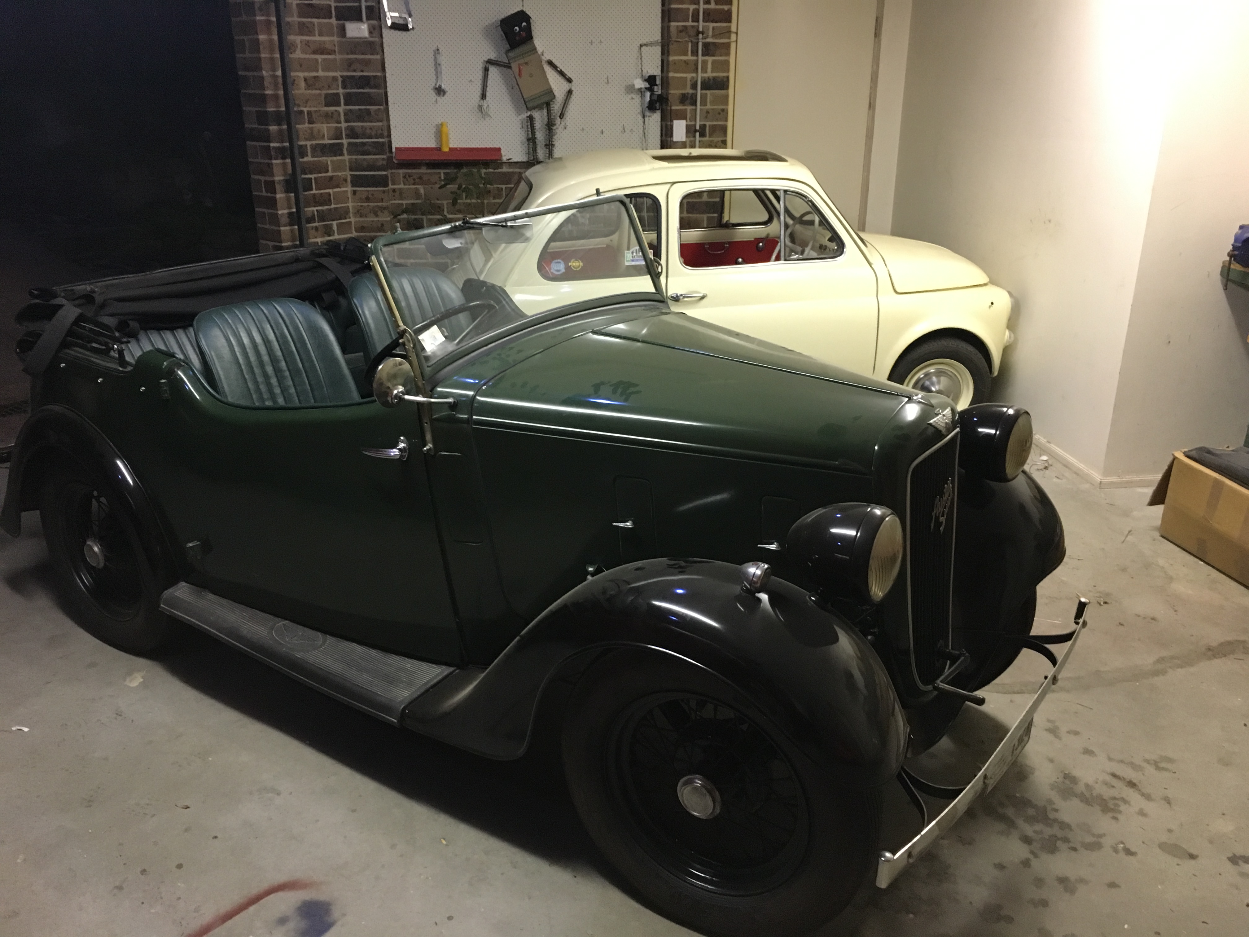

I put the engine in the 500 with help from Fiat club member James B. Nothing connected yet but at least it is in. I moved the Austin 7 and the 500 to the new house and introduced them to their cosy brick garage...
Now to start bolting more parts on.

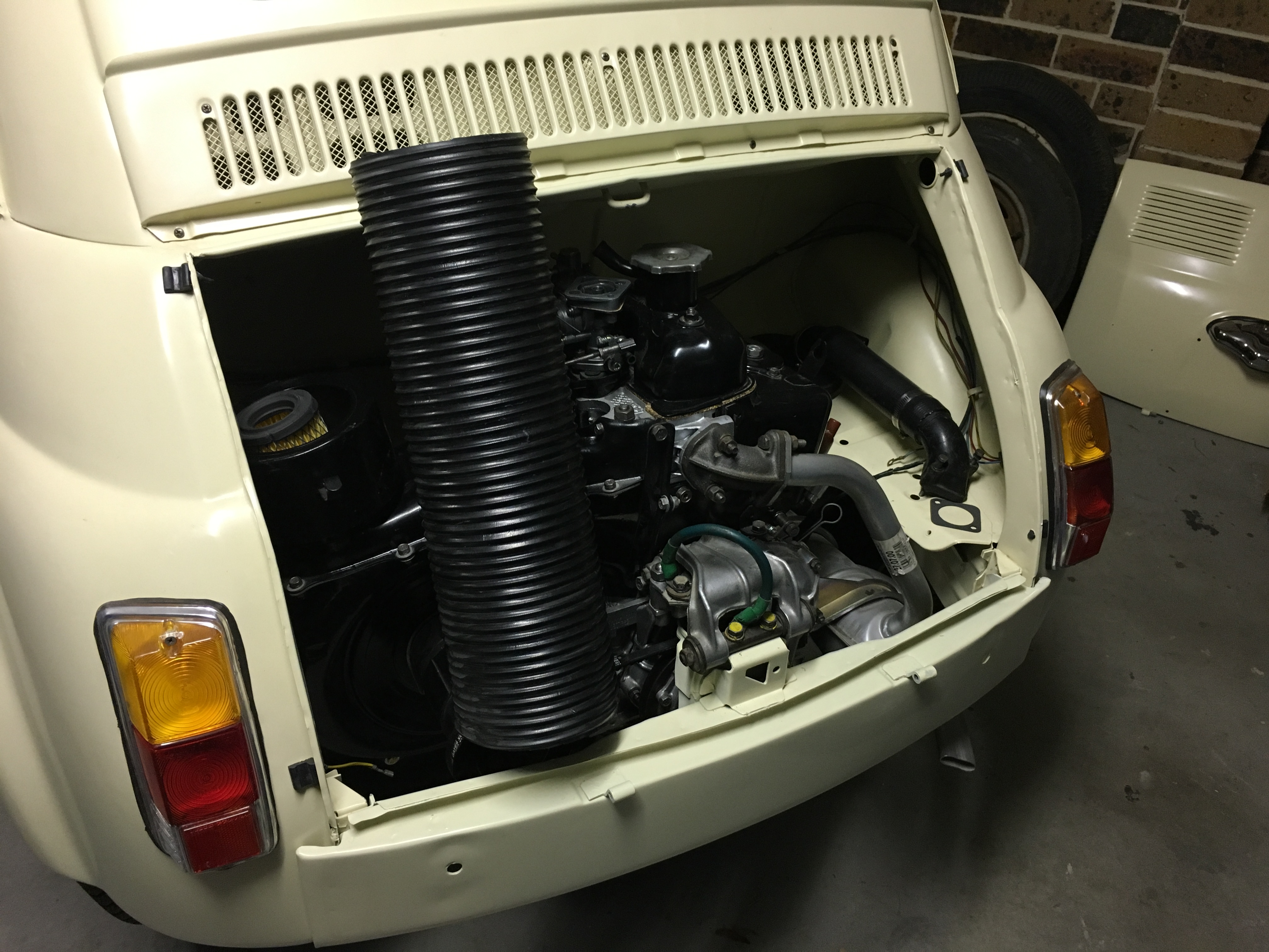

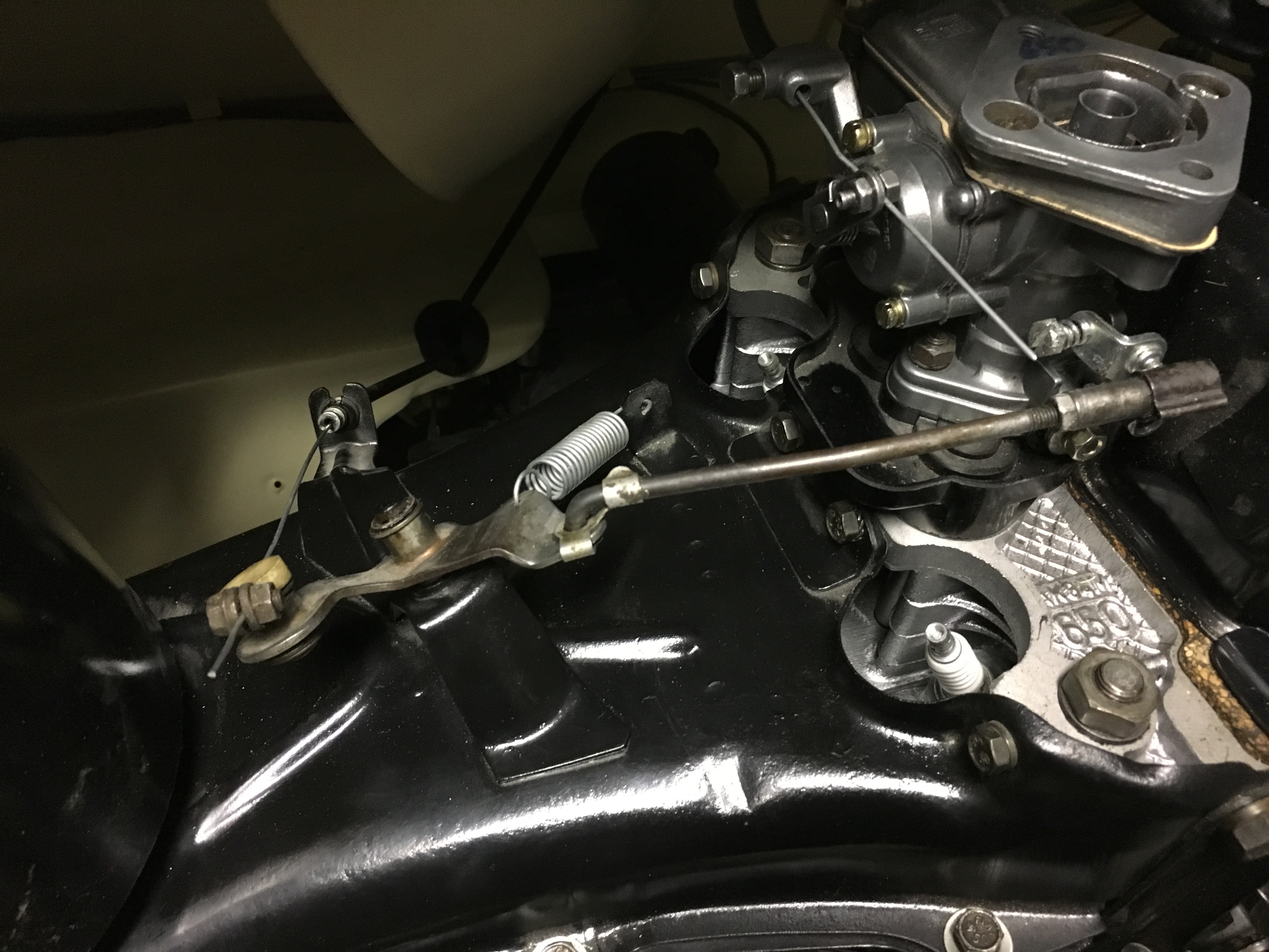

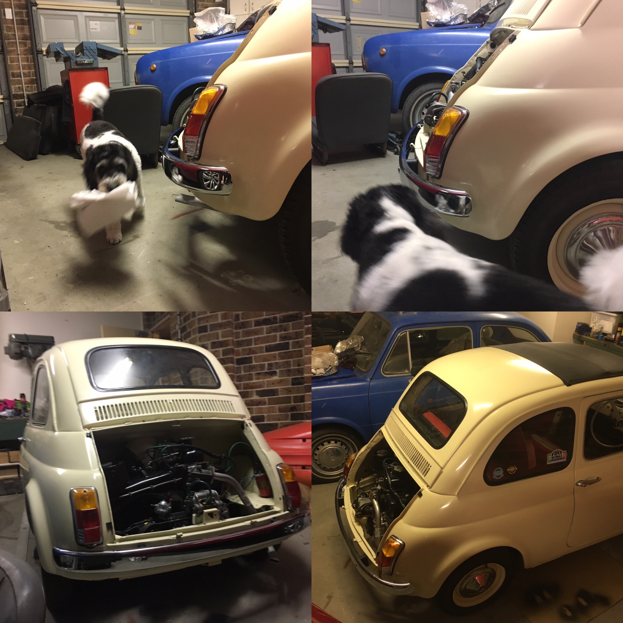

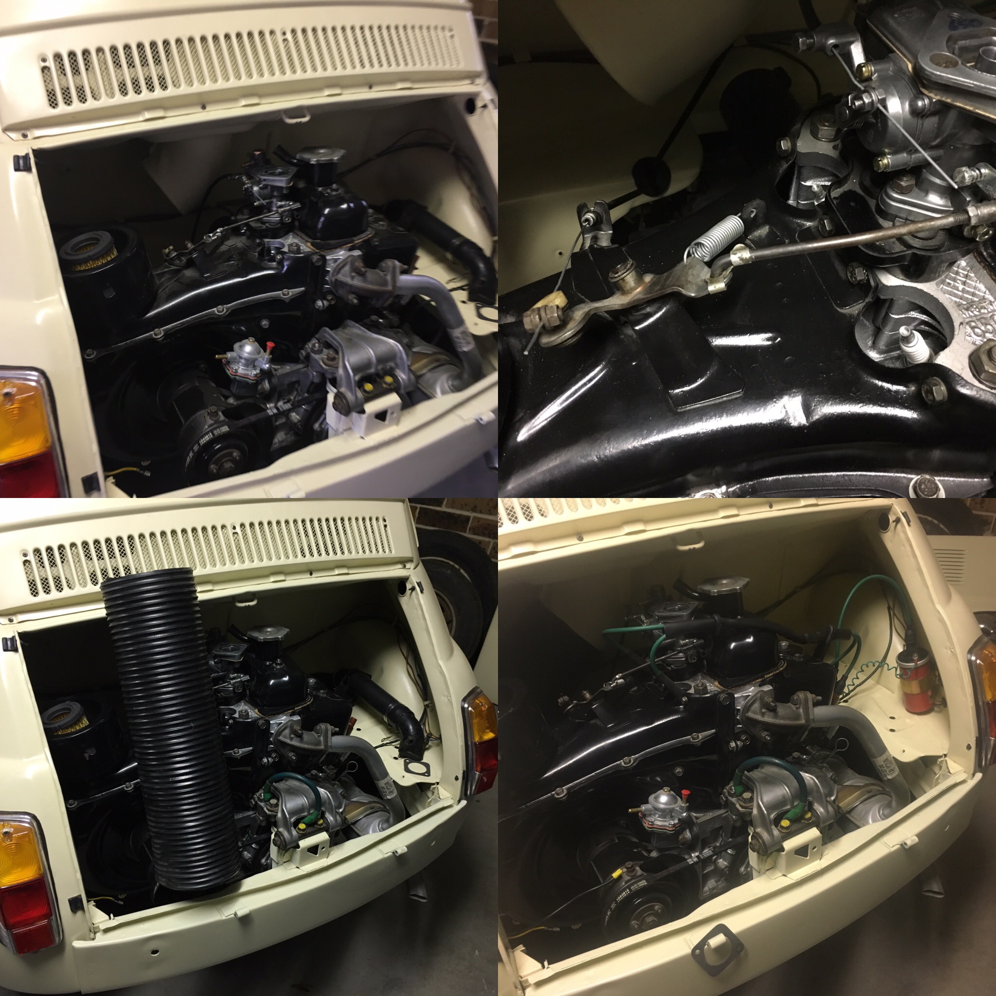

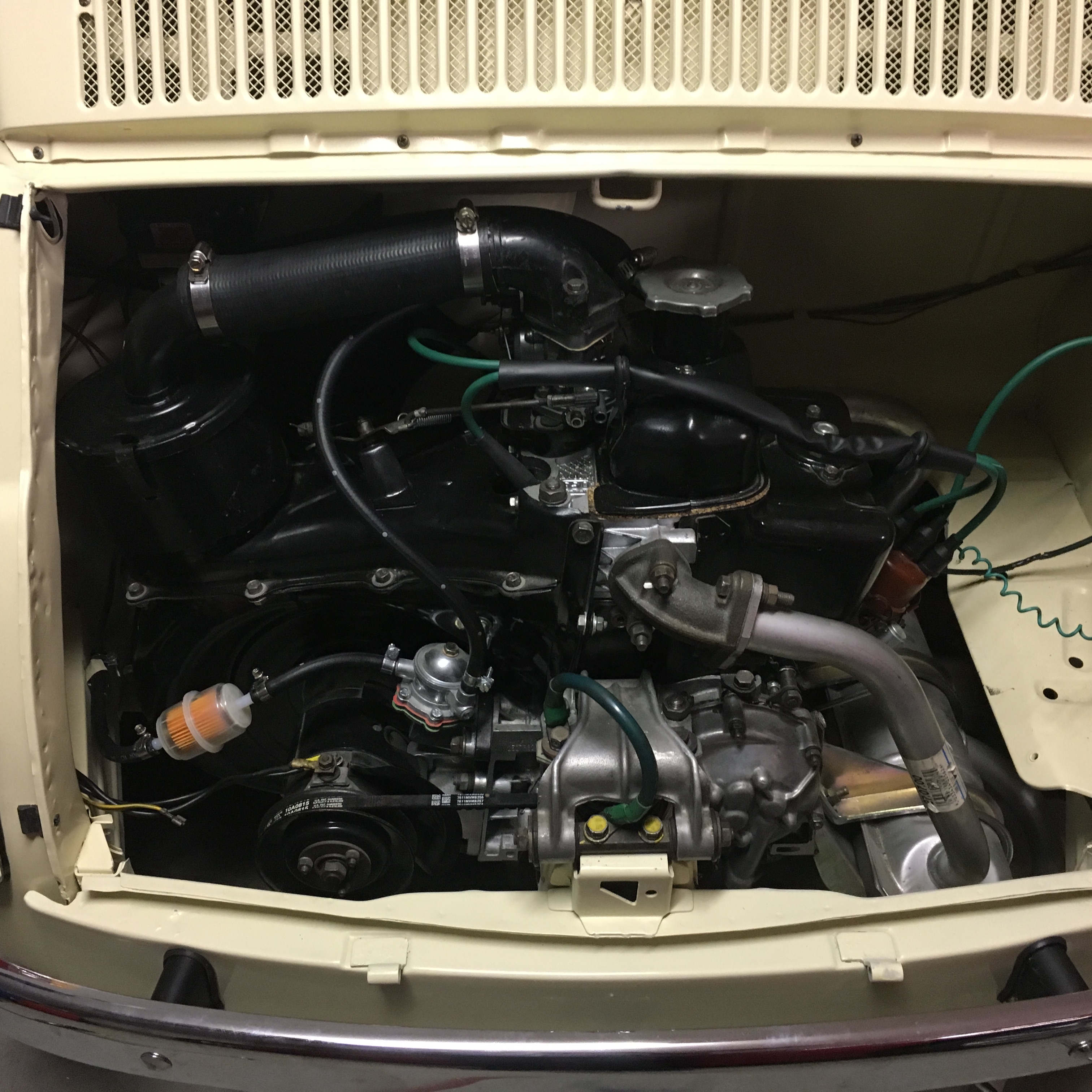

A little bit of progress some cables and air intake...

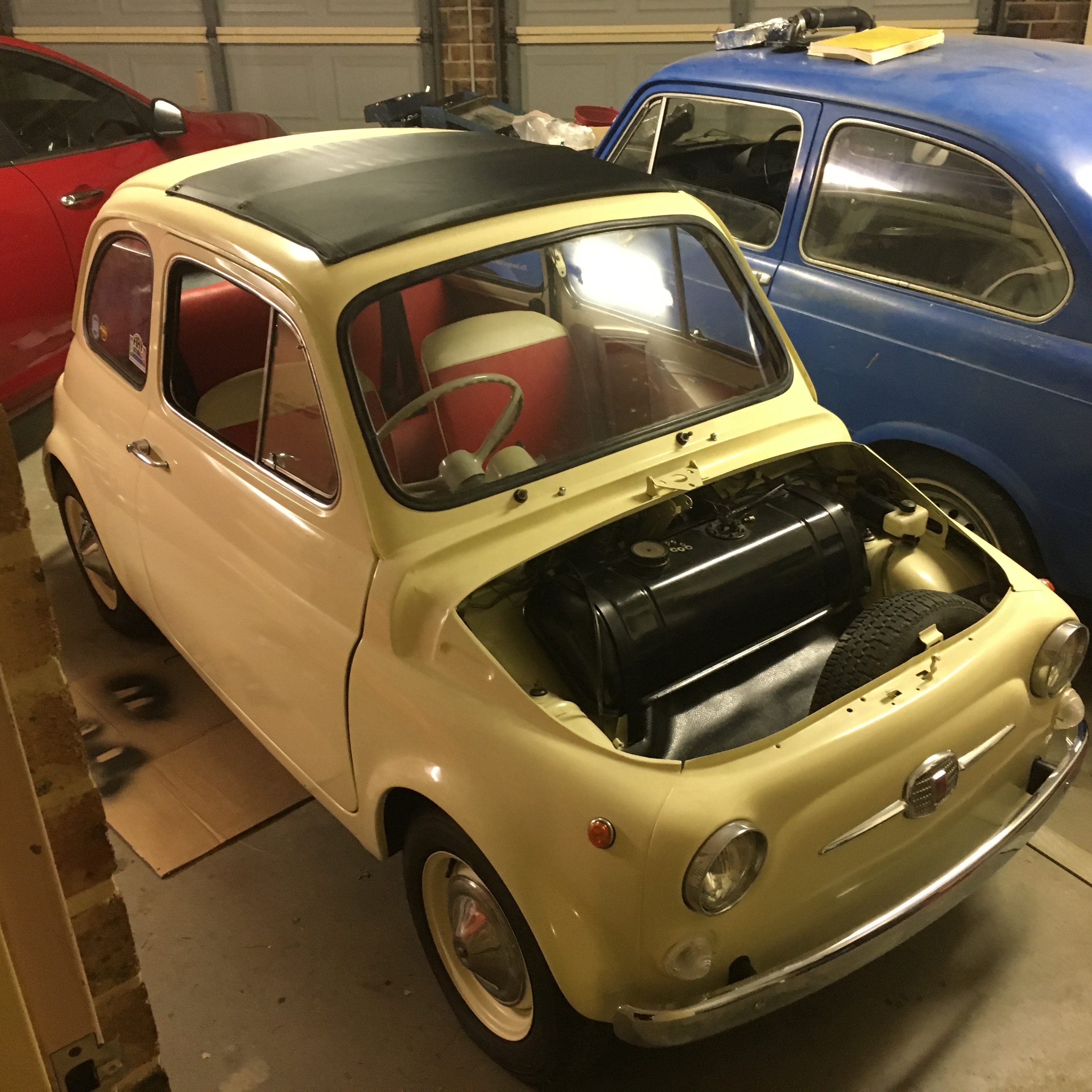

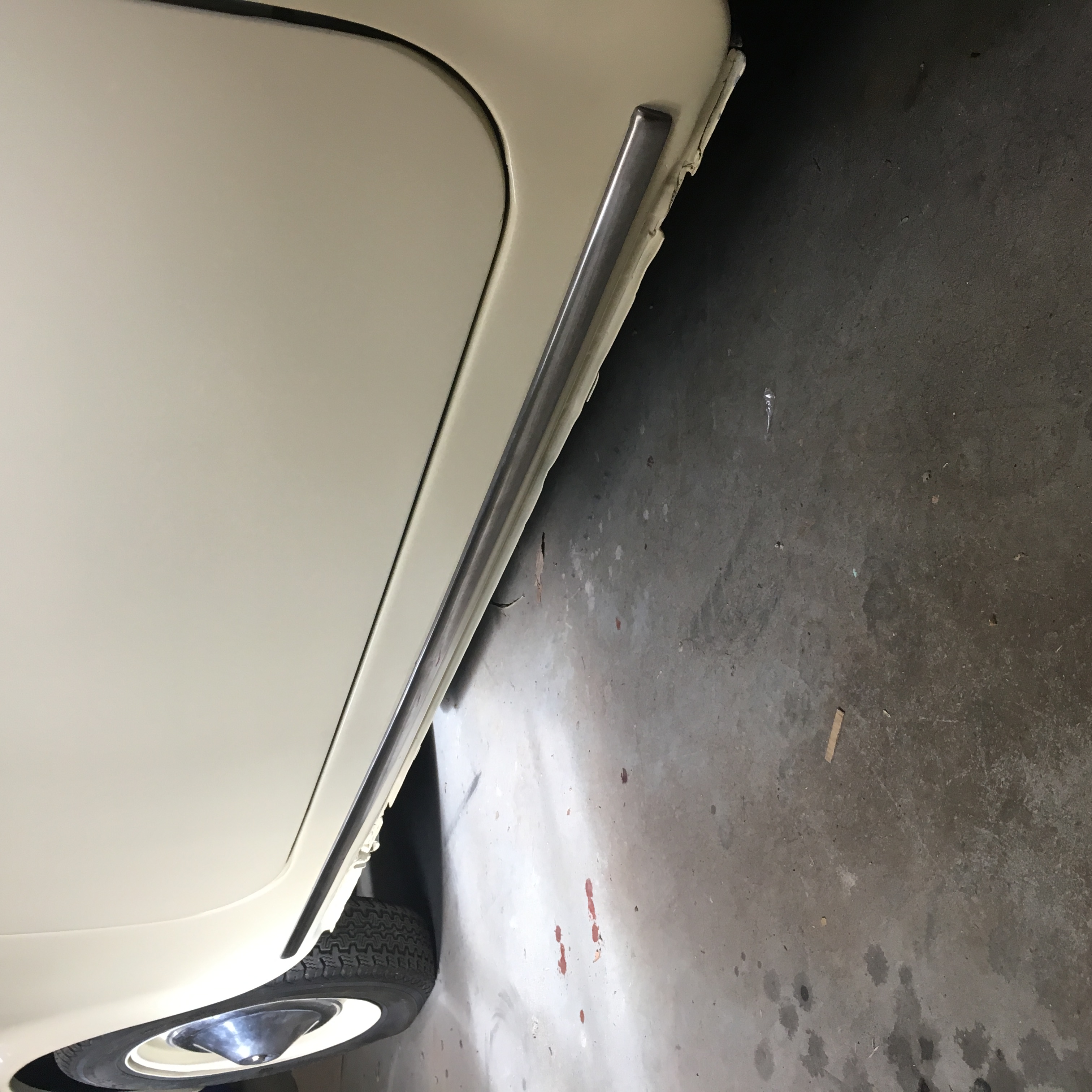

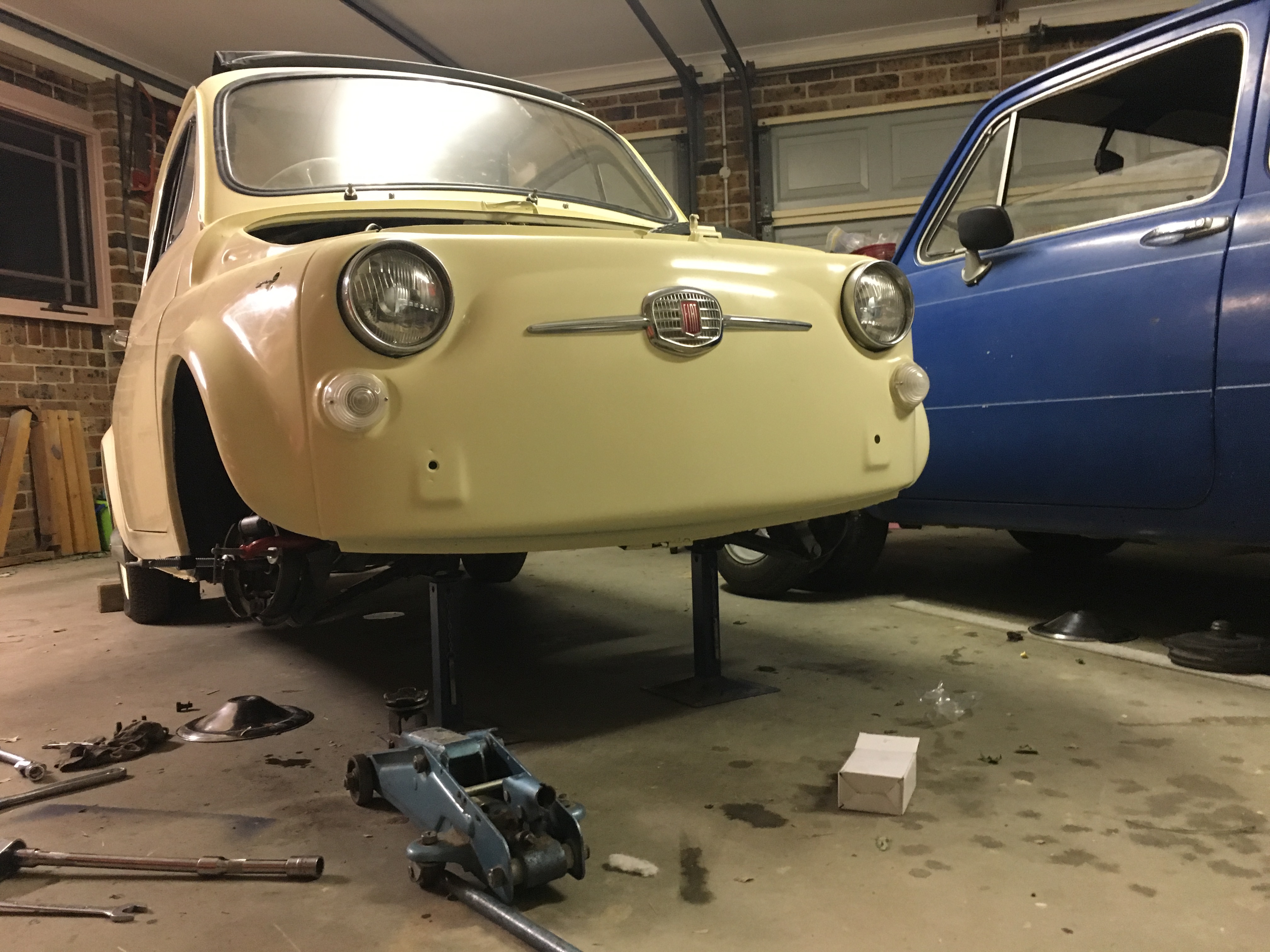

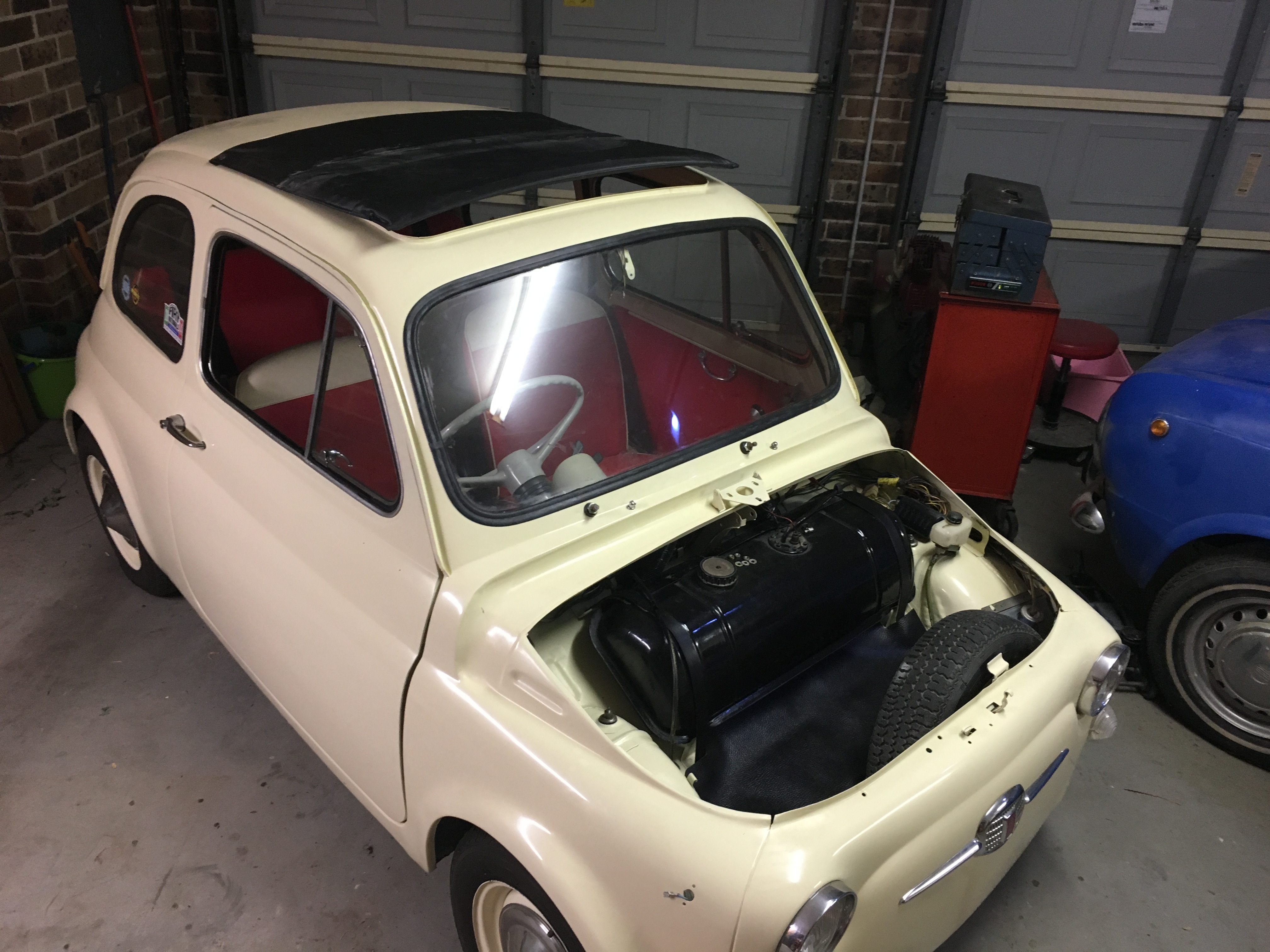

I have been adding a few parts here and there and this weekend had the chance to cross a few more things off the list. New brake wheel cylinders and shoes, roof lining, seat belts and started on folding roof.
I can’t get the latch off the old roof but might have a spare in a box somewhere.
Also fuel tank is in and most cables attached.

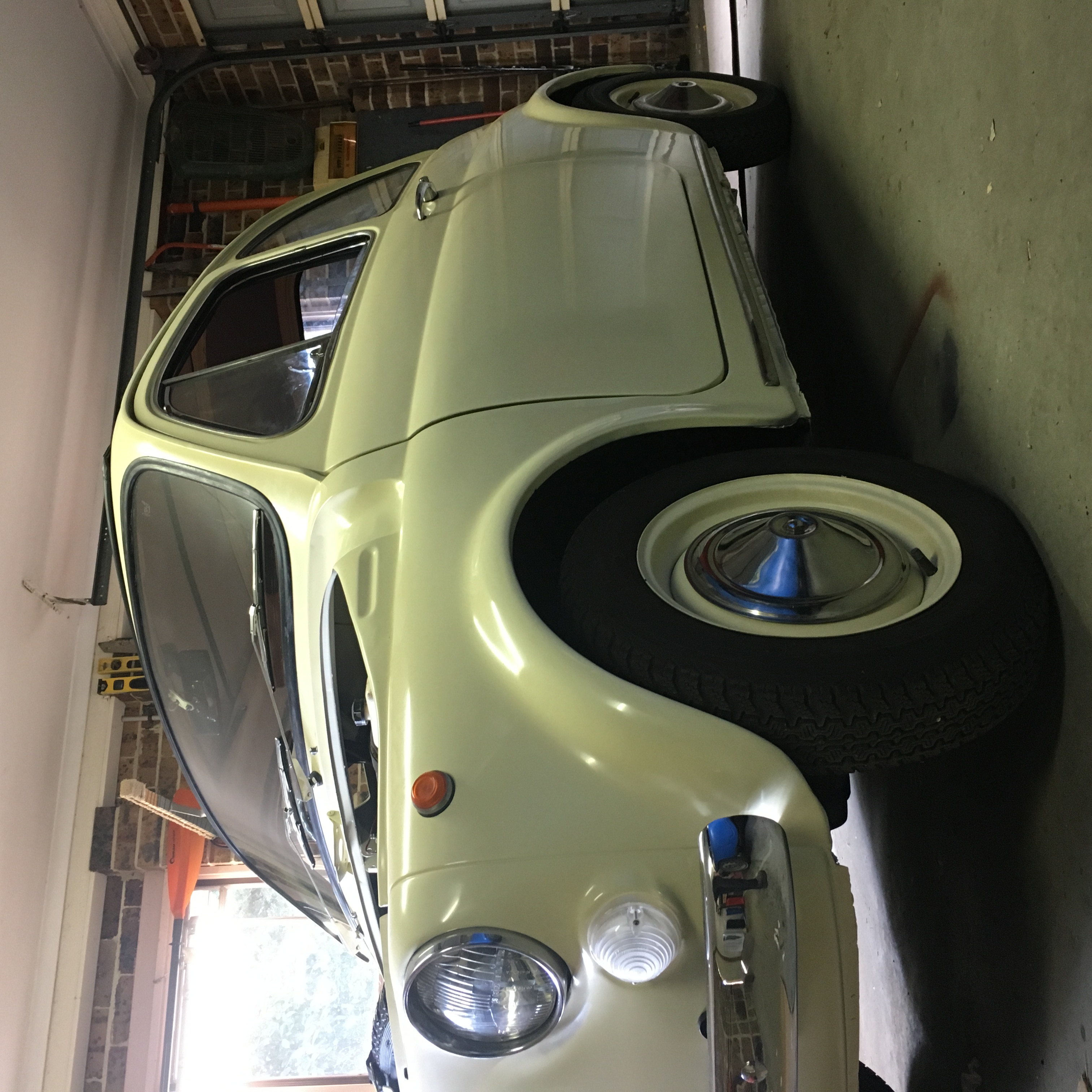

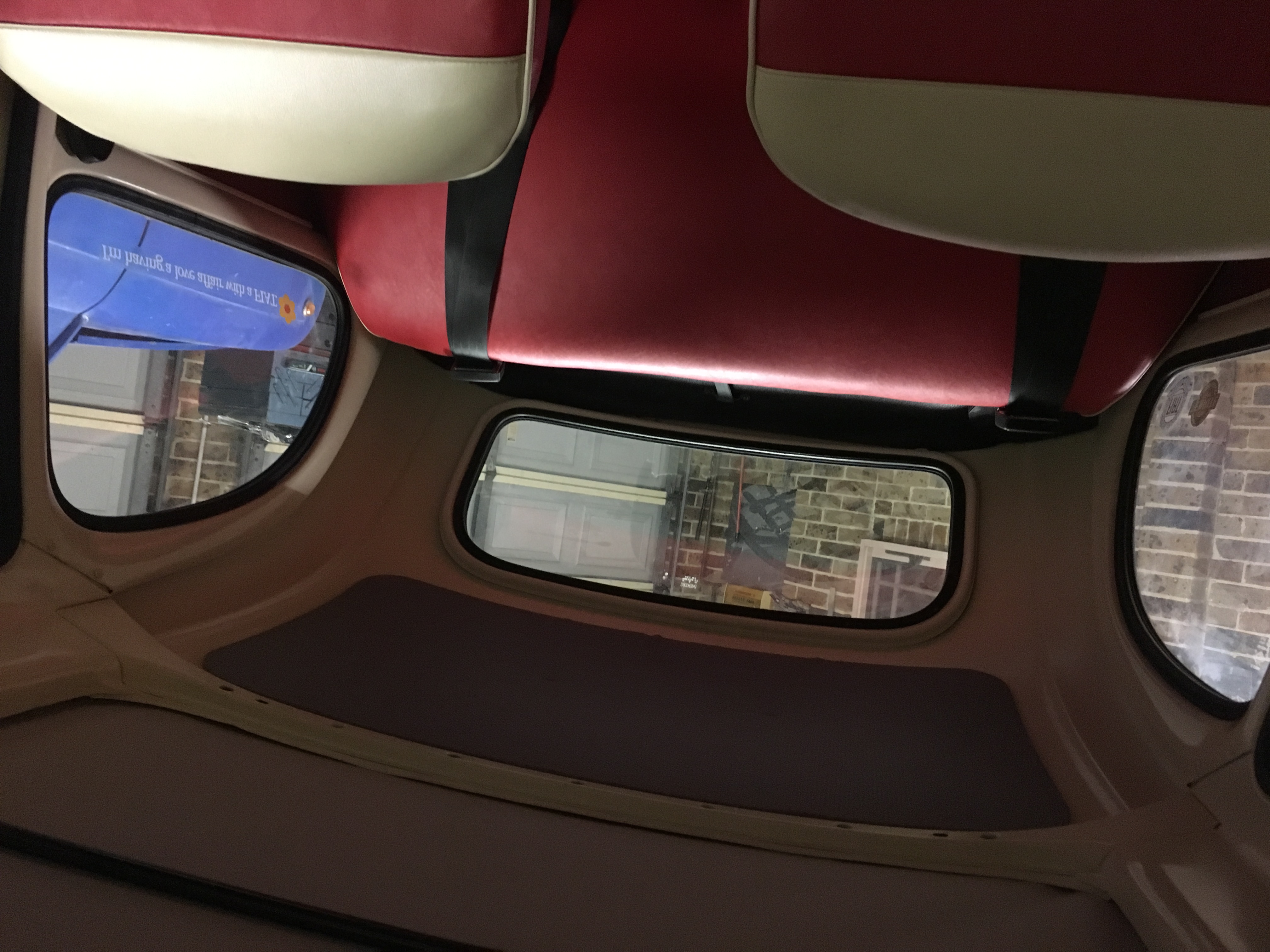

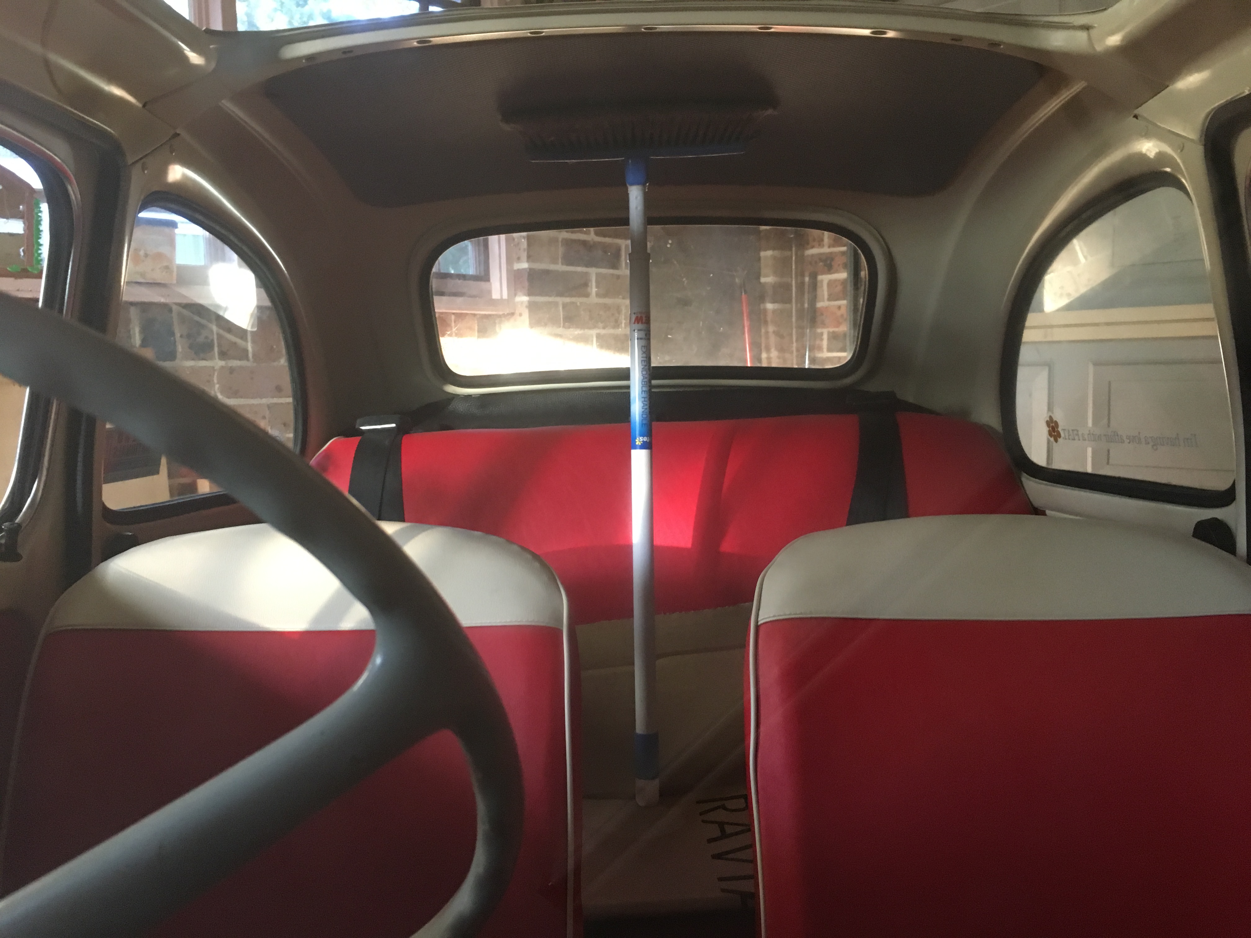

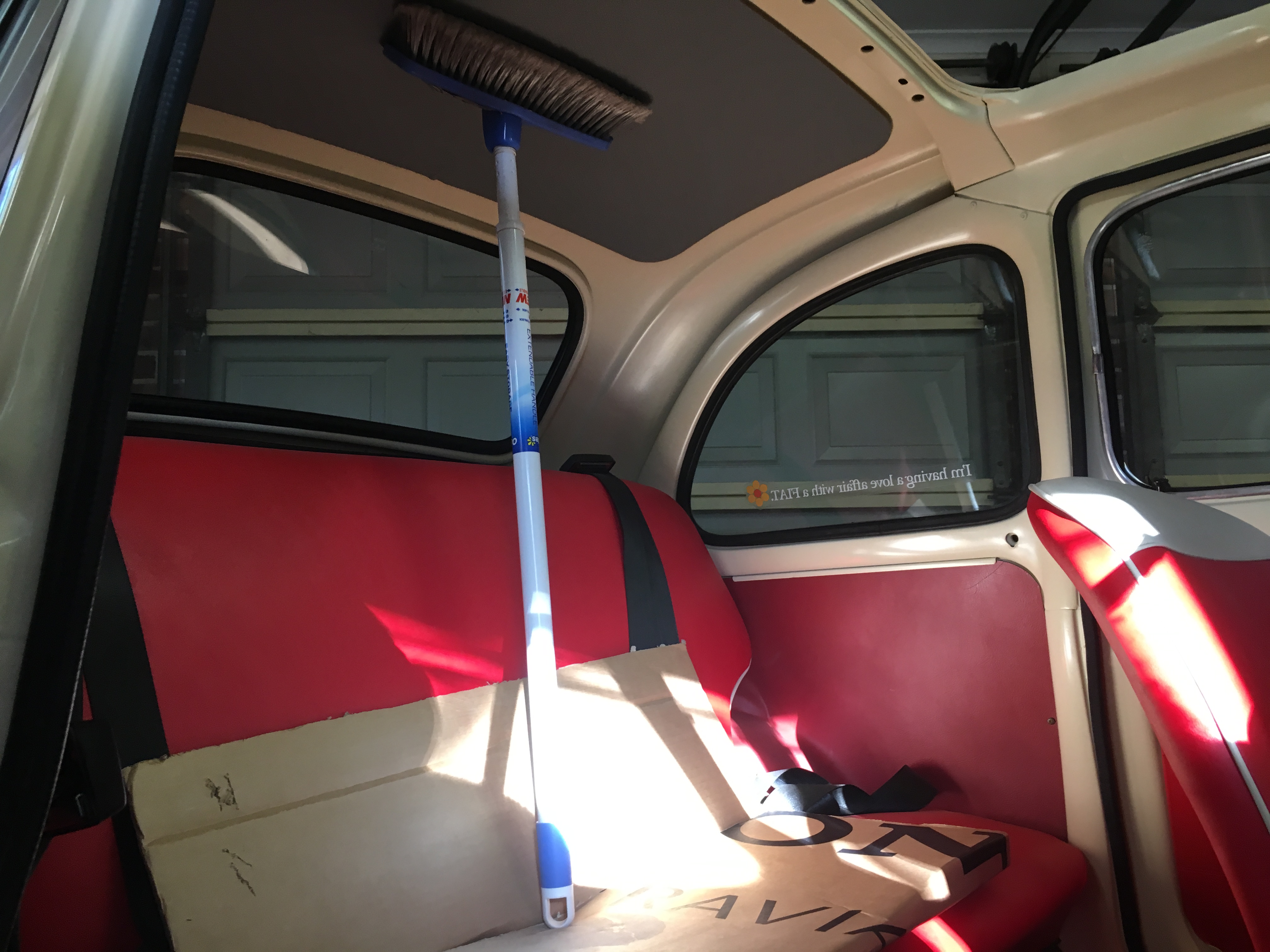

The broom :)
It did the job. The pressure in the middle was enough to make it stick all the way around because the roof is curved and the new lining was flat.??
Also having the car upside down helps. Oh wait that is just the photo...

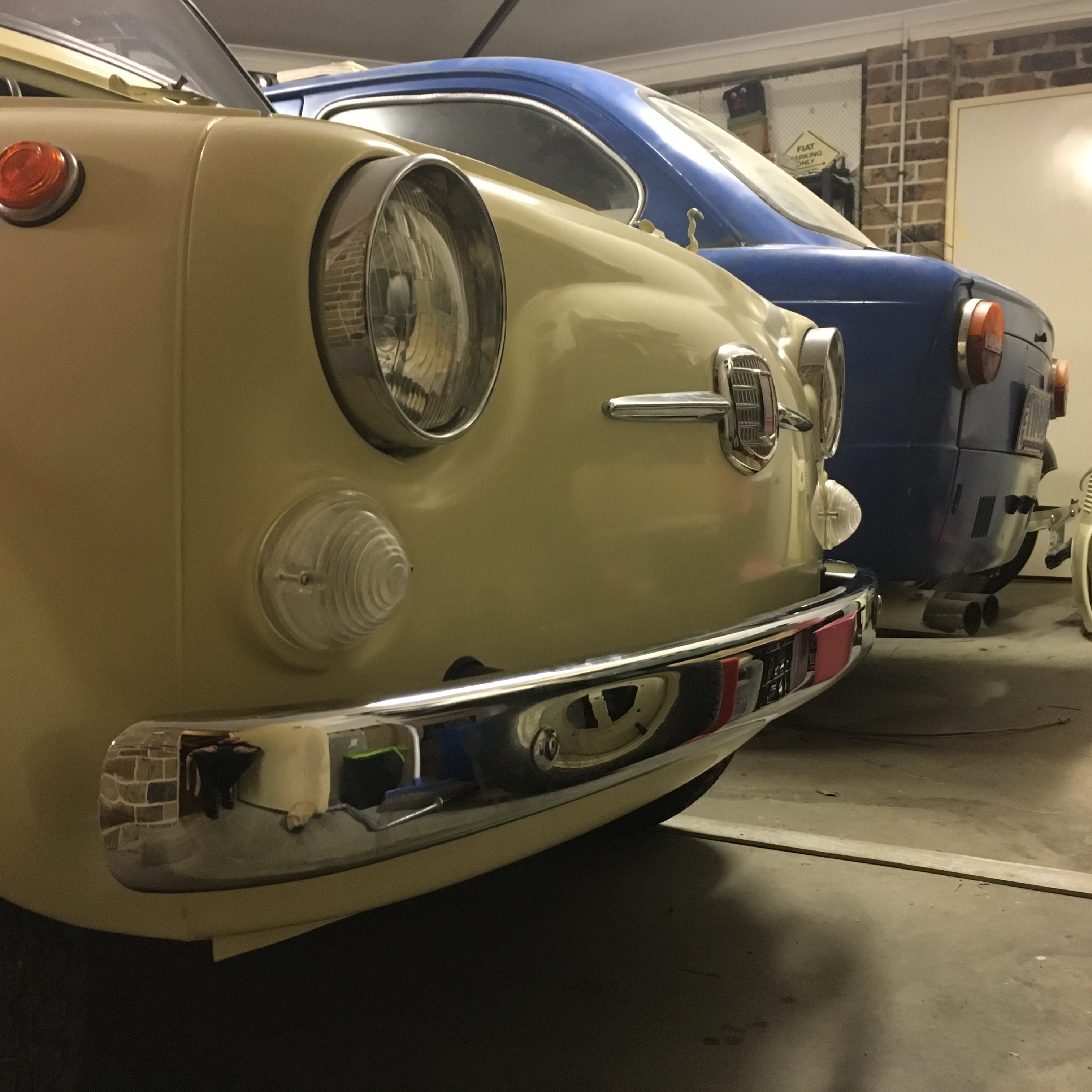

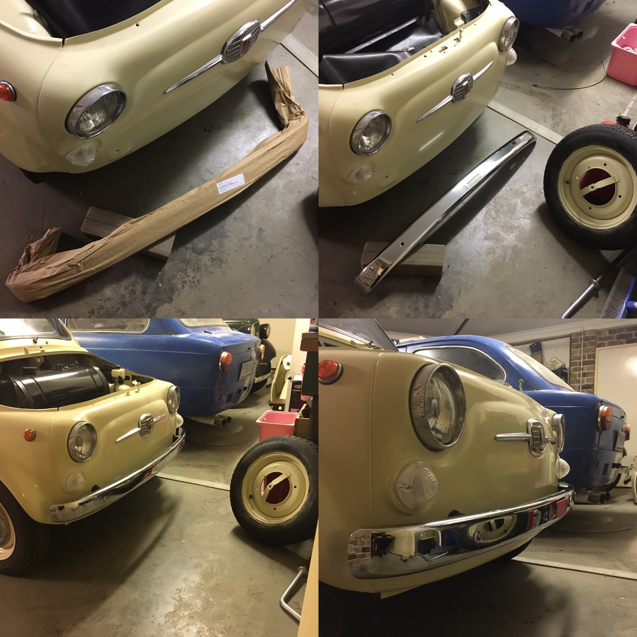

Folding roof, bumper bars and side indicators...

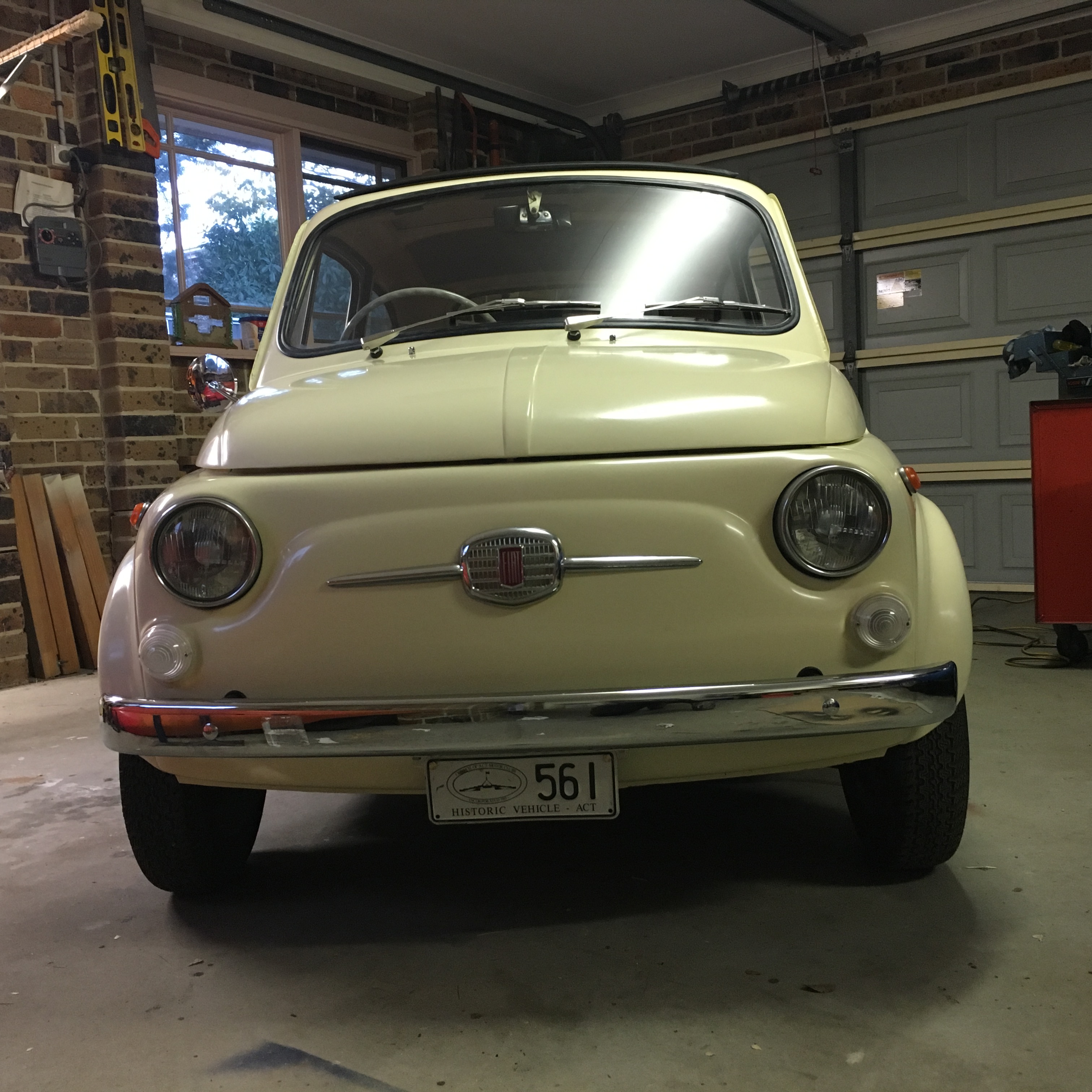

I have ticked everything off the list except starting the engine and bleeding the brakes. Maybe go for a test drive next weekend.
So close...

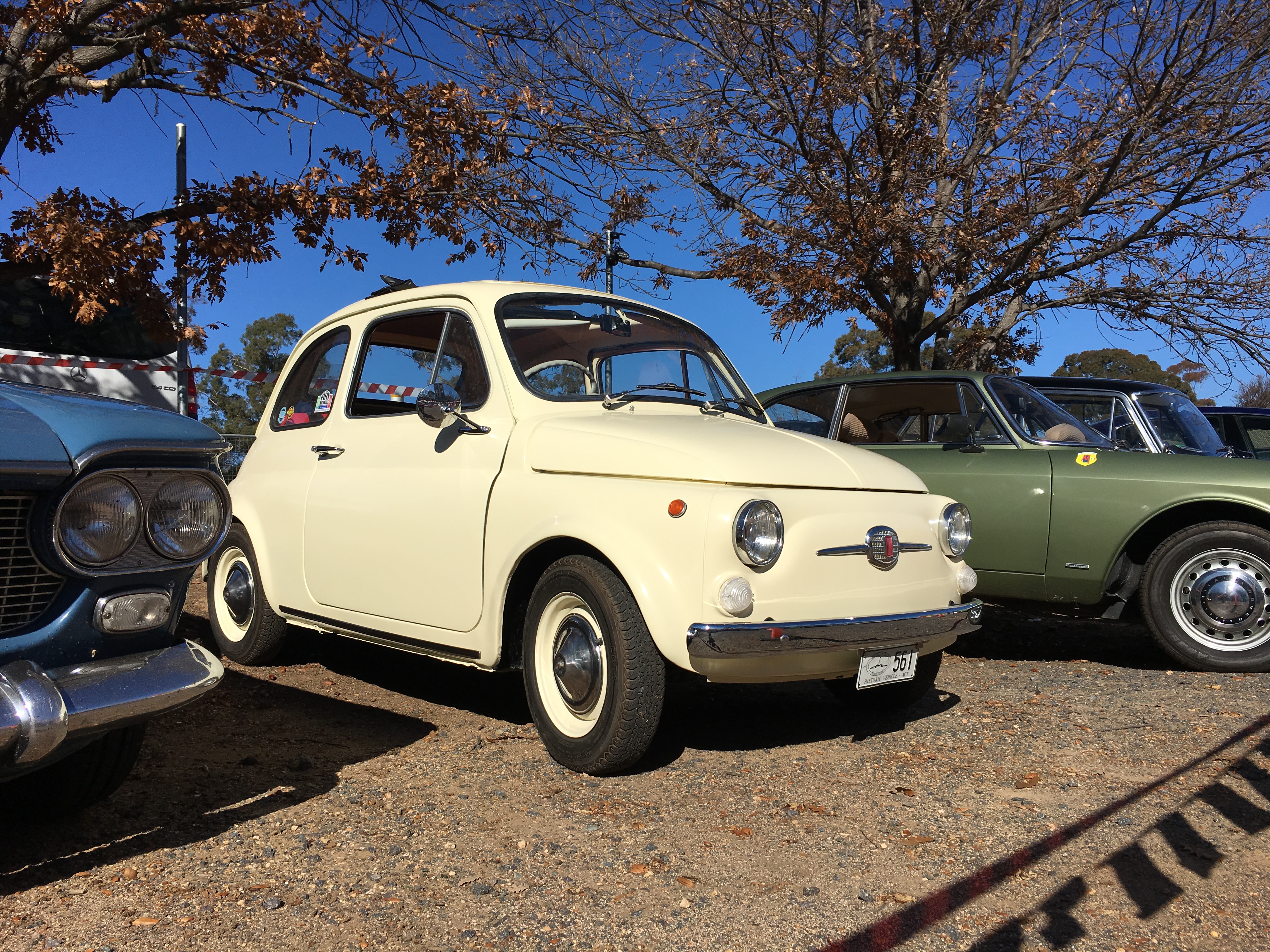

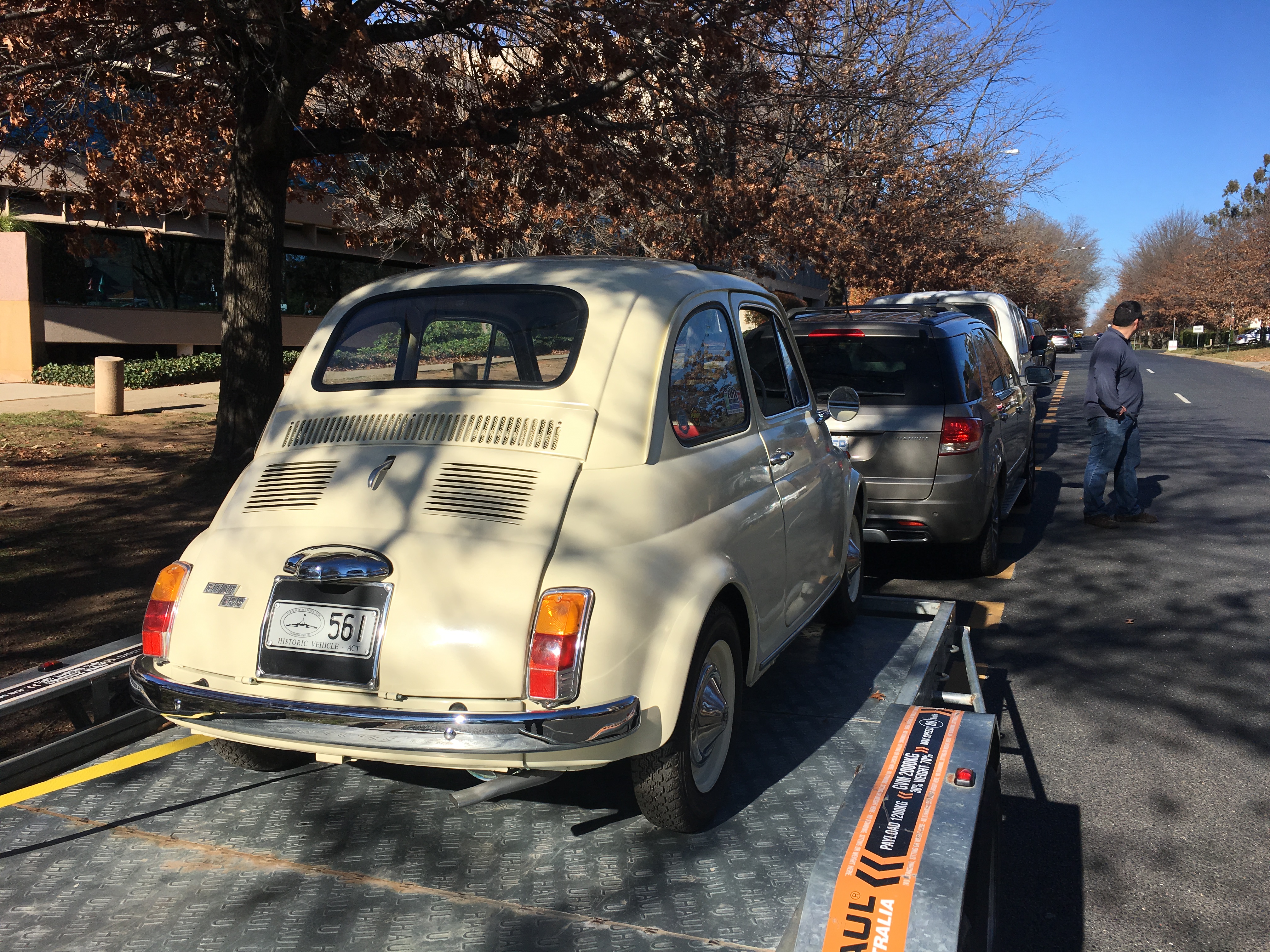

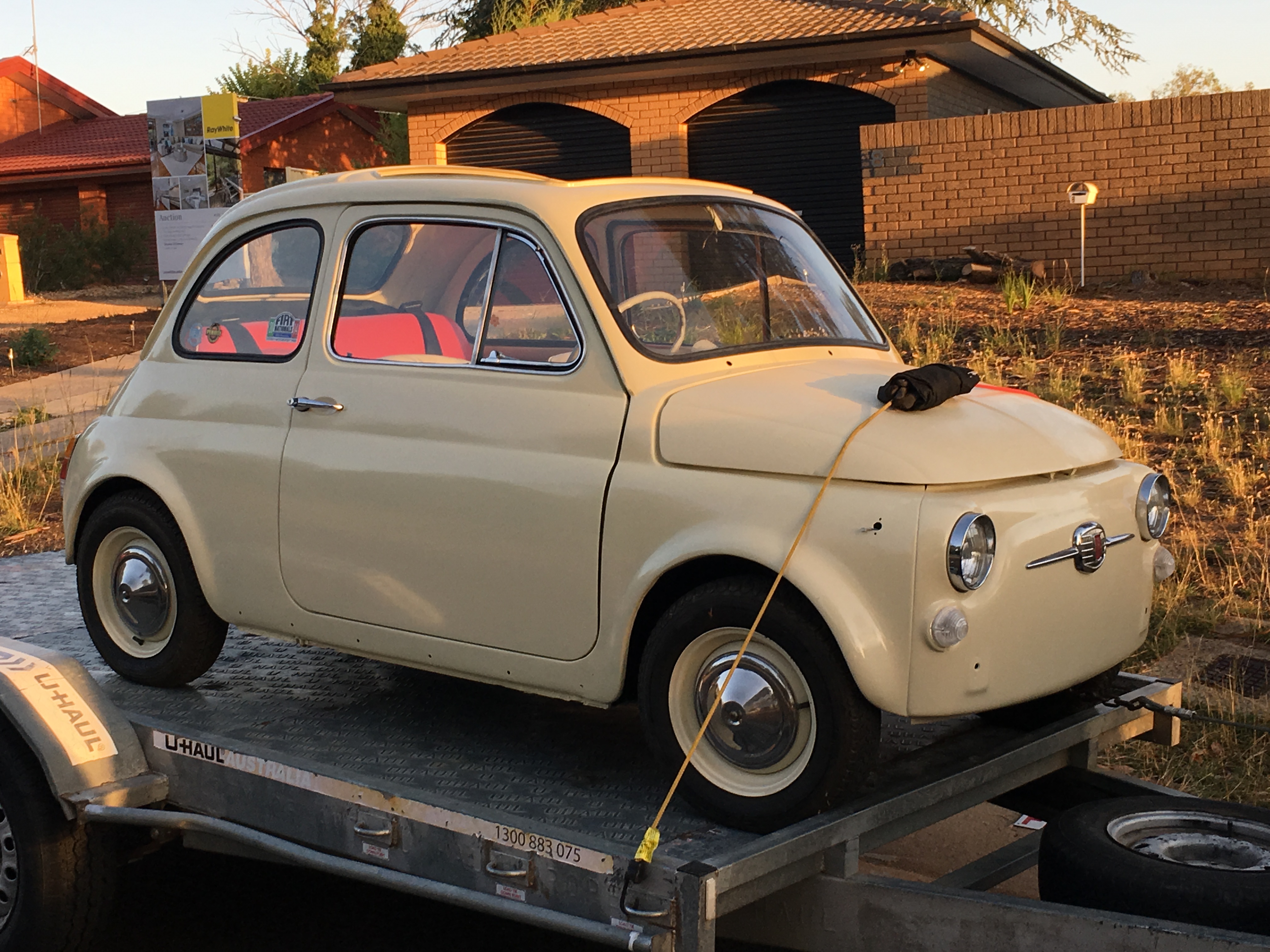

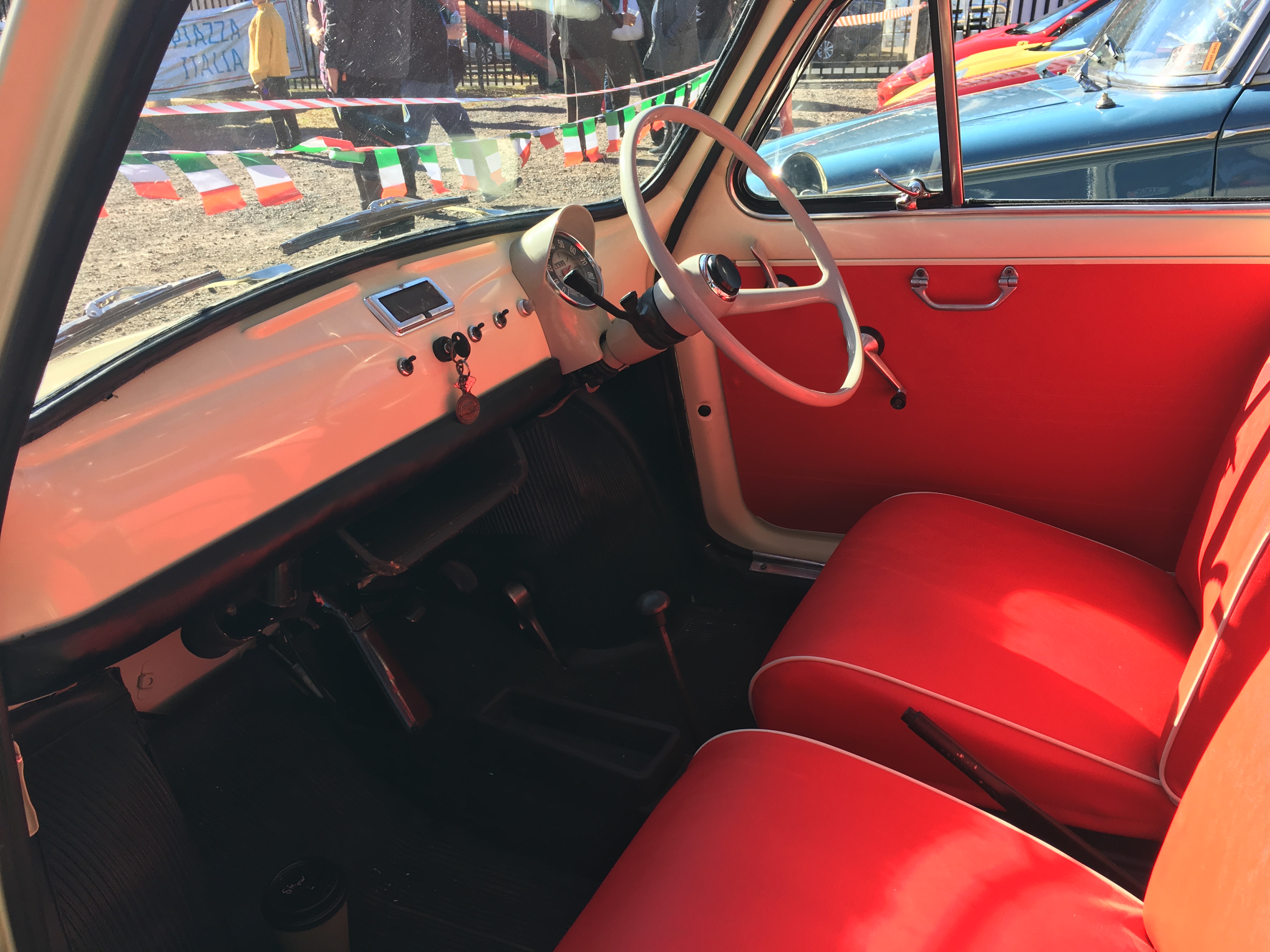

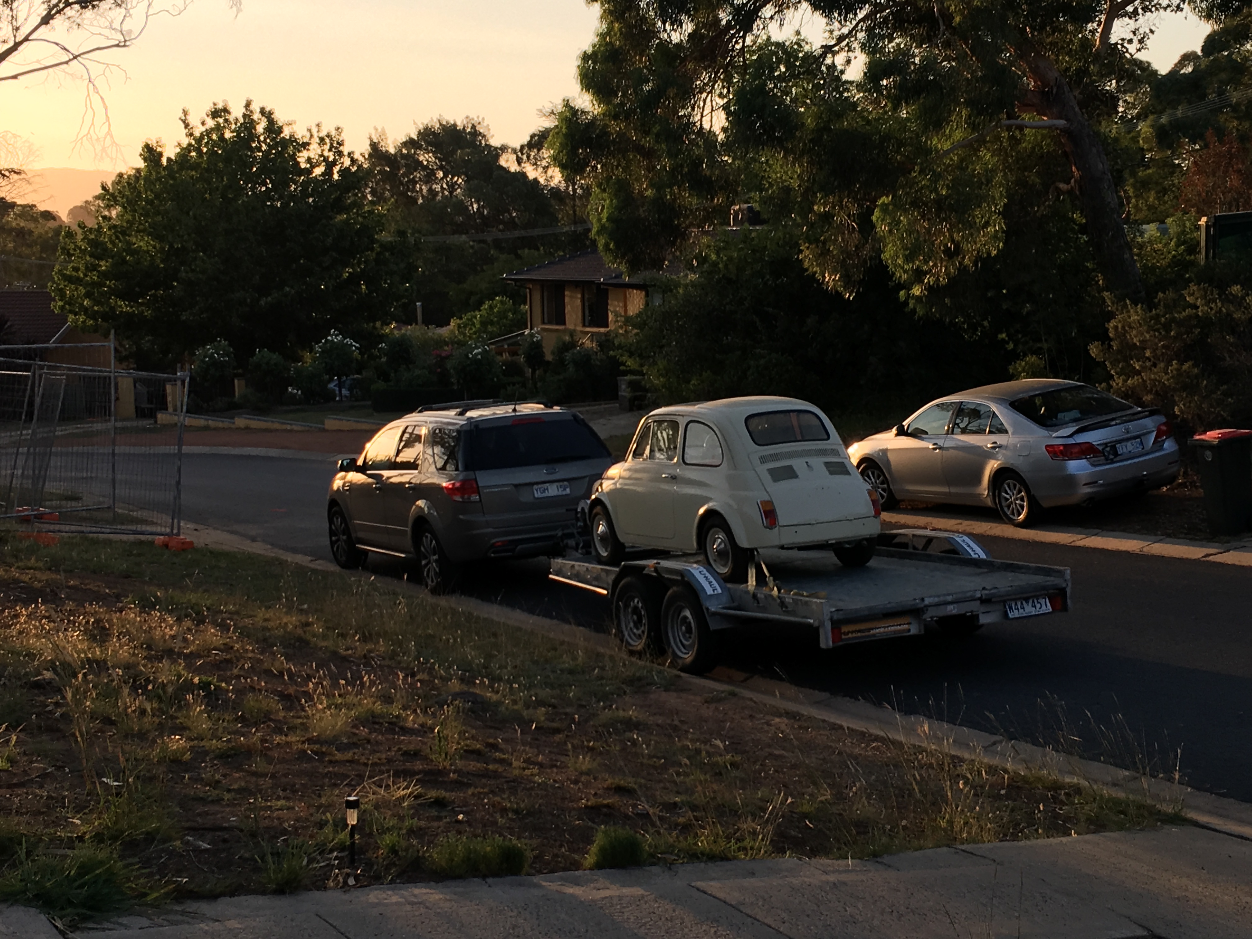

Never let the fact that your car does not go or stop deter you from participating in a show... just hired a trailer..

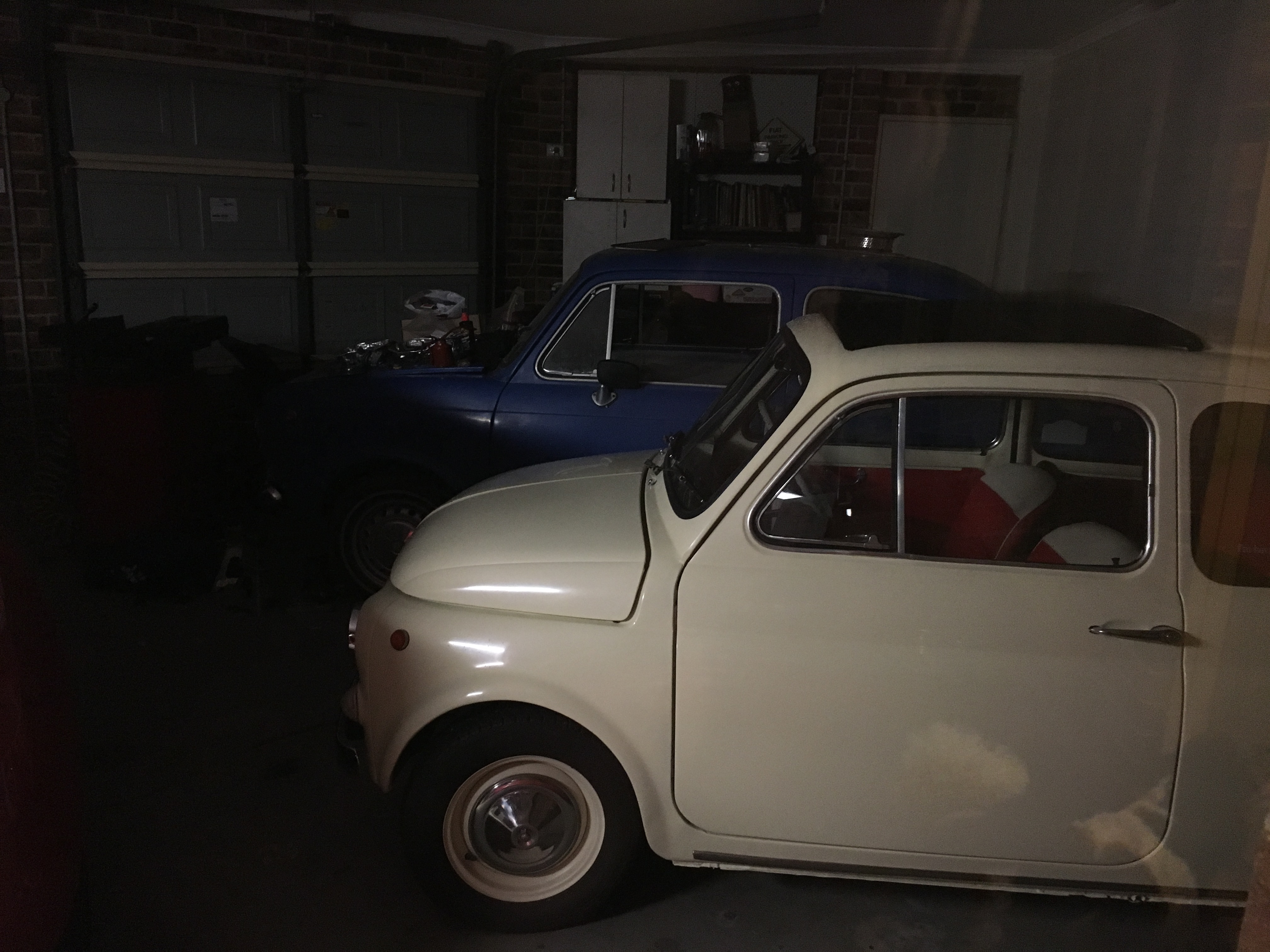

I almost got the car running in time but hit the common problems of air in the fuel Line and brakes with pedal travel to the floor. I borrowed an electric fuel pump to get that going tonight and also after bleeding the air out of the brakes we moved the front shoes on the self adjusters and that brought the pedal up.
First drive was in the dark and rain. I’m sure Murph would appreciate that - making my car an all weather car from the get go.
