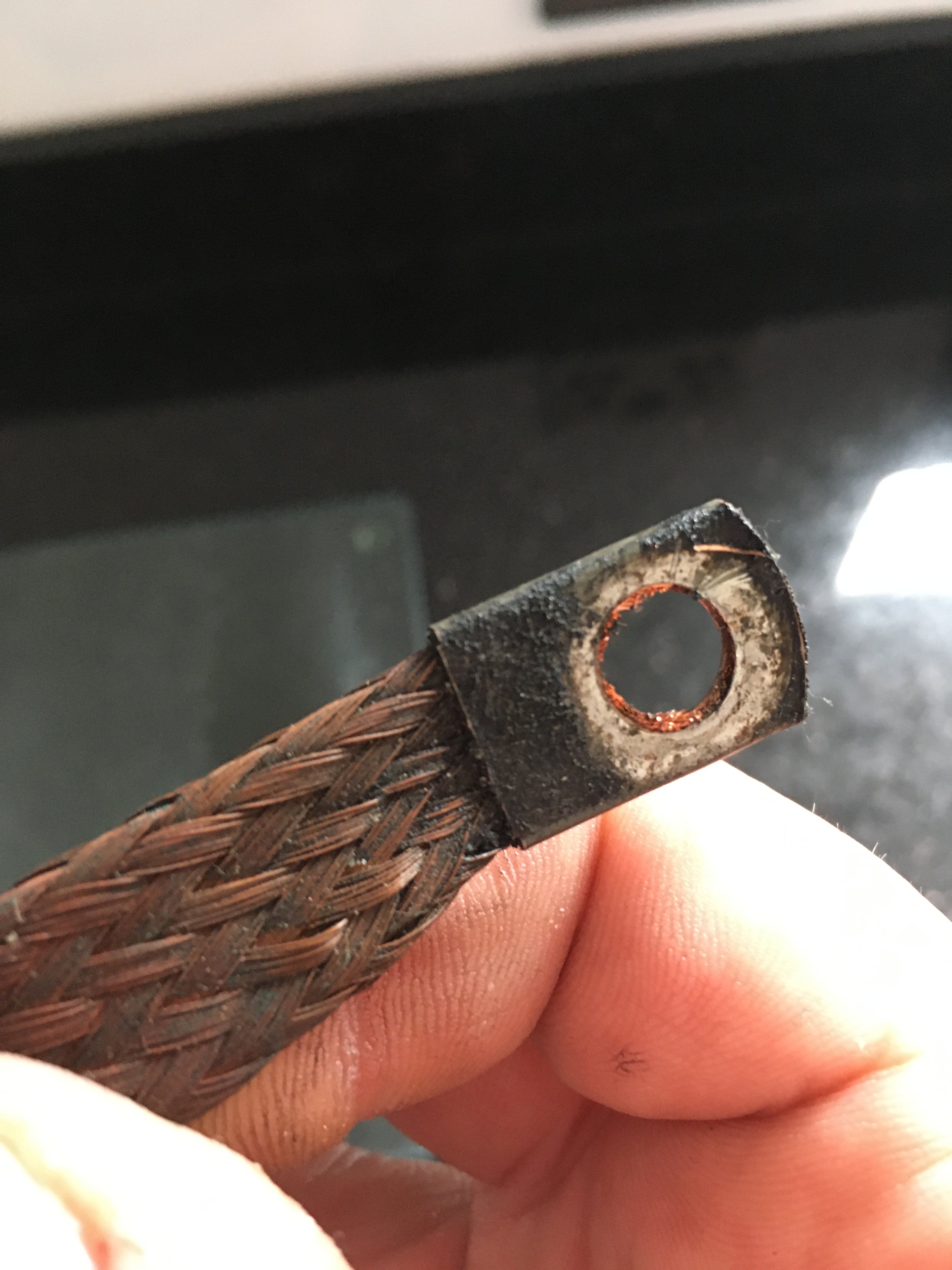

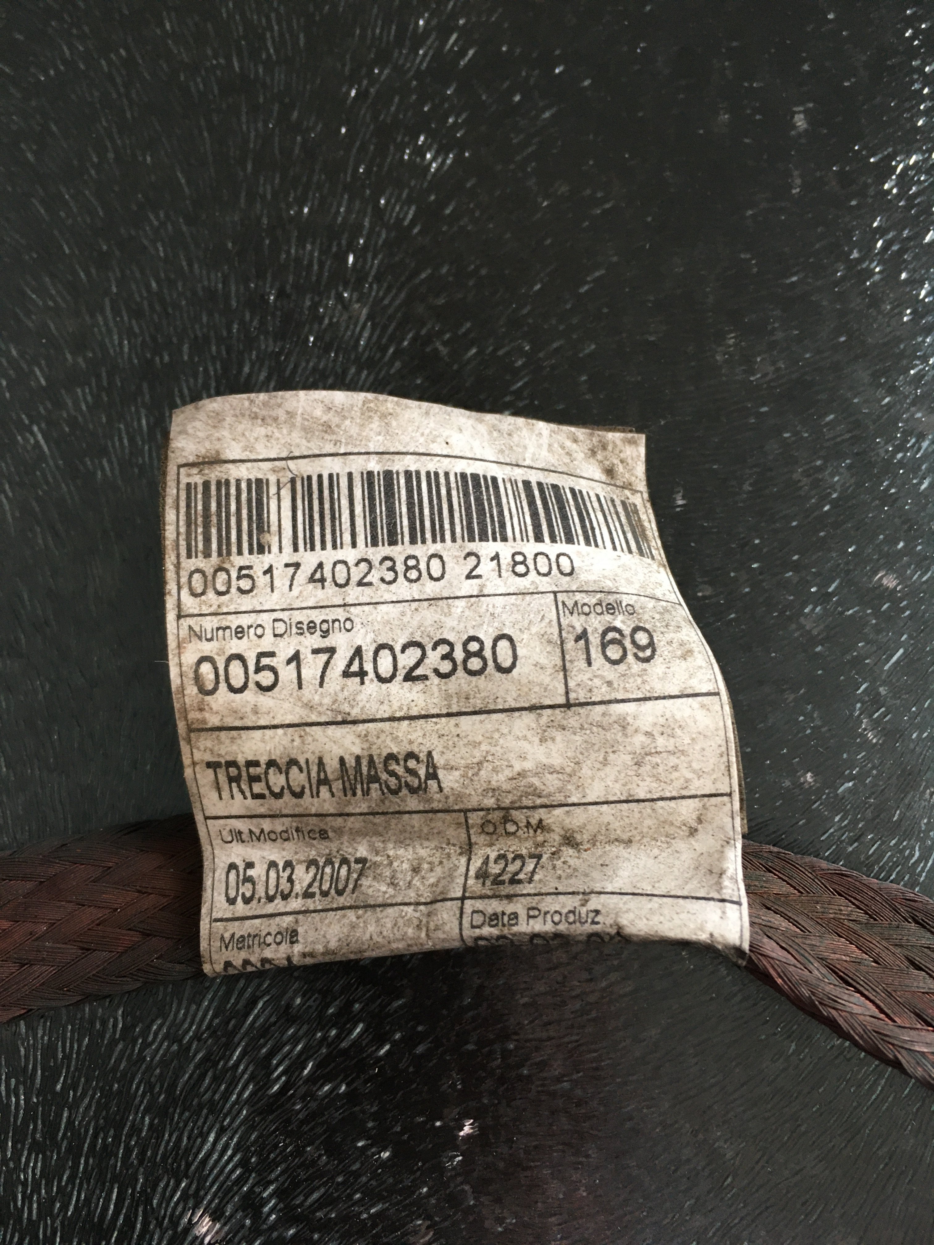

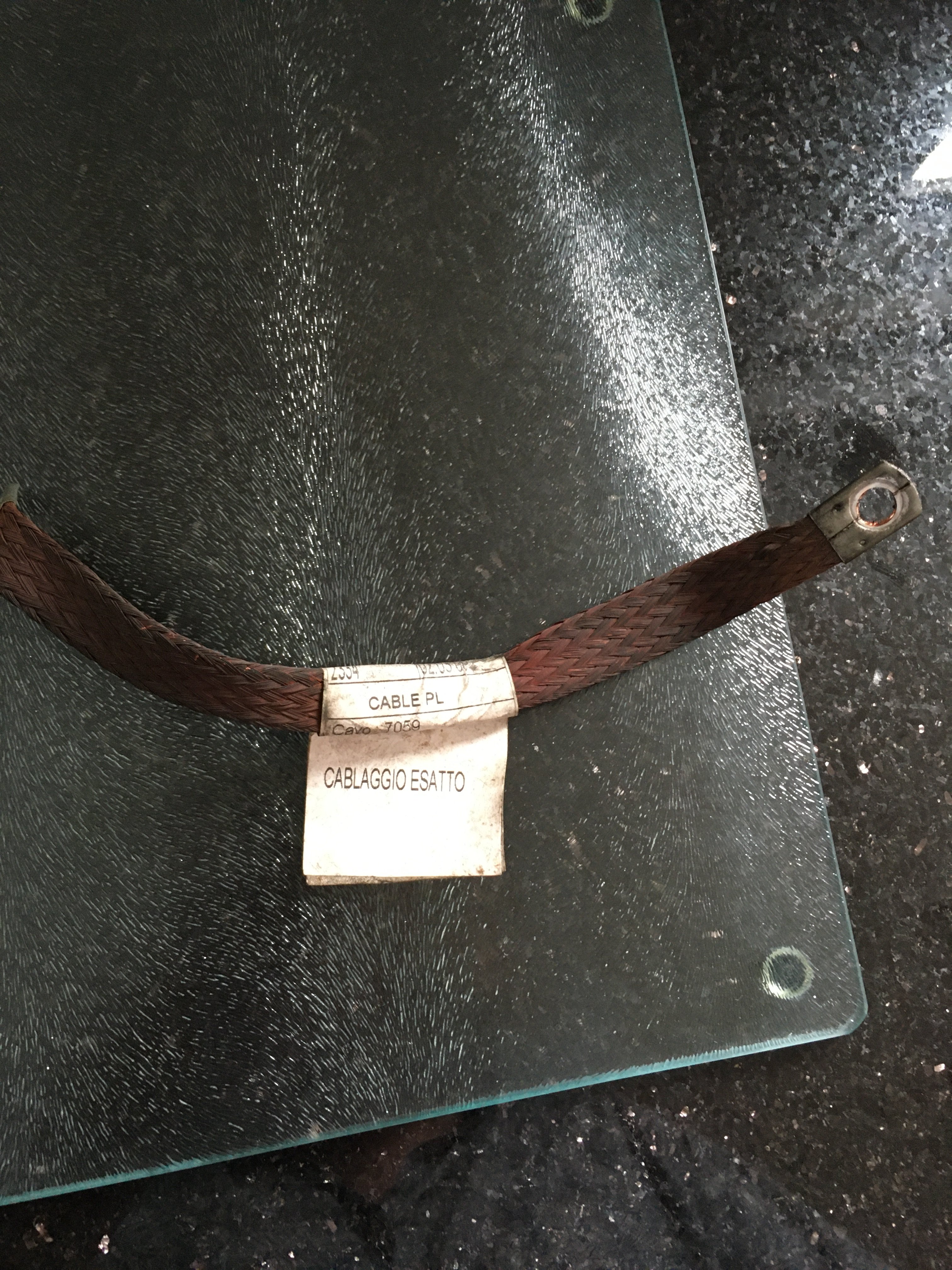

I’ve just changed it and like I said earlier it never seemed to come with a plastic cover, I’ve seen the newer ones and it’s not much of a cover either as it’s very loose so not sure what the point is.
I bought the Halfords 45cm negative lead and was almost too long but as the lead was very flexible it was fine.
Heres some pictures of my old earth strap
B9CAA6A7-32C6-4439-8D60-E3D1BCEB5F60.jpeg603F41B0-F456-4968-B0A8-EB274D384C4E.jpeg603F41B0-F456-4968-B0A8-EB274D384C4E.jpeg
Didn’t have that right angle connector like the newer ones either
View attachment 407983View attachment 407984View attachment 407984
Yeah that looks a bit past it! I’ve seen worse though! Mine was green!
Those angled ends obviously don’t make any difference as my new one didn’t have any such angles and that’s been fine!
