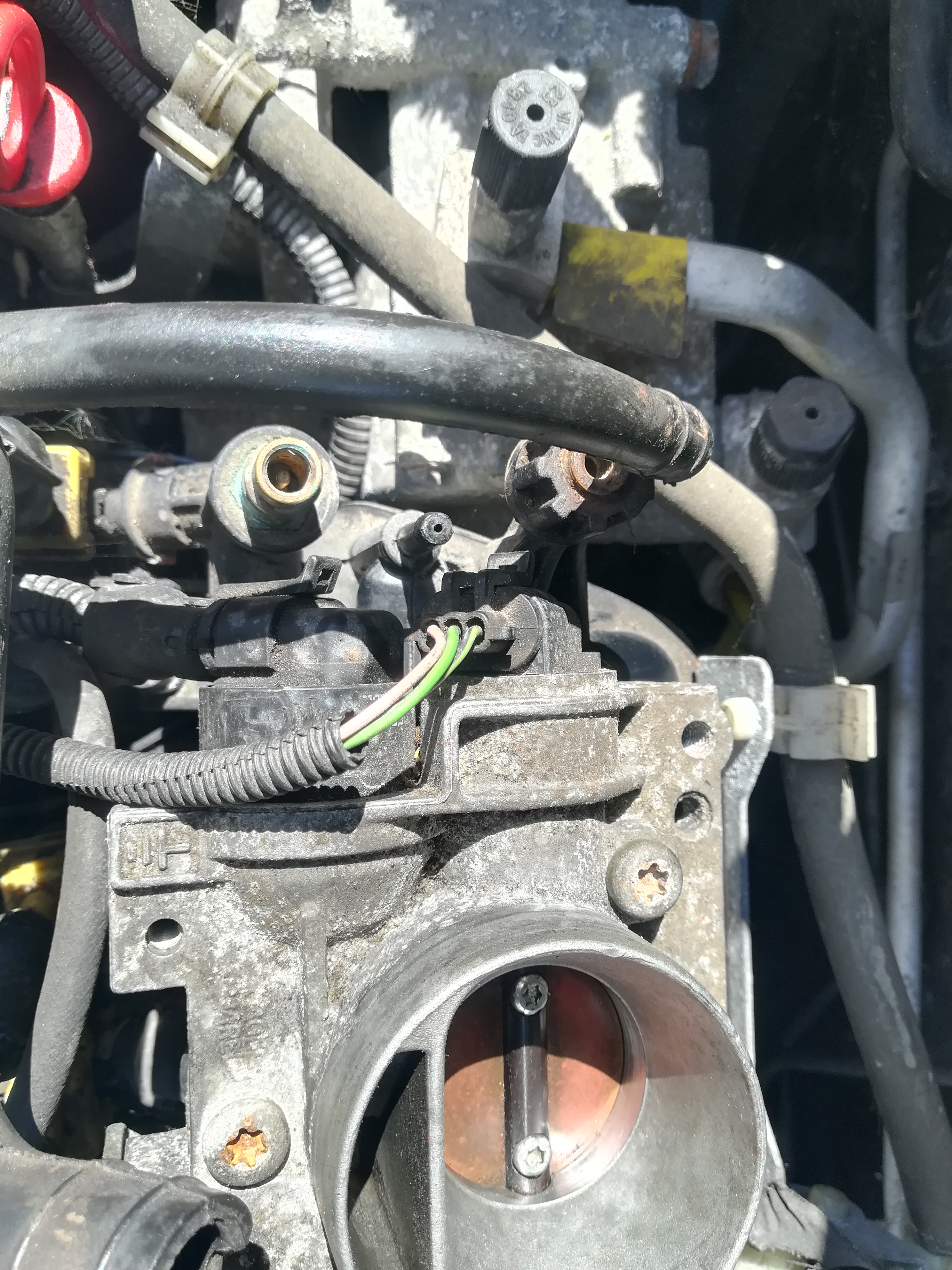

Now it is running good, cleaned the breather pipe from the air box to the manifold. The throttle body has oil on it too, it needs an oil change soon but checked the oil level and is still okay. Is it normal that the hole in the manifold where the breather pipe from the air box is attached to is very small? It is open but i don’t know how big it should be
@Wouttie if it's any help, here's the breather on my cable throttle non-VVT Euro4 1.2 60hp FIRE. Yes, hole is very small.
