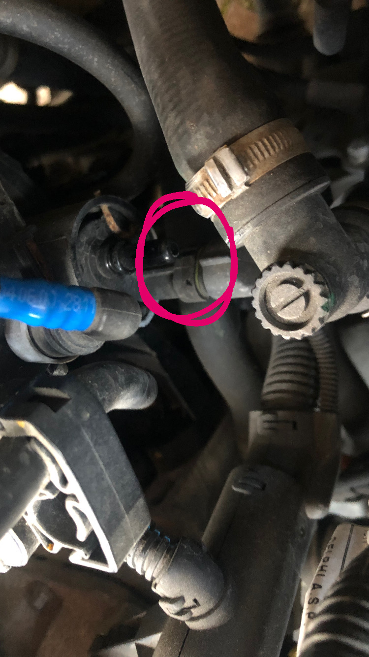

Hi everyone.
I’ve been having issues with my car (Fiat 500 -65 plate) with engine warning light coming on intermittently, telling me to check ESP, Hill hold unavailable, start/stop unavailible. Have taken the car into the garage a few times and they have tried clearing the codes but this hasn’t worked. I have also had oil and filter change, new spark plugs, and changed MAP sensor and used the specific map sensor electric spray. Unfortunately these haven’t resolved the issue either.
I have checked the codes myself p0101 and p0106.
A few times the car has started to go into limp mode and go very slow, the more I put my foot on the accelerator the slower it goes. I then have to turn my car on and off again for it to drive.
Any advice please? I have looked on this forum at other people’s issues and I wonder if it could be my evap. However I am unsure which wire to disconnect to test the evap. Is it the blue wire and how does this disconnect please?
Many thanks!

The blue pipe is a tube from the evap canister at back of car to the evap solenoid valve in the inlet manifold.
The codes and driveability problems could be faulty evap valve . Disconnect the elbow for the blue tube from evap valve , plug the black pipe on the evap solenoid and test by driving.
To disconnect the elbow you may have to pull on the light grey ring? Be gentle because I am guessing type of retainer. Fingers crossed someone @koalar Will pop up and give first hand knowledge.

Warning light is back on. Code shows P0106. I have disconnected the blue wire and the evap port (where circled) is suctioning as soon as engine is turned on. Does this mean it is faulty and needs replacing?

Leave the electrical connection on
Turn the engine on
Wet your finger and put it over the now exposed end
There shouldn't be any suction felt
99 out of 100 it's the only test needed as the normal failure mode is being jammed open from a bead from the evaporation container jamming open, if this fails you might have to flush the evap system to stop the new solenoid also getting trashed
You can do the same test with the electrical connector also removed there should be a slight suction felt this time
This would prove it's opening and closing correctly but not if the ECU is commanding it probably
Assuming these are okay you can double check by blocking the pipe and taking it for a few test drives,
If there's now no problems you can order a solenoid in confidence
I only know of a couple where some other work has been carried out and the whole solenoid hasn't been clipped back in properly
If the problem persist we need to do further diagnostics
