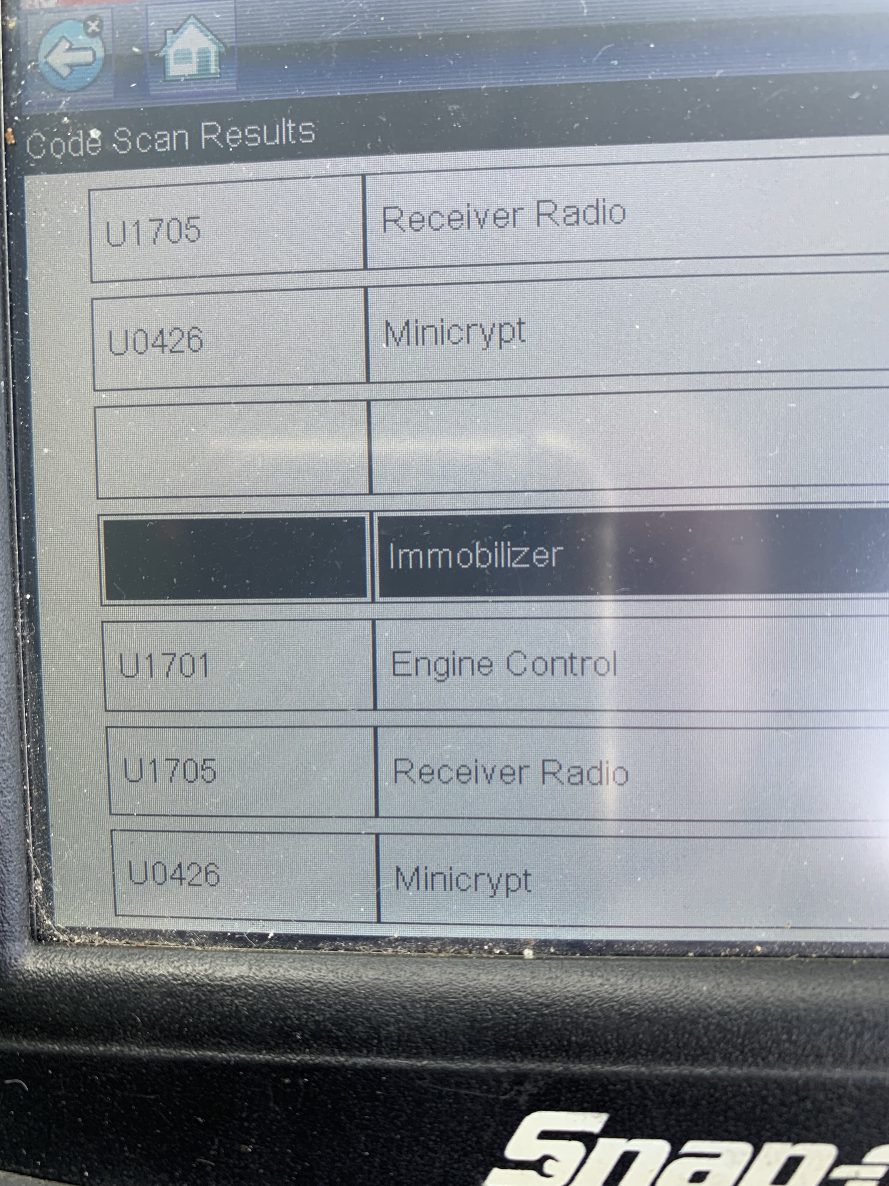

Changed bcm ecu ignition display everything do with electrics still has immobiliser on

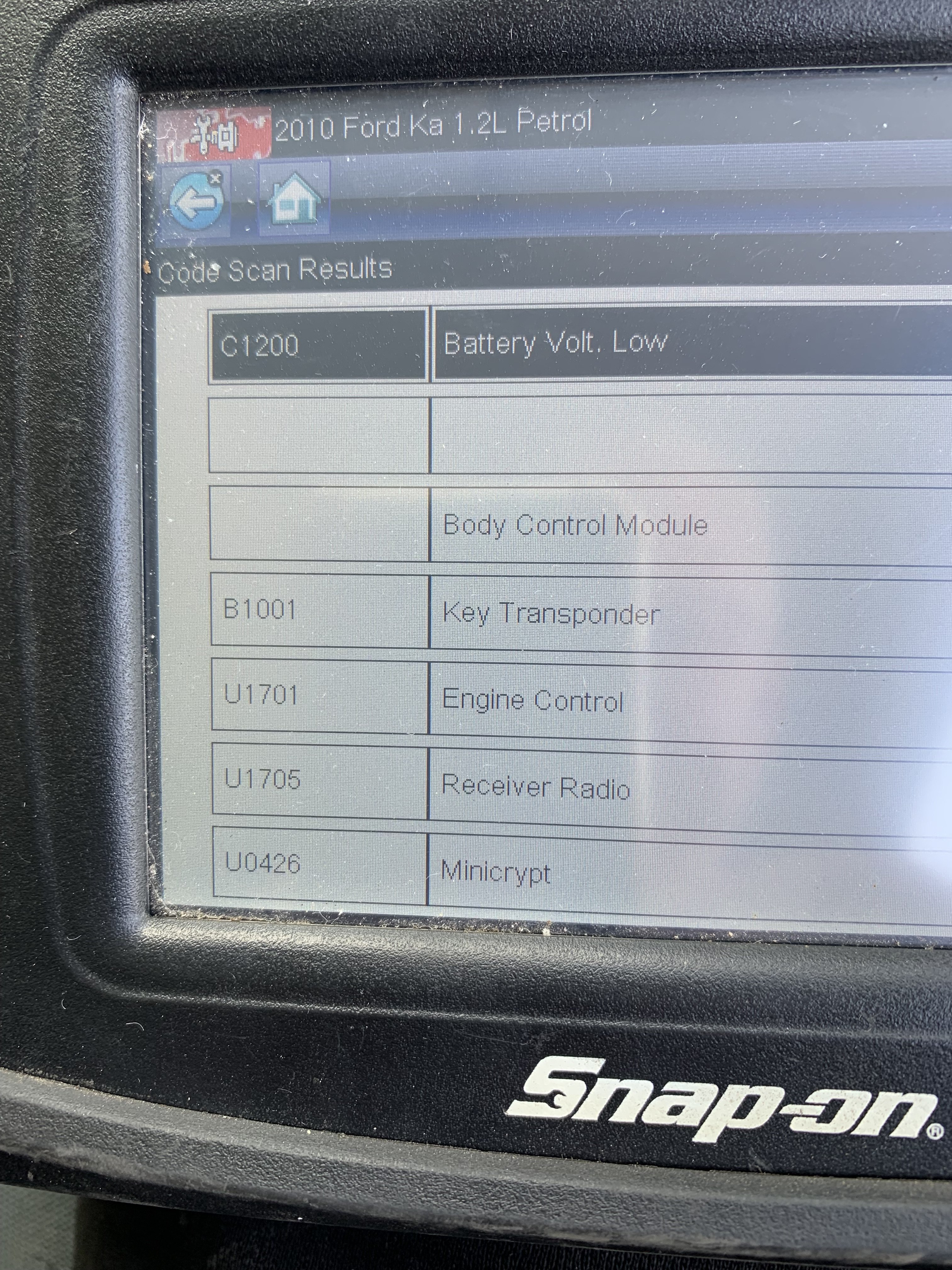

Regarding the snap on errors can you clear any of them? You also have a low voltage error on there? Have you checked the voltage. At various points through the system?
No the errors dont go, they clear then come back, car just stopped, this last move was to replace all electrical components i mean what is left, it was 2nd hand so i will resell it, i have put the old back on.
Voltage is fine, engine turns over with ease so what is the immobiliser light on for if turning over?
