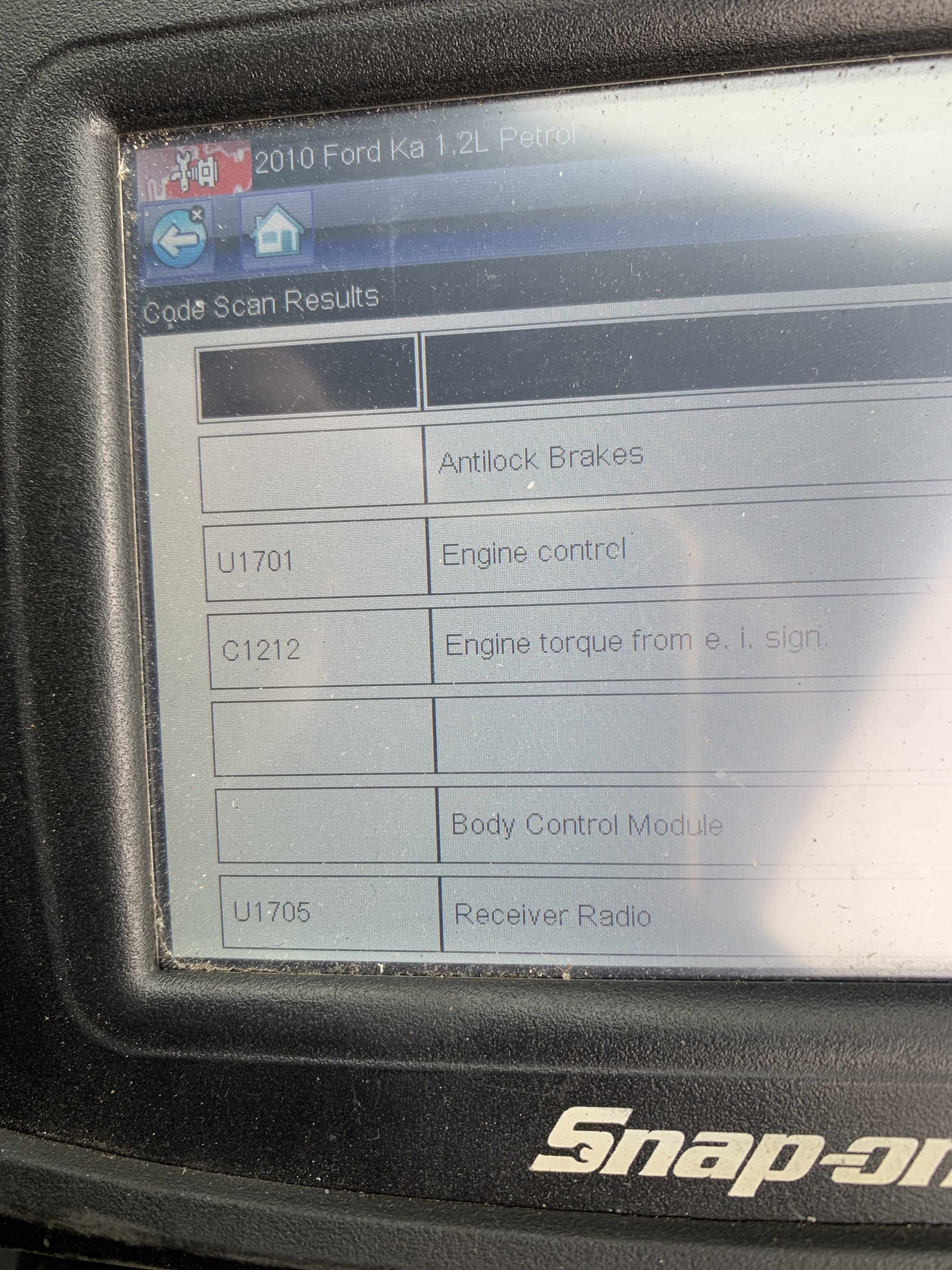

I think this car has gremlins
Clear codes and guess what it cranked but terrible took battery off , charged in me van on leads, put it back, connected with jump leads now its back to not cranking, im thinking starter is dodgy, heres codes i read

Have you tried this?
But... you also have the IMMO on, so... you gotta sort that out, otherwise there's no chance you can start the engine.
Have you disconnected the ECU's little ground cable by any chance?
