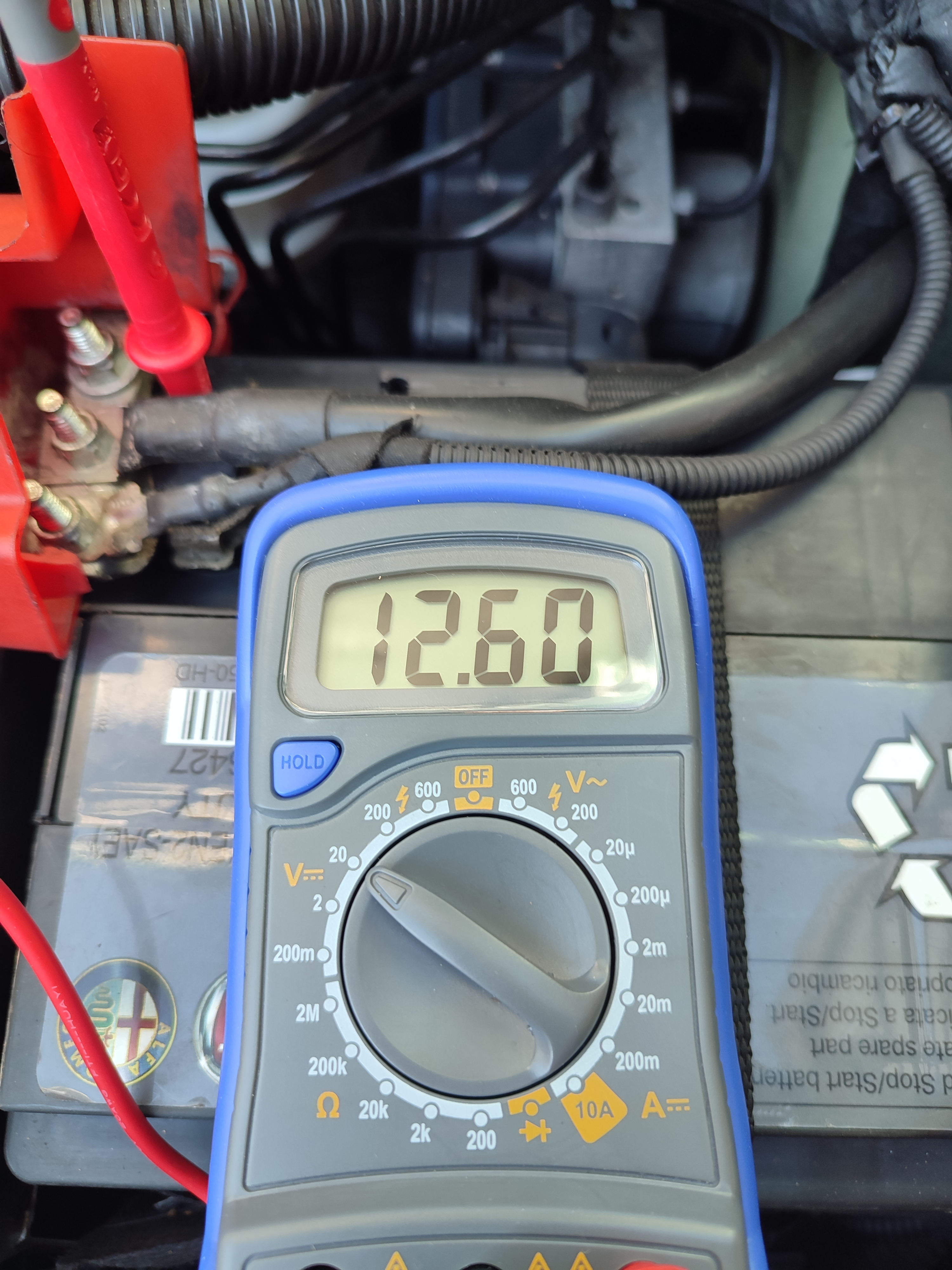

Voltage this morning after standing 14hrs was 12.49. Not great but not bad. Voltage yesterday afternoon after standing for abour 9hrs was 12.6 which is good. I don't think it's the battery. It started just fine this morning as it always does, no labouring or hesitation.

12.5 volts shows the battery is only 50% charged - which is enough to lead to errors when the drain of the starter is applied to it. Trust me - been there, done that. On my other car (a Volvo v50 - recently sold) just about every warning possible showed over a two week period. All cured by replacing the battery. My 2018 4x4 Panda is already starting to not stop for stop-start, or to restart almost immediately as it senses the volts drop too quickly while it’s stopped. That’s a car with 37000 miles on it, used several times a week but ‘only’ 8000 miles last year. My battery is at 12.6v the morning after a drive the previous day.
