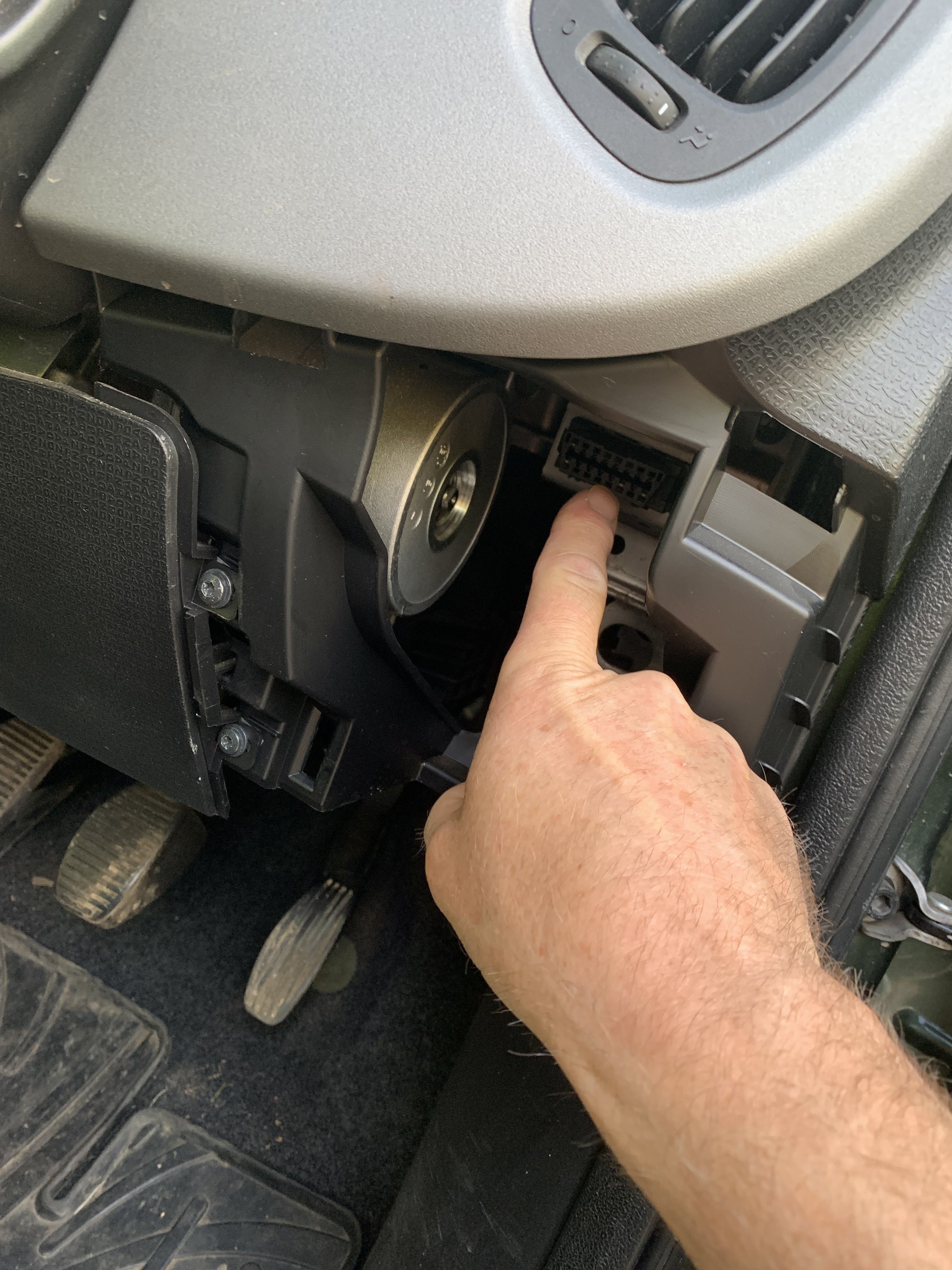

Well I've started and drove it several times now and no change. I'll keep on driving and see how it goes. I was going to check the OBD codes but can't find the connector? Where the hell is it?

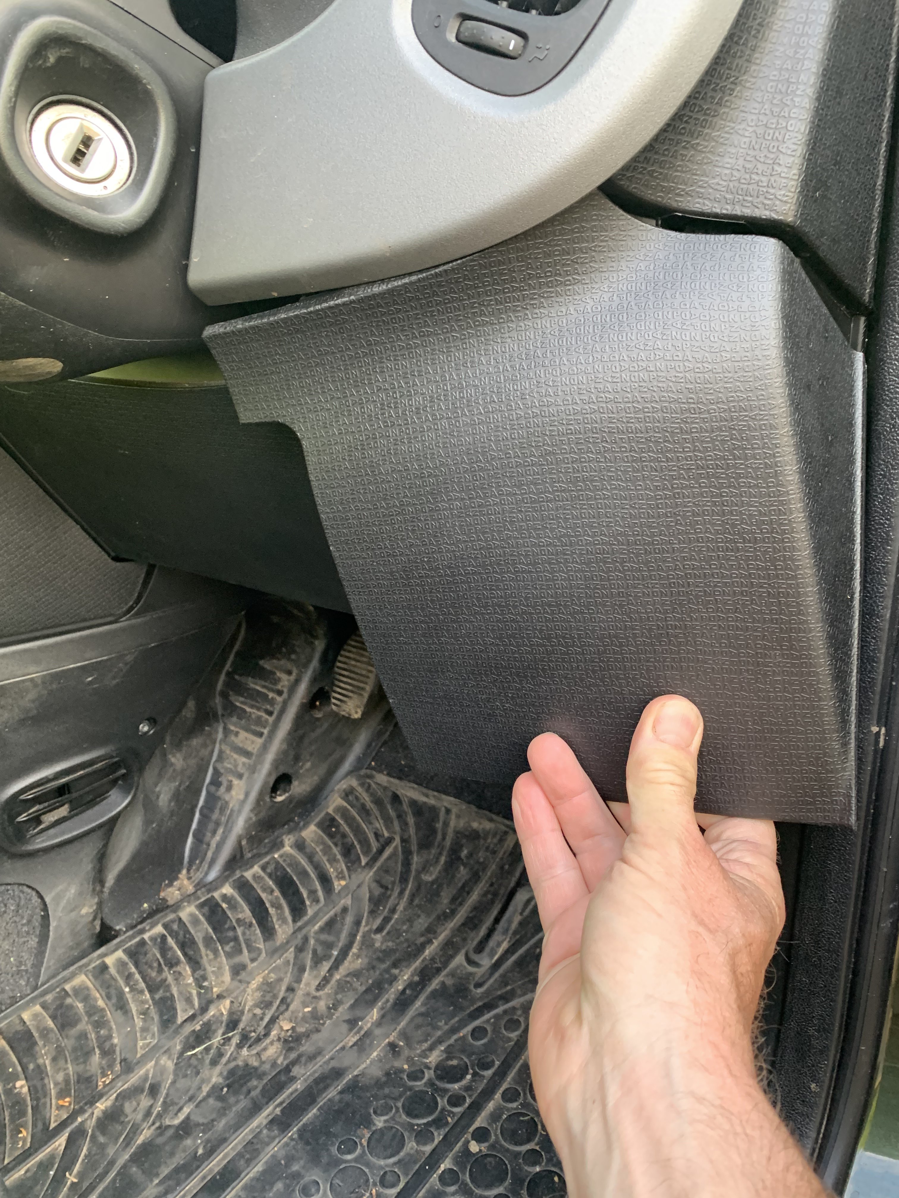

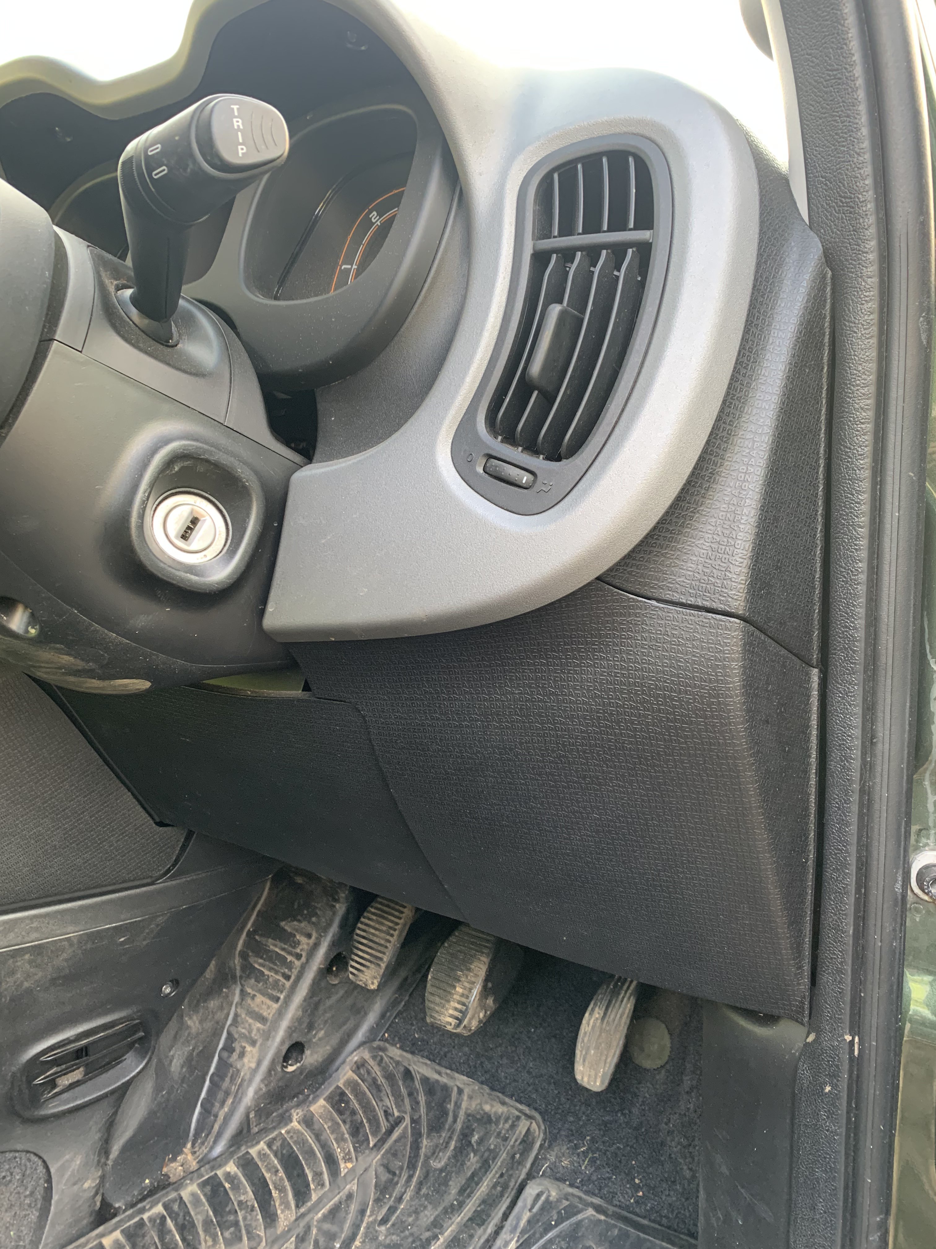

Here you go… panel above drivers knee. Pull hard at the bottom, towards you. Feels like it might break but doesn’t - the clips are metal and designed to be opened. (Oops - photos loaded in reverse order)

Cheers, I tried to get the middle panel off but it wasn't coming off easy, didn't want to use too much force.

Absolutely looks to me like a 100% removable panel? Good job I didn't get peed off and ripped it off.:)
UPDATE.......... (I'm busy during the week which is why I'm always real slow to update) anyway I've checked the codes with my (pretty good) OBD unit and all is well. Didn't have my phone to take a screen shot but it was a screen full of green ticks, all good.

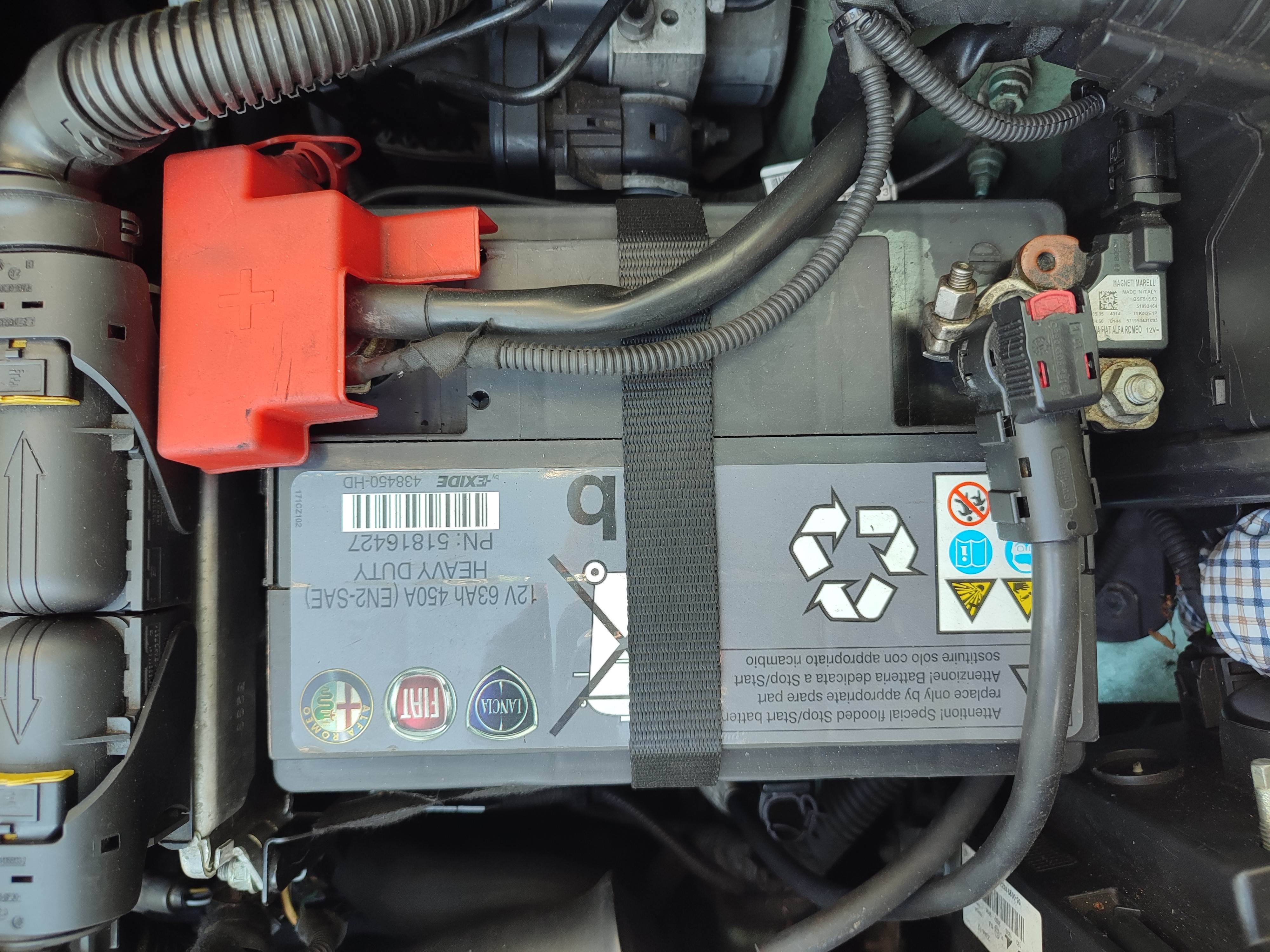

There is also a voltage regulator on the negative terminal of the battery but I don't think this affects things significantly other than the stop-start.
