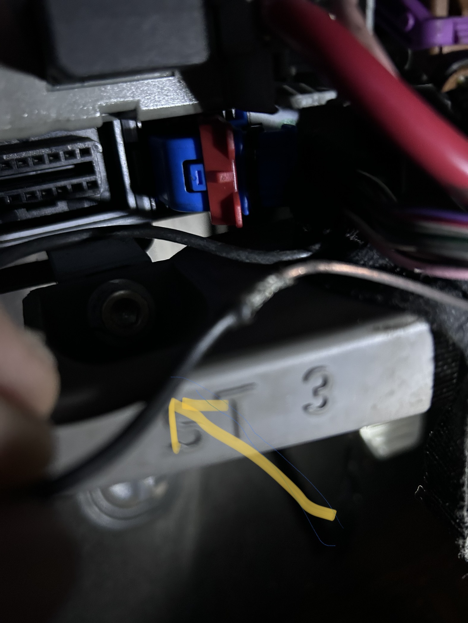

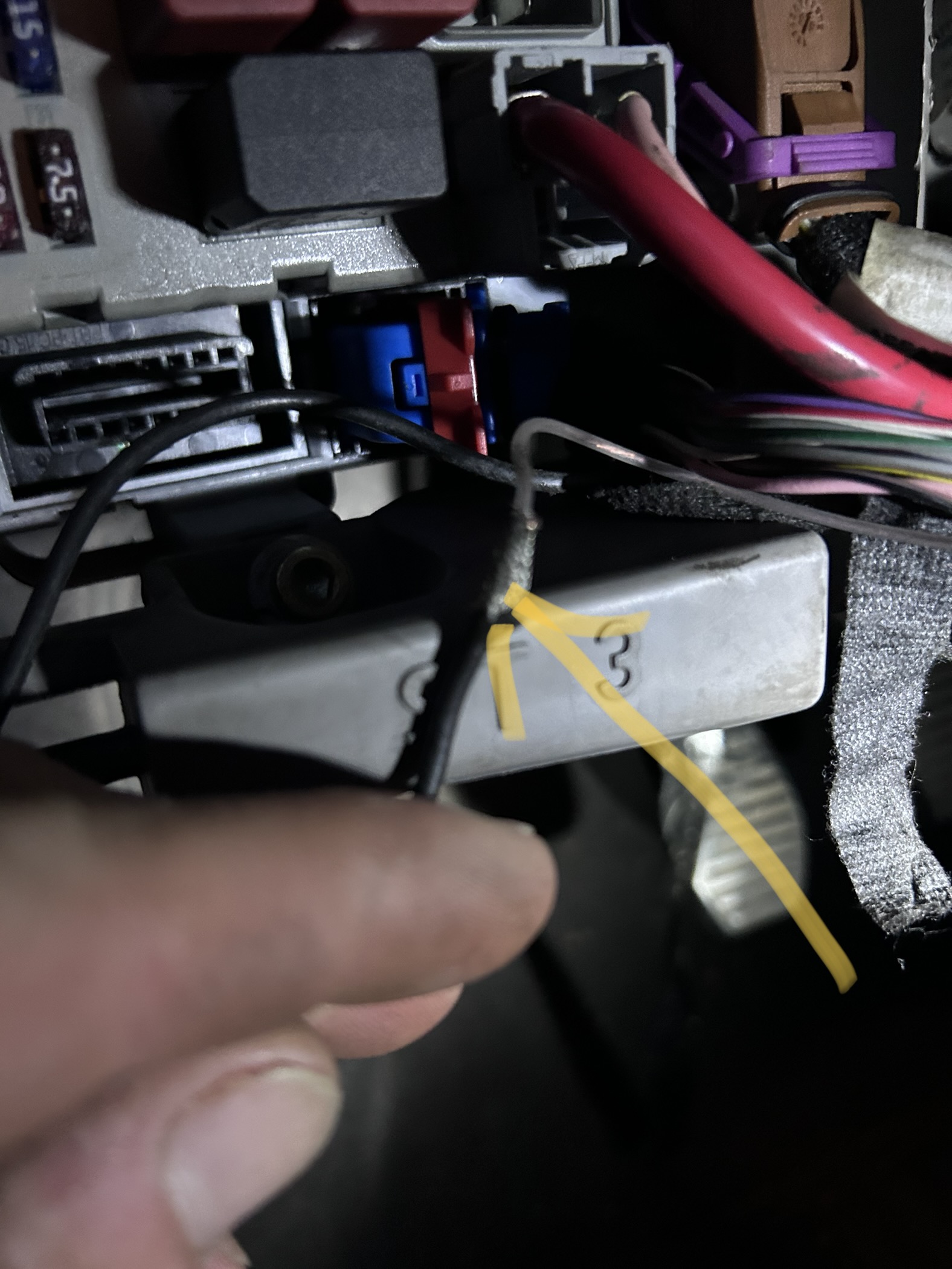

I bought an Punto mk2, but the seller didnt tell me Some issues. The flashing light keeps blinks fast like there is an bulb broken, but it its and when I use high beam The other light go of and no high beam. I also found a wire that isnt connected see pic it looks like an coax cable hope Some 1 knows

i also bought an second hand steering column switch, could that help? also that lose cable what would that be u think its in the blue plug and looks like coax its in the plug the outside and inside used

Re the coax cable I don't know, can you follow it both ways to see what it has been put there for.
I found 1 of The ends and it ends in connector c bleu one fuse box but i cant vind any pin out of that bleu connector.
The wire with the coax covering is a Ariel it's for the ecu to sense your key fob it should go up to the ignition (or the alarm if one's fitted) switch, as it surrounds it complete with a lange plastic washer, so the car can start. Don't know why you lights are goin wankie. But every day is a school day when you trying to work with European wiring looms. Hope you source your problems quickly though
How is it possibel this car starts if thats a cable for starting? Or do i raad it nog good? In nog so good in english.. haha i also Cannon use my obd Bluetooth Thing to reed the car! Thnx for all info that u Guys gave me intik now
It reads an electrical signal to disable the immobiliser and is not the high amperage cable from the battery that turns the starter motor.;)
doesnt it need to get that signal to start? normaly.
