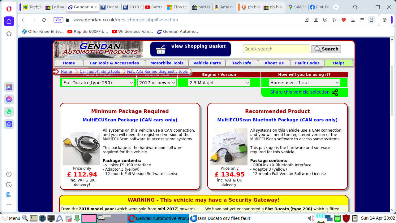

OK, that would be great to know which is the best sensor to put back in, thank you. My van was registered in March 17, so I'm guessing I will be OK without the security gateway bypass that Gendan advertise? Is it worth getting the bluetooth version? How much is the ongoing subscription after 12 months?
Attached is my spare MAP. There is no ongoing subscription for multiecuscan just 1 year of updates "lifetime" use for the windows version, for the IOS version Apple want £50 a year. I use both usb and blue tooth versions. bluetooth is more conveniant for general use usb safer for key coding and proxi alignment. no sgw bypass required

Happy to try the MES, but at the moment it wouldn't make it to the motorway! Will have to renew the MAP sensor and then do it. Is the MES software expensive?
£50 just for software, not in my eyes. Read my guide for alternative interfaces.

ok, let's see what the MES throws up, will take me a few days to organise, my home laptop is knackered and I won't be allowed to download the software onto my work laptop. Will find another laptop and get the kit together. So essentially the £15 OBD dongle off ebay you mentioned and pay £50 for a software license and I'm good to go??
Caveat emptor as with anything from EBAY but one i bought works. I now carry it and one Vgate permamently in van. the spare vgate and OBBdlinkSX live in my OBD2 box with all interfaces i have which goes in whichever car is travelling more than 10 mile.

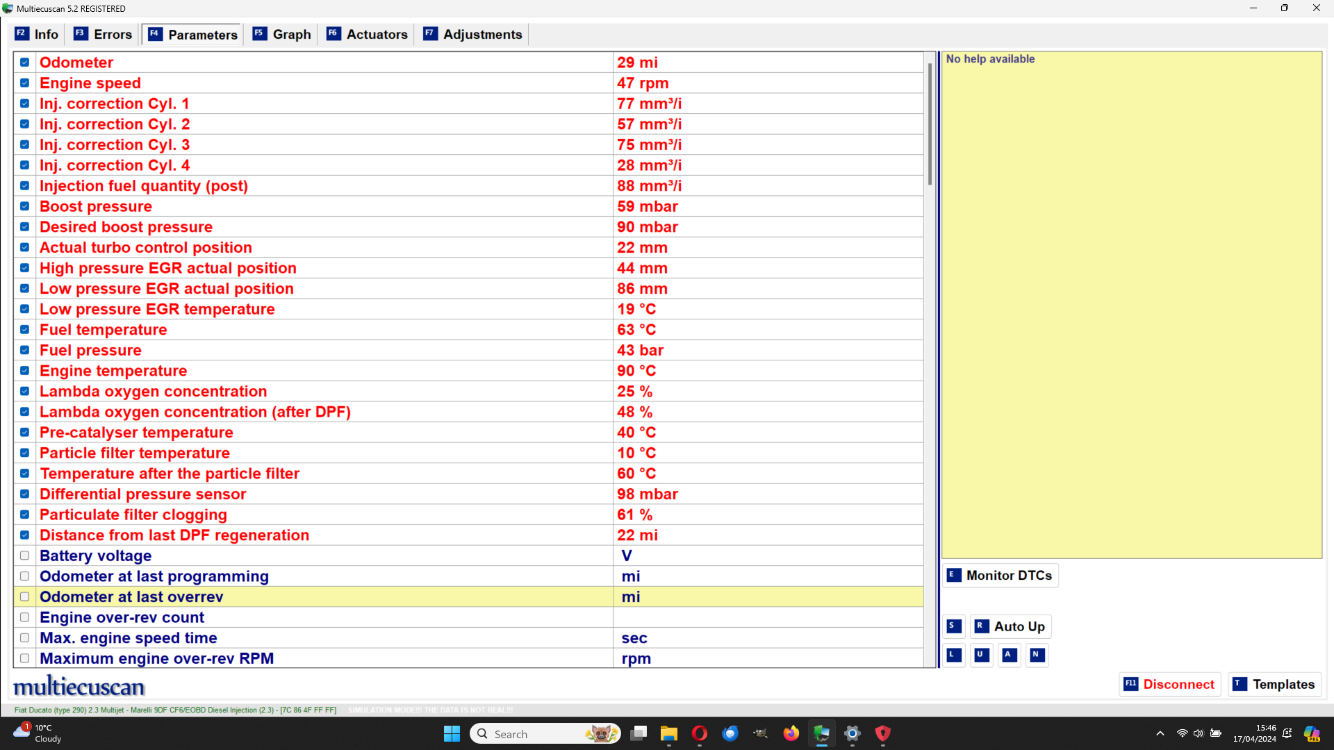

Hi @Serrow225 , I'm the originator of this post, still here and still using our Ducato (inc comfortmatic).
I'm also the one that worked out how the LP system works when the cooler is blocked with the result that it strangles the engine because it closes off the fresh air supply from the air filter and with the cooler blocked there quite simply is no air to breath. If I put a scarf around your neck and pulled it tight you too would collapse and go limp!!
It's very easy to employ Multiecuscan and view on the laptop both EGRs working. The LP works to effect a controlled blend of exhaust / fresh air and the LP can be seen constantly varying it's millimeters of opening, the temperature seen to be varying up to say 100-120 degrees; this being if all is well. If the cooler is blocked you will see the LP is either full closed or full open, at 4.7 (if memory correct).

As the ECU has obviously decided to shut off the turbo, will I need to clear / activate something with the MultiEcuScan to tell it to work again? In it's current state I would struggle to perform the tests required once I have the dongle / software.
