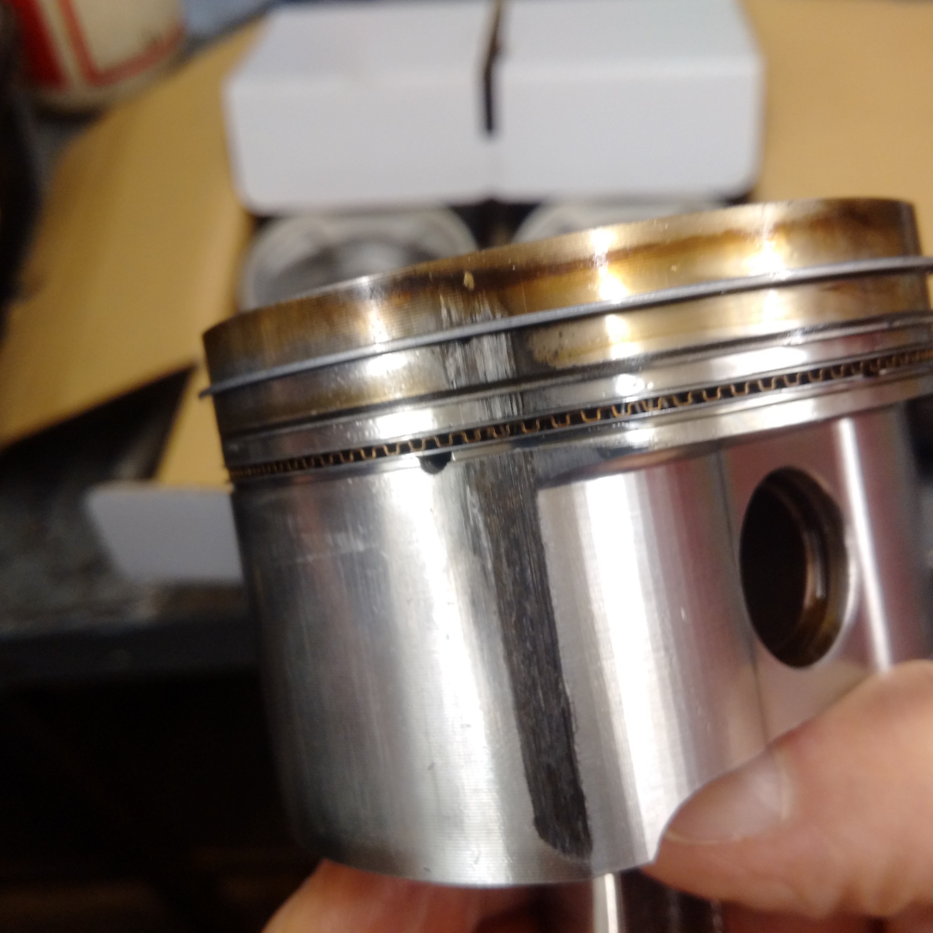

Ian, I think your plan to, ahem, confront? your engine guy will get the answer. At my local workshop there are lots of really good information posters which would probably point straight at the cause of that. In the circumstances, with your engine not even run-in I think it's likely that the bore is a bit tight to the piston. If so, if a piston ring or rings was insufficiently gapped. When the engine got hot you might have broken rings or partial piston seizure.
I would partially agree with Peter in that the score marks look like a broken piston ring--they don't look or feel, (when I was at your 'umble abode earlier today) bad enough to be a 'picked-up' piston. Also the noise you described, (like a stick being run across railings) is not normally the noise associated with a picked-up piston. The fact that the engine was not running hot, and that you can hardly feel the marks would also point to a broken ring. Bore-wise, I reckon that the marks can be honed out. If new piston rings are required, I can supply a couple of companies who can supply piston rings---you would probably get them a darn site faster (and cheaper0 than going back to Italy for them.
Ian Bleeding Knuckles, I obviously wasn't aware that Tom has actually physically seen the damage; so coupled with the fact that I didn't properly read that you were looking for an "engine guru", which I most definitely am not, :D I would go with his recommendations.
Either I have been lucky (because I'm not the world's most precision engine builder) or because I have stuck with standard components, fortunately, so far, I have had no personal experience of that level of internal engine trouble.
When you are back on the road I would definitely stick to the Fiat running-in regime which indicates that you were probably pushing your little baby a bit hard at 60mph within the first 300 km. So don't let on to the machinist that you were doing that. ;););)
Good luck and good on you for getting stuck in so quickly.(y)
Certainly looks like a piston ring problem to me. As suggested gapping could be a problem if not addressed on assembly but as many will know from experience breaking a ring can so easily happen. Unlucky there mate but at least you caught it early before a total mash up. You should have enough evidence to nail the problem. I do have a new set of 82mms barrels here if needed :)

For the bores to become scored, either a piston ring has broken, the piston skirt has cracked/broken .. or part of the valve/seat has come adrift and found its way into the combustion chamber.
If the engine has recently been rebored there's always the possibility that something was dropped/left in the bore .. however, as the car obviously ran ok for a while it tends to suggest that the company who did the rebore may have done something wrong .. like broken a ring when refitting the pistons. Or there's been a bit of 'swarf' left behind.
Some of these engineering companies can be 'fast and furious' - in and out as quick as they can.
Back in the 70s I had a Triumph Toledo 1300cc rebored and wondered why after refitting the engine that it took Monday to Friday to reach 60mph. They'd fitted the wrong pistons, which were one eighth of an inch too short ...
In the very early eighties the gearbox failed on my Austin Maxi, so I took to a reputable gearbox specialist who fitted a reconditioned box. When I collected the car I didn't actually get home.. as the gearbox failed. They'd left swarf and other lumps of metal in the reconditioned box...
On the face of it, the company who rebored the engine for you may have made a mistake... Though proving it is another matter.
If you're pissed off, there's a lot of people understand how you feel ..

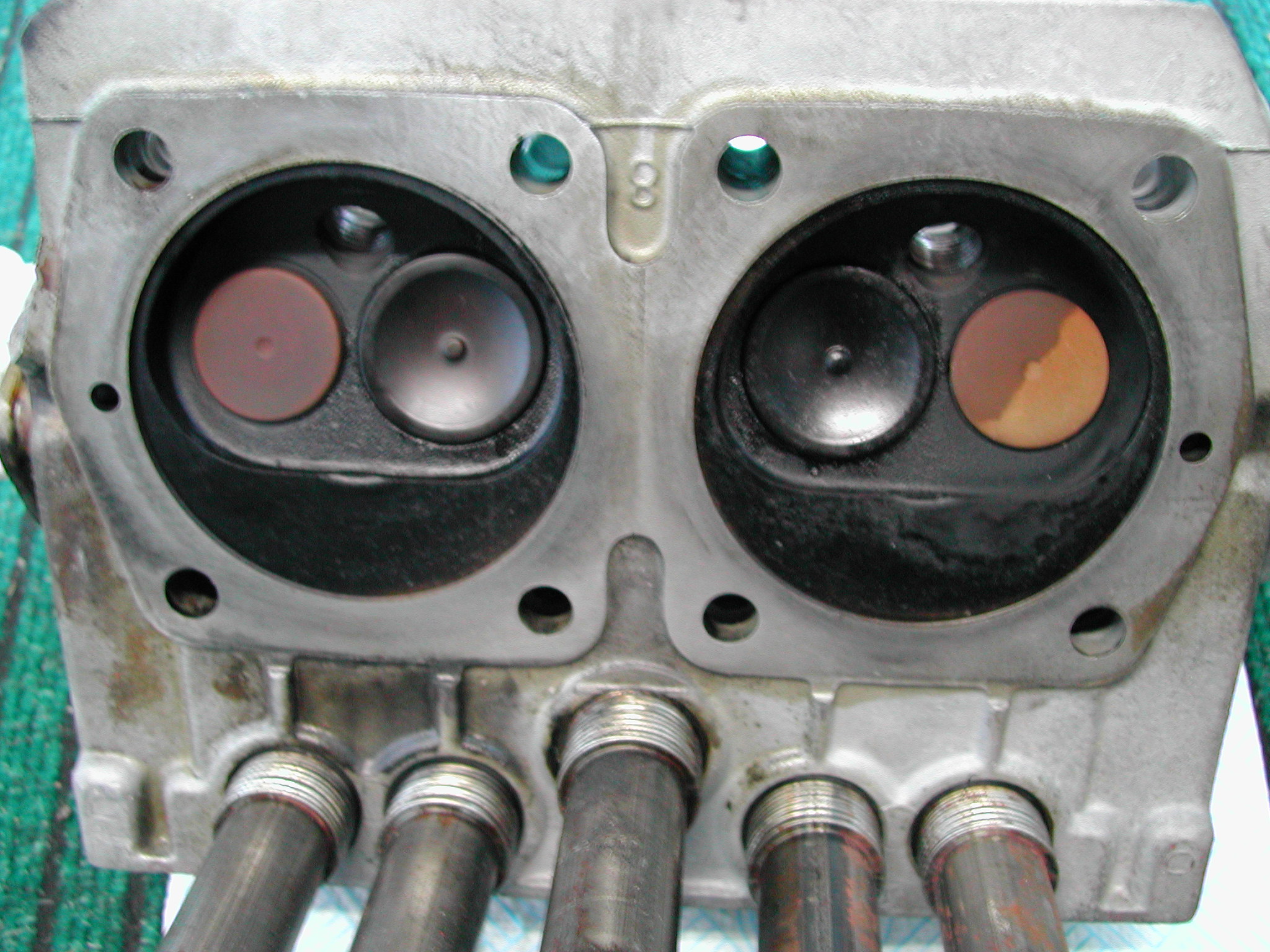

Update! My engine man :worship::worship: has seen the pic's and commented that the number two cylinder (forward) seem's to be running Lean??
(n)(n) Which i think is a bit strange as the Weber 30 DGF carb I'm using just dumps the mixture into the manifold there is no individual sharing :confused::confused:
Why would one cylinder run Lean:confused::confused:Anyway I am providing him with the cylinders, pistons and cylinder head too, to help diagnose it all. I'll get back with the diagnosis(y)
Ian.
Greetings, back from the engine man with info(y)(y)

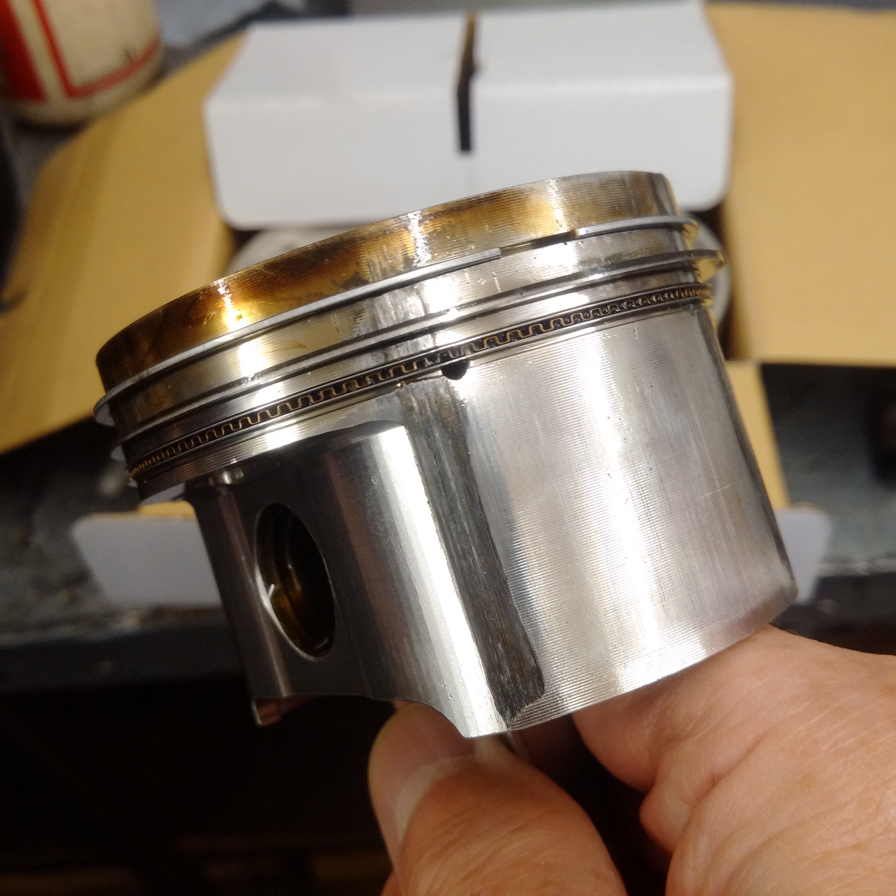

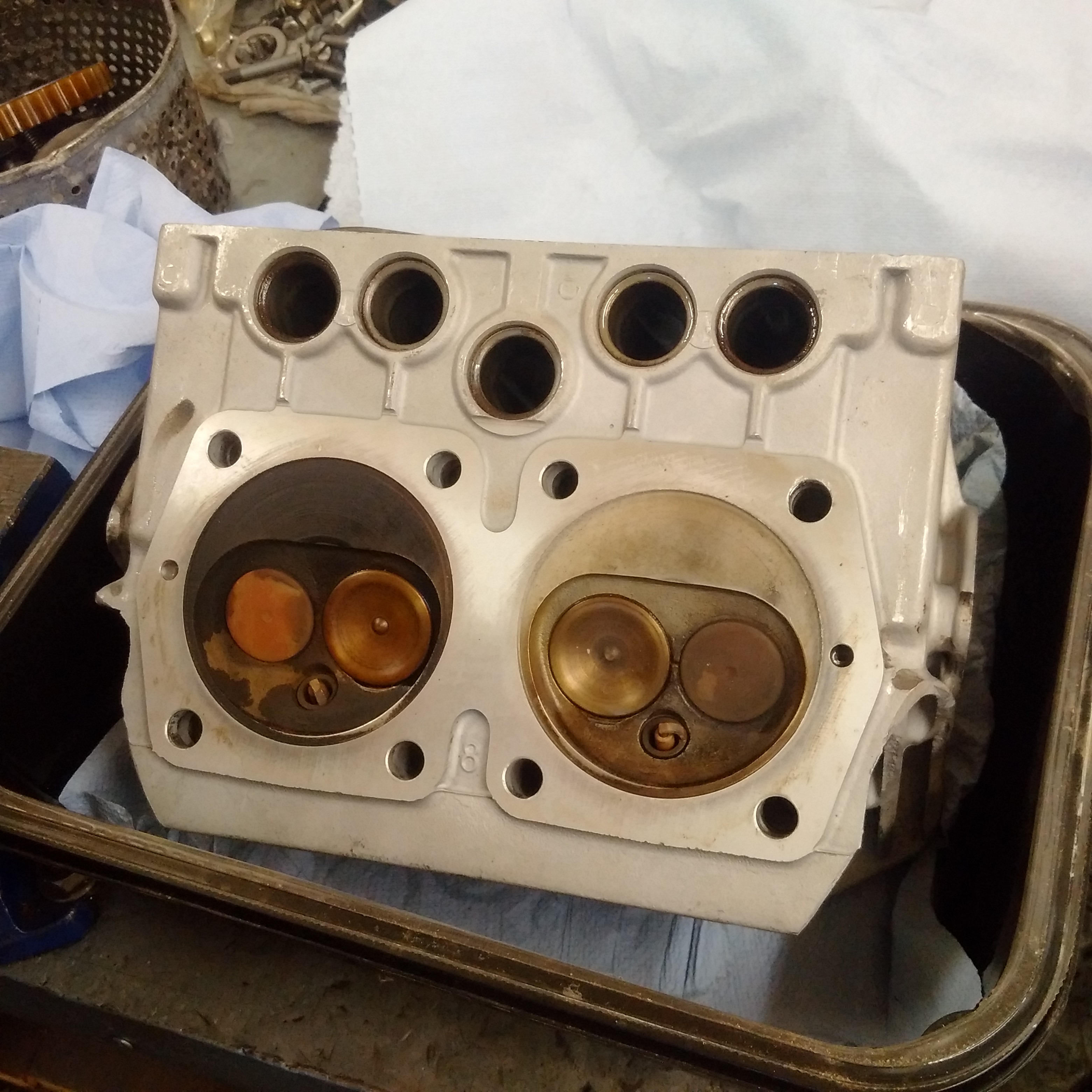

See the attached pics the first (1) shows the head before repair and cleaning with equal colour from each cylinder. (2) shows the head now with unequal colour - the lighter side is number two (front) (3) pistons with corresponding colour difference the lighter item is number two. (4&5) number two piston showing markings from what my man says is a partial seizure:eek::eek:
It seems (prior to more diagnosis) that the engine is running leaner on the number two cylinder and thus suffering overheating. There is a small amount of evidence of detonation too. All of the rings are ok. The only other work that has been performed is the porting and polish to the inlet manifold and the carb service:confused::confused:
All in all the possibilities are these - the airflow in the engine has changed (an air leak?), Its running leaner than before, over advance of timing, bad fuel, detonation. :mad::mad::mad: I don't know for sure, but the kit I got for the carb service may have been suspect with jets marked up as incorrect, as a matter of course I will replace all the jets removed. My man has said that due to the fuel mixture helping to cool the engine, any removal of this cooling effect (shut off)
could cause a rapid rise in internal temperatures and give the seizure:mad::mad
: so as everything can be saved(y) it's going to run rich until further notice.

Great pics and information.
The death rattle could have been pre-ignition .
Good job investigating this and so saving everything before it was destroyed.
Your distributor could be worn or faultly causing over advanced ignition timing on one cylinder. Suggest checking timing on both cylinders using timing light.
Good luck
Jack
Considering that the distributor sends spark to both plugs each time - i doubt the dizzy itself is at fault. Change dizzy cap, both spark plugs and leads in case number two circuit is breaking down.

Anyway, I find the location of the scuff/pick-up marks on the new piston to be rather suspicious. These marks are very close to where the cylinder studs are situated... You also mentioned that the barrels seemed to be a bit tight on the studs. To me it looks like the studs are pushing against the side of the stud holes nearest to the cylinder bore. Usually there is clearance around the studs and the barrel spigot is accurately located on the crankcase or stepped studs or dowels are used at the lower mating face of the barrel.
Many years ago, I dabbled a bit with overboring air-cooled motorcycle cylinders. (beyond what was commonplace and defiantly (I was young then!) against the advice of experts!).
Some strange things could and did happen. The cylinder needed to be able to expand without constraint. The cylinder didn't necessarily expand equally in all directions, i.e. the cylinder bore might not be circular when hot (or very hot!). Trimming cylinder fins (e.g.to make a different cylinder fit an engine)
could and did result in distortion of the bore. Cylinder bores don't expand equally from top to bottom. But hey! pistons are not truly circular nor the same diameter from top to bottom. If the cylinder wall is reduced too much in thickness, it can distort unpredictably in service. Cylinders get hot when being bored, so immediate measurements can be unreliable.
Enough rambling, I hear you say!
If this was my engine:-
I would open out the stud holes in the barrels from the top down maybe 3/4 way.
Investigate (if possible) if these pistons have expansion-control (Invar?) metal struts built in. Iirc, original Fiat pistons did, after-market pistons might not have. If not I would increase piston to bore clearance. My rule-of-thumb on a slightly modified engine is that the piston, without rings fitted, should easily drop under it's own weight when placed into the cylinder but not rattle.
However, if piston to bore clearance was insufficient I'd expect you would have experienced trouble much sooner and the damage would be similar to what you showed in your post #1 i.e. centrally on the thrust face of the piston skirt below the rings.
I'd measure the pistons to check they haven't distorted (unlikely given how small the tear marks are), clean off the scuff marks, check the rings aren't pinched in their grooves or otherwise damaged. In an ideal (i.e. money-no-object!!) world, new rings would, of course, be fitted but I don't live in such a world! I wouldn't even bother removing the rings to check them, too much chance of breaking them.. Just check they rotate freely and side clearance in correct, if you have a thin-enough feeler gauge. (You could use a strip of aluminium foil).
As regards one cylinder seeming to have been running a bit weaker than the other?
Maybe it was because one cylinder was running hotter due to increased friction. Are both spark plugs the same heat range, same brand, same tightness (approximately, a loose plug can alter it's heat range!). Any mods to the air cooling system, missing baffles? restricted air intake? air outlet?. Any restriction in one exhaust pipe?
As another poster has suggested, check the ignition timing is correct on both cylinders.
Imho, you might have gone a little high with your compression ratio.

Some brilliant thinking (as annoyingly always ?) there from Al. It got me thinking, do the pistons have the proper offset that I believe the gudgeon-pin location should have? If so, unlikely you got it wrong, but are they fitted with the correct side facing the camshaft?
