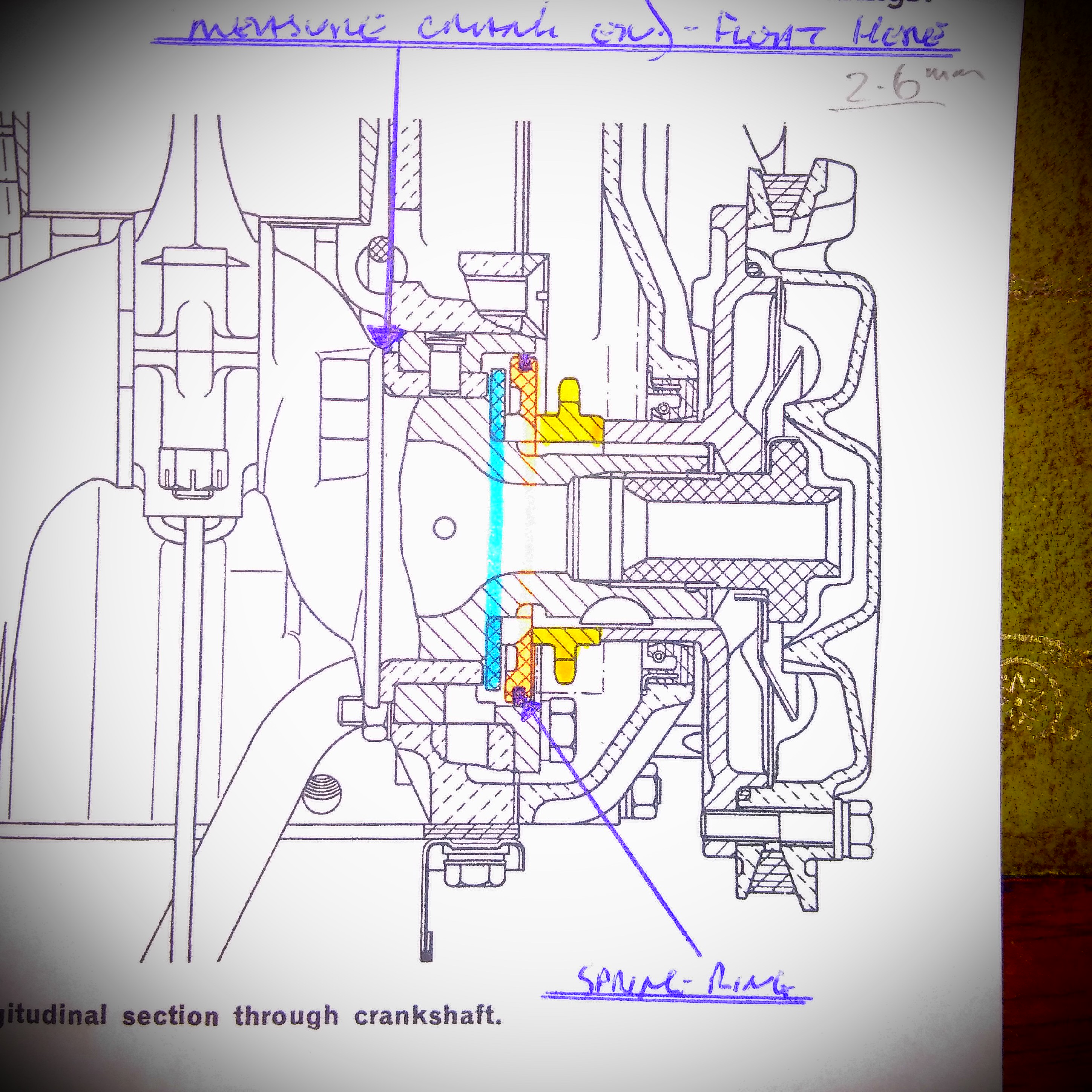

Thanks Tom, Graphogen on order. Can you confirm that I will get the same result if I remove material from the spacer (I appreciate that it will take longer) I'll get my DTI out and check the required amount for removal. I am loath to attack the bearing surface, so will do the next best (harder) thing and thin the spacer!!!

Well, having had a chat with Tom and a good think about what I propose to do I've had to change my mind (again) :mad::mad: the problem is that if I remove material from the spacer at the outboard end of the bearing I will alter the position of the timing chain drive sprocket :eek::eek: if only slightly. So the assembly is coming apart and the bearing face will be adjusted just enough to obtain the minimum clearance of 0.30mm (y)(y) the attached pic will show the position of the relevant components, the drive sprocket is coloured yellow and the spacer blue (ish) I'll get on with the measuring and the disassembly pending the Graphogen arrival

Started today with the attack on the bearing surface to obtain the correct End-float (y) found a good sized piece of glass, wet 'n' dry and wd40. It was slow going at first as I kept thinking "I hope i'm doing the right thing here"! A gentle circular motion is all that is needed then clean up thoroughly and reassemble and measure -damn only half way :mad::mad: disassemble and start again, after half an hour of circles I arrived at 0.30mm end float and the Graphogen arrived at least four days early (y)(y) (parcel force really are getting the finger out!!) On with the Graphogen and locktite the bolts (y) Still waiting for some poxy little spring washers so no more progress on this end. Camshaft next (y)

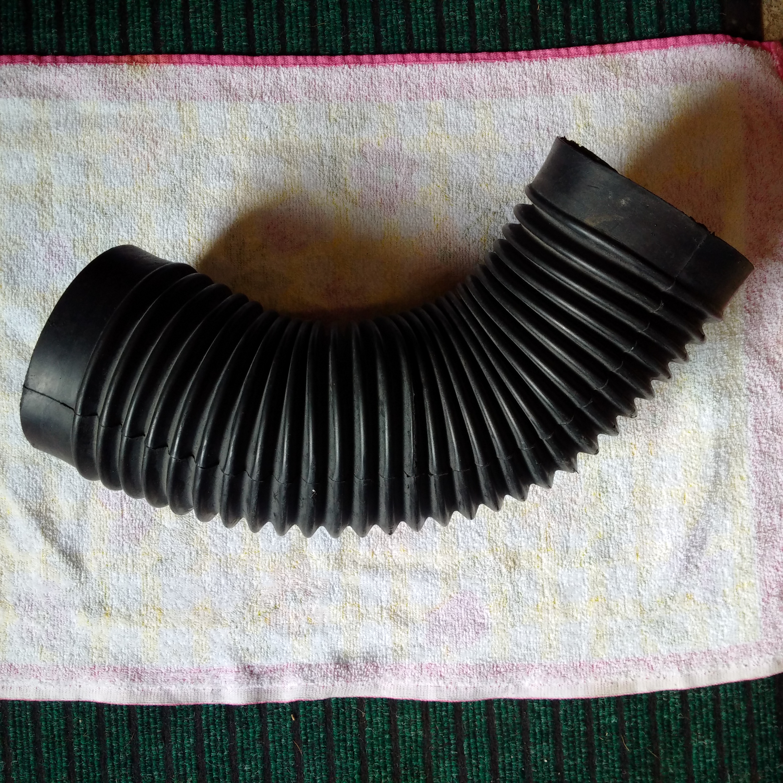

As the rebuild continues I have run up against an issue with the air intake hose I have, in that it's old and stiff (same as me then!) :eek:
So after canvassing the web I noted to my horror that you can pay anything from 13 euro to 19 pounds without postage/shipping (n)(n) But then a light went on and I vaguely remembered something somewhere about reconditioning rubber parts - a quick search later and I had the answer (y)
but not the required silicone spray (n)

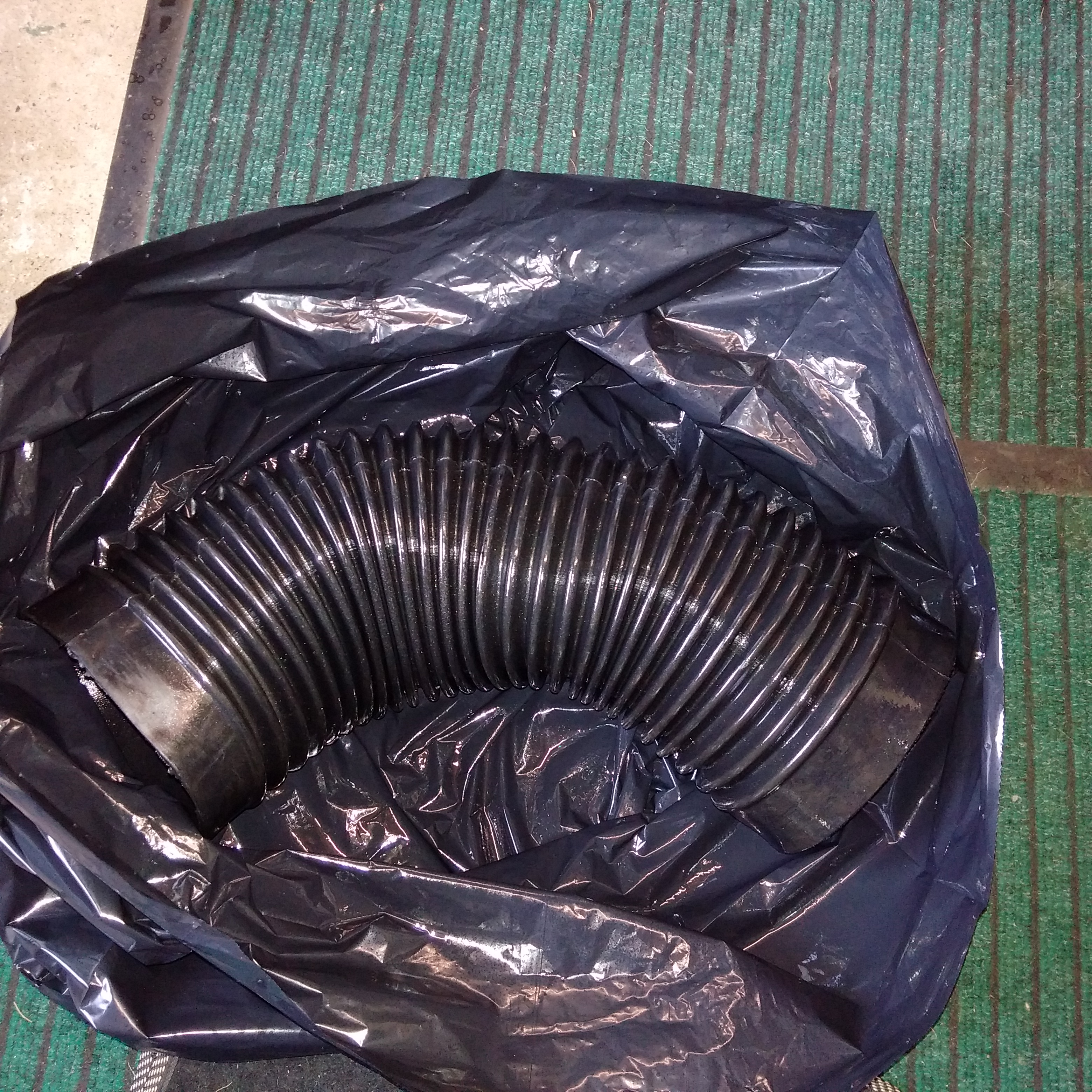

Apparently it's all to do with the natural ageing of the rubber and the leeching out over time of softening chemicals called 'Plasticisers.' Silicone Spray contains the required plasticisers to keep the rubber pliable :cool::cool:
So all you need to do is grab a bin bag big enough soak the part thoroughly with the spray and tie up the bag for up to seven days - check and replace if needed. Result!!!!
Only downside is that Silicone spray does stink :eek::eek:
