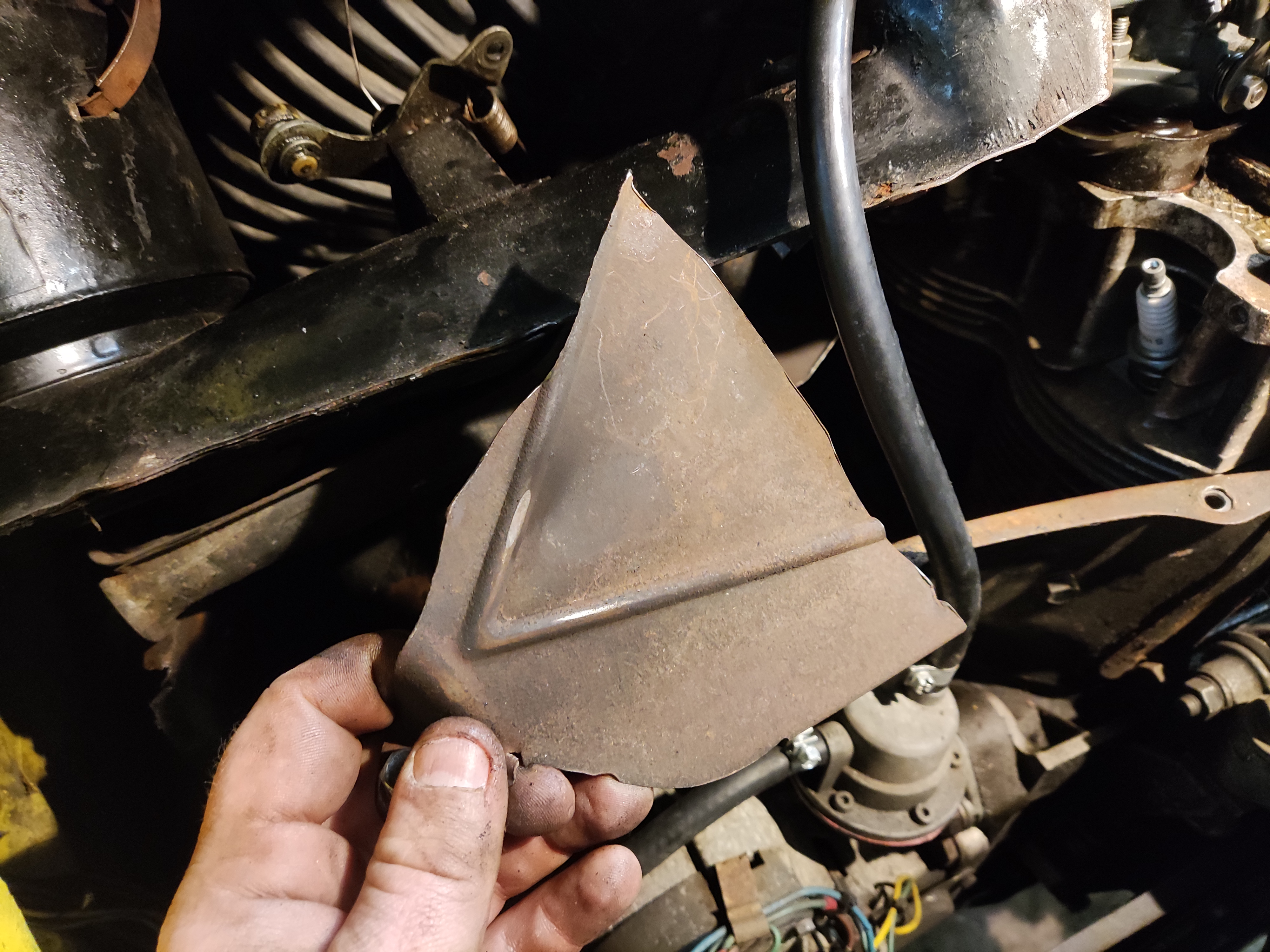

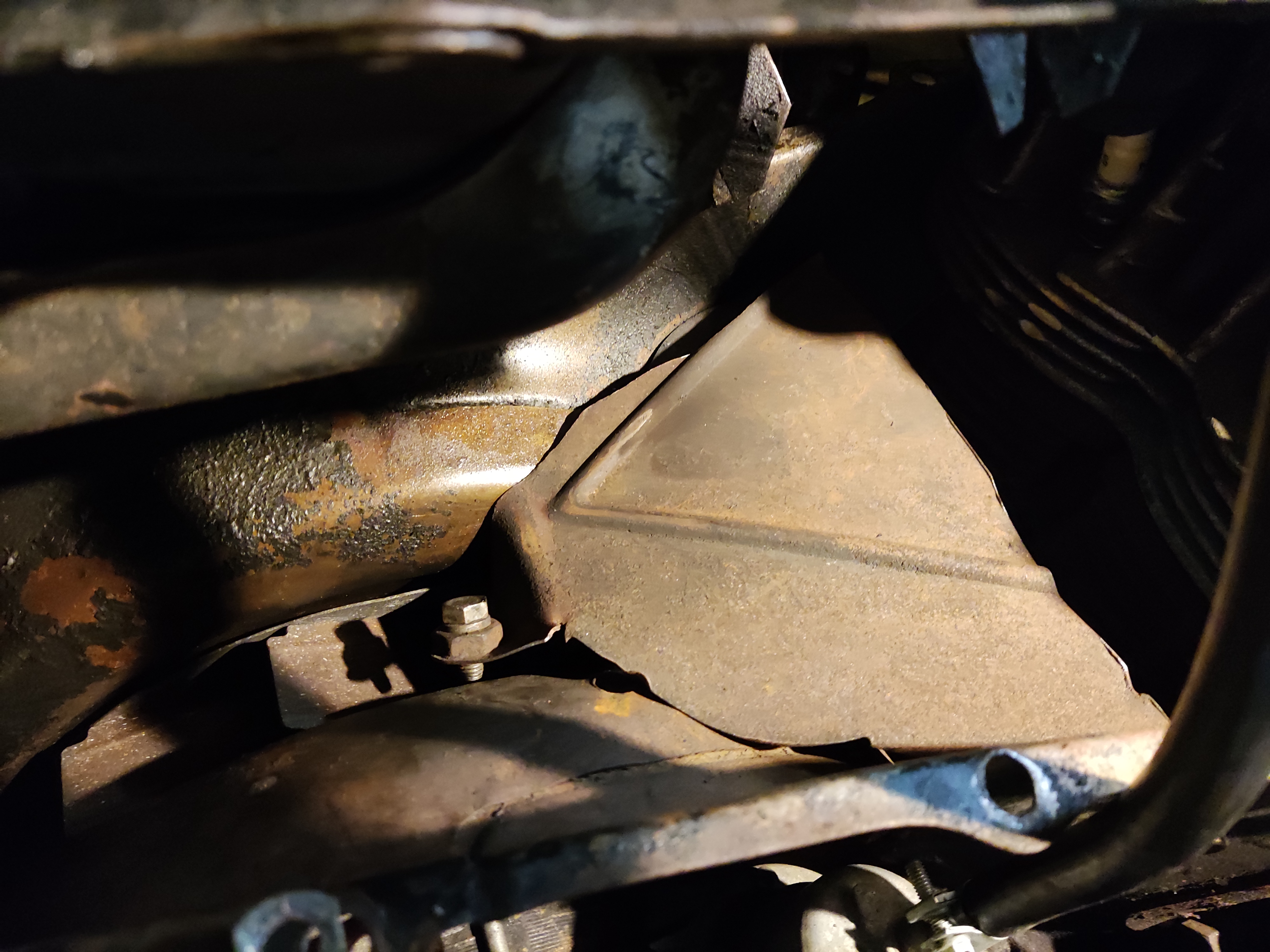

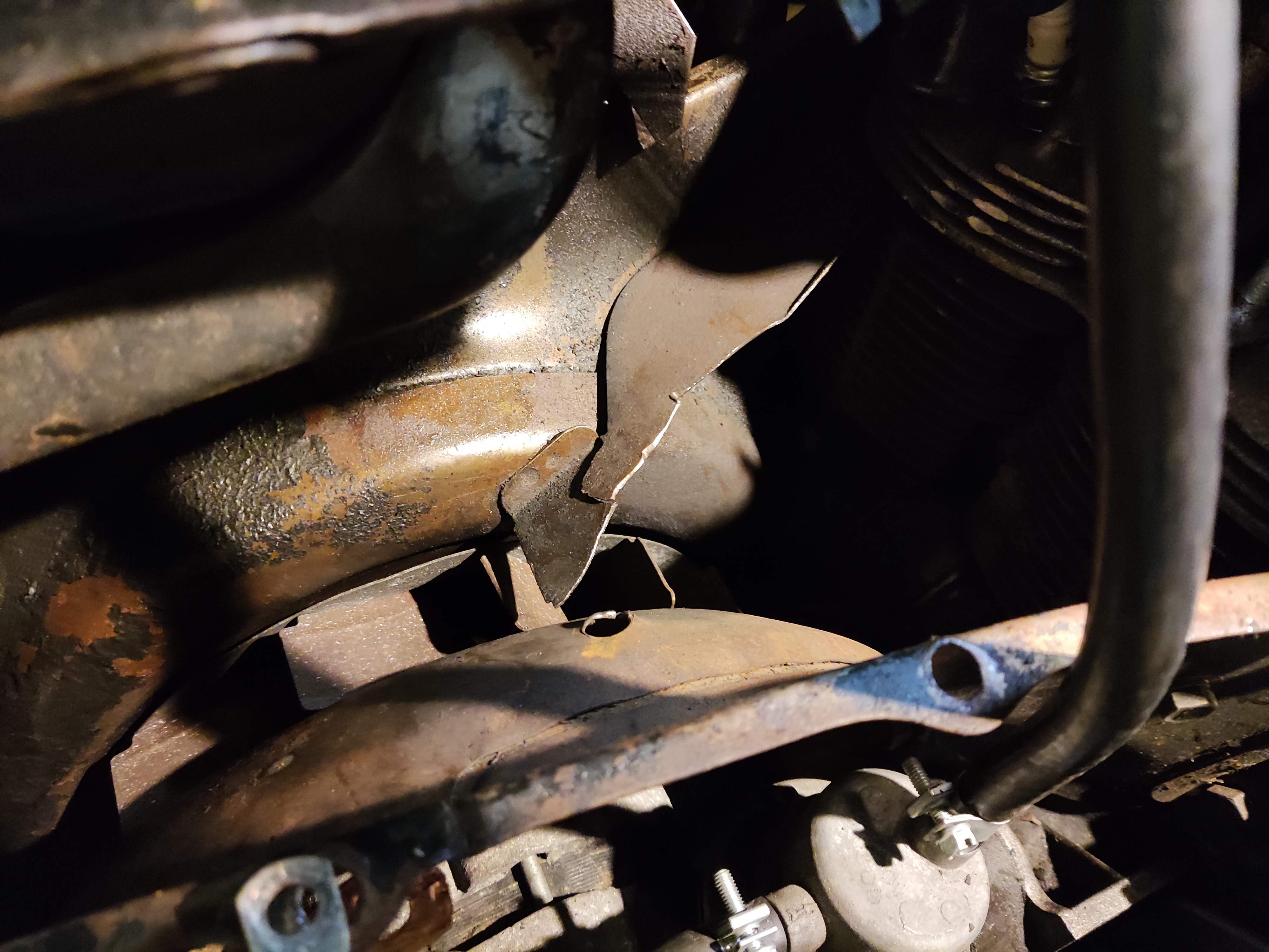

Hobbler was bang on, the deflector plate came out, looks to me that over time due to fatigue it cracked the whole way across.
Fan looks to be intact so I don't think anything fell in and got chewed up and bounced around.

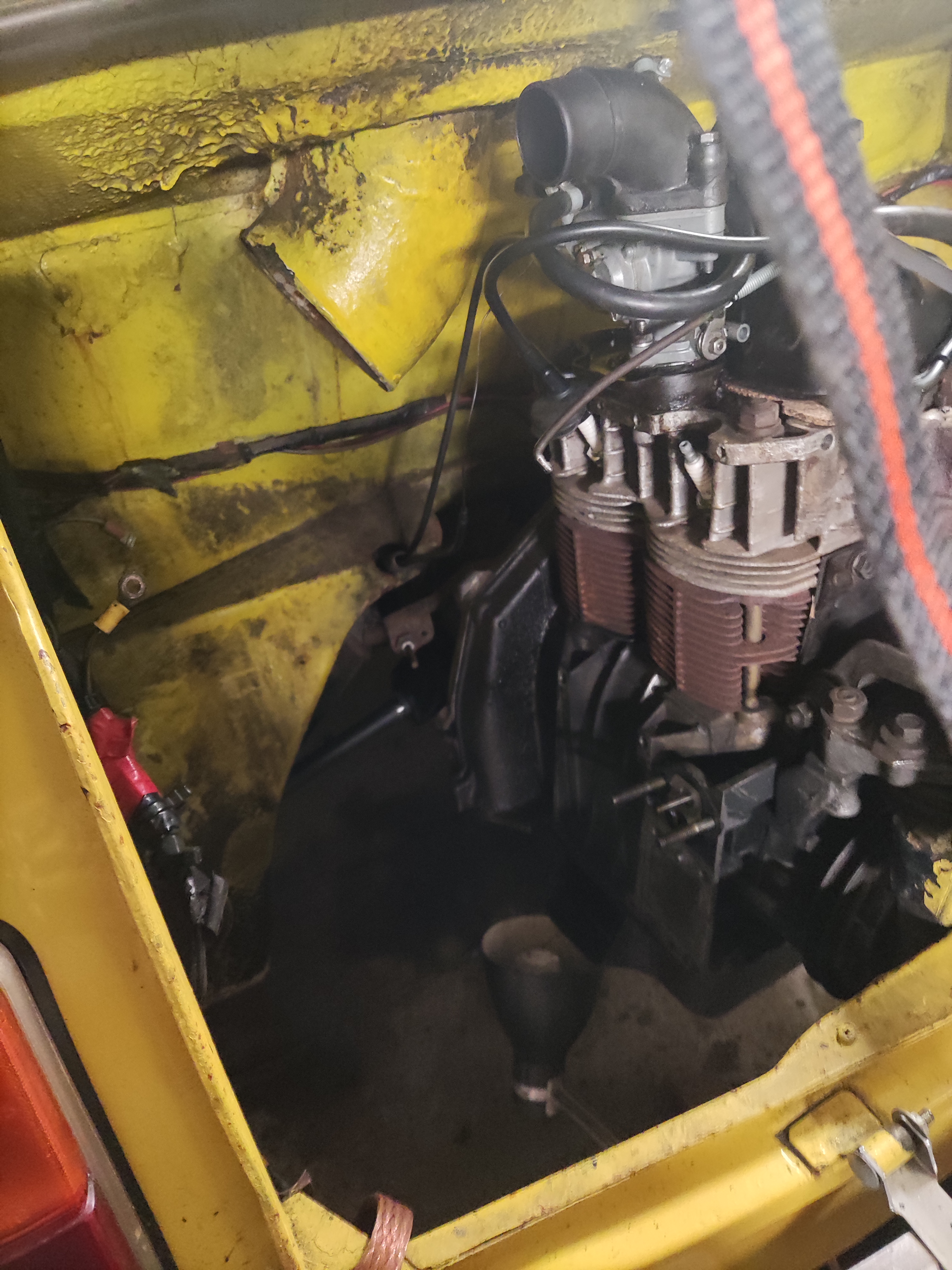

So that's out, did a bit of jiggery-pokery and got it out as one lump.
Site I had found a housing on couldn't guarantee that it was an alternator version and I don't need to order a heap of them to find the right one so I'm just going to bring this as a whole to a metal fabrication place and see if they can weld and brace it. Forgot to take a picture but it looks to me that whoever was in here last loc-tighted the fan nut on there so I'd say it'd be he'll on earth to get it off.
While it's off a good bit of detergent and minimal water to clean the bay is called for!
Many thanks to all who posted and stuck with me.
